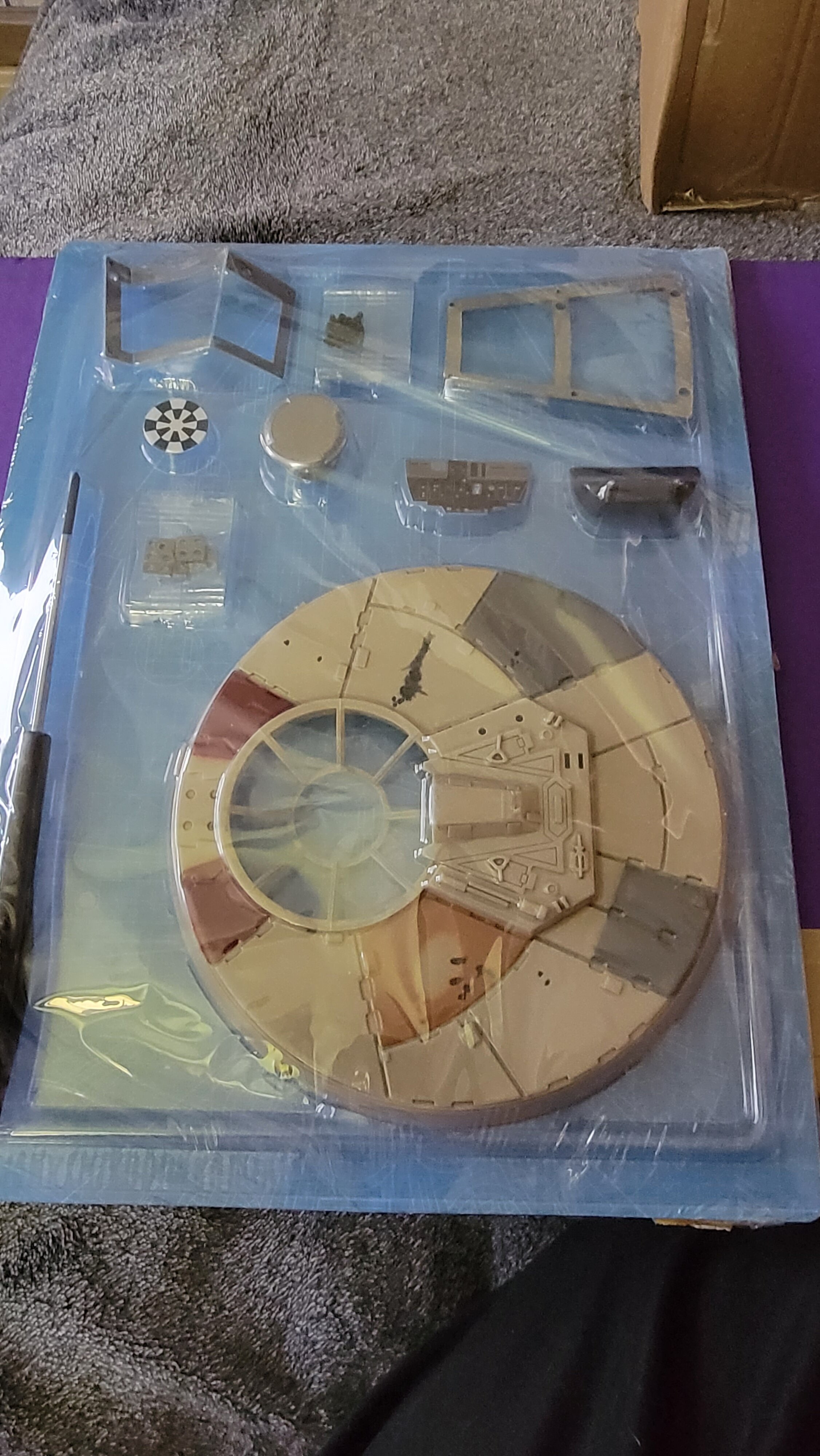

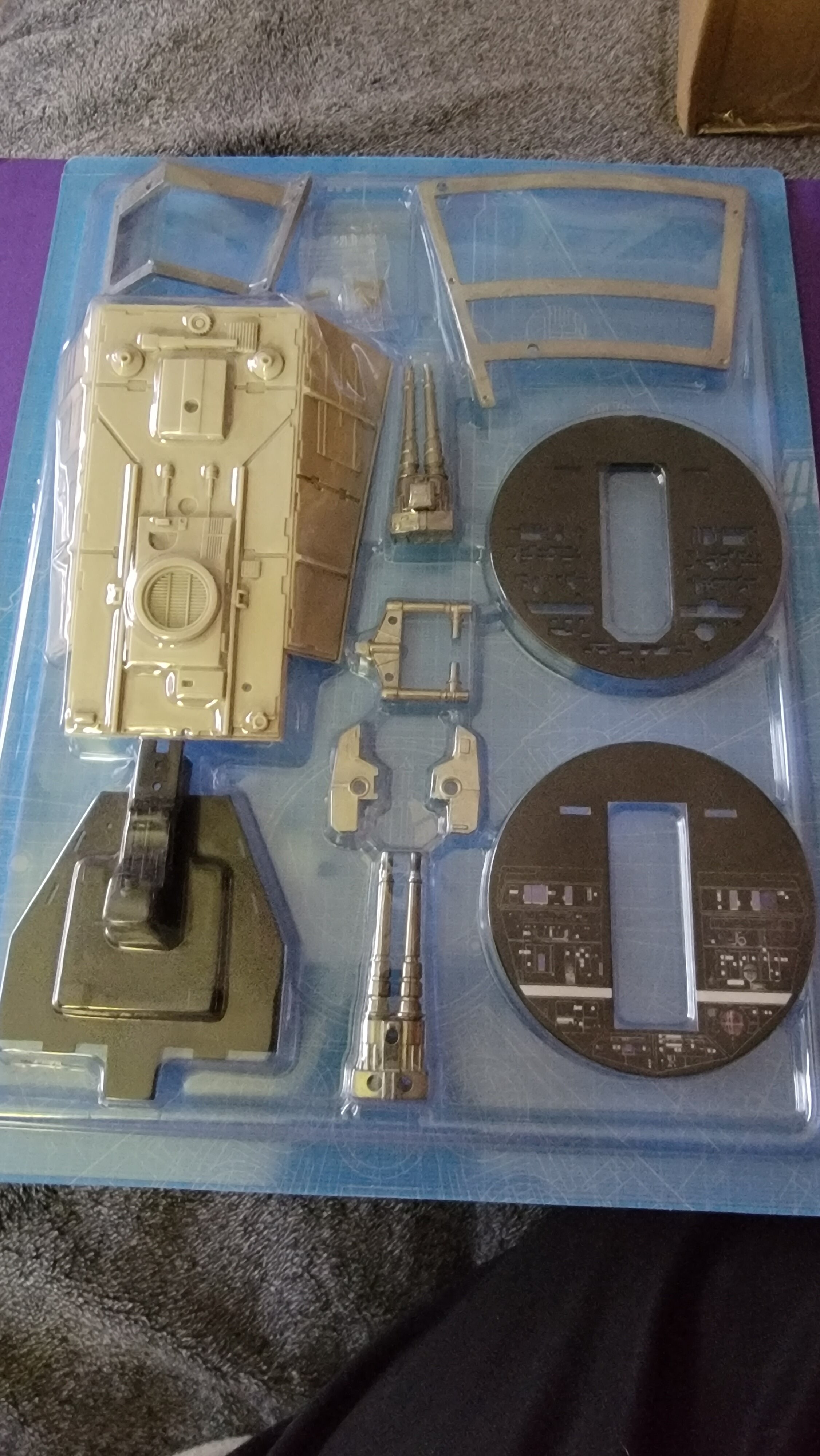

So, I just received my first two issues in this build. I missed out on the opportunity to get the DeAgostini set so I jumped on this one. It's going to take a while to start but I will be asking for advice on various topics.
Looks like the parts come painted... I though I read that this was an unpainted kit?
Yes, some parts are painted. However, I will be repainting the whole thing. I do have a question for those who have this kit. Did it come with all the correct decals?
I've had the complete kit since 2018 and yes it is unpainted and most of the coloured/painted parts are the cockpit and internal parts. The exterior hull and landing gear are unpainted but there are SOME painted panels on the upper turret though.
It comes with NO decals other than what's used for the cockpit.

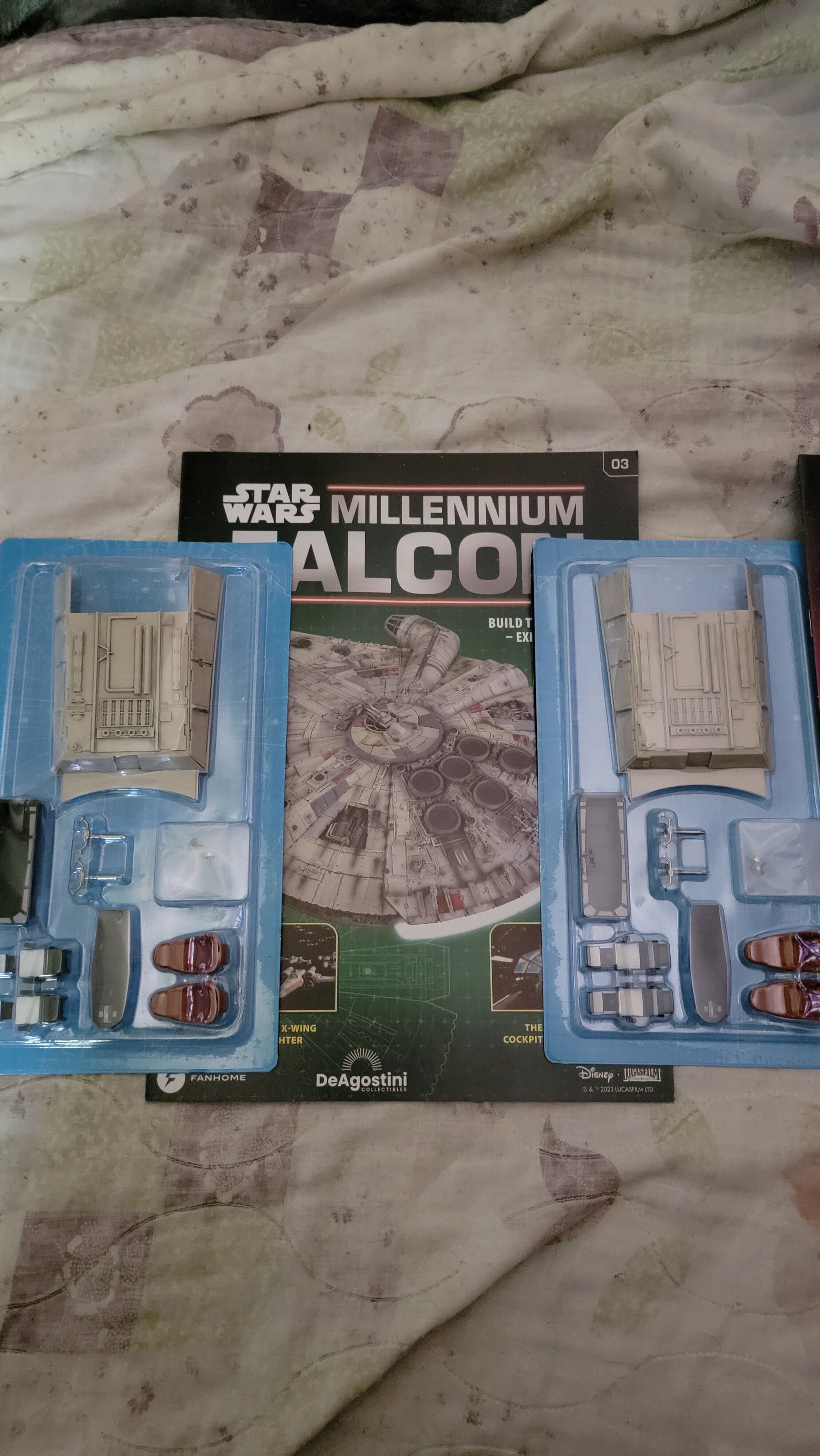

Well, I received a double issue with issue #4 missing. I've sent word and photos of my shipment.. I hear that Funhome is pretty good at resolving problems..

So, Fanhome is correcting the error and have already sent out the replacement.. Absolutely superb customer service.
