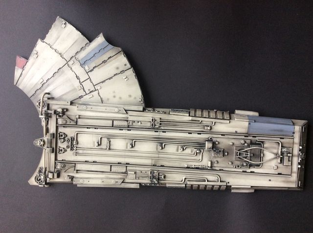

The underside recesses in place, the mag says not to join these at this time (46) but so lve only screwed 2 screws per pit.... Its so l get a total feel for the underside painting....

The lightings dark & shadowed due to bad natural lighting from window but hope you like a close up....

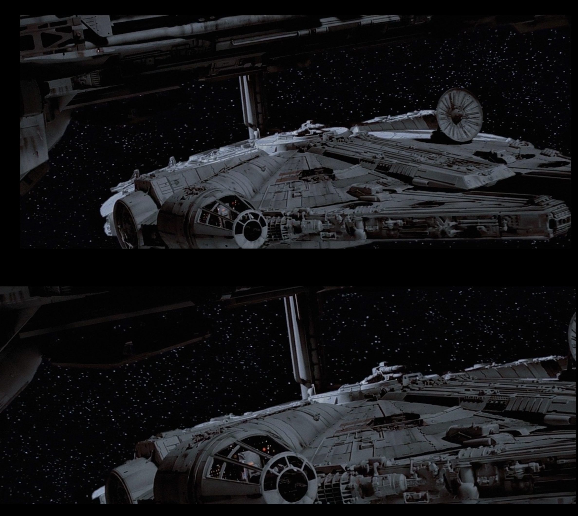

In regards to the 32" model being for stunts and fast shots, there is one nice long shot of it at the end docked to the Medical Frigate that is really cool, the best shot of it in all its glory that I can think of that is on film. It's fun to look at all the ref pics of the model and compare the paint job to what actually shows up in the shot, shows how much these models are painted to be filmed under studio lights vs displayed.
Just noticed something in this first black and white pic. What is that ring around the center cone? I don't think I've ever noticed that before. You can see glue spots for that part in the second shot as well.

Here's the magnet mandible + cargo section part... Had a little trouble with fitting 2 of the magnets to give a flat plate fit to the rest of the Falcon but sanded down the magnets holds to fit perfect, the center mandible needs the red markings so l just added grey ref markings...

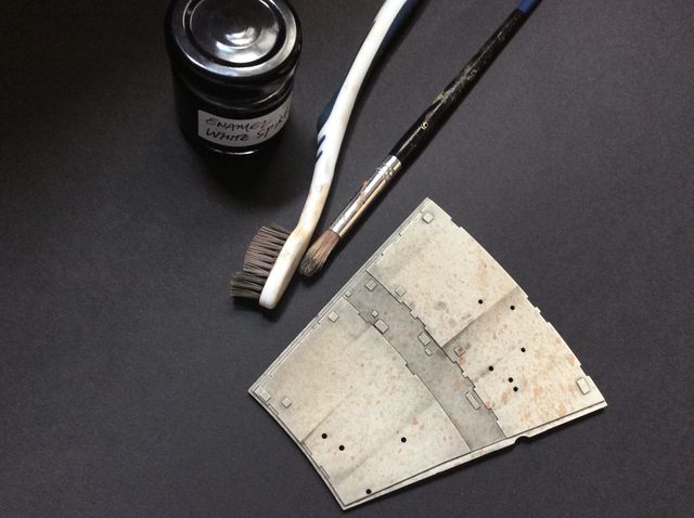

Next week lm going to go into tests of making those 'splatter' marks and fixing them, lm not keen on them but lll show the results and my findings on some spare practice plates..both oils & enamel based- with thinners.

And thank you... Been doing some test runs on those awful spatter/splotches Steve talks about in his video part 4, as he says it's optional to do
but l really didn't like what lve seen up close in the video as well as the distance shots...but it's good to know & l do like that he covers issues like this. What's your views on them...
https://youtu.be/Zmh16WAIijw
If I do add them at the end of the build I'd make them subtle like my test plate here... I'll try the rust colour splats later too.
This is my first layer using Matt black enamel part mixed with white spirit thinner..

One thing I would like to try is where you airbrush through a scrubbing pad. It helps create a more refined spatter. So I've been told
I've seen the Falcon up close and although the spatter is all there, it isn't nearly as heavy as in his video. Imho

Hi Astroboy, id like to see the effect if you do try the scrubbing pad method! I'm going to use my toothbrush & old stiff big brushes I've got come the time as long as my clear Matt lacquer fixes with good results when l receive it tomorrow..

I am going to be leaving the paint splatter off mine. That may work for a model not seen close up and made for filming but personally I don't like the splatter on the model.

Thanks Thomas, l know what you mean about them splats....looks like a spacecraft pox on the video!!! lm just getting the technique n' practice for the end of the build & if lm brave enough to do it, it will be a very subtle version. Anyway I'm sure you'll do great on your build.
I think the spatters are great for a little weathering texture on a model that is moving on the screen with motion blur, but not a static model. Unless you can keep it very subtle (1 shade darker and lighter than the basecoat), then I think it would look crappy.

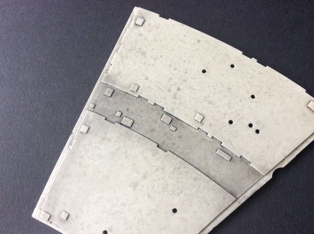

Here lve added a small spray of rust to the black & gray spats, (all just roughs to get into a comfort zone with the techniques) as lve said its only practice for the near end of the build & l will make it very subtle if l do...lve ordered the STAR WARS Sculpting the Galaxy book for further detailed references on this...
Just to NOTE I did mix a pot using the black lamp oil with thinners but it never drys properly, more like soot.
But with enamel it drys in well. I'm waiting for my Matt spray lacquer fixer tho to seal the job properly.

Just to NOTE I did mix a pot using the black lamp oil with thinners but it never drys properly, more like soot but with enamel it drys in well.
Wow. That looks amazing. Seriously.
But I'd like to add that the pic steve shows in his video from that book looks wrong to me. I think the photo was over saturated or something because those spatter look WAY harsher than they do in reality.
