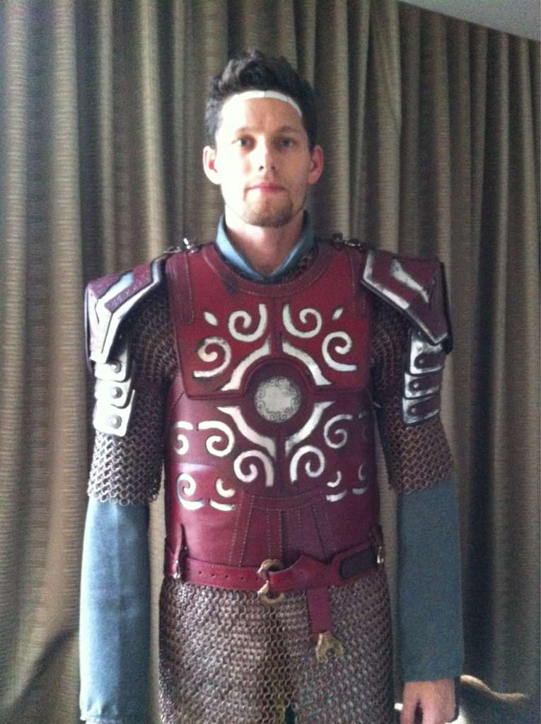

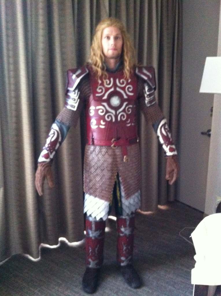

So great.... Thanks for posting all the layering progression.
You did such an excellent job. I am so in love with this costume and you nailed it.

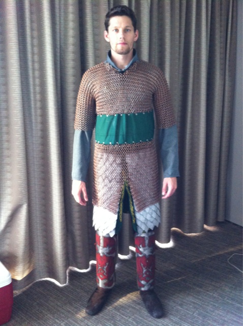

Excellent costume, I like what you did with the chain mail, did the middle section work well?
Yes, it worked great! Nobody was the wiser, and it was that much less chain I had to weave. I just put about 2 dozen eyelets into each end of a heavy cotton tube and hung the mail from it.

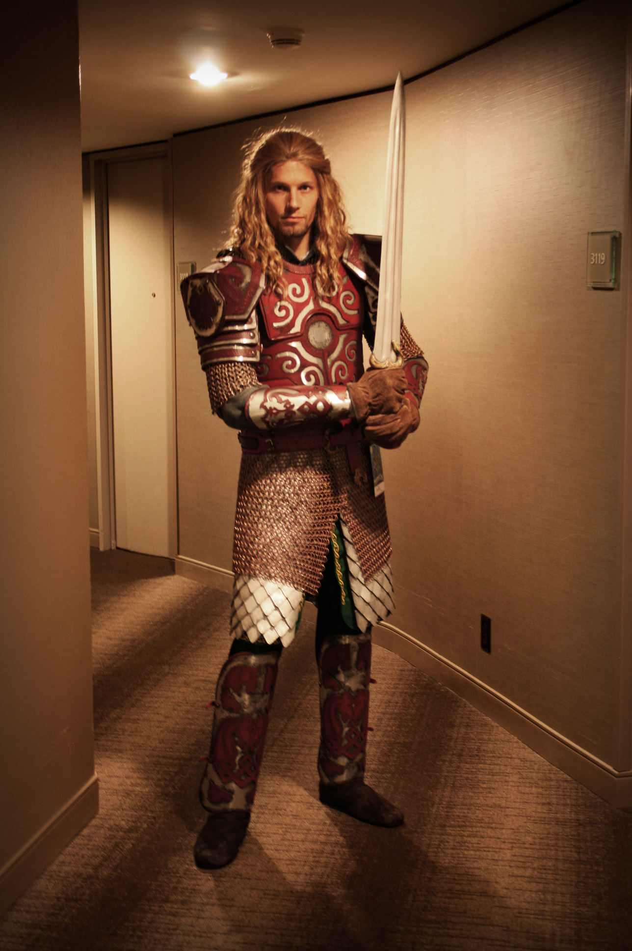

Here's a slightly better shot, showing off most of the full costume. This was after walking a couple blocks back from the Evening at Bree party, so I didn't notice my right greave had become a bit cockeyed.

Fantastic!!! this is just amazing, as soooo much details. I am blown away! Can I ask what material you used to create the horse detail on top of the pommel?
Ah! Sorry I missed this. In the last few days before I left I was doing nothing but working on this, eating and sleeping. For the pommel, I cut a rough semi-circular shape from a few layers of MDF, glued them together, and carved them freehand with a dremel. Then I put on a layer of wood glue and then rub-n-buff (which didn't really work because the surface was still pretty porous). For the cross-guard horse heads, it's super sculpey that I then hit with a heat gun to harden.
