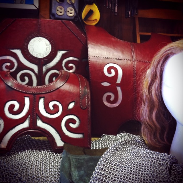

This is the earliest I've started working on one of my costumes for Dragon*Con, and I have a feeling I'm going to need all the time I can get. I'm building Eomer from The Two Towers from scratch, starting with the "harness", or torso armor.
I'm using craft foam which I ironed, then painted with acrylic paint, and finished with an acrylic satin varnish. This is adhered to aluminum flashing from the hardware store.

I spent a lot of time towards a dead end today, but I think I figured out how to solve it. The pauldron pattern I found online wasn't looking right to me, so I drafted my own through trial and error. My plan was to cut 2 pieces of aluminum and bond them together to form the curved shape, but either my experience, tools, materials, or all three worked against me, and the seam just looks too sloppy. My new plan is to construct the shape with foam, and then skin it with aluminum.

Last night I finished the main structure of the pauldrons, and they look better than I had any right to expect. I wanted to get the "leather" decorations on them last night as well, but I literally fell asleep at the workbench. I KNOW people in this forum can relate to that.

Pauldrons nearly complete. Still need to add trim and then weather the shield things. Lobster tail arm guards should be done by tomorrow.

Got trim onto both pauldrons, and all six upper-arm plates completed. One set is completely assembled. Could have had both done, but it was too late to be hammering rivets in the garage. Cannot wait to actually be able to wear these.
