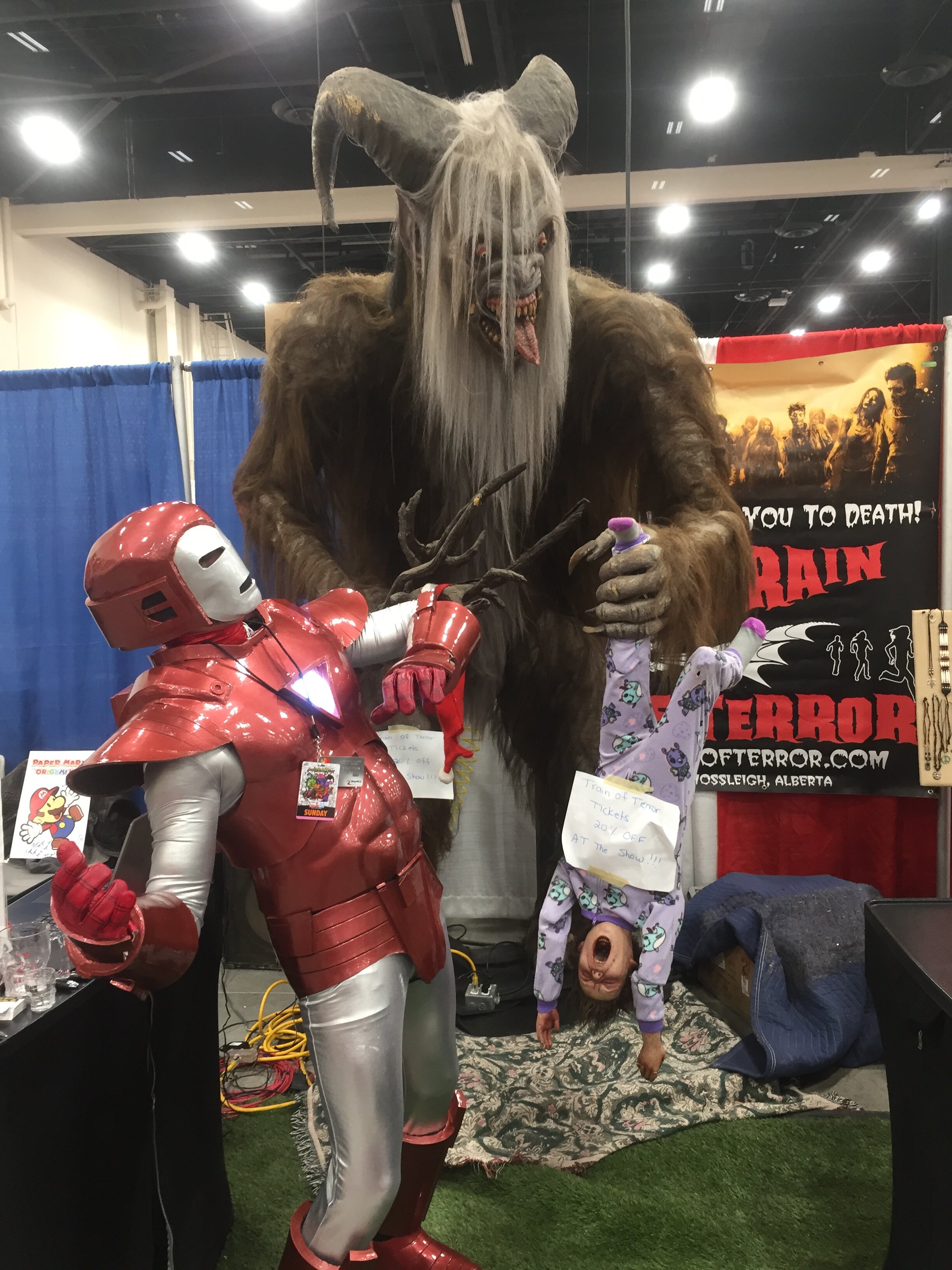

Paint job will differ from prior also; my Silver Centurion was:
- Heat sealed
- Sealed & primed with 2 coats latex/water based contact cement
- Painted via 6 coats of acrylic medium with colored mica
- Finished with 3 coats of acrylic varnish
