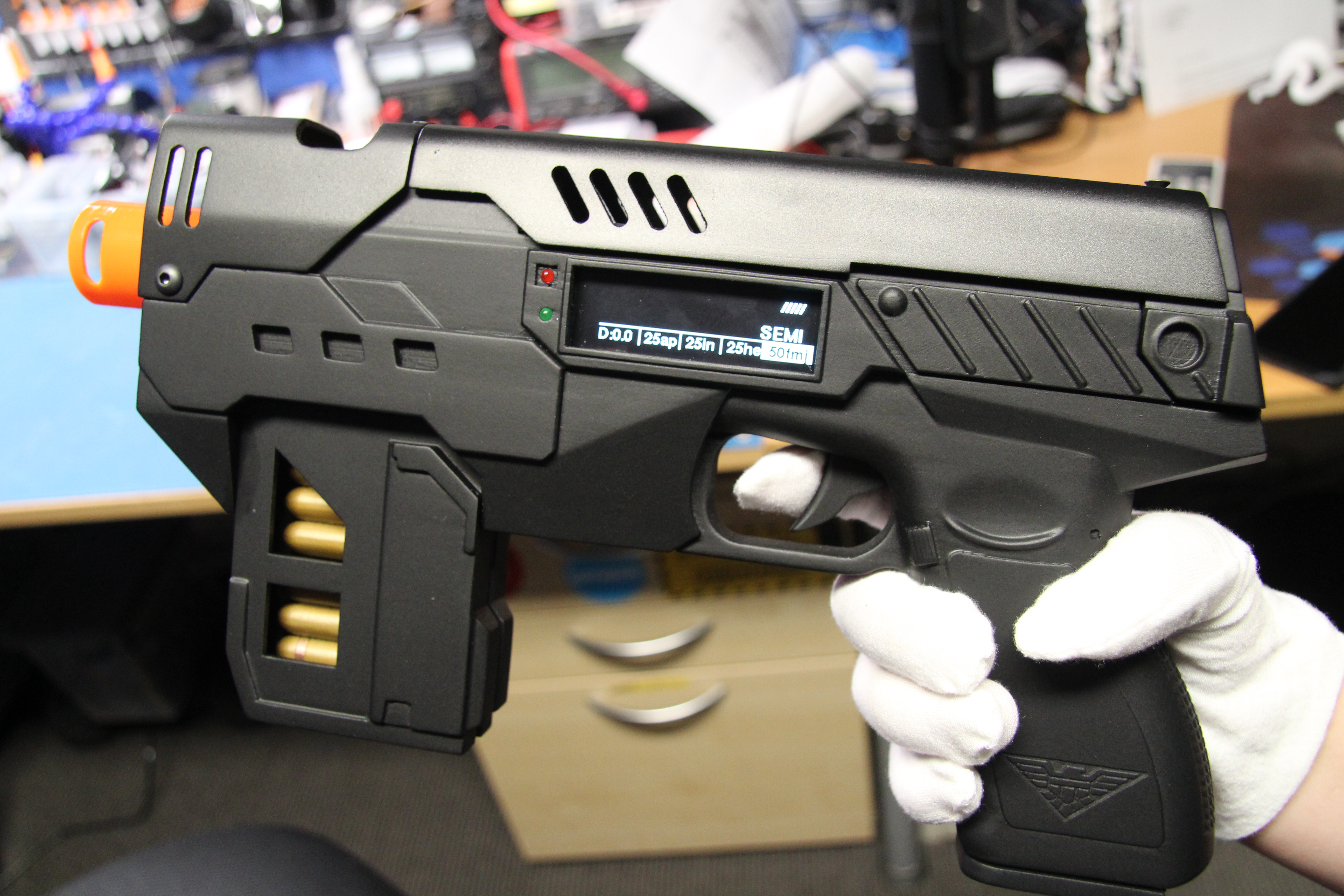

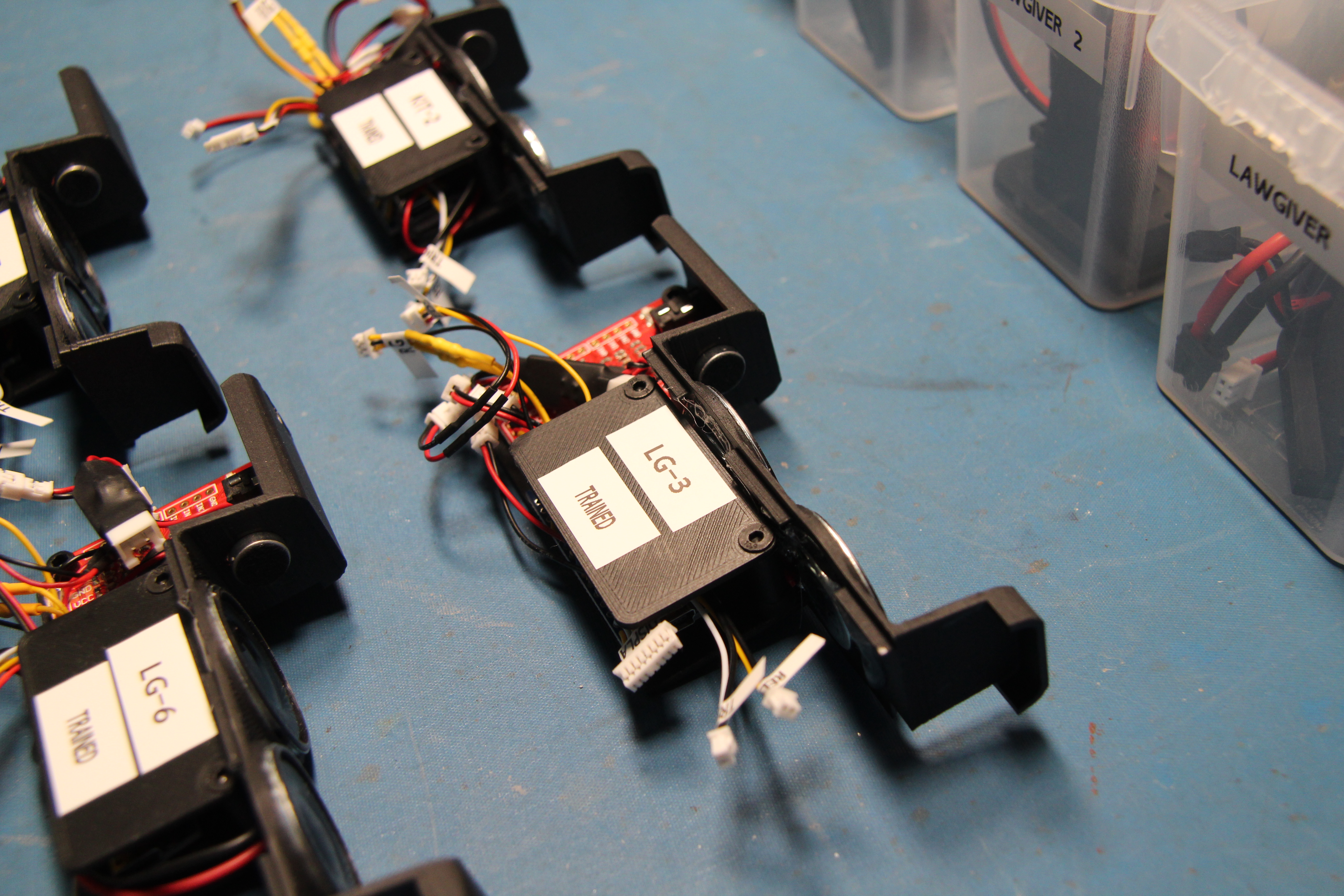

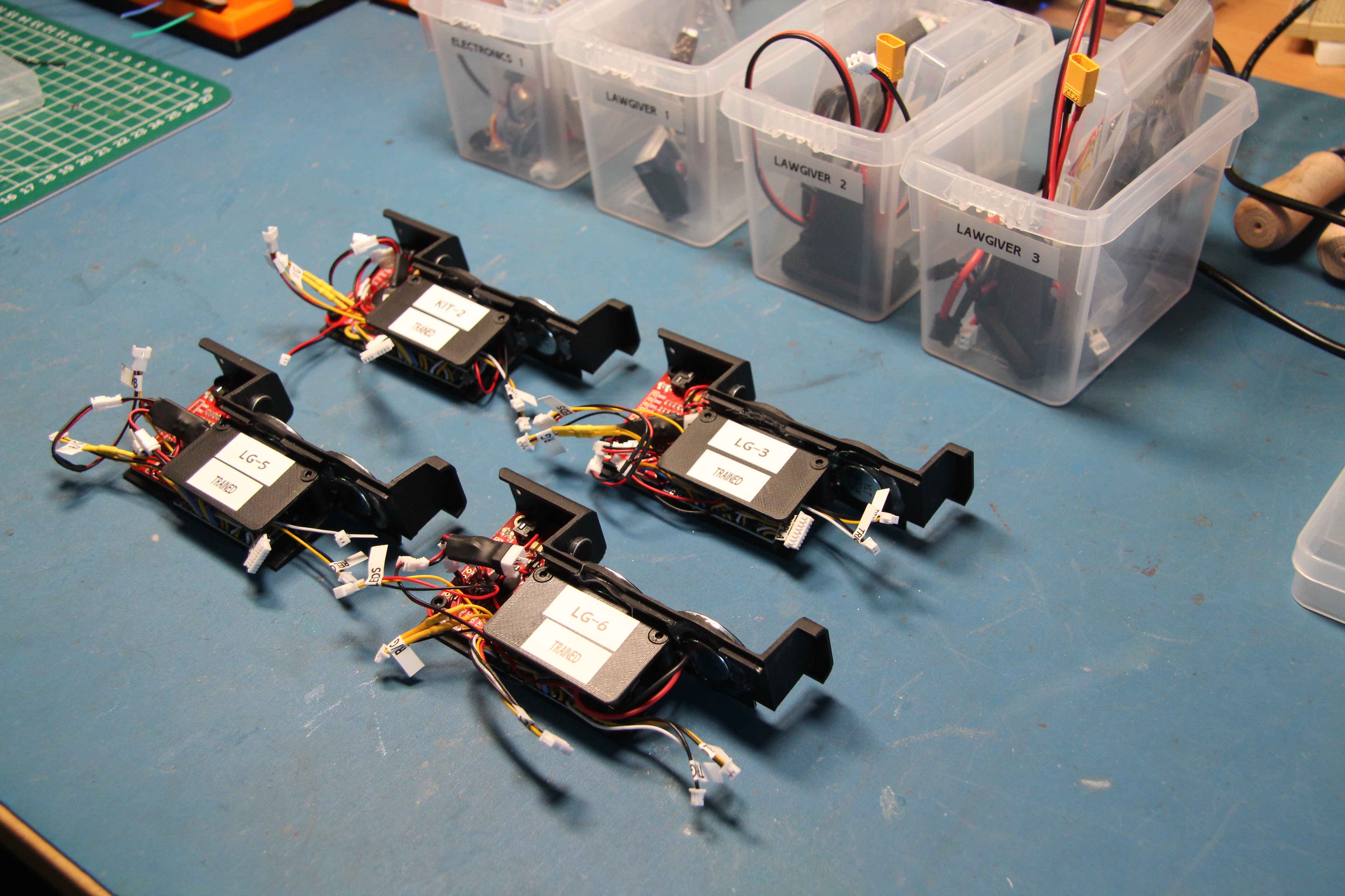

Apologies for being quiet for a bit, but as Chris mentioned, things are all go here at the moment. I'm really close to having all three of my Lawgivers complete, and am just waiting on the Chris' package to arrive (snigger), hopefully this week, so I can finish them off. My electronics are done and one of the kits for a UK buyer too.
My electronics packages are complete
Tidy

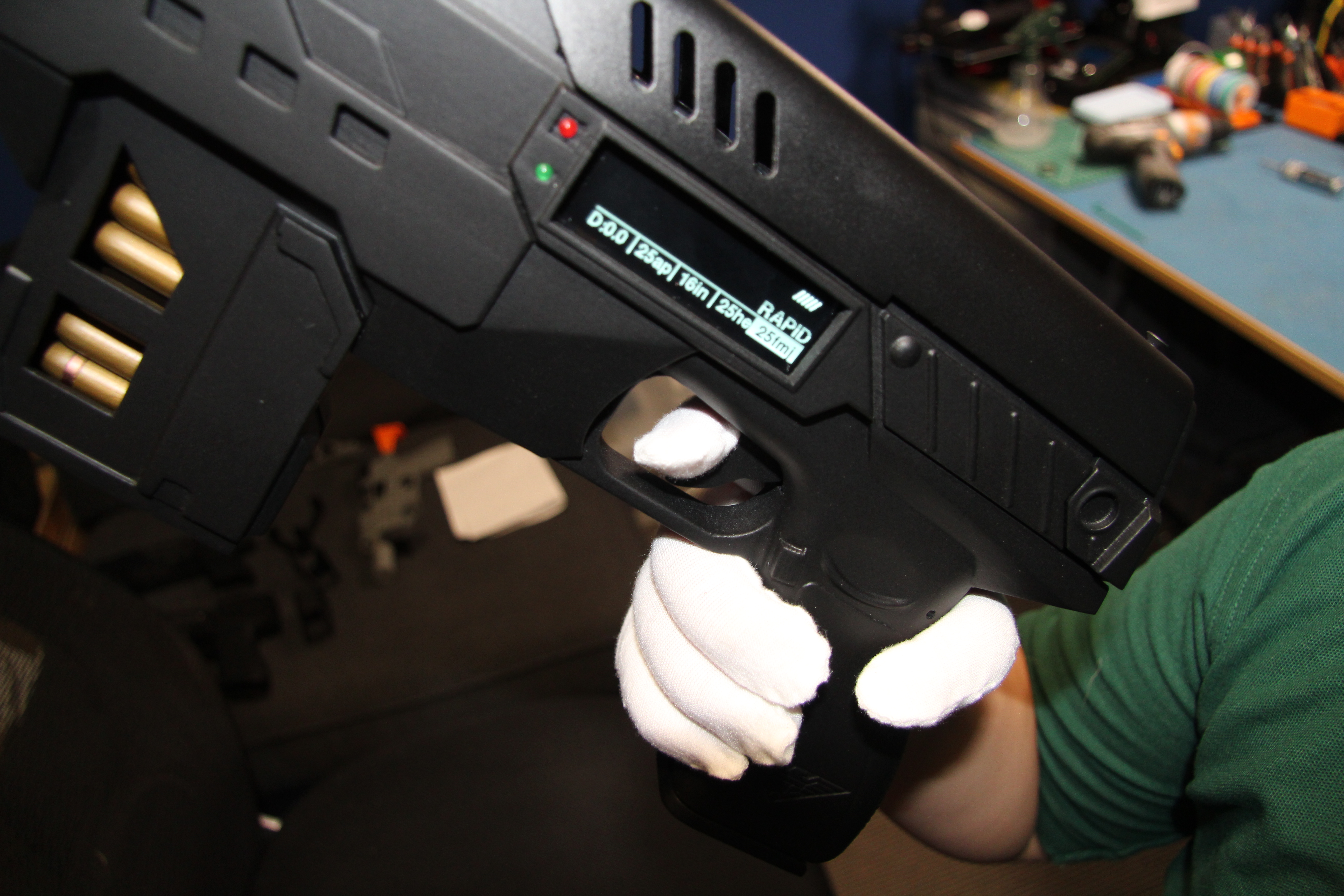

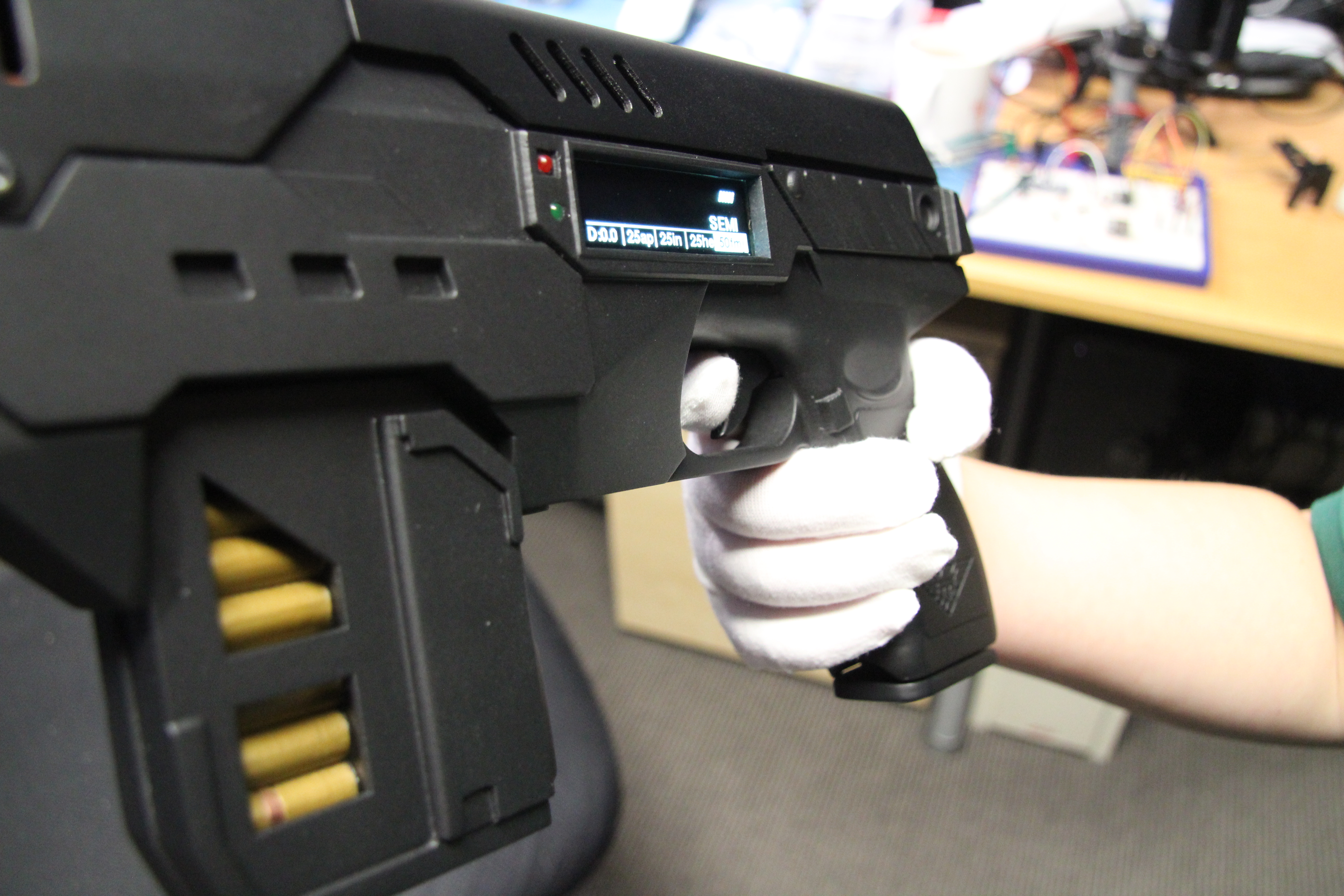

Each one of the Voice Recognition boards has been trained with my voice, so make sure you do your best non-descript British accent when trying to use them! I broke out the big boy camera to take some better pictures than with my Google Pixel, but just discovered that the auto-focus doesn't work properly now. So I enlisted the help of my little assistant to hold the first (mostly) complete Lawgiver.
Pew pew

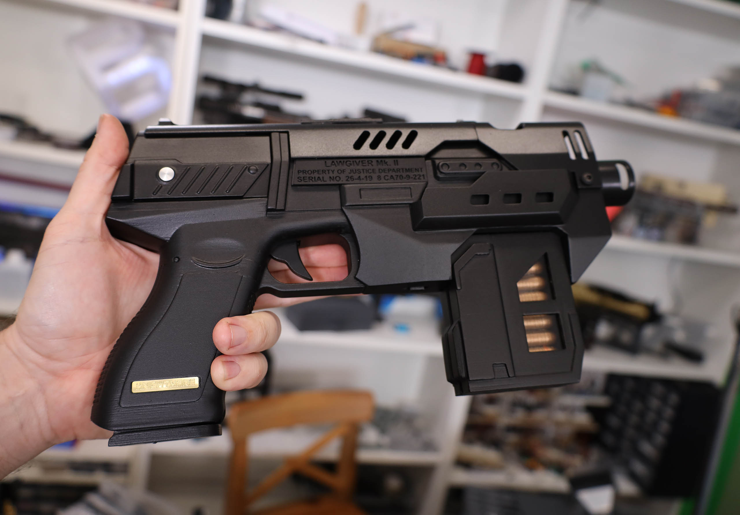

Looks odd without the sights
The top rear cover for the Lawgivers haven't been clear coated yet, I'm waiting on the middle sights so I can do them all as one batch. There are also the clear plastic windows to go inside the magazine to be inserted.

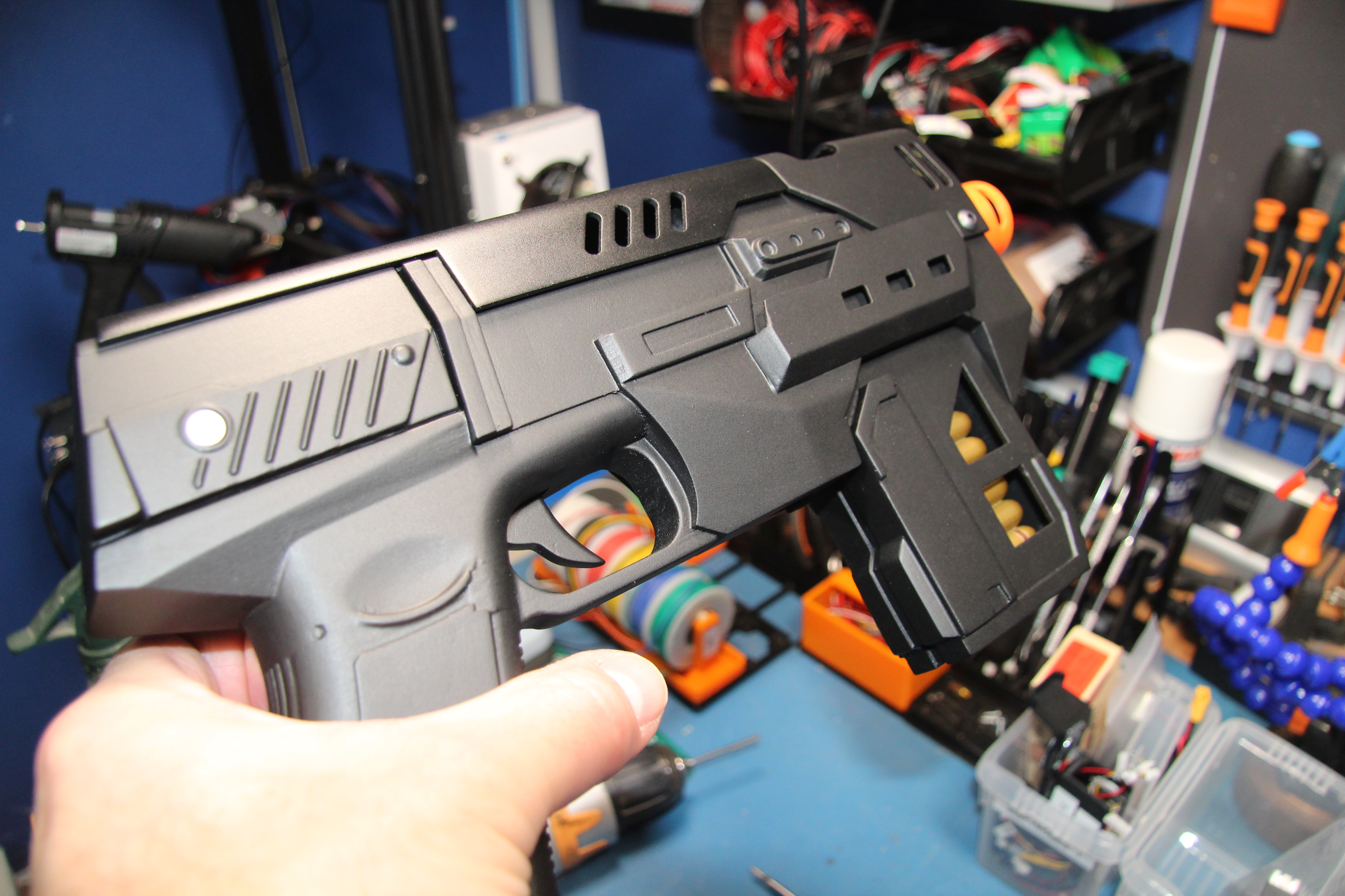

Focus you ...
And one of the other side
So that's me for tonight. Once I have all the brass, serial numbers, sights and magazine inserts from Chris, I'll take some glamour shots (with a lens that focuses properly). I'll then have the boxes and inserts for packaging everything up to send off in the next week or so (depending on deliveries).
Stay awesome,
BeakZ

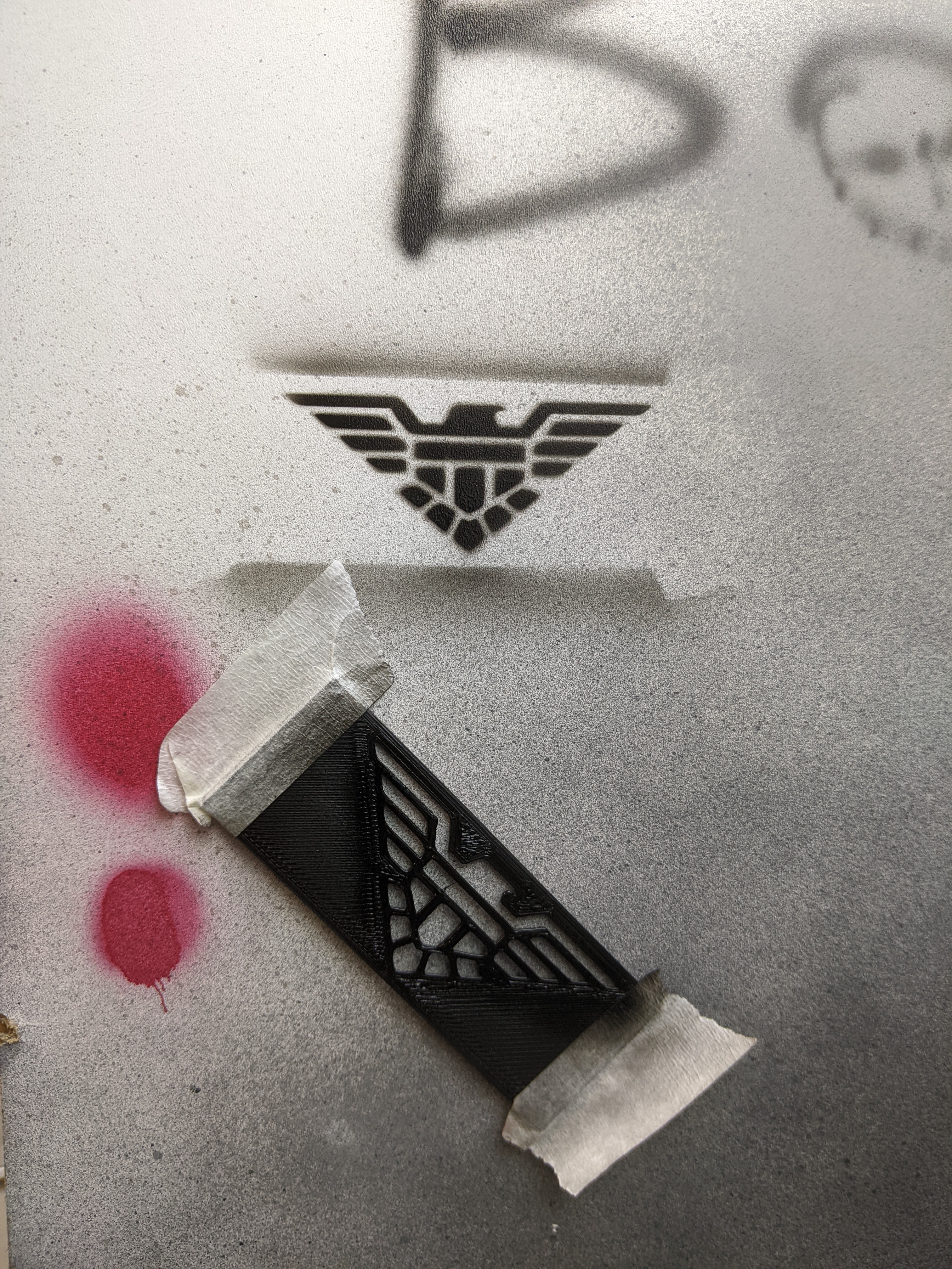

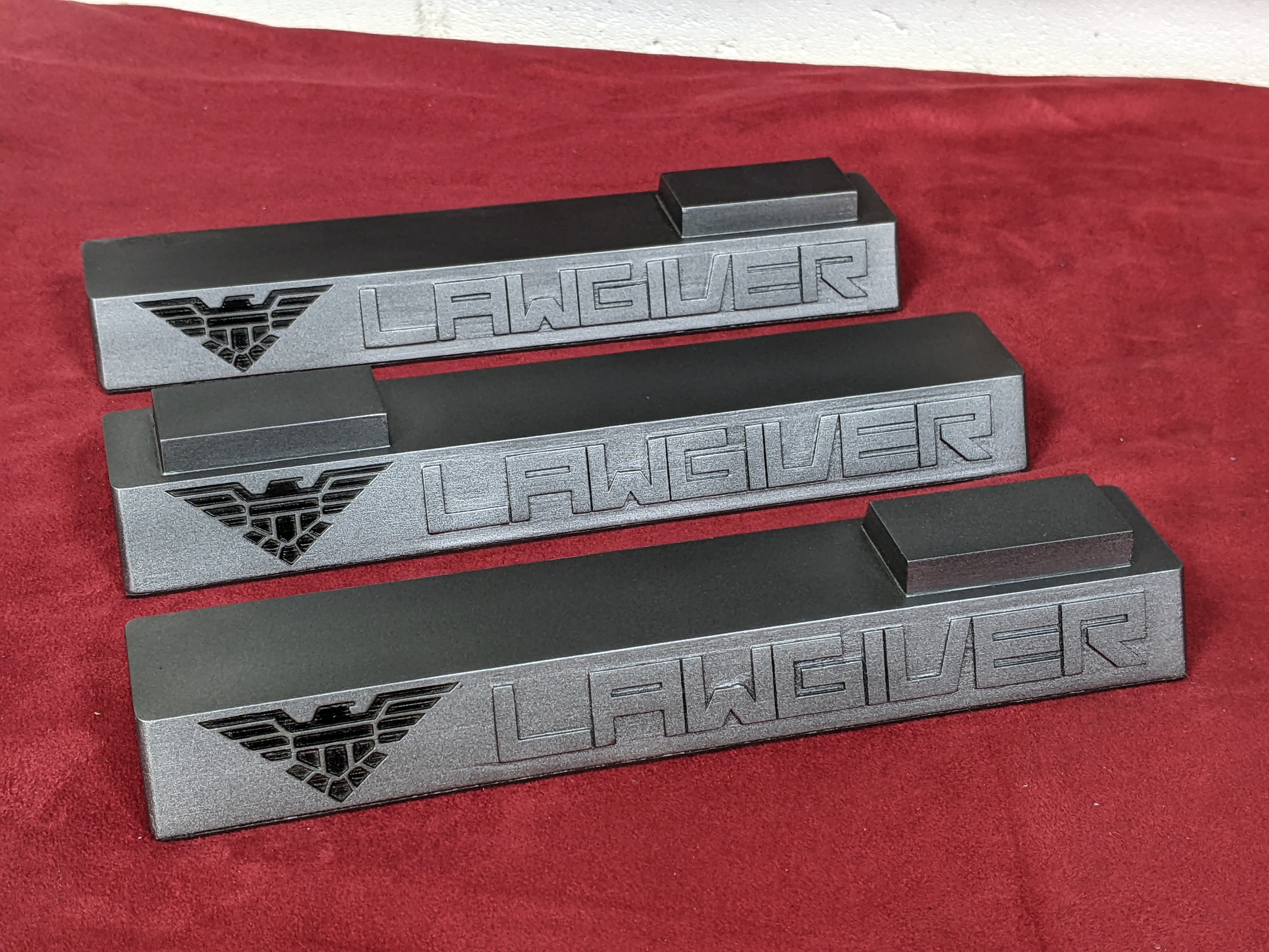

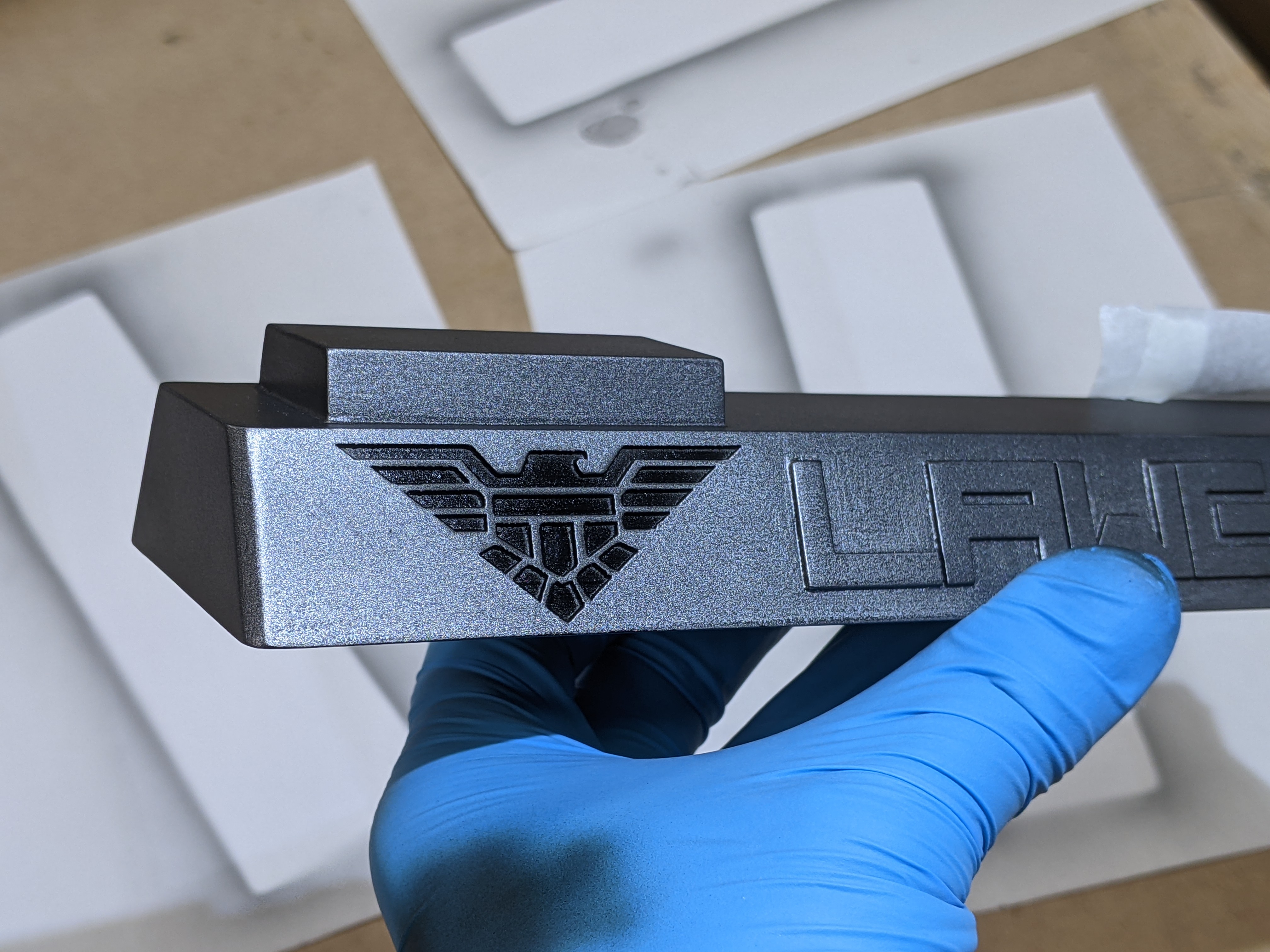

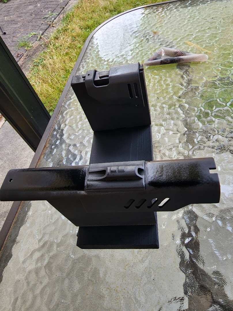

Just a quick little picture update for you. I've finished the stands for my Lawgivers now. I hope you like 'em.

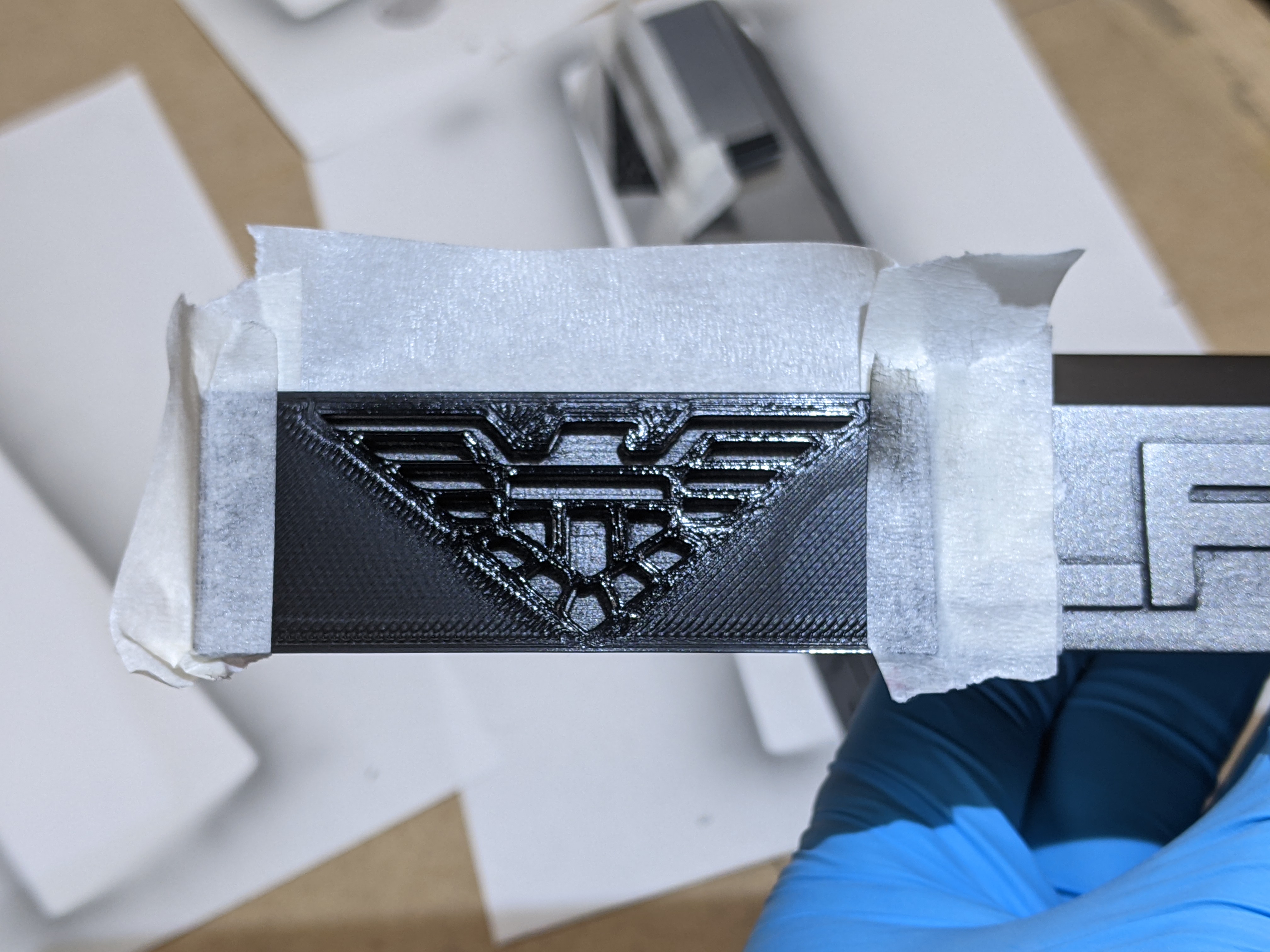

3D printed a little stencil to make it easy to airbrush the relief
Does an awesome job
3 finished stands
A fun little stencil to paint whatever
That's all you get for tonight :)

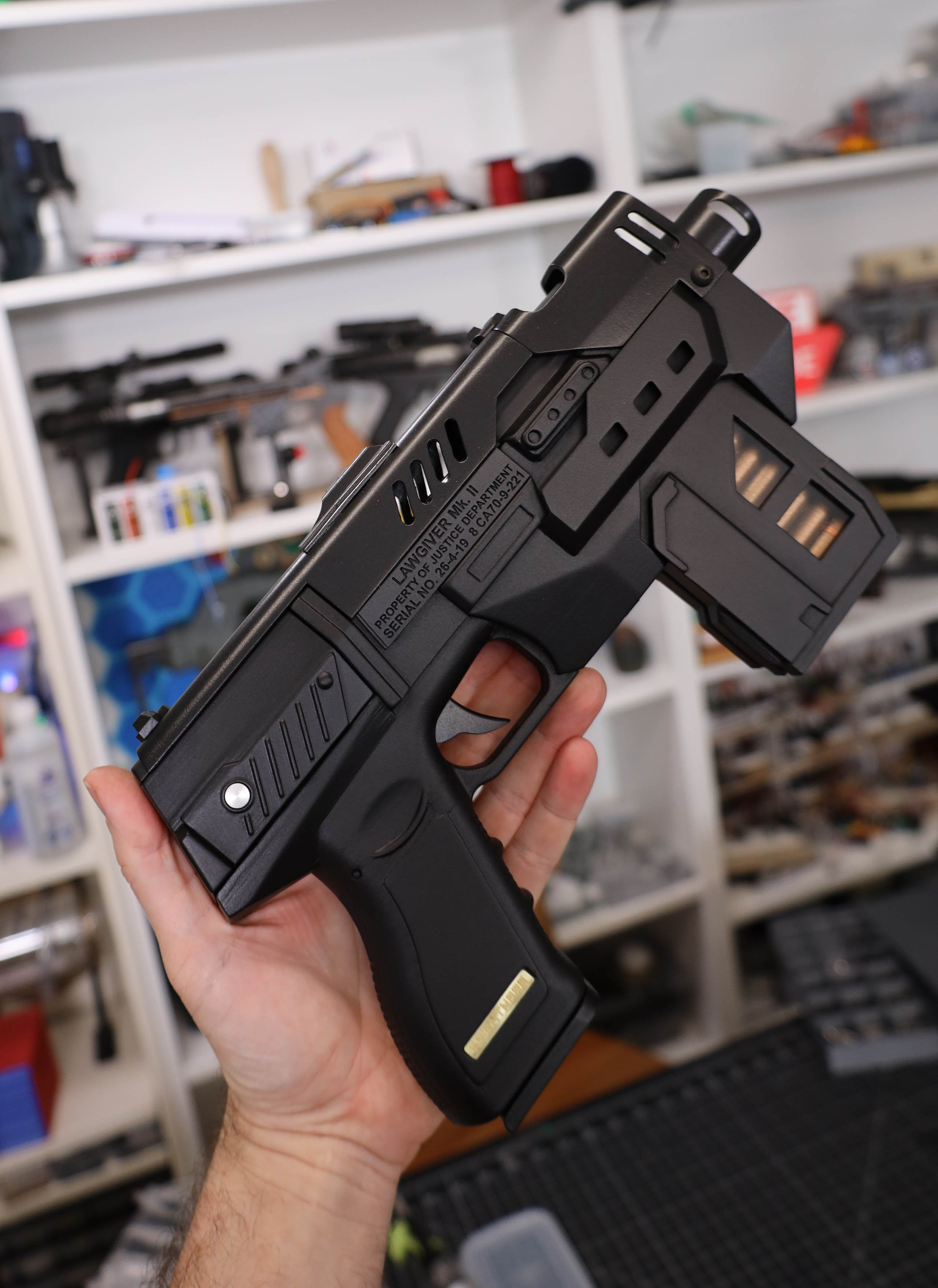

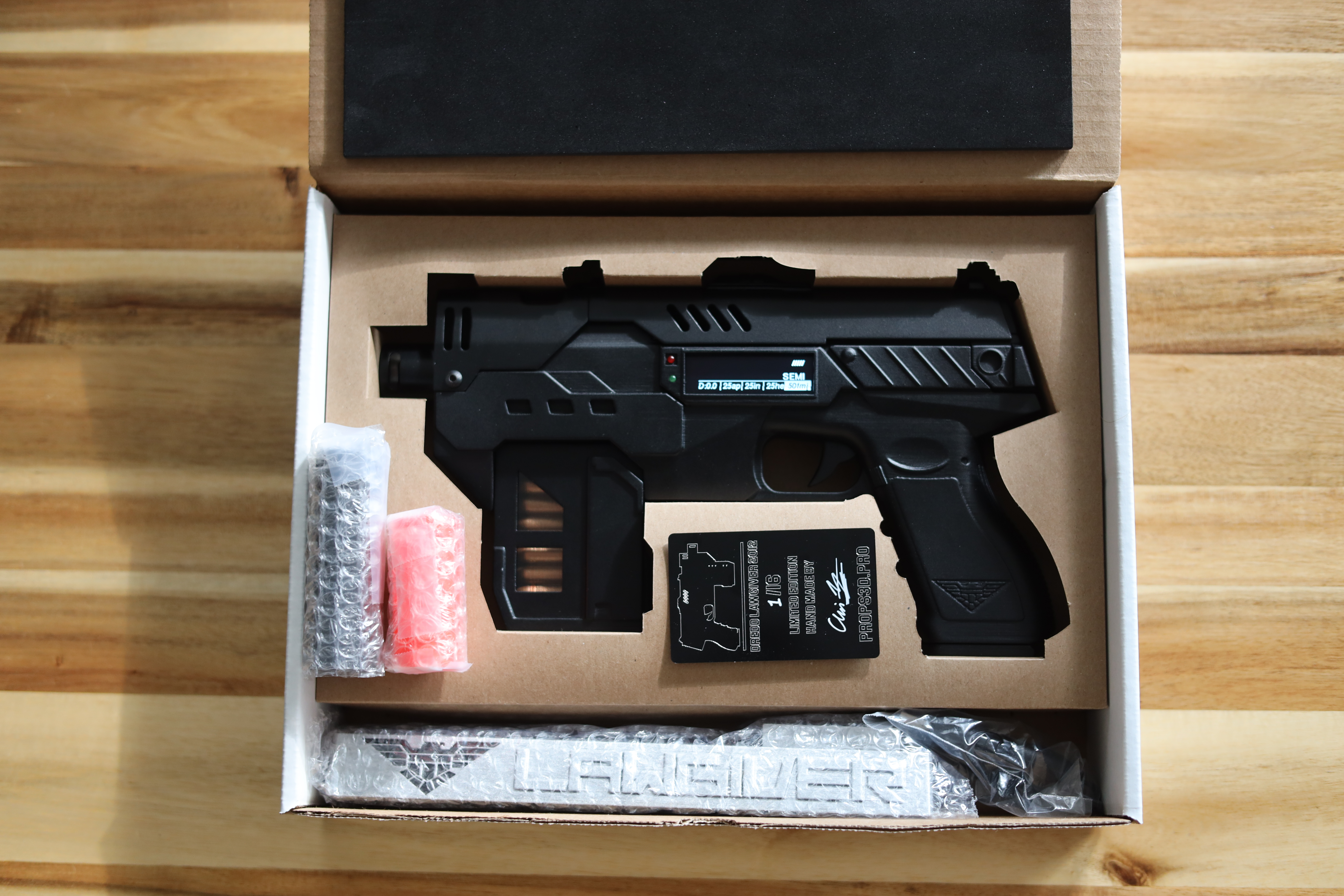

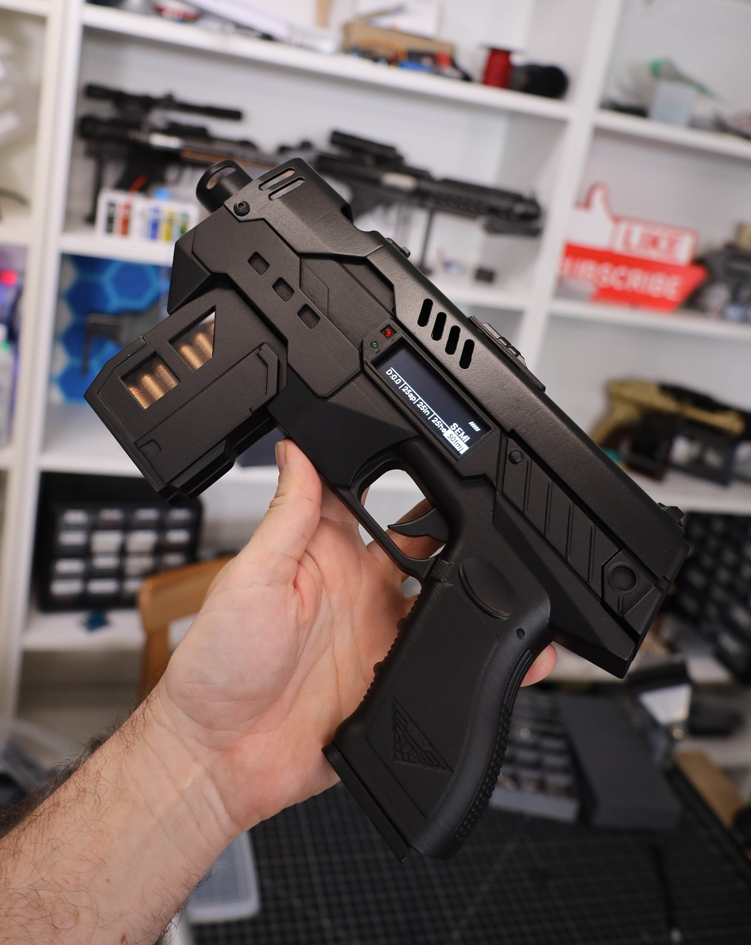

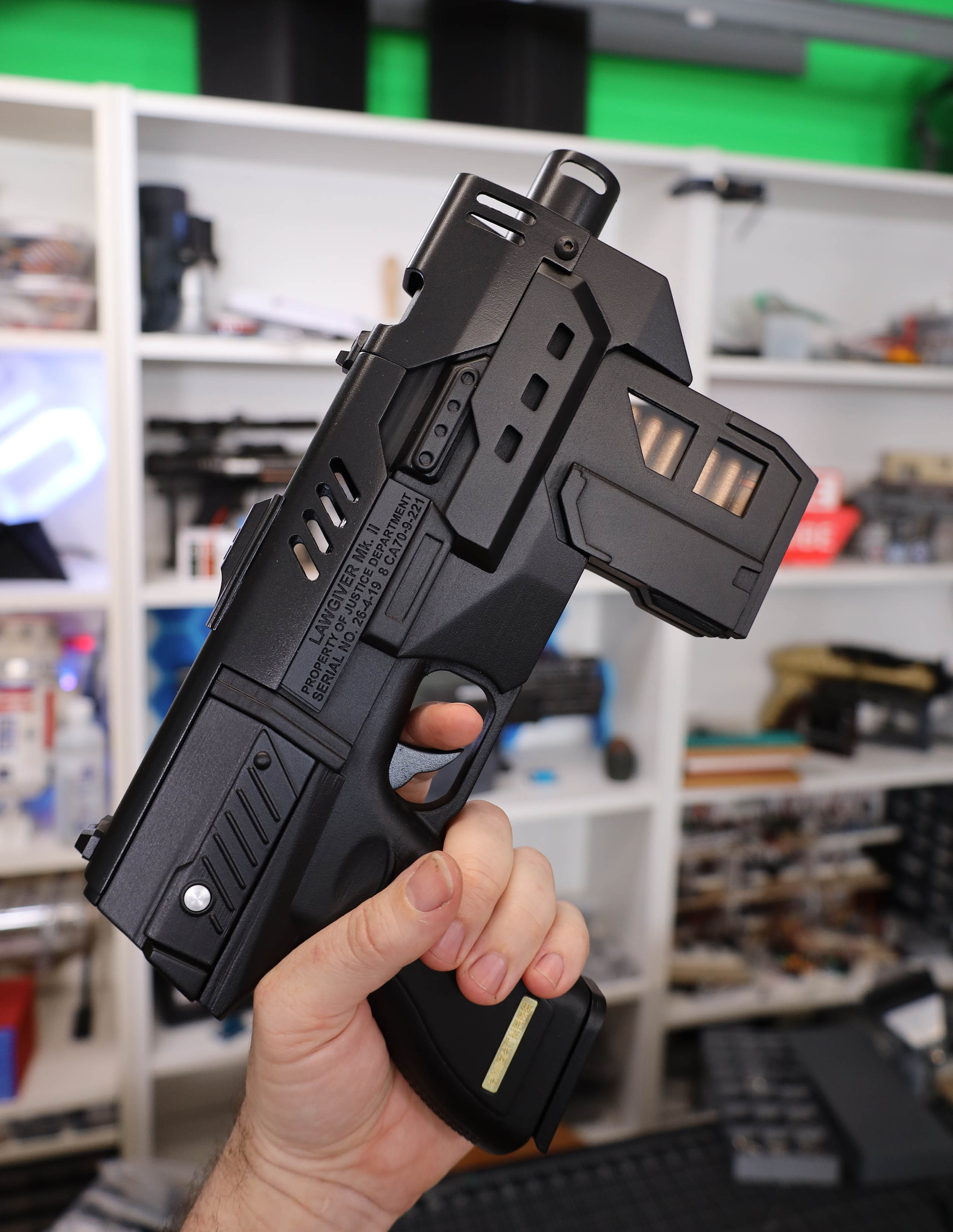

Knightmare Ready to ship!
Battery comes charged, I'll make a tutorial soon on swapping the barrel and servicing but for now if you can limit it to playing with it and charging that would be awesome, there's a lot of parts crammed under the hood! You can hit me up on Discord or DM me here if you have any questions.
----side note but applies to this-----
I had an inspiration last week on the VR. I was training my AI R2 last week with my cohort in Australia and we were having issues with object detection reliability: The more accurate we made the training and testing set, the lower the recognition %. I ended up making a new training set with WORSE images in a spread and it immediately went from like 6% to 90%:
So I tried the same trick with the voice recognition on the Lawgiver, I'm recording slightly off in 2 directions and the hit rate went to almost 100%. It will false trigger sometimes now but to be honest I'd rather have a few false triggers than yell at it all day while it mocks me in silence. I will make a tutorial on training it soon so you can choose what works best for you. I have a lot of filming to do, but not until a few more are shipped at least.
