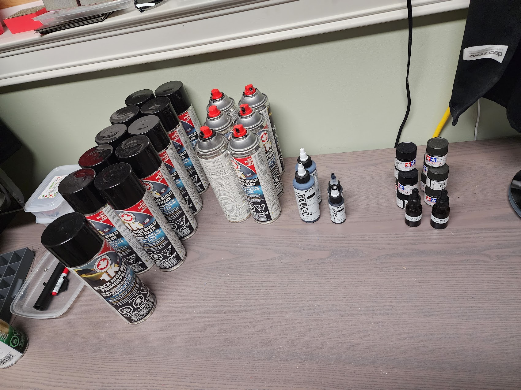

Airbrush paint and primer are things I usually buy just as much as I need but they just instantly vanished from the market. After some calling around the nearest place that had primer was a 14hr drive but I managed have them order it in closer and snagged the rest of their inventory, and the only place that had the airbush paint was in another country but I got that shipped in too. But dang, inflation is crazy. The primer was 14 dollars a can, now 25, and the airbrush paint cost me double! But I did get enough to cover the run so phew..
(primer cans without tops are already used, middle is airbrush paint for the darker top and metal parts, small bottles on the right are Tamiya for layering)

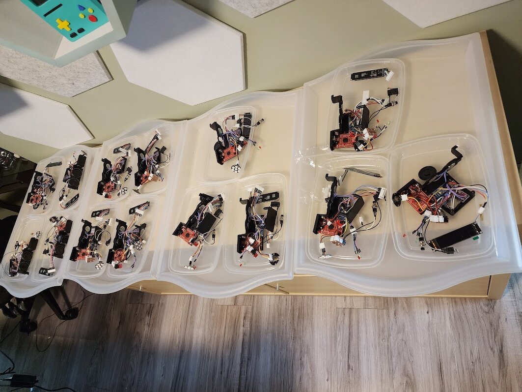

Haven't been idle though, I've been sanding like a fiend and I've soldered the entire run now. So things are trucking along:
(14 kits: 8 for run, 4 for electronics only, 1 for YouTube, 1 backup)

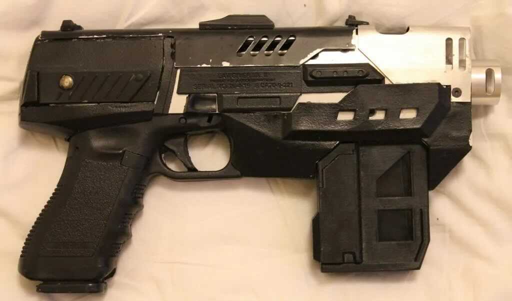

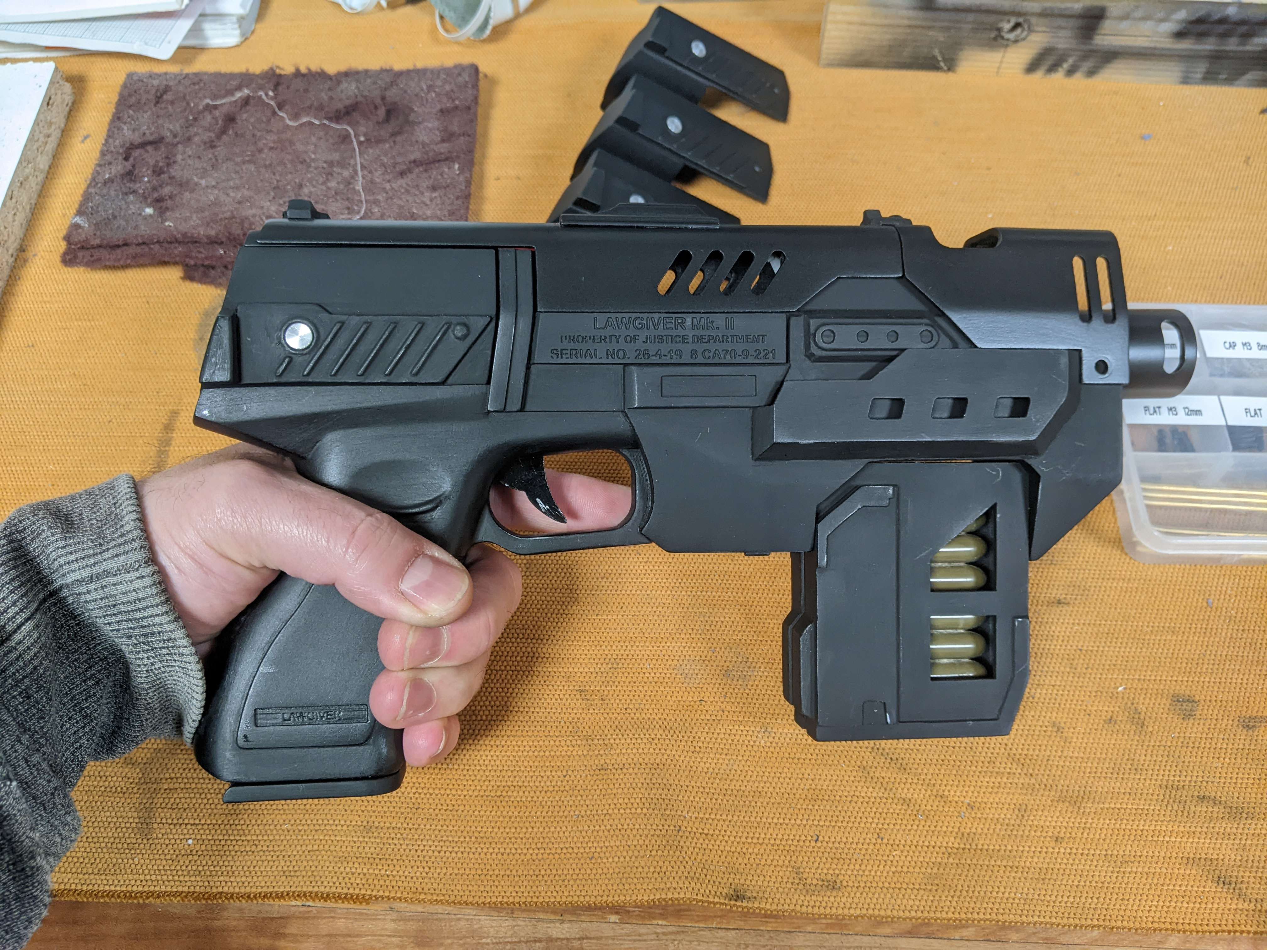

He watched the movie last night and got a bee in his bonnet over this:
Can you see it? There's an exposed metal pin on the slide.
My (probably right) belief that this pin is there for the shots where they're firing blanks to keep the Glock slide and the prop slide from flying apart under force. I mean, there's at least 3~5 variations I found and not all of them had this pin, so it's not really an omission in my books since it was more of a utilitarian thing.
He countered with the fact that he already went ahead and did it on his part of the run so tough luck:
(one in the pic is his test one, the ones for the run you can see behind it on the table)
So I checked with the WIP images Michael VK sent:

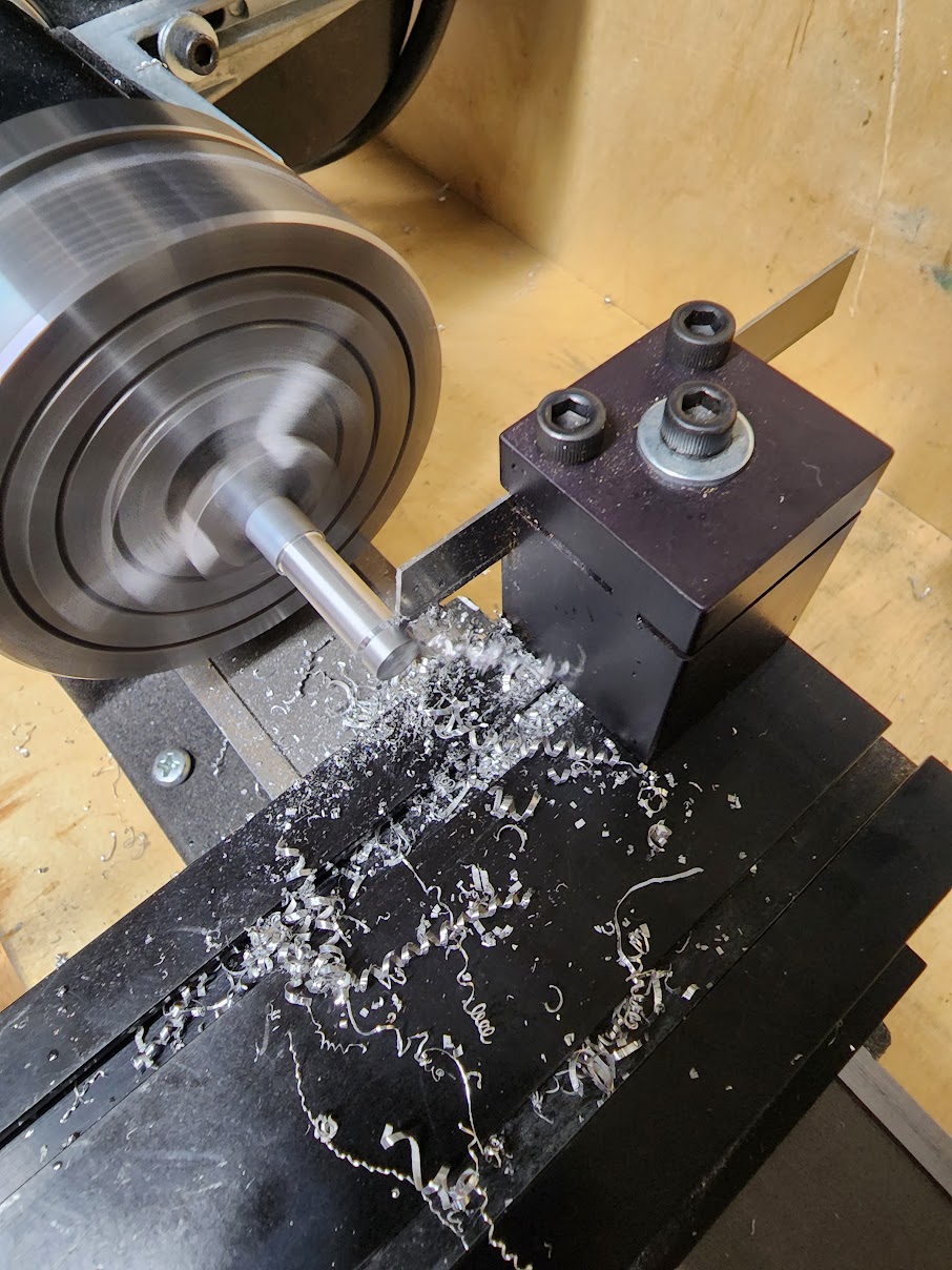

And there it is, sigh. Bar stock ordered, looks like I have some lathe work to do... ;)

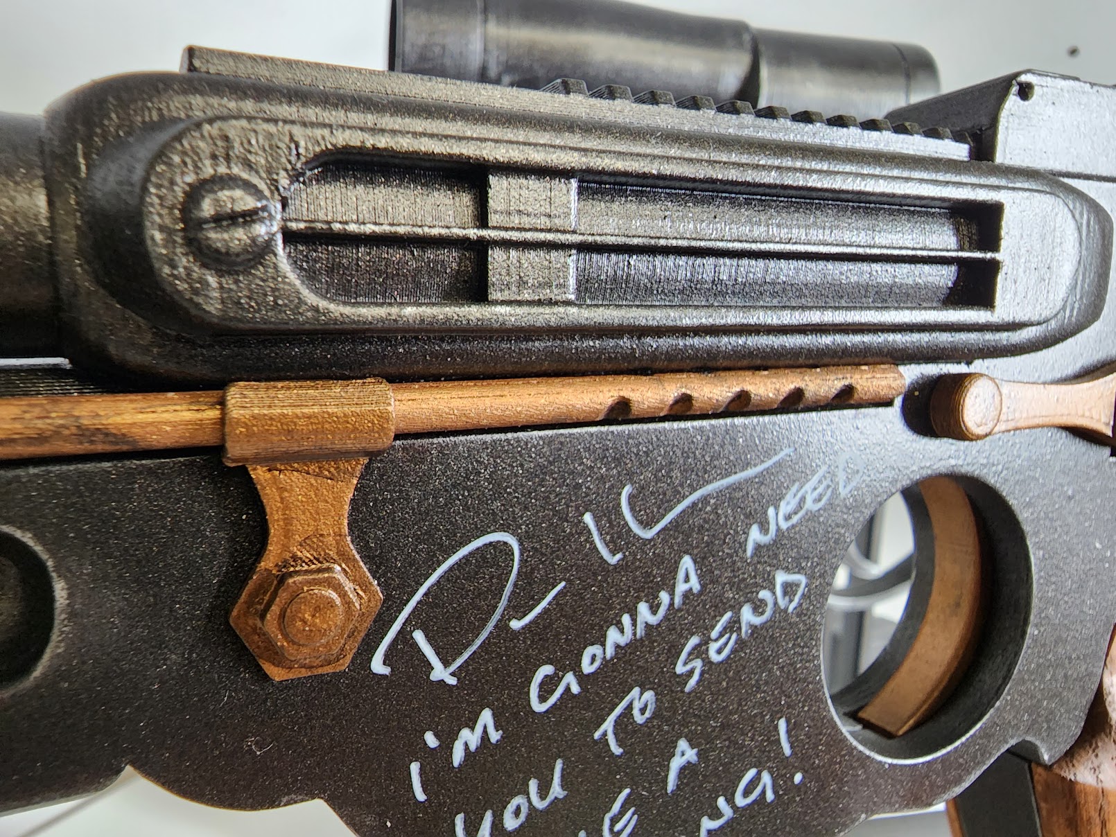

Here's some examples of retail props I still have in stock:

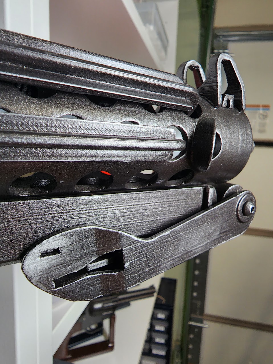

This is a close up of what I consider to be a 'very good' finish. This exact E-11 is featured on Bucketheads. The 501st has also been through this at exhibitions and has highly praised the accuracy and finish, I dare say some have said it's the finest E-11 they've ever seen.
But if you zoom in this close you can clearly see the layer line, print artifacts, etc.
Here's me showing it along with the story:
Same with my upcoming mando baster release (there's a demo if this in the vid above as well):
(Signed by Paul Lee, fellow Canadian and Mando/Boba Fett actor)
Unless you're VERY picky you will not see these defects very well:

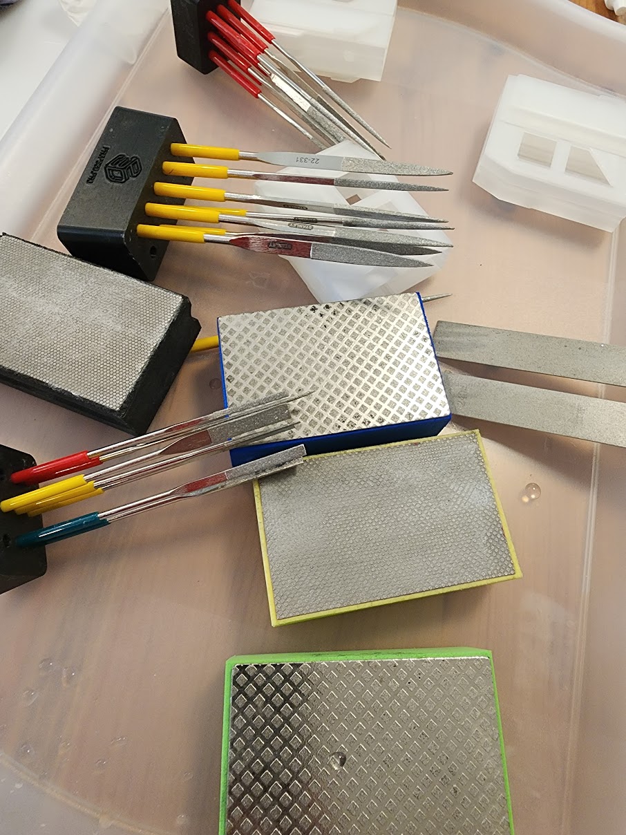

Which has meant a whole slew of extreme finishing tools to both improve quality and cut through this crazy material!

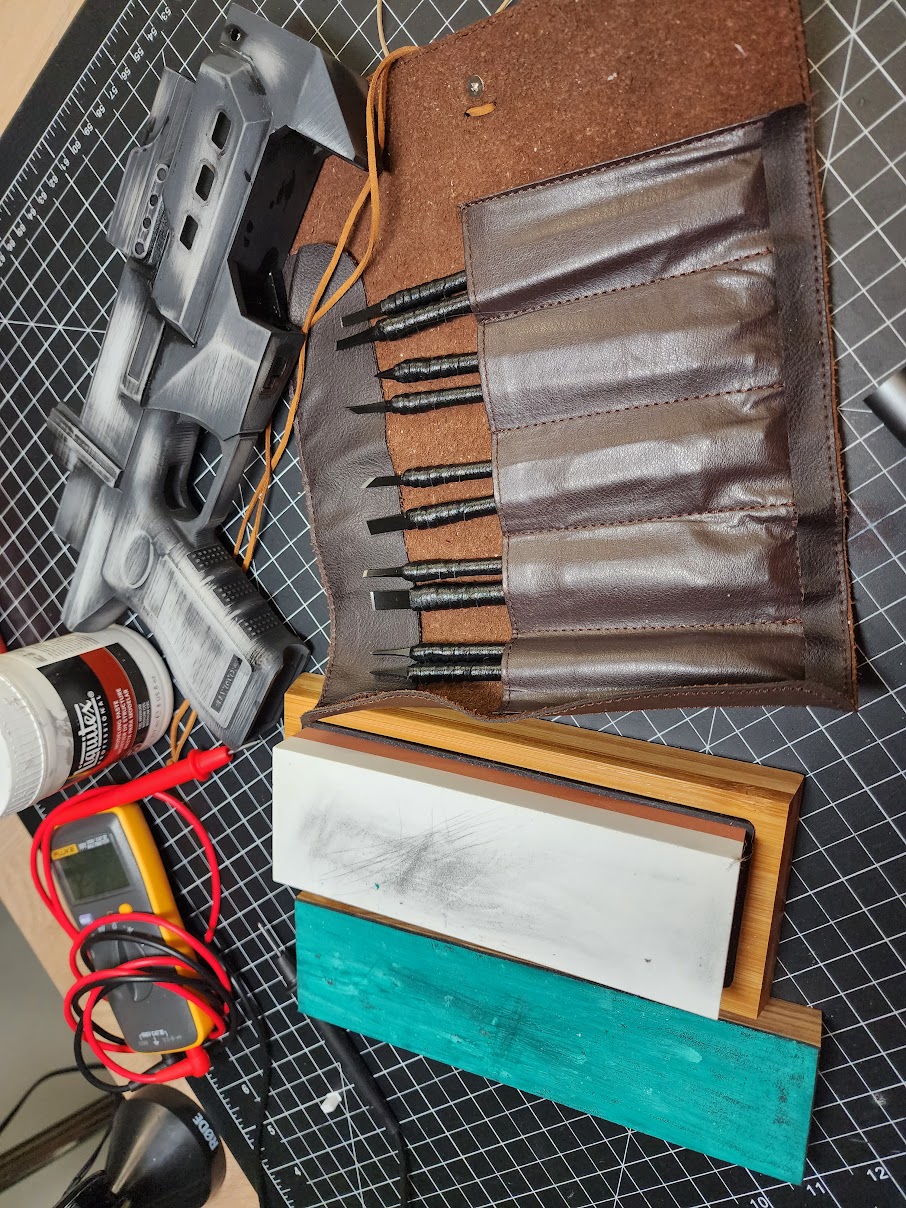

This is an Asian signature stamp making kit, my new secret weapon against layer lines and overhang artifacts. I'm sharpening them with a 6000 grit stone and then stropping, that's what it takes to smooth out these small details on tough PLA.
I got by for years with nothing more than files and sandpaper, and now everything I'm using is diamond coated:
This has added a LOT of scope to the sanding, but the really hard part is out of the way for the entire run now, all the initial sanding and smoothing is done. You'd be shocked how long the details take though.
I was also up last night fabricating the new pins, see the post a few above for details. These 'little additions' take quite a bit of setup and time. They look awesome btw, time well spent.

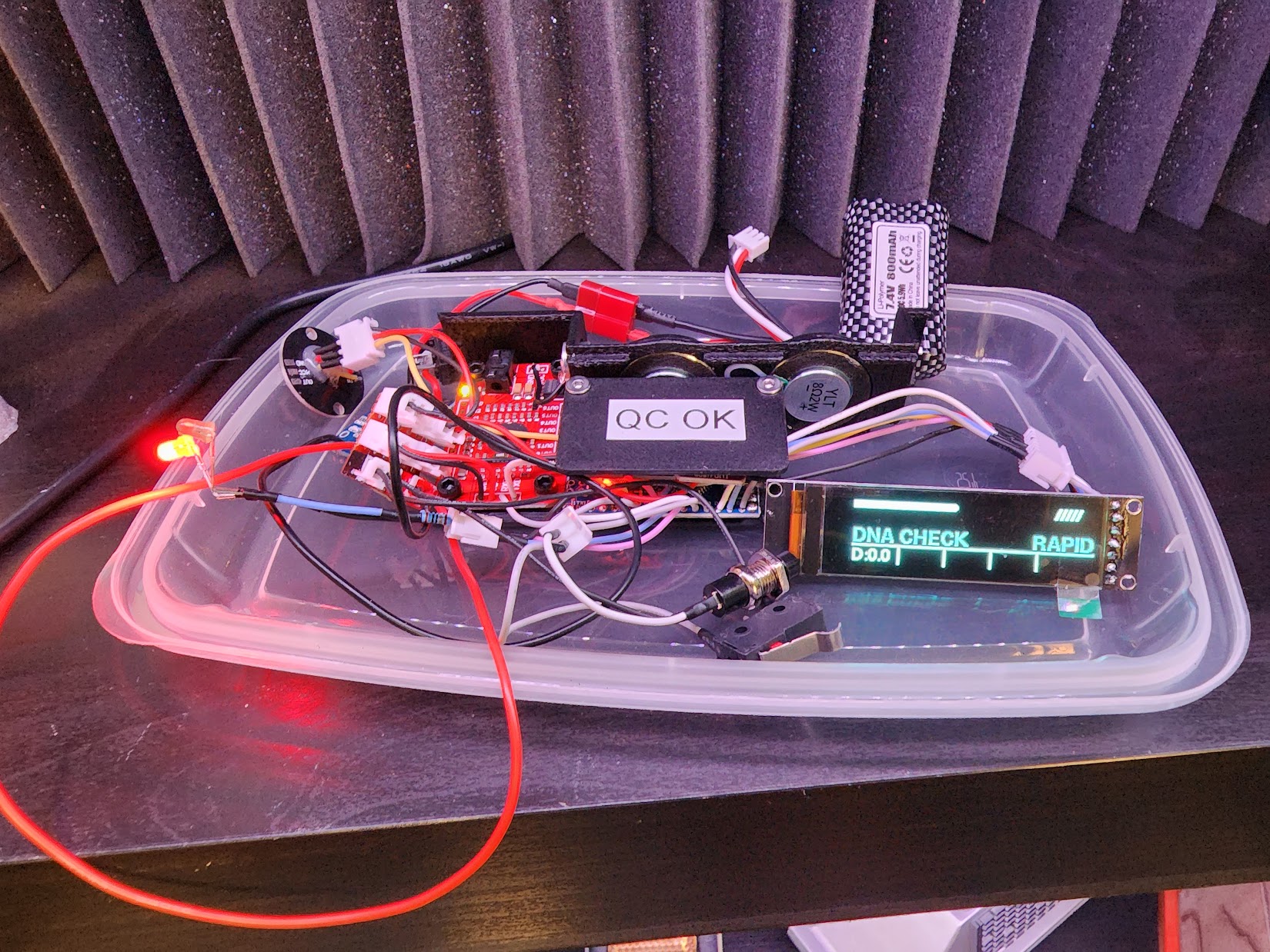

  1. All electronics are done and tested for the run, we're just tweaking the code and audio before shipping the kits and installing into the blasters. It's a real pain to pull them all out for changes so it's better to leave them on the trays for now

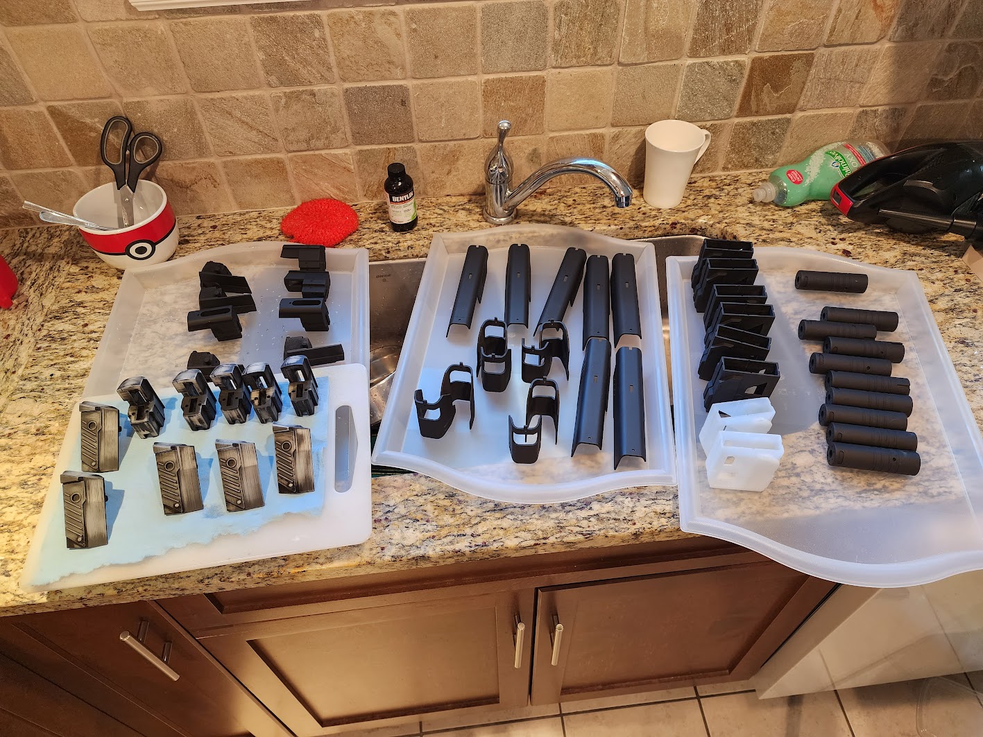

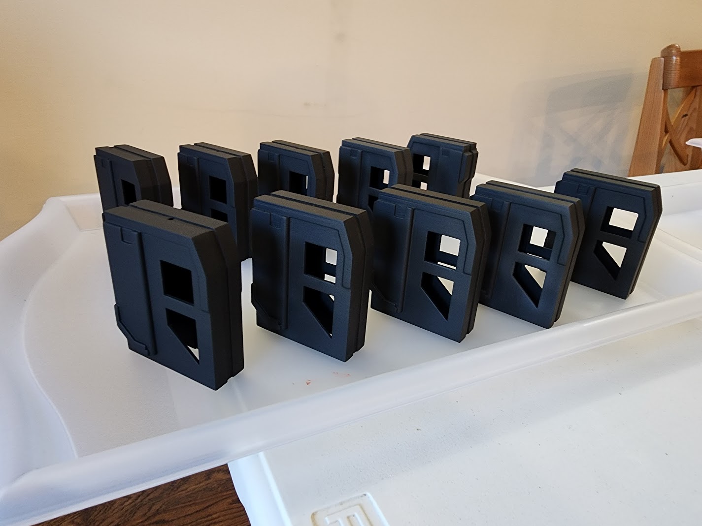

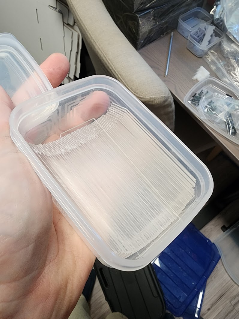

All the magazine plates are done, this was more challenging than it looked. On my first attempt 8/18 were a write off, on my third it was 18/18 (I can fit 18 on an 8X10 sheet of plexi)
How so straight? Cheated again and used a machine, There's still manual scoring and snapping after but it really helps to have a shallow guide. I'll throw a set in each kit, I really got carried away after the failure rate of the first set

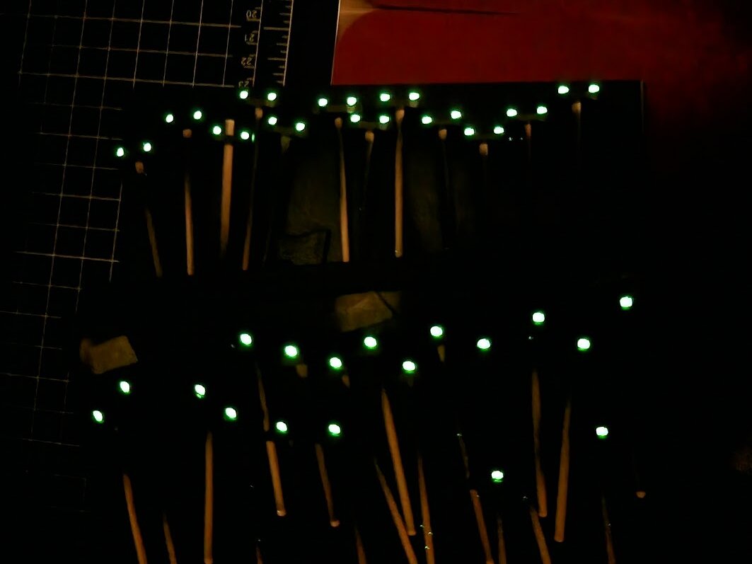

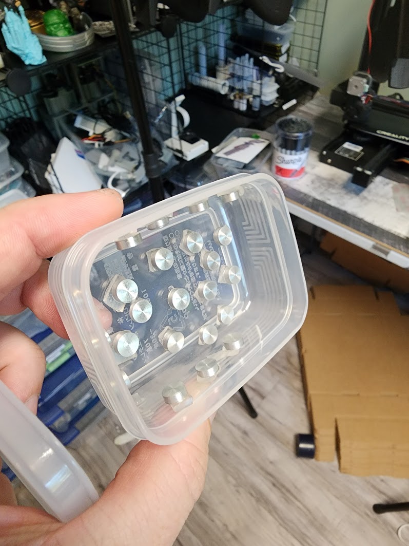

Glow sights? Yes!
Soo satisfying.... still have one more coat to do to get as much in as I can, if I put too much in at once they crack while drying, this is coat 4? 6? dunno..
Those new aluminum pins? All lathed up!

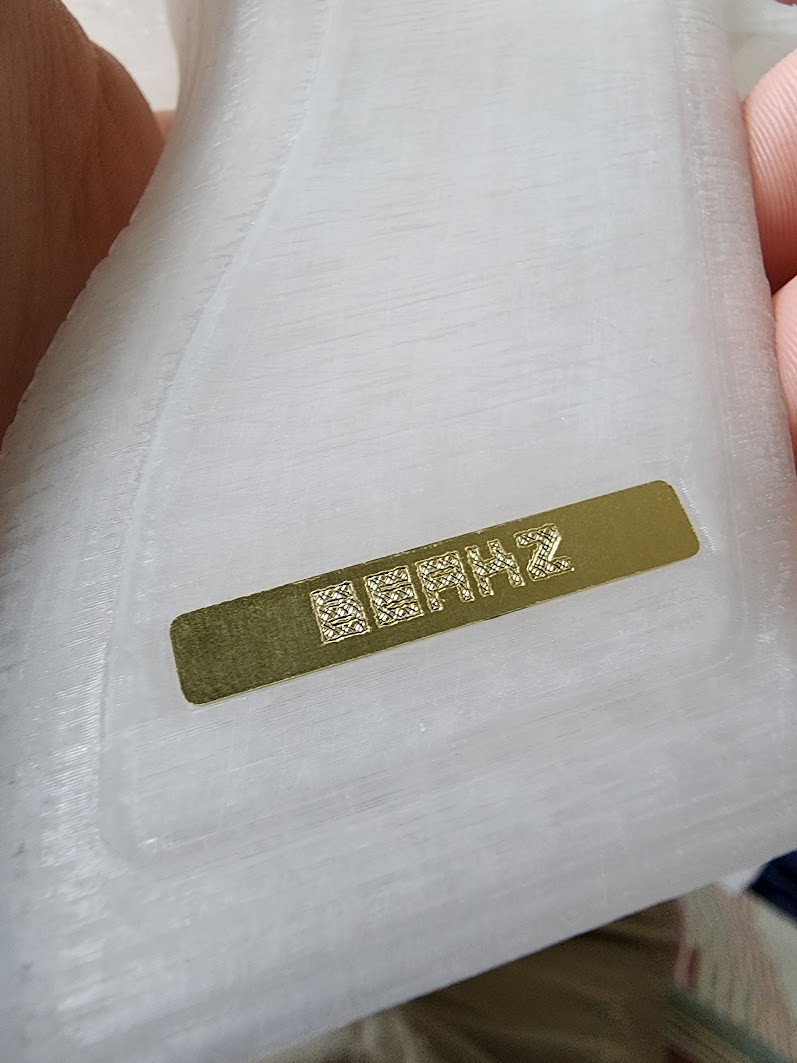

Brass plates? Yup! All done. The fit is so tight I can just press fit and be done with it, they sit perfectly flush. I love math! (well after screwing an entire set up but that's another story) Shown here is the lovely example for BeakZ

Electronics are all in a queue. I was on a call with Spidey74 doing super technical code stuff, well, mostly watching him do it. Hoping he can give his own breakdown later, that's a whole story I don't want to spoil full of hair raising moments involving compiling errors with U8G2, phew. Suffice to say a new build is live on https://github.com/Props3D/dredd-lawgiver as of this message and there's a lot of quality of life improvements, like actually working properly.

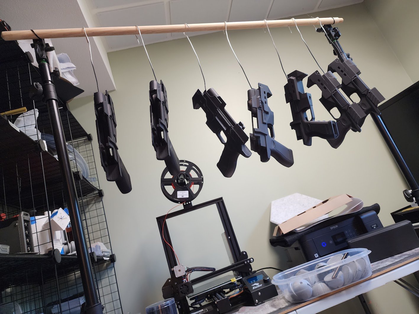

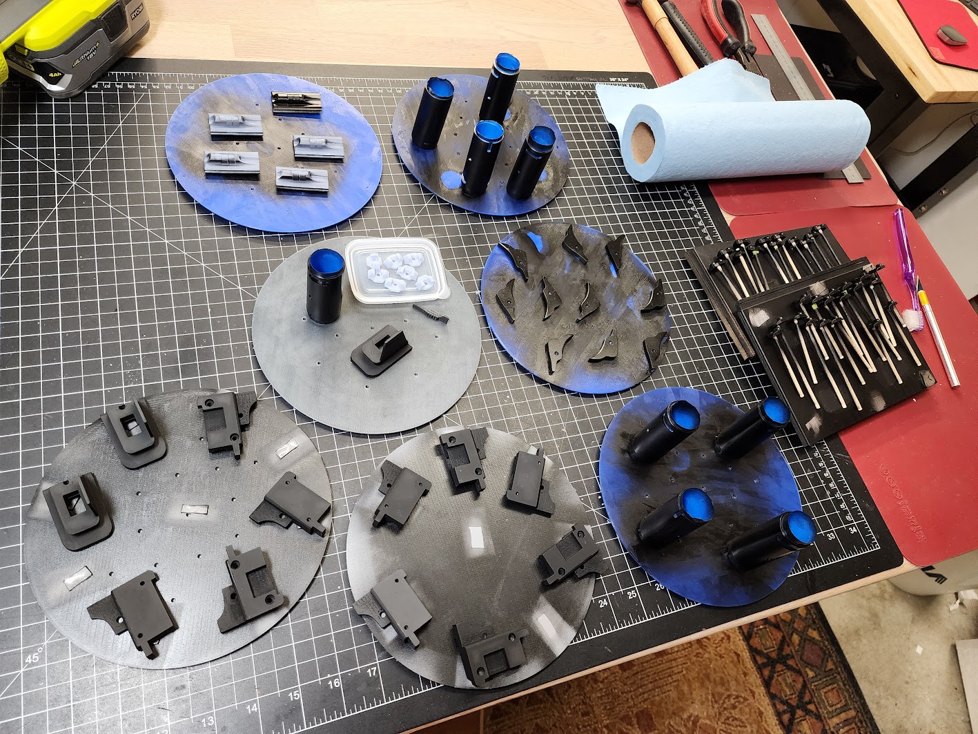

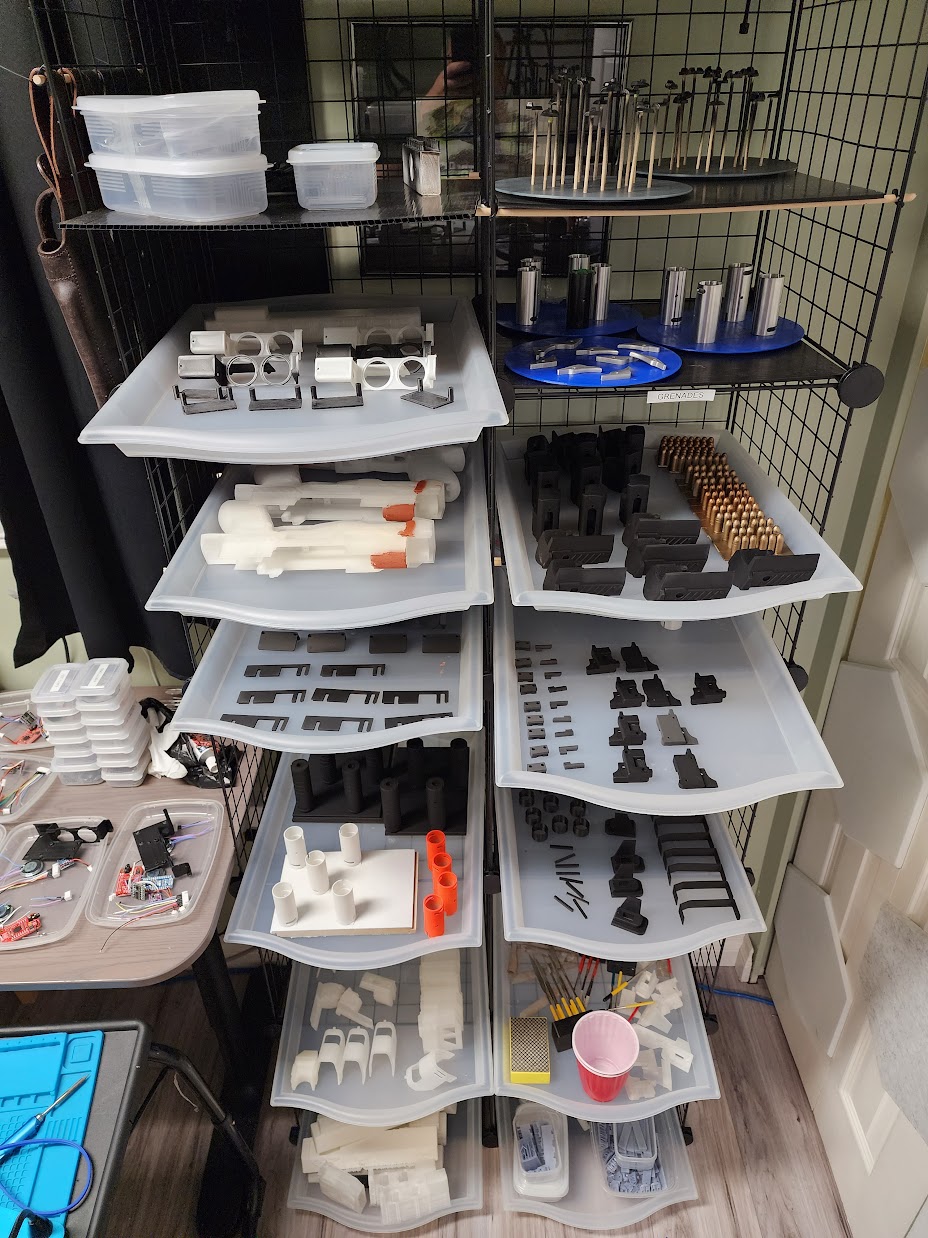

The last week has been primer, primer, primer. Primer hates cold and going into the fall this was always going to be an issue. I usually have to heat the can, heat the prop, and spray close and fast. But thanks to ummm... 2022? when it's usually 5c and raining it's 29c and sunny, I'm still in shorts in a Canada fall! So I've taken advantage of ... this... and been sanding and priming like a fiend.

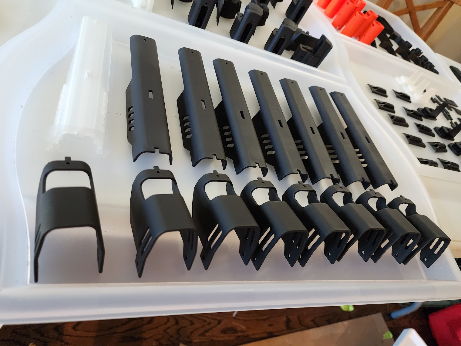

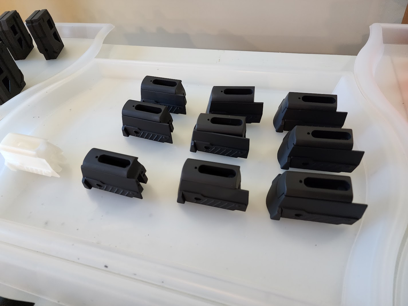

Tops are sanded and primed:
Cocking mechanisms are sanded and primed:
Magazines are sanded and primed:

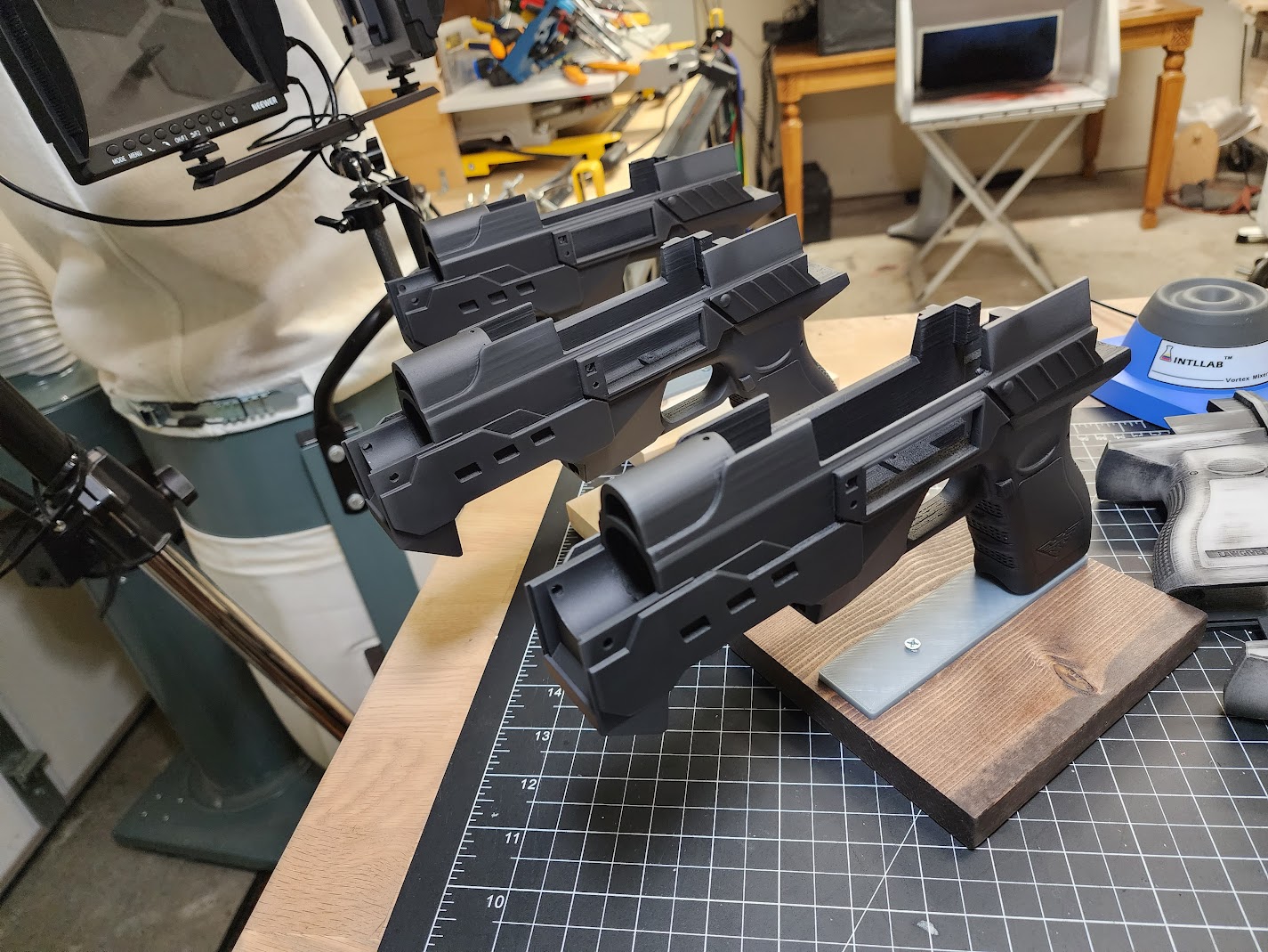

And a just about done 6 frames, which are by FAR the most time consuming part:

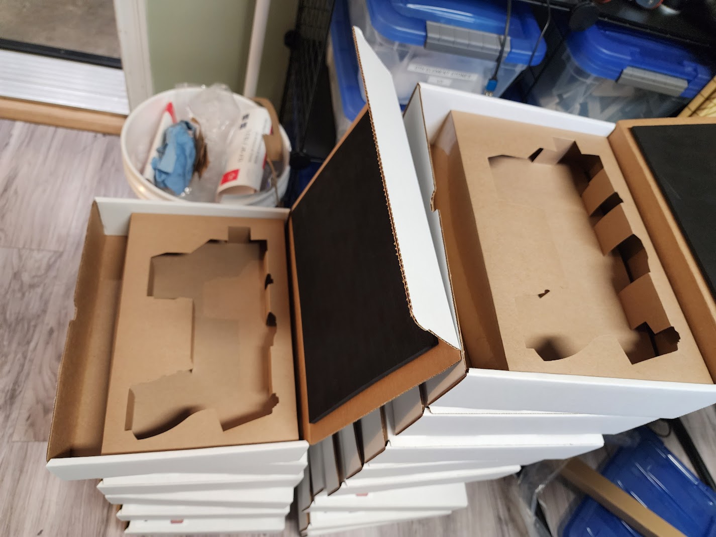

Oh, and I FINALLY got the boxes finished, what an ordeal:
Each one needed 3 CNC jobs with 2 tool changes each, then all carefully assembled and taped, they took about an hour each! And yes, this seems silly, but at the same time a lot of this run for me is 'the art of the possible'. So while past and future props from me were, and probably will be, just bubble wrapped, I love how these turned out!
