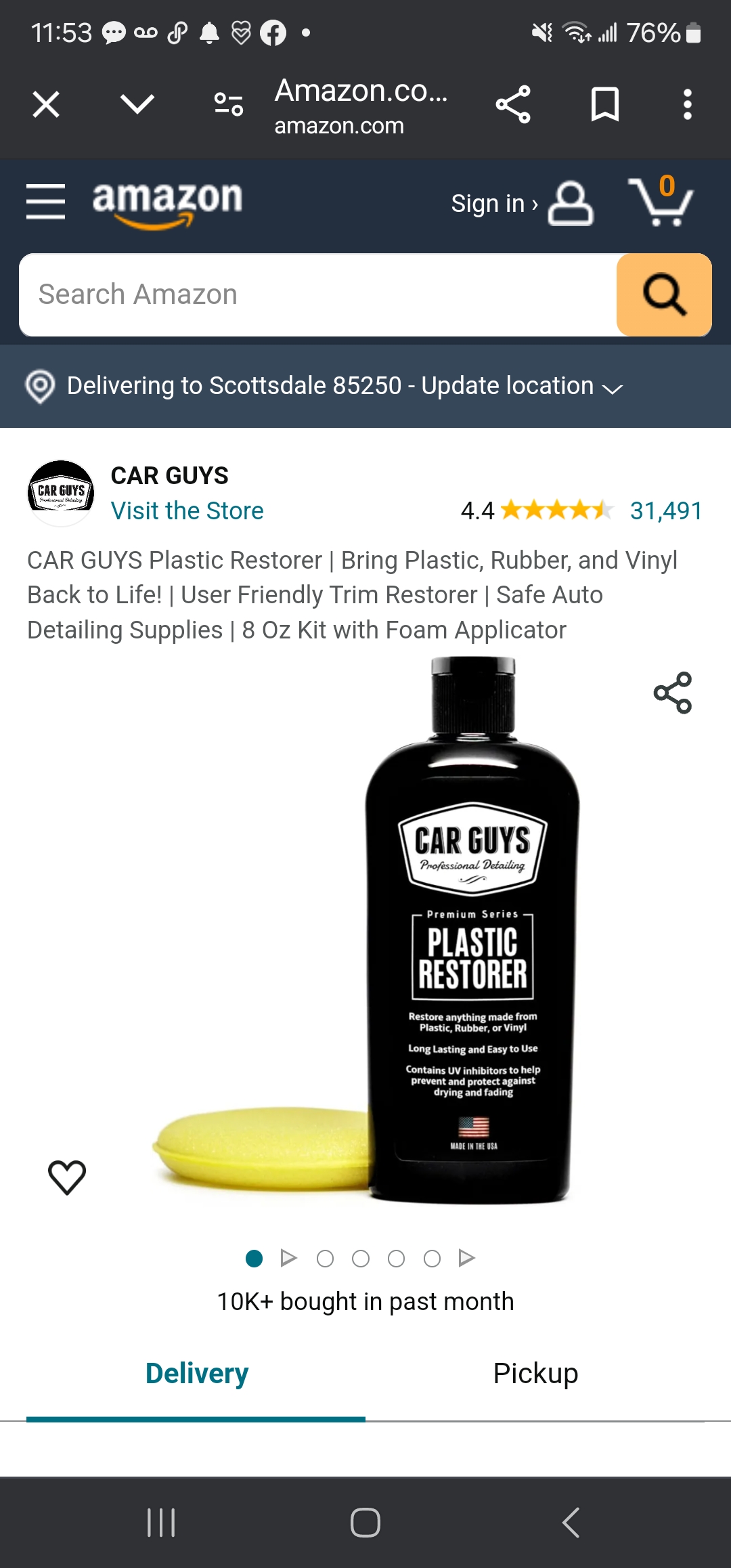

Not sure if anyone read my post on my finished hilt, but I used Car guys blackening cream with various grades fine grit sandpaper to bring that beautiful dark satin finish
Do you mind posting a link to the blackening cream you used? I was having trouble finding which product it would be.
I found your post on the other thread and the hilt looks great.
Here's the stuff
