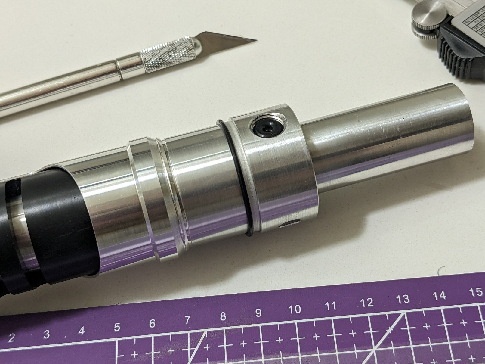

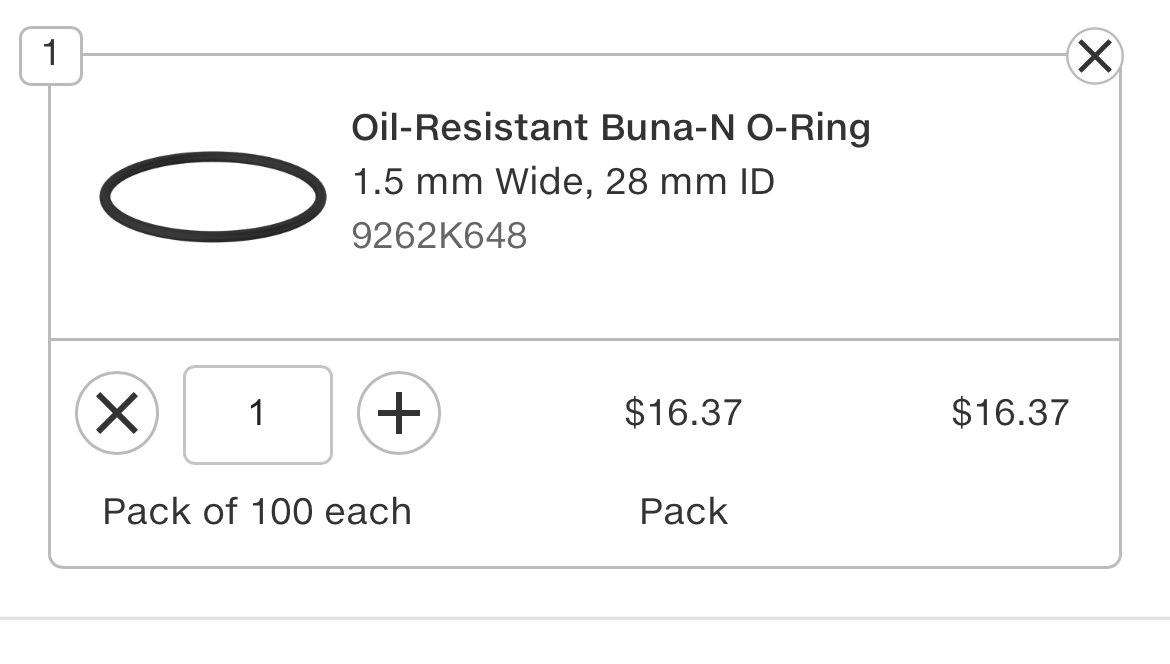

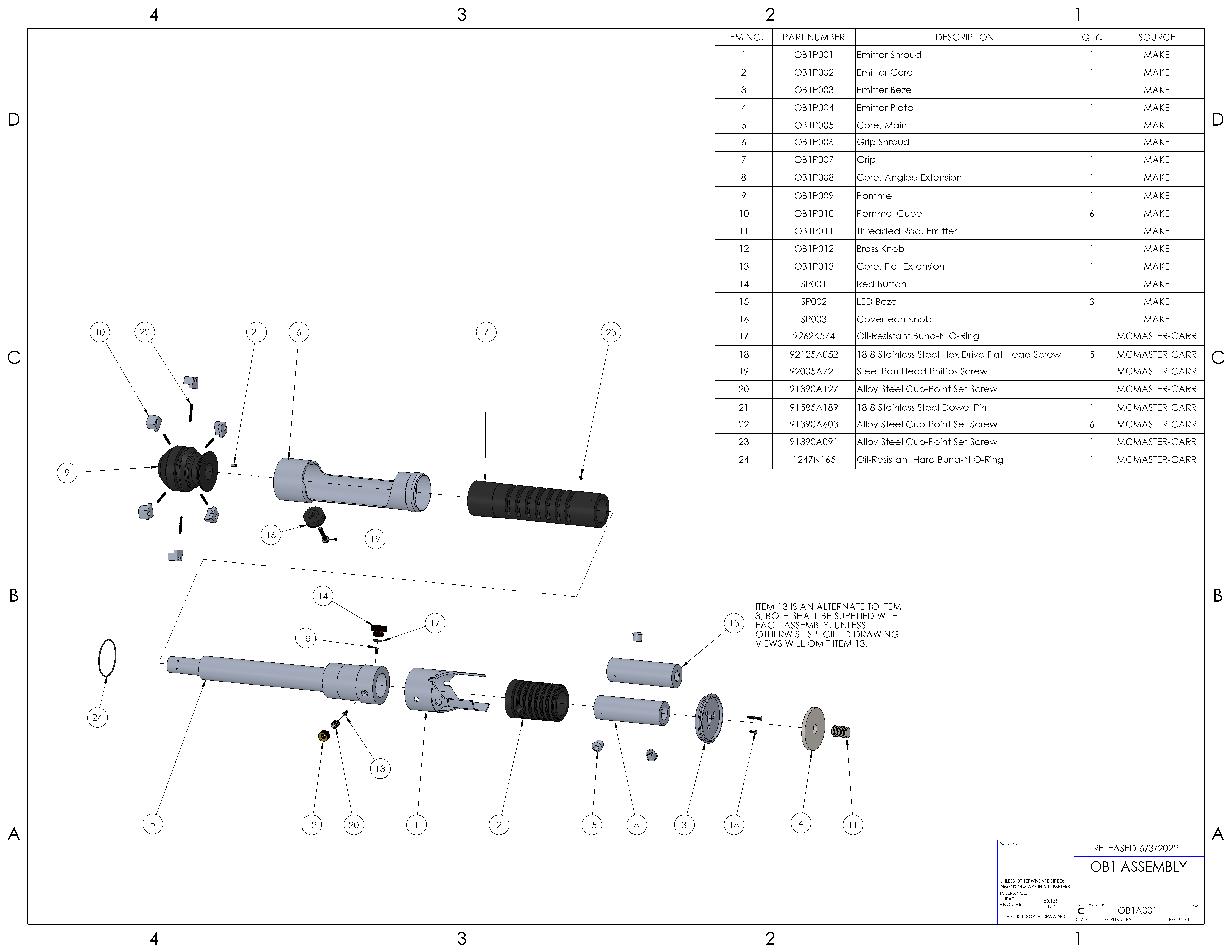

I have the worst luck with rubber bands, and now o-rings. Must be something about where we live. What size/material is the appropriate replacement for these?
Oil-Resistant Hard Buna-N O-Ring, 2 mm Wide, 28 mm ID

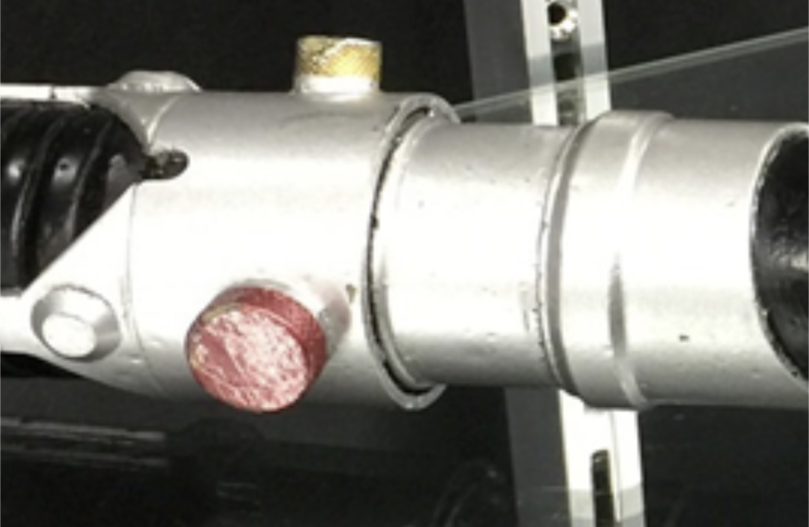

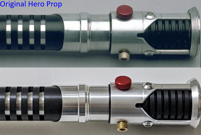

The only shortcoming I see now is the lack of a groove in the neck to hold it in place. From Dewy's resin stunt thread, a crop of one of the reference images with the o-rings captured in resin and painted silver:

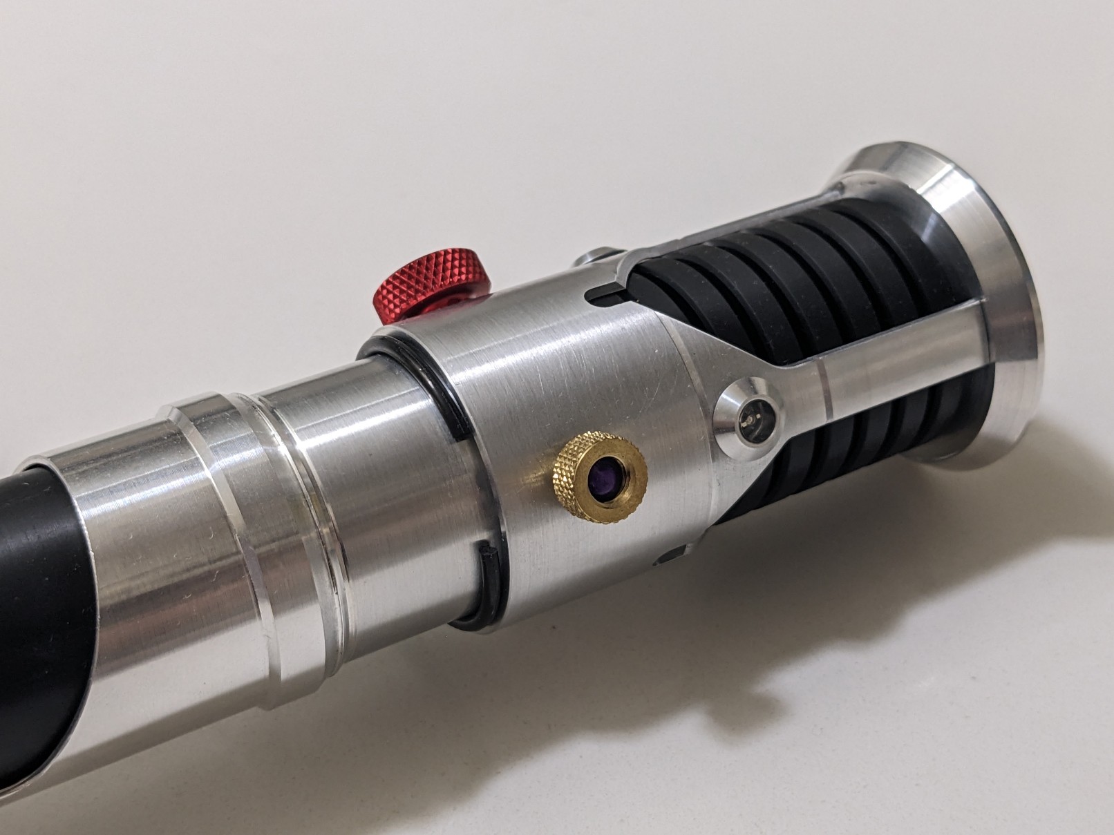

The o-ring appears to be in a groove set a fraction down from the head, enough to leave an all-around gap, which just isn't possible to do on this replica. The 1.5mm on mine doesn't leave a gap when pressed against the bottom of the head.
Actually, looking at it again, the prop o-ring appears rather beefy. I wonder if it is 2mm, and there's a deep enough groove that half of the width is sunk into it.
Excelsior made a point of this in his earlier post when he made his mods on his kit, determining that there was a groove.

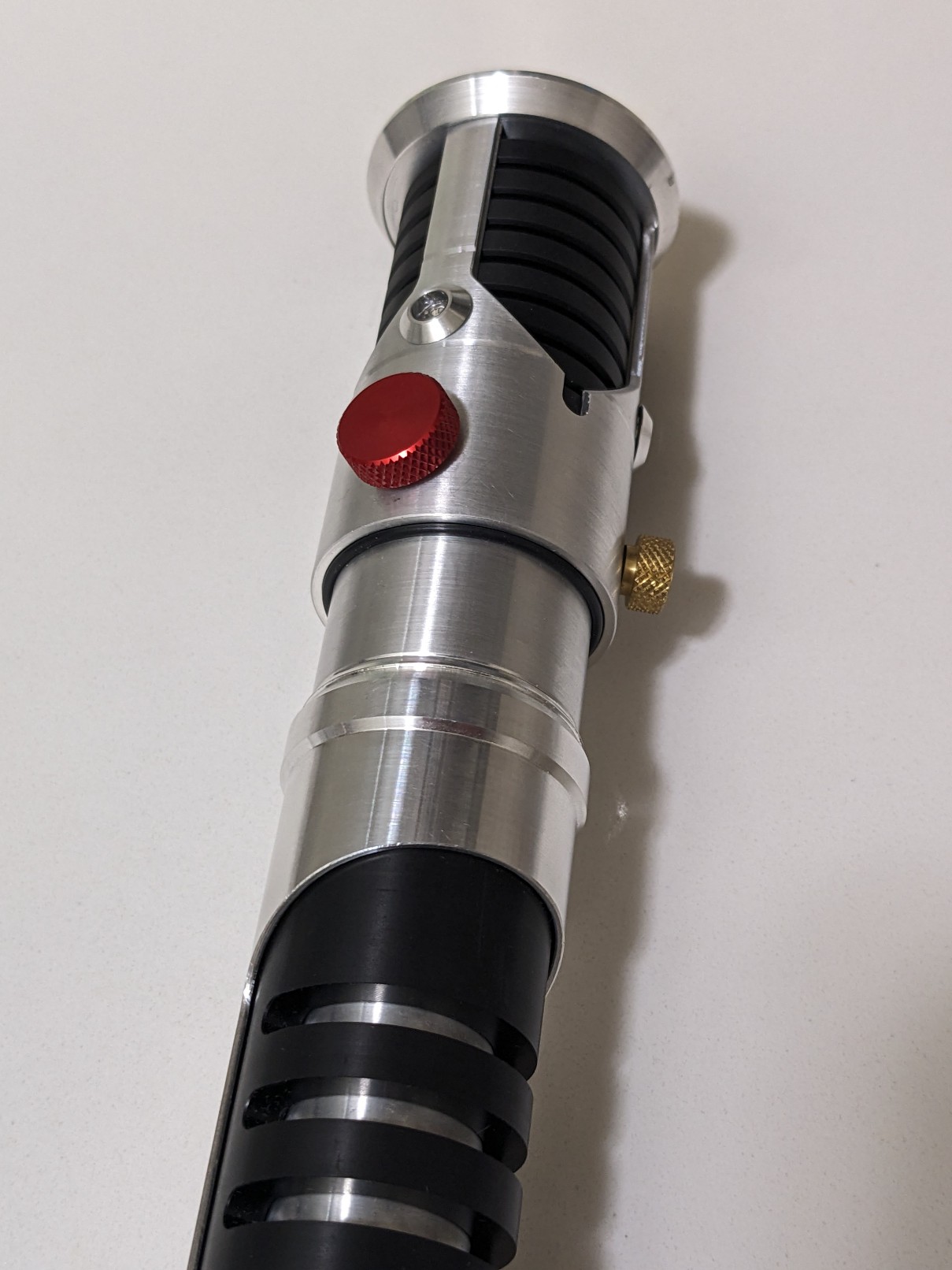

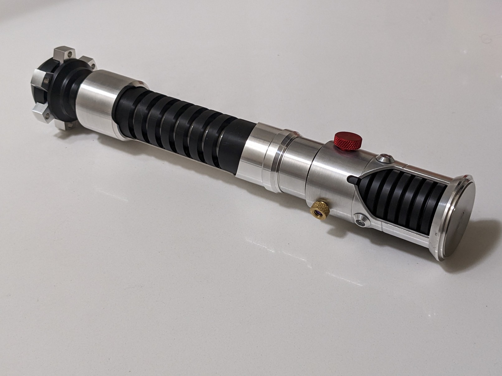

Side note, I just completed my build of this hilt and I just am so grateful to be able to own something like this...it's truly incredible what Anakin Starkiller and Dewy have been able to accomplish. When I was a little kid I used to take photos of the TV with my moms old digital camera of this very scene, only imagining what it'd be like to hold the real deal. Dream come true! Thanks guys!
