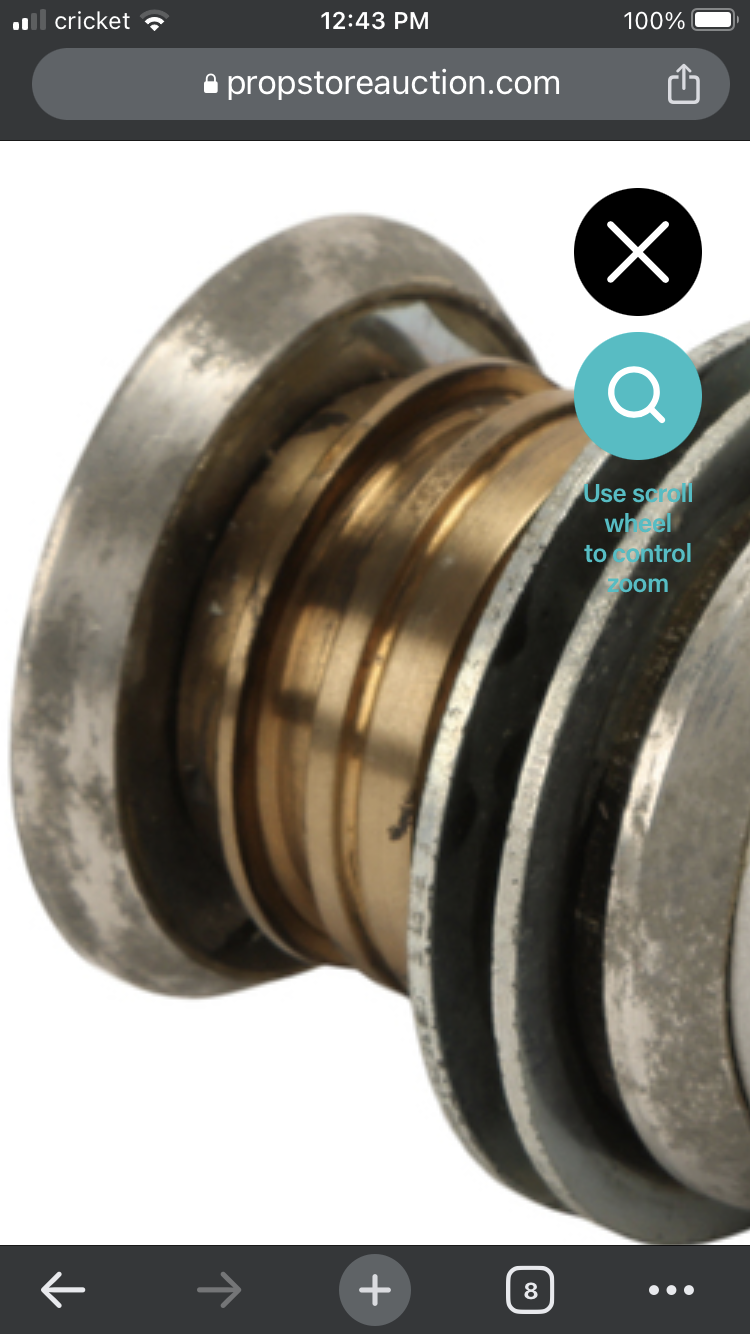

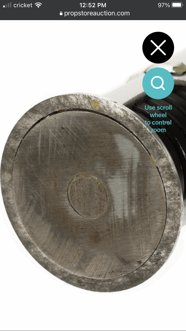

As to that new Obi wan stunt with a metal emitter - yes there does seem to be a spacing block but… looking at others from this collection… there’s glue everywhere. This isn’t indicative of the hero lol
Attached is the Obi Wan face and the adi gallia
(Of which I’m very excited to see metal parts of that one up close)

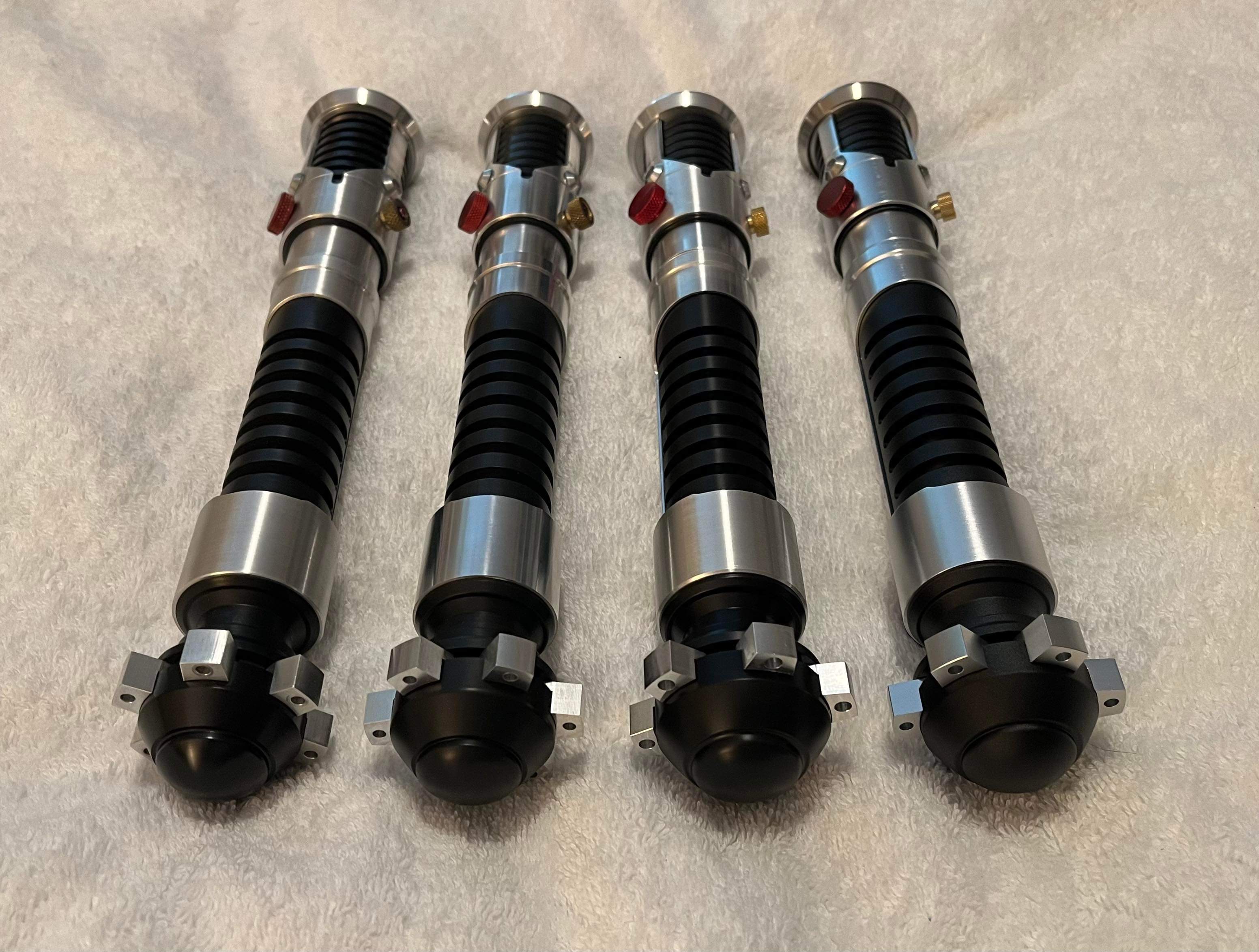

Added a bit of tape to a couple points in the core to fill the air gaps and it has firmed up the forward assembly. Also sanded the LED faces a bit (should have done that before installing them with glue but got it with the pinched corners of sandpaper without effecting the bezels too much)… and glued the emitter bolt threads flush with the washer.
Feels firm! And looks amazing wherever I set it down ;)

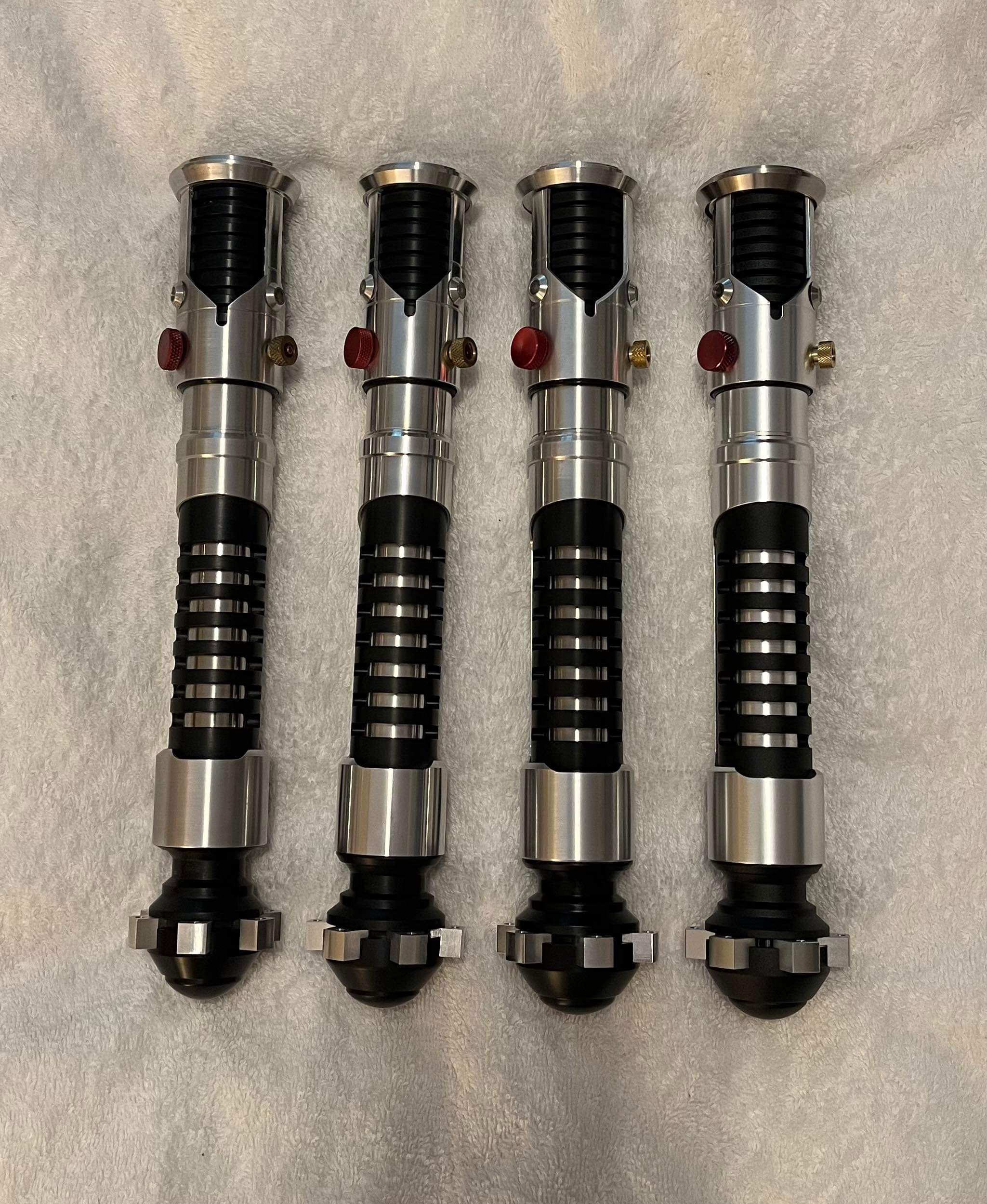

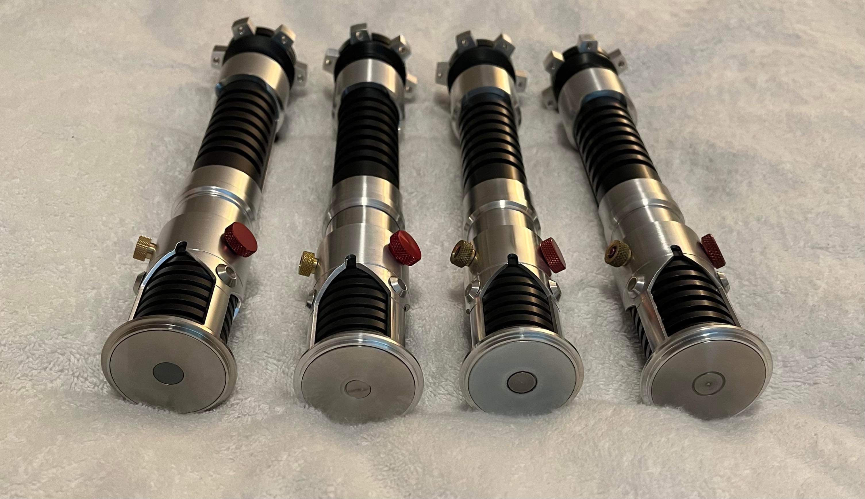

Bryan and I were texting and doing the same work at the same time. Such a great hilt! My new favorite TPM.
Darth Hez (DH Studios), AS Aluminum/delrin, AS/Dewy, Saberz
20+ year old saber, 10+ year old saber, brand spanking new 2023, also 2022/3
Order flipped for this one:
Nice collection, Chris! Maybe you could do a YouTube video review/comparison showing the slight differences between the different variants sometime. :) That would be fascinating.

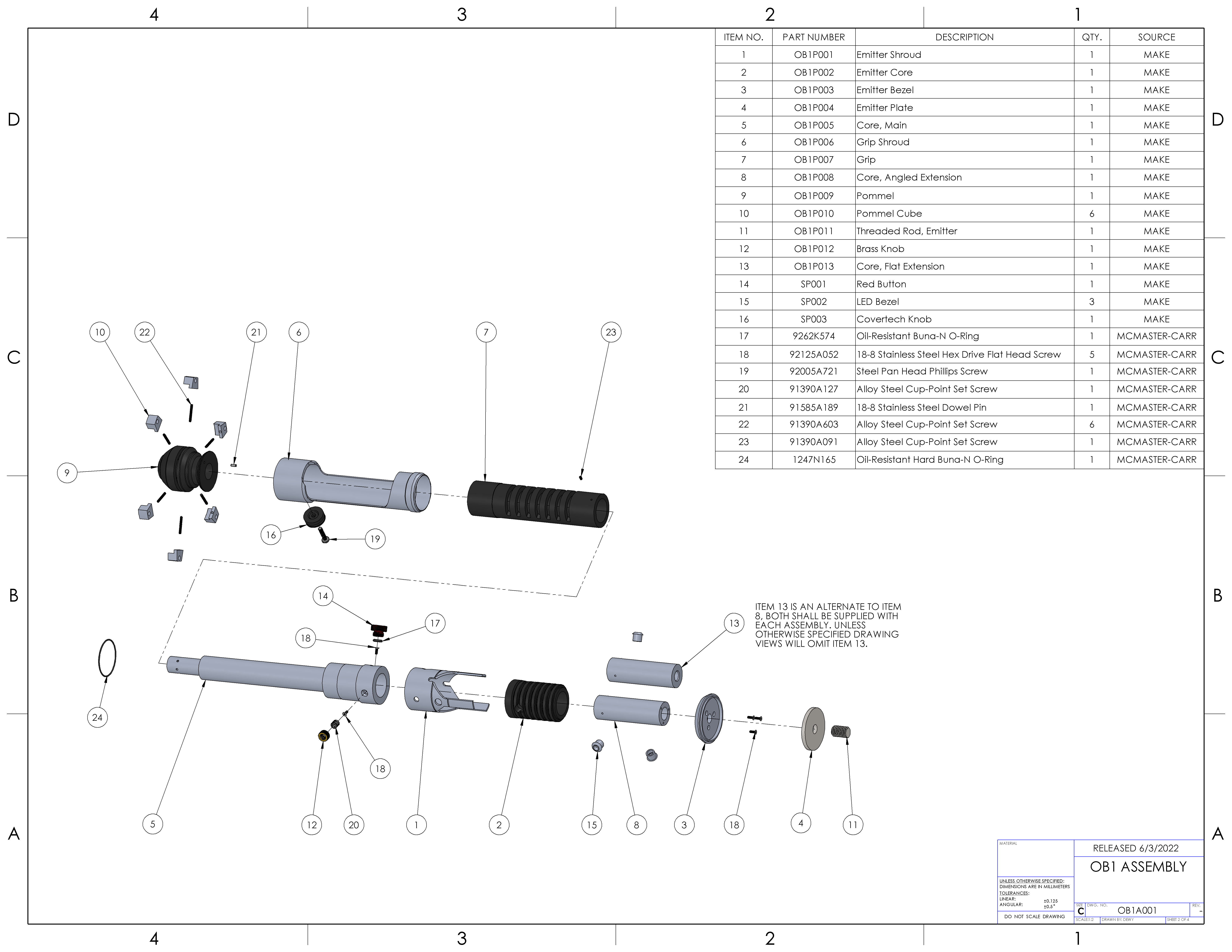

Hey is that O ring supposed to go up inside the emitter? I've only been able to squash onto it like 1/2 the thickness
I just remembered there are two sizes included for the neck O-ring (#24). If that is what you are referring to, the thicker one should be more accurate. The thinner one can be discarded.
:) yeah I meant the thicker one. I wasn't sure if I was supposed to find a way to stuff it up into the emitter shell, if that makes sense.
