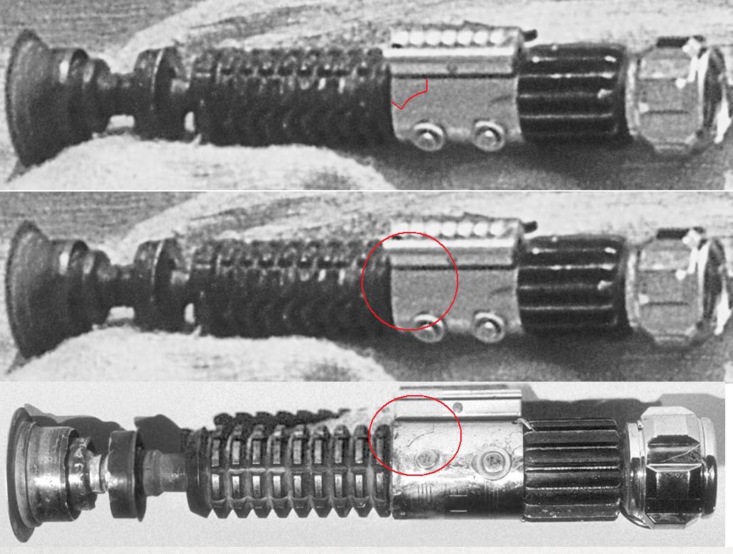

Am I the only one that sees this on the both chronicles & tunisia clamps:
Aside from that, which may be my eyes playing tricks on me... It's possible that the tunisia version had the frag body assembled upside down. Then they flipped it when they reassembled with cotter pins and screws...?
Your therory is valid, same thread on both sides (just checked)of the frag body.
And yes the clamp looks similar on the red are, would confirm it's the same prop, just some parts reversed (cube section and grenade)
However the brass part is different, could suggest the original brass part on chronicle saber would be inside the clamp, and maybe fixed in the booster (would be the cone on some pictures of tunisia version?!)
the windvane outer is also 38mm can help to center the clamp, one side has the frag body, then the windvane, and finally the booster ring.
however, if it's exactly the same prop, I don't understand why we can see both versions on same sequence (death star), but it can be possible they make some cuts with the first saber and a few weeks or months later with other saber.
hahaha... holy crap. I thought... is that even possible to flip the wind vane? I busted our your replica and my real one and sure enough... it IS possible.
I noticed one dent on the booster matches up too... one of the fins is flattened on the end. Not in the same position but the shape and placement are the same.
