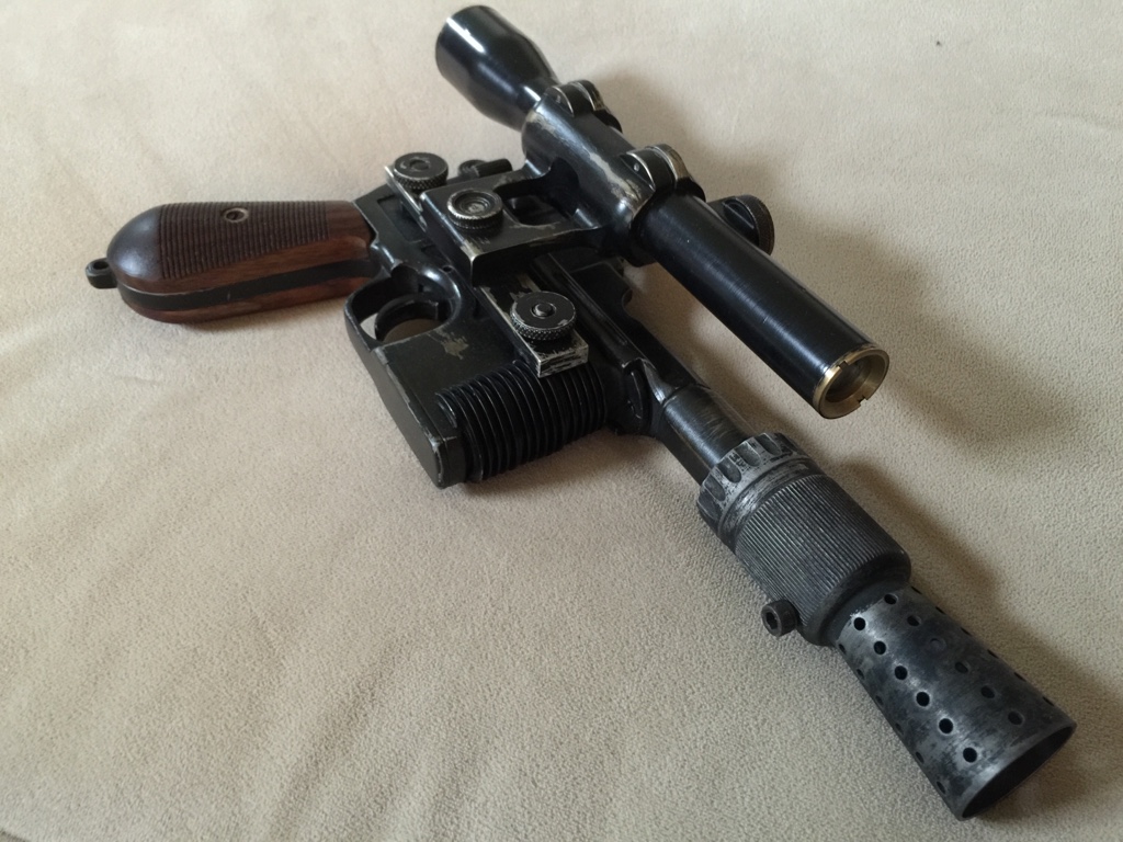

Here's my baby.

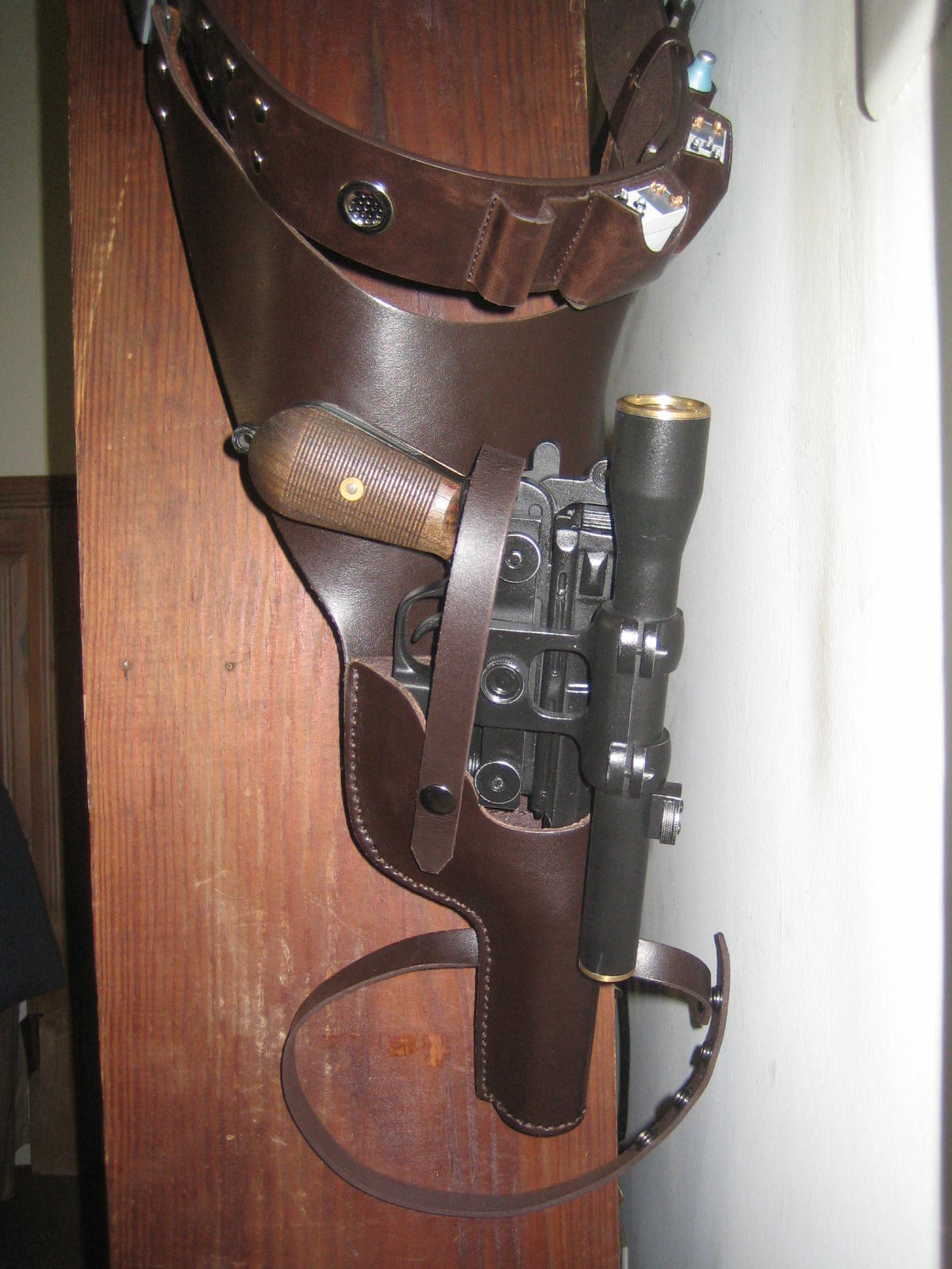

Here she is in repose on display. I opted for a CostumeBase pleather gun belt, leather hoster and greeblies. Not screen accurate by any stretch, but since I was shooting (pun intended) for playability I prefer it over a stand.

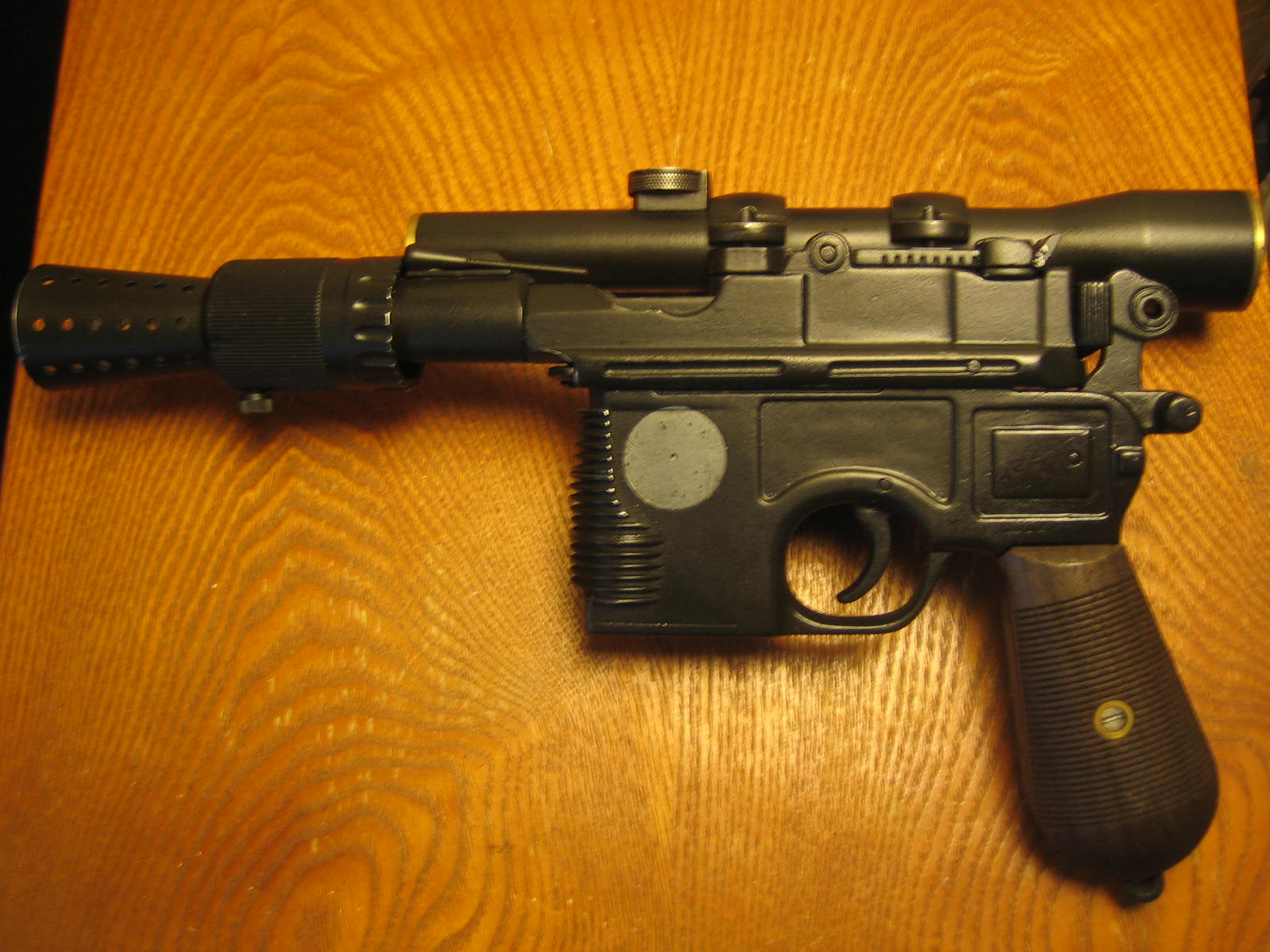

Here's the left side:
As I'm infested with younglings I decided to go with as-issued instead of weathered and paint instead of blue. I wanted a prop with sound and lights in a holster that the kids could run around the house shooting at each other and weathering it for me and not worry about the finish. Here it is fresh from 3 coats of matte black with polishing in between and still tacky from 3 coats of polyurethane. I'll see how the poly likes some hand polishing and may add a few more coats. I'm still not 100% happy with the mystery disk but, as many of you will also ask yourselves, will I ever REALLY be 100% happy with it? :/

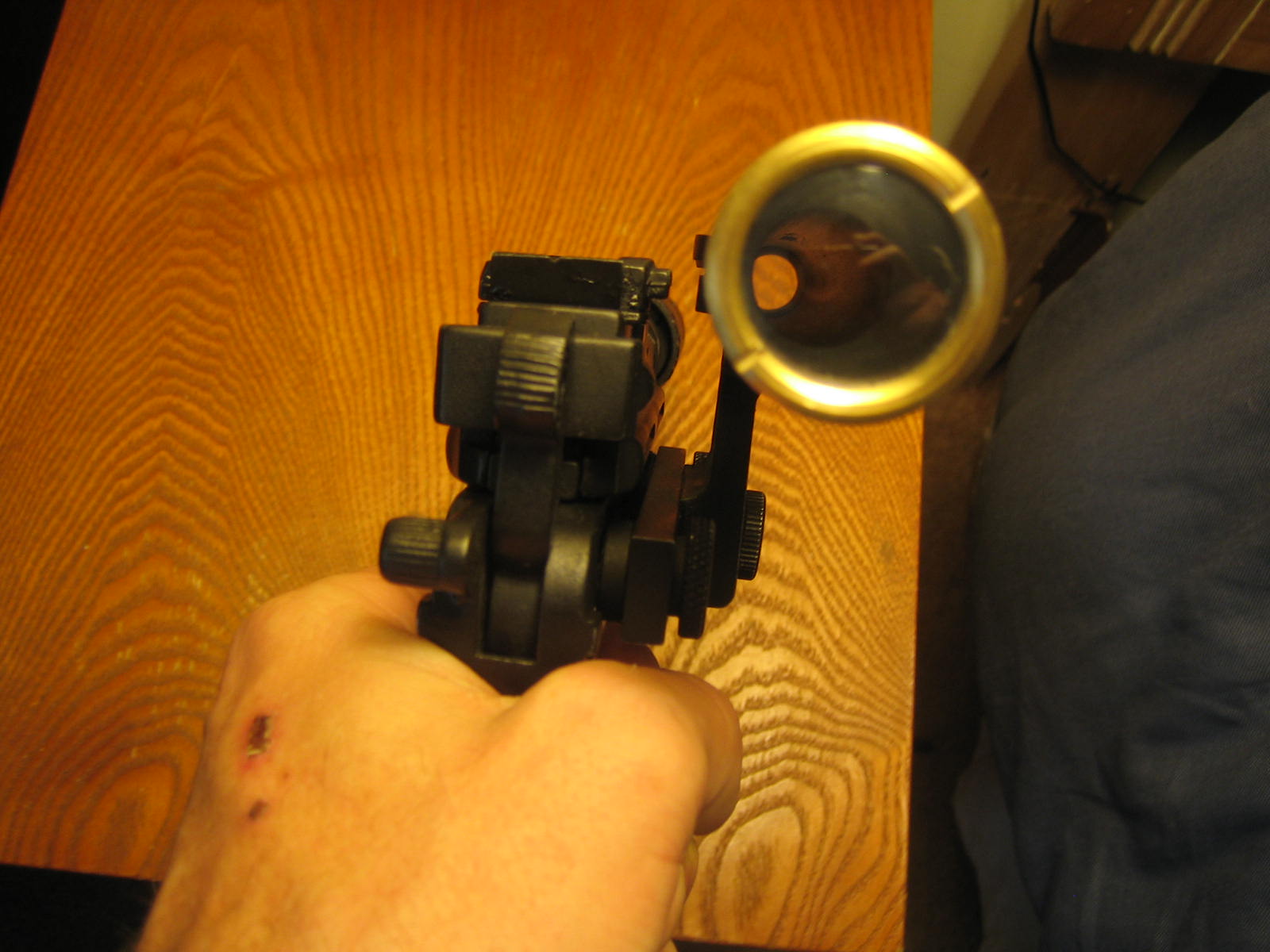

Top view:
This is where some detail specificity and artistic interpretation come into play. I couldn't stand the funky notched deal on the rear sight hinge but I didn't feel the urge to replicate a blued ejector on the bolt. It just seemed incongruous to me for a blaster to have an ejector. Ditto with the gold finish on the sight adjustment knob. Sanding down the black finish with 1000 grit to expose the silver knurls works for me. Go figure.

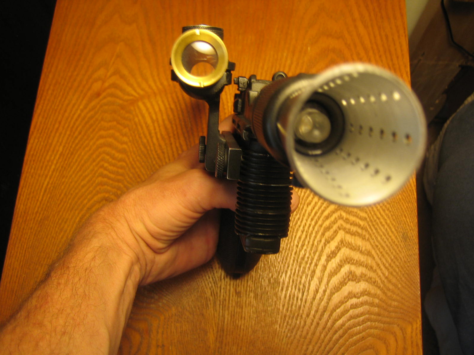

Front view:
Here you can see that I left the inside of the flash hider silver and added a 10mm LED. To get lights and sound I used the innards from a new 2015 Disney "Rebel Blaster" and got a friend to drill out the barrel with his drill press. I had to buy a AAA holder and blue LED (actually 10 for $3 shipped... how do they DO that?) from China on fleabay and Dremel out a sound chamber in my beautiful DEC walnut grips but it was totally worth it. Here's a video of the result:
