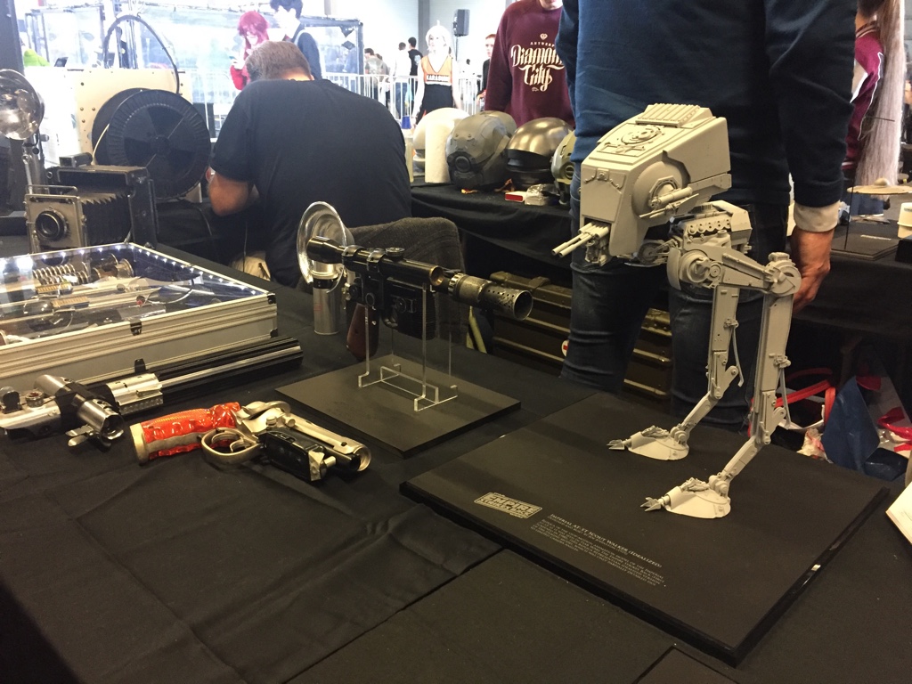

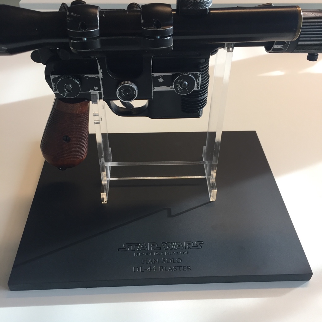

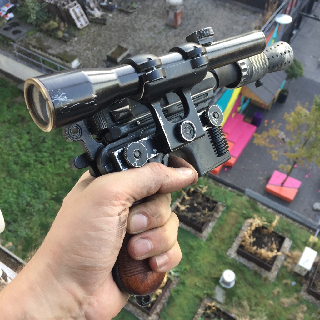

I finally built my denix/DEC blaster!
It was a fun build! The finish is a combination of aluminium black and glossy black paint. The weathering was really fun. The toxic fumes from the aluminium black were a little scary :)
I also build my own stand with laser engraving and laser cut acrylic parts.
And I presented it last weekend at the FACTS comic con in Ghent, Belgium, where I was part of the RPF stand with fellow RPF members. It was awesome!
