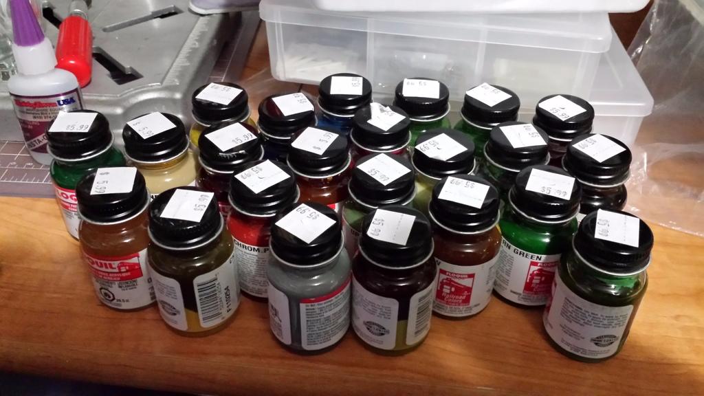

Trains & Lanes Hobbies in Easton PA has a lot of Floquil and Polly Scale paints in stock. The price is 5.99 a bottle plus tax.
They only have Floquil Primer in stock. All other colors 'used' for the falcon are sold out. I looked really hard for them.
However, They do have Reefer Yellow, Concrete, Reefer Grey and Caboose Red in Polly Scale.
Again, they also have a lot of other colors available in both Floquil and Polly Scale.
My score as of 1/28/16
Not shown: they all mixed up perfectly using my paint shaker.
My current Floquil paint set.
Waiting for two bottles of Engine black to arrive from online purchase.
Not a huge update/progress report but a step in the right direction. :D
