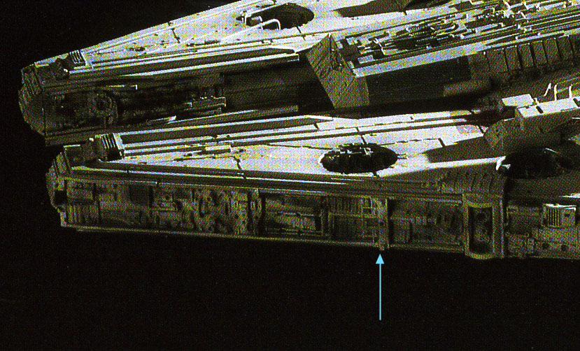

Just to throw more fuel onto the fire here is an image of the port side mandible with another missing part from Hasegawa's 1/72 Morser Karl

UPDATE 12/27/16: this part is not missing. Move along, move along, this is not a part we are looking for.
