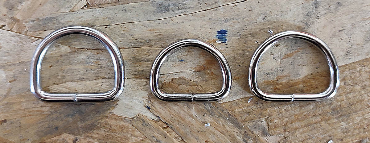

it's been a bit of a while! I have been struggling with sourcing the screws and D ring all this time and I just received the last D ring, which is finally correct :)
so, here are the 3 types of D rings I ordered, they were all very close to what I got from my 3D model in the descriptions, but you can see how different they were when I received them. Every time, paying shipping costs + 35 of them, those are small expenses but they add up quickly.

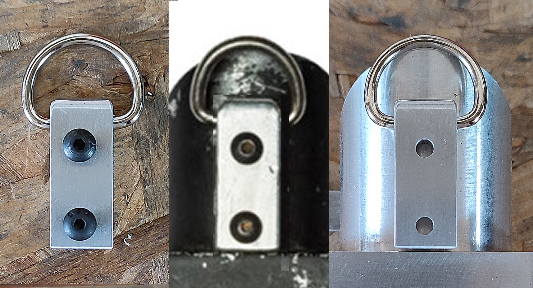

so, I'm finally happy with the last D ring and don't think I'll be able to find better, so this is what I'll be using. here is a small comp with the original, it is only very very slightly wider, but the shape and size is extremely close :) :)

Hello guys,

You can’t get anymore accurate than that d-ring, eethan. Well done!

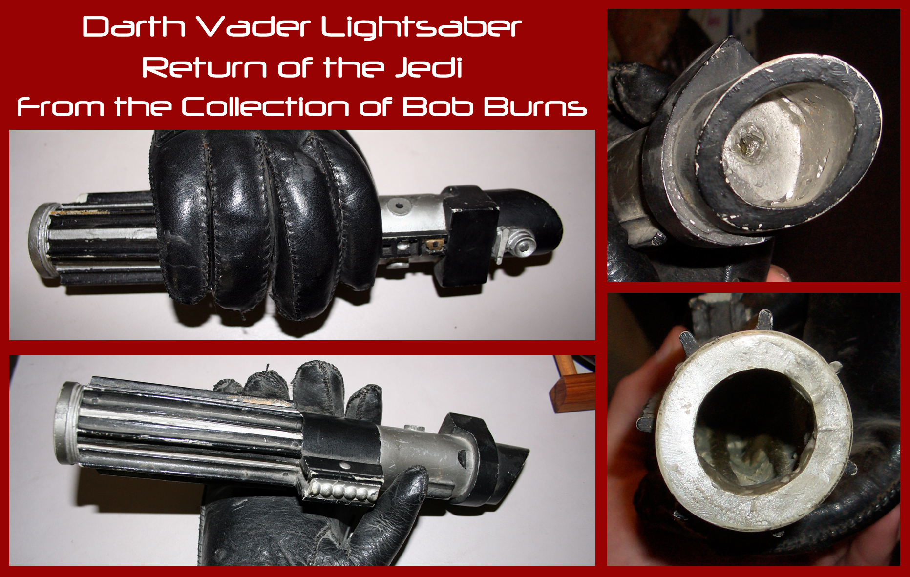

eethan , are you going to do both shroud greeblie options? The one seen on the resin stunt must have been on there at some point and is more likely to be the esb/rotj production version since it still had bubbles and everything.
hey,
so far, I'm working on the initial square shroud, and the Barbican as is now, the cast version has been a possibility all along, I just don't know if people are interested in it since this one was a cast and not an aluminium version. this will be decided with the interest thread. If enough people want it, i'll do the 3 versions. (this will be an "idealized" version though since it will be in aluminium and would get a double black/aluminium core, to simulate the paint they did here.)
cheers
Wicked impressive updates, I’ve seen those photos before and never noticed that weird greeblie until teecrooz mentioned it..

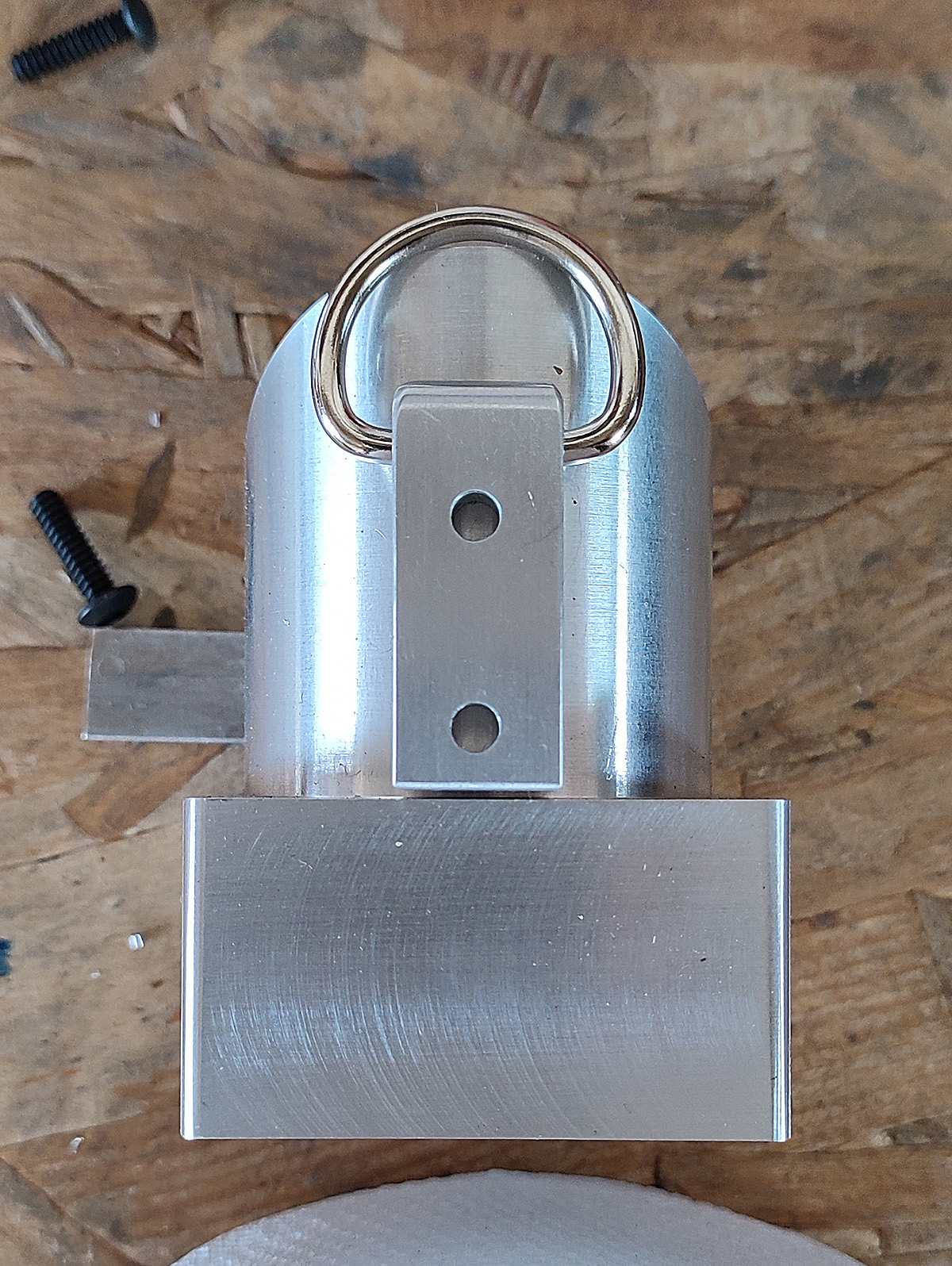

just thought while discussing Tom's and RedButton's saber in the other thread that I showed the D ring research but never really showed the D ring holder piece, with an actual rounded out bottom for a perfect fit, just like on the real prop. So surprising that they went the extra mile on this, things are normally not that clean in Star Wars!

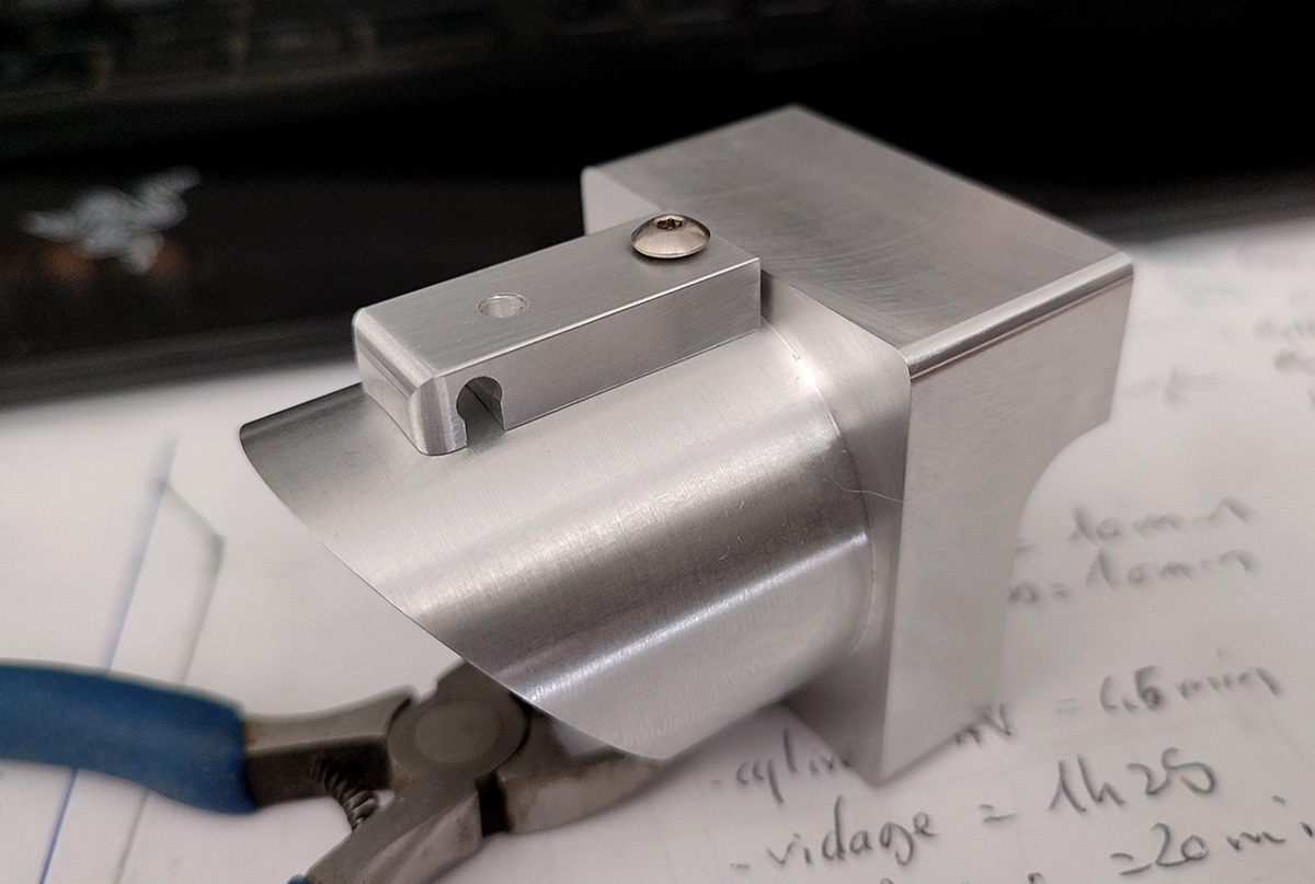

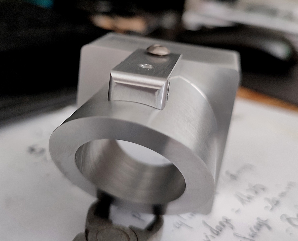

The machine work is breath taking

such smooth work, very very impressive. Hell, I just learned how to control the "feed rate" on a hand drill and drill press... couldn't imagine it on a lathe or mill, well done.
Also, good eye on the curved bottom of the D ring. You're an asset to the community with eyes like that
Thank you so much Tom for your kind words, you can't imagine how much that means to me, really!
Hi eethan ,
I found this thread because I was looking for references of the Obi ANH D rings and then I saw your comparison photo and the one on the original hilt looks very close to this one I found on Etsy. I played quickly with it in the PS a bit and I think it is really close. I am just not sure if it is the right size. Anyway I thought you might be interested! HERE IT IS
Hi eethan ,
hey,
thank you, those look nice indeed but from the dimension listed, they are too big for the Barbican.
I'm pretty happy with the ones I found already and paid quite a bit for the D rings, since I had to order 3 times already, so they will do nicelly I think :)
