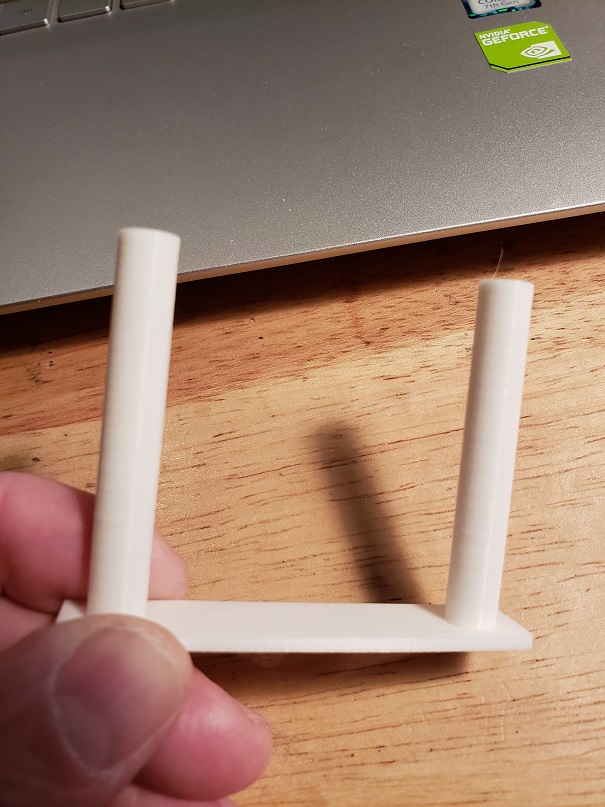

I wanted to see if my E3 would produce any stringing from point to point as seen in the video, so I modeled two 7.60mm
posts separated by @ 50mm and this is my result after 1hr and 57min.
I have always used CURA 15.04.3 that came with the printer and have been happy with the results.
The firmware is unchanged with all the original components.
I suppose if the E3 is properly set up with filament that melts well, the nozzle can do a pretty good job of laying down the layers.
I use filament from eBay Century brand at 210C and a .4mm nozzle.

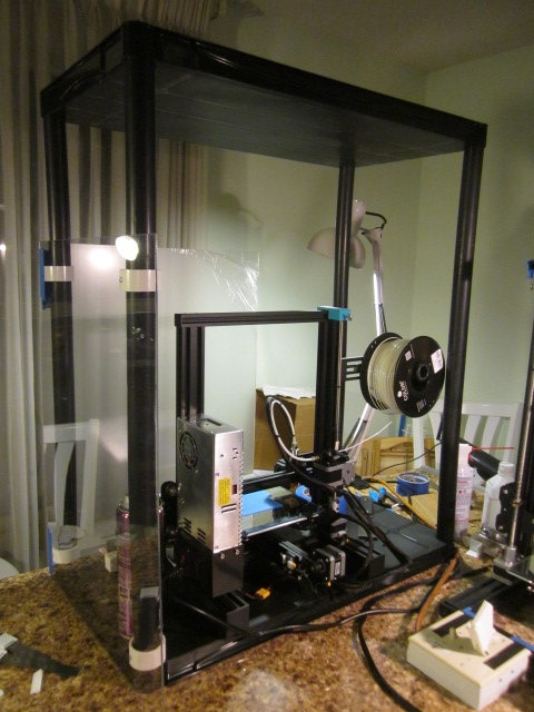

I wanted to make a quick "setup and tear down" enclosure for my Ender 3 using the fairly
inexpensive plastic shelving and pre-cut 24" x 18" x 1/8" plex from HD.
I still have to cut down the legs a bit to lower the top lid and add the clear plastic sheet to the far side and back.
I will then add a light fixture to the inside top.
(so far - pictured from the back)
(so far)
Are you worried about having your controller in the enclosure itself or are you going to move it later?

My particular enclosure for my Ender 3 is not meant to increase the over-all temperature around my printer.
I will still be printing at near normal room temperature.
This enclosure will be mostly used to maintain a constant temperature and airflow around the printer while still being able
to see inside. Also, it will help to keep the sound (during a print) at a lower level.
It will not be air tight or completely sound proof. Only partially.
I also will need to be able to dissemble, transport and store it easily.
I managed to find some time to work on my enclosure for the E3 printer.
This will be used mainly to help keep the sound and air flow around the printer to a minimum
while still being able to watch the print progress.
I need to be able to disassemble, transport and reassemble without too much effort.
I think this design will work well. (I still have to install the back cover).
