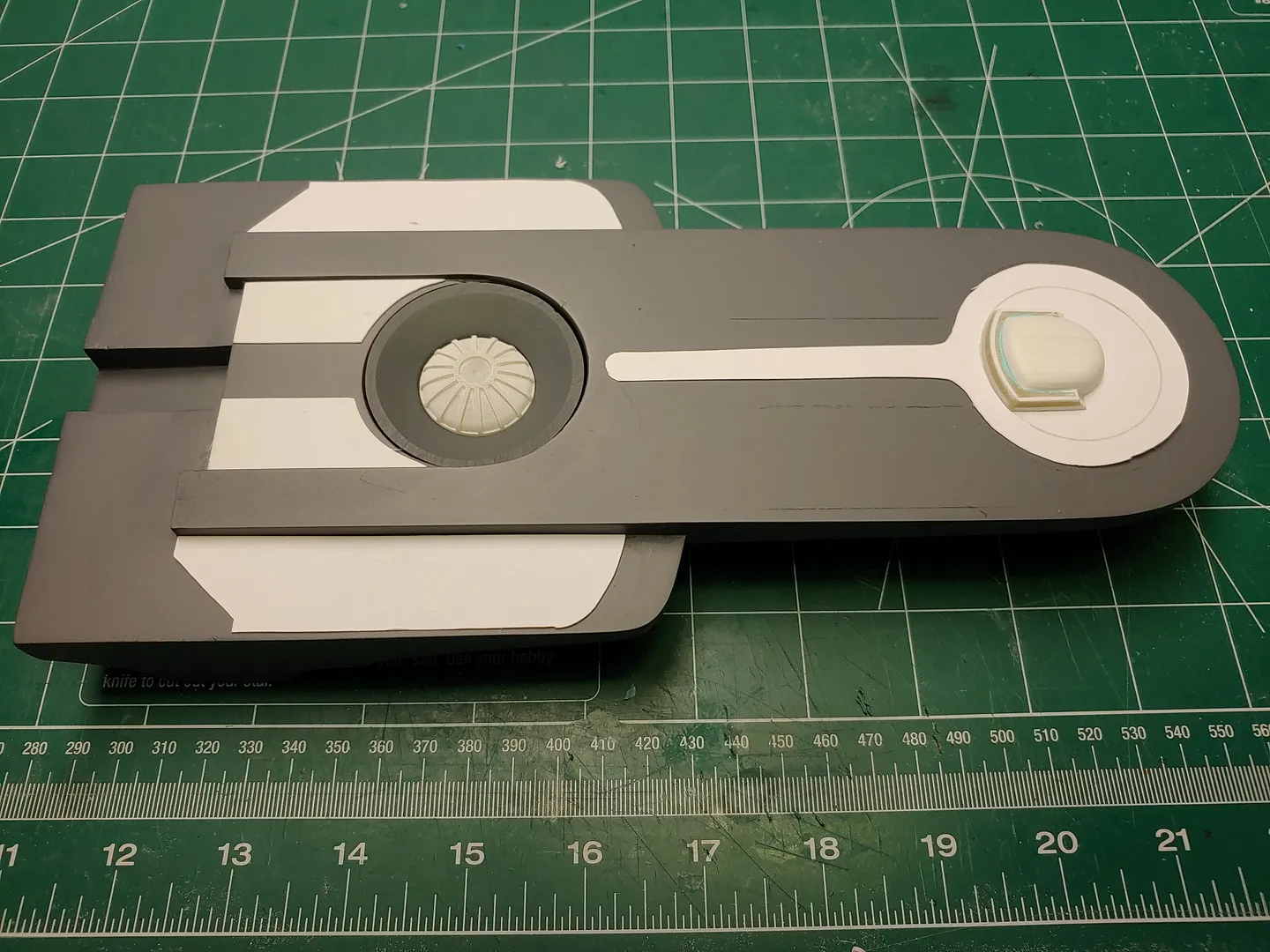

Here is the Superstructure master fully primed. The scratch made Impulse Crystal trench from a DQ Blizzard top and the 3D modeled dome are in place, along with the scratch-built bridge dome. The paper templates for the raised surface detail are also in place.

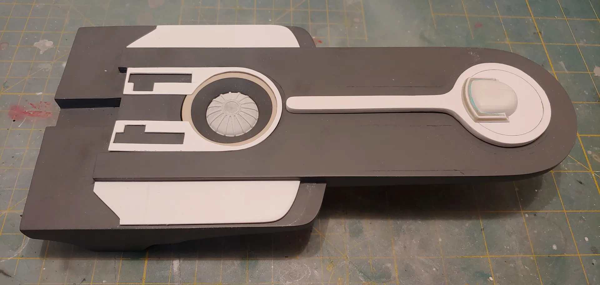

The Superstructure is pretty much finished except for the two fins, and the impulse engine exhaust ports.
Here, I used Tamiya's 1mm x 1mm grid tape to fasion the raised and recessed details around the Impulse Crystal assembly.

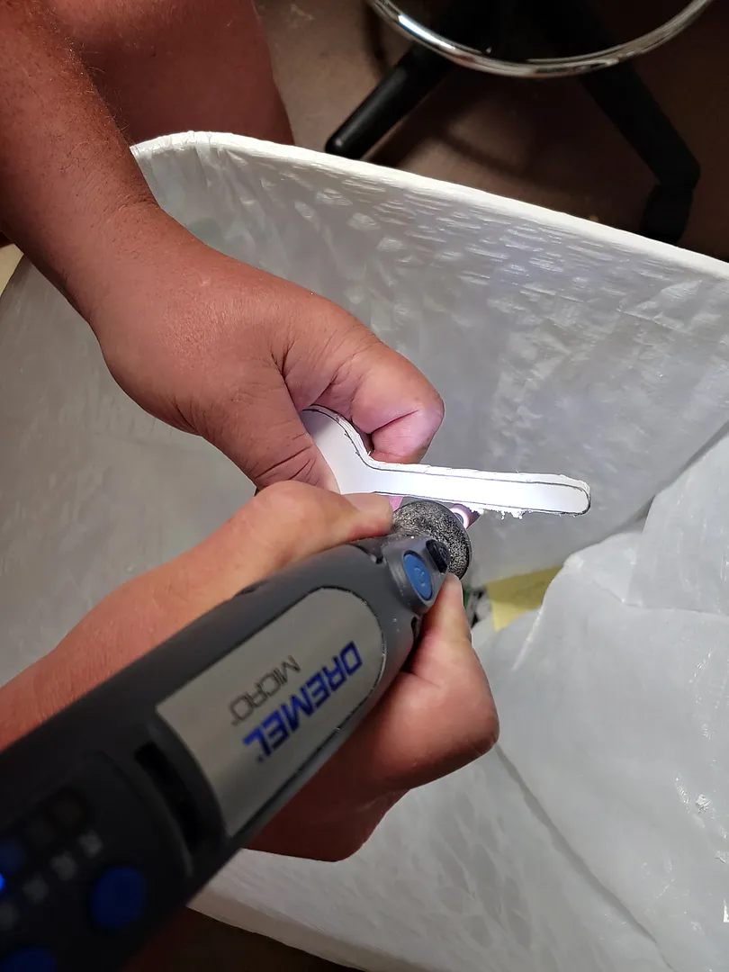

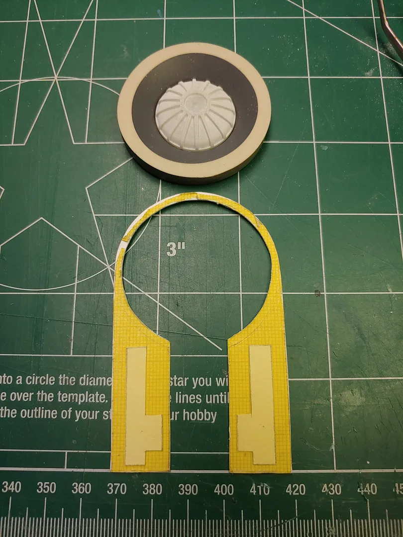

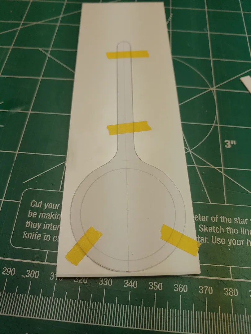

A paper template is used to make the raised plating under the bridge and the spine that extends aft behine it in 2.5mm thick sheet styrene.
Cutting way the styrene from the part.
All the raised plating details in place on the Superstructure's Buck.

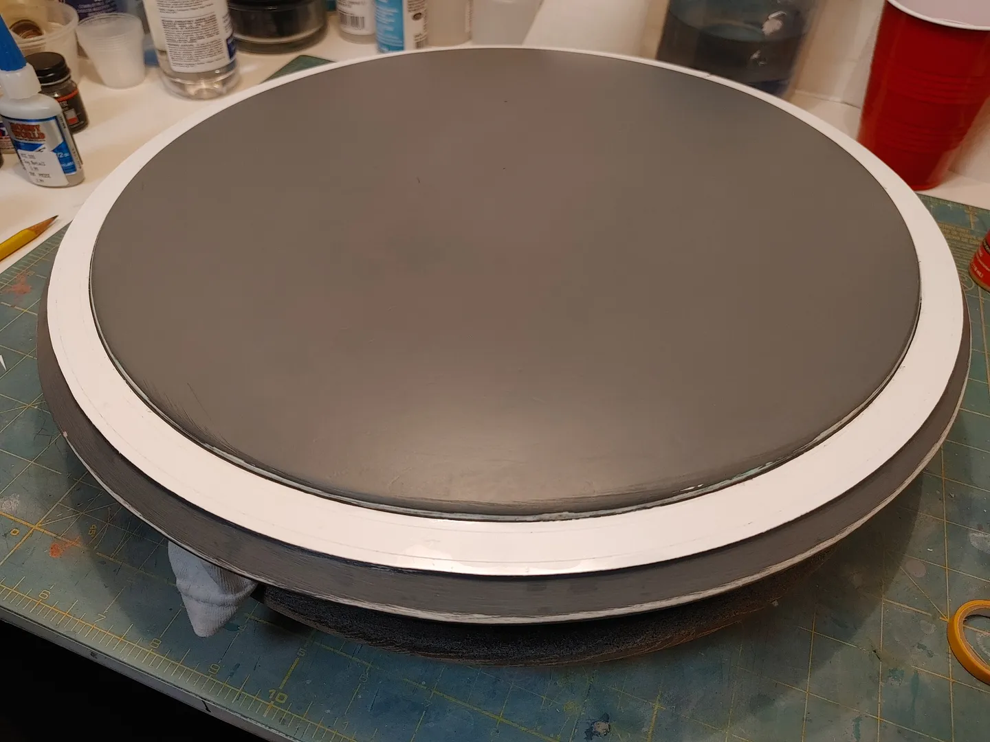

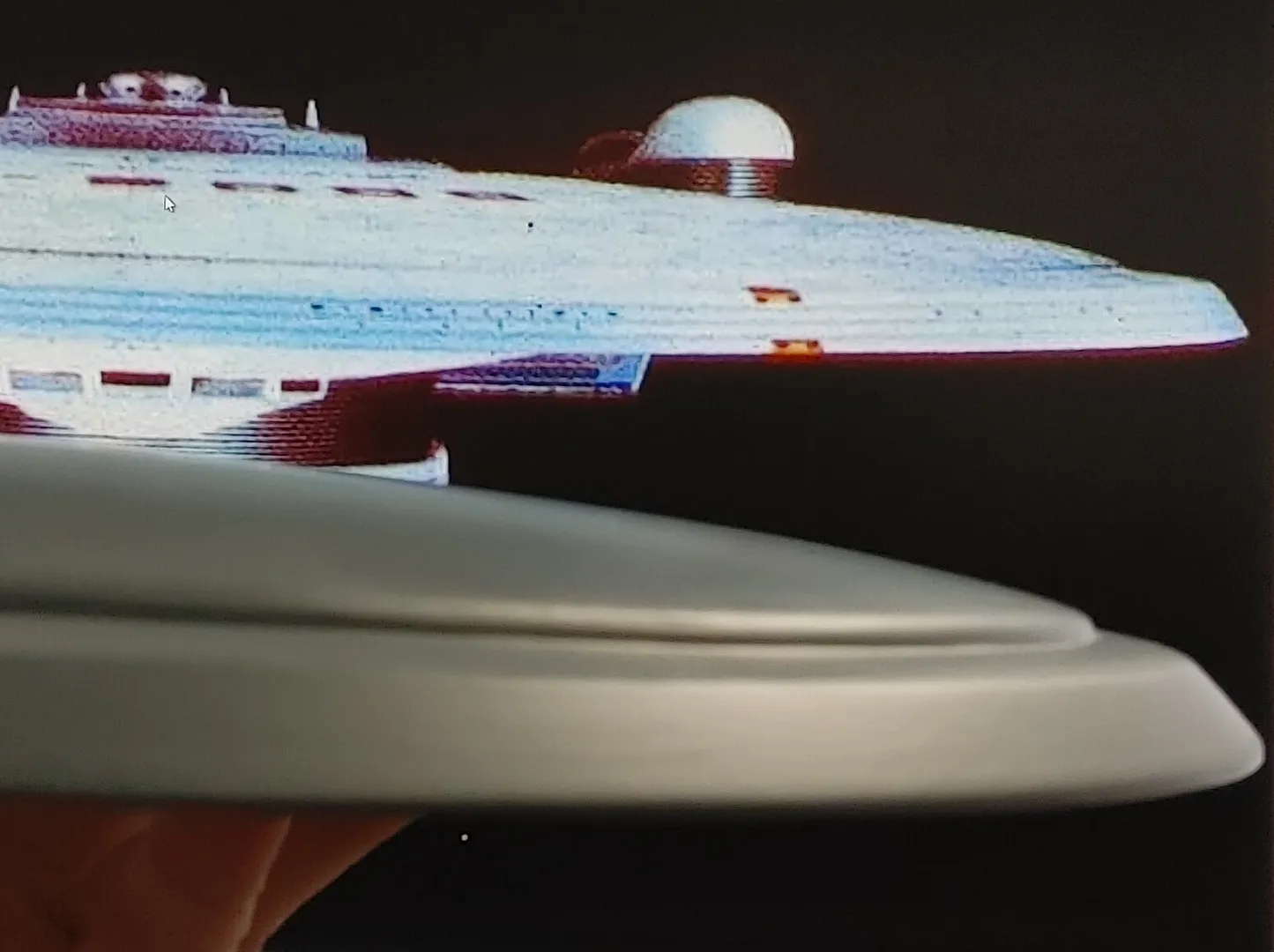

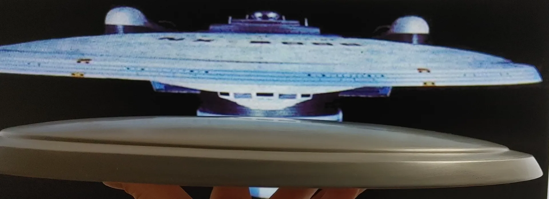

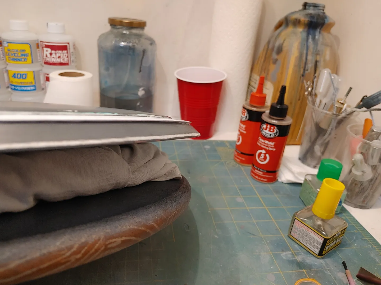

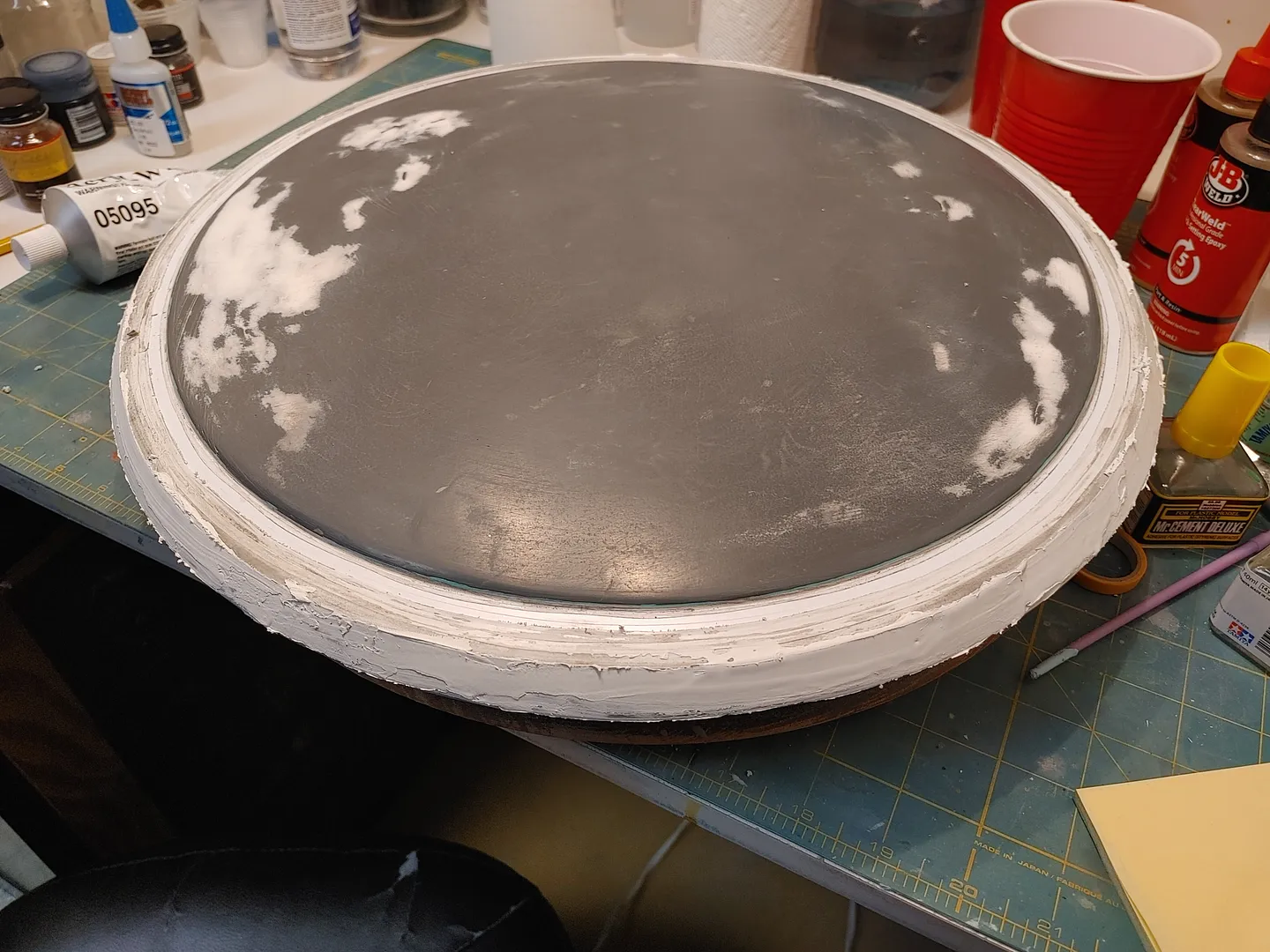

So, The Lunar Models saucer has another issue. The outer edge (with the window ports) is leaning at too much of an angle. It needs to be more to the vertical. Some preliminary work in progress correcting it.
Here you can see the difference in the angles.

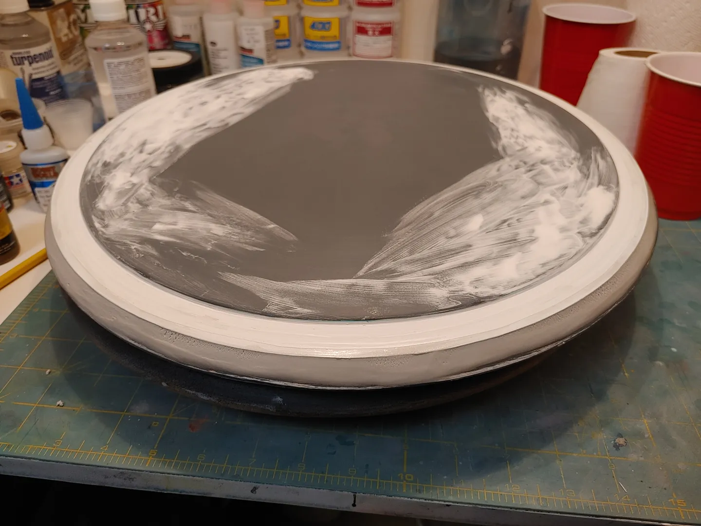

The saucer's edge is sanded and stripped down so a new ring section can be cemented into place.
The new ring to correct the profile is cemented into place.
Then filled in at the inner radius at the base of the dome.
Side view of the new angle before the filler is applied.

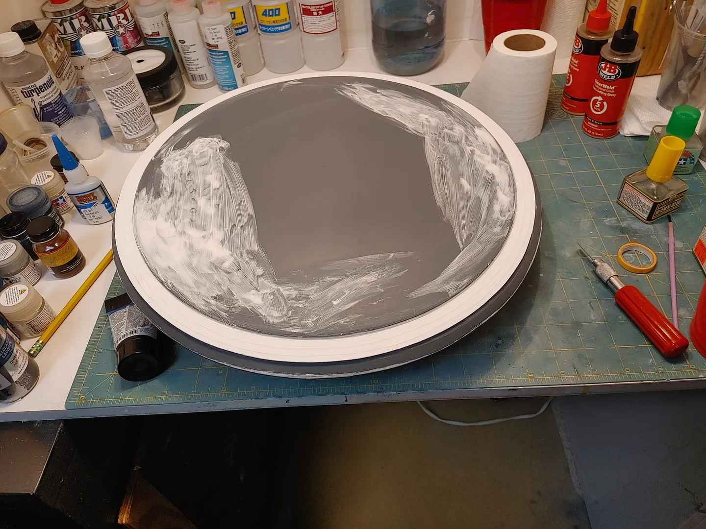

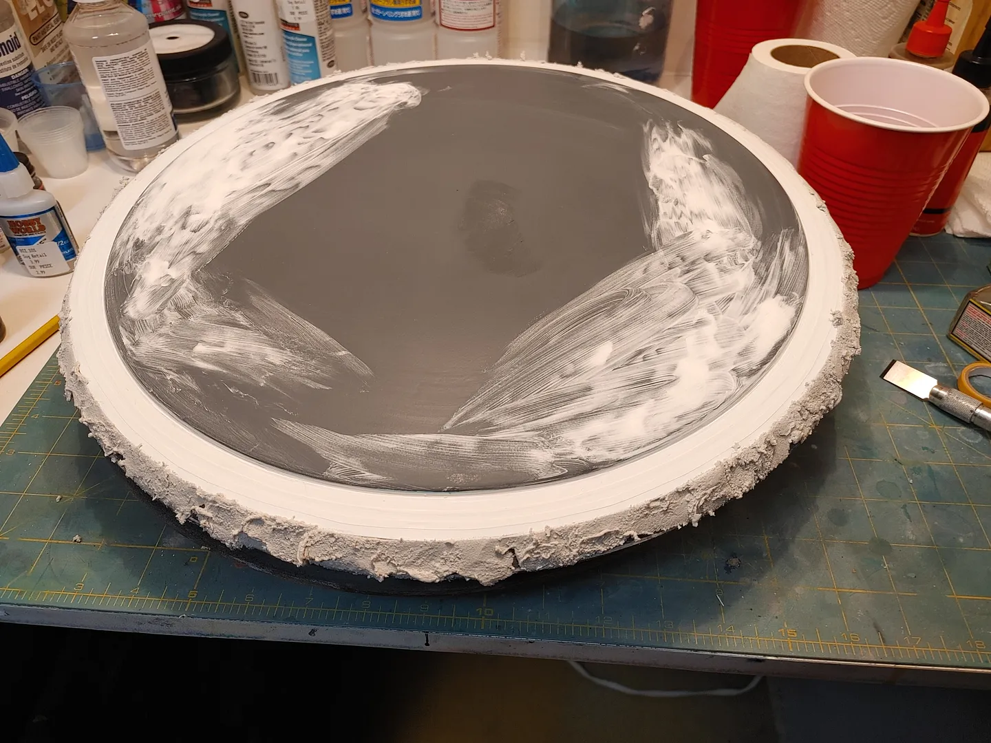

The new ring is masked to protect it, then the Smooth-On filler dough is roughly applied.
Next the filler is smoothed into the hull with water dampened hands. One or two more layers are expected before putty, sanding, and re-priming is done.

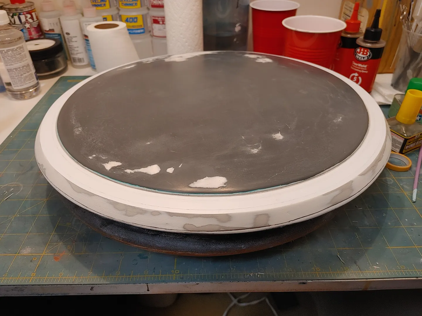

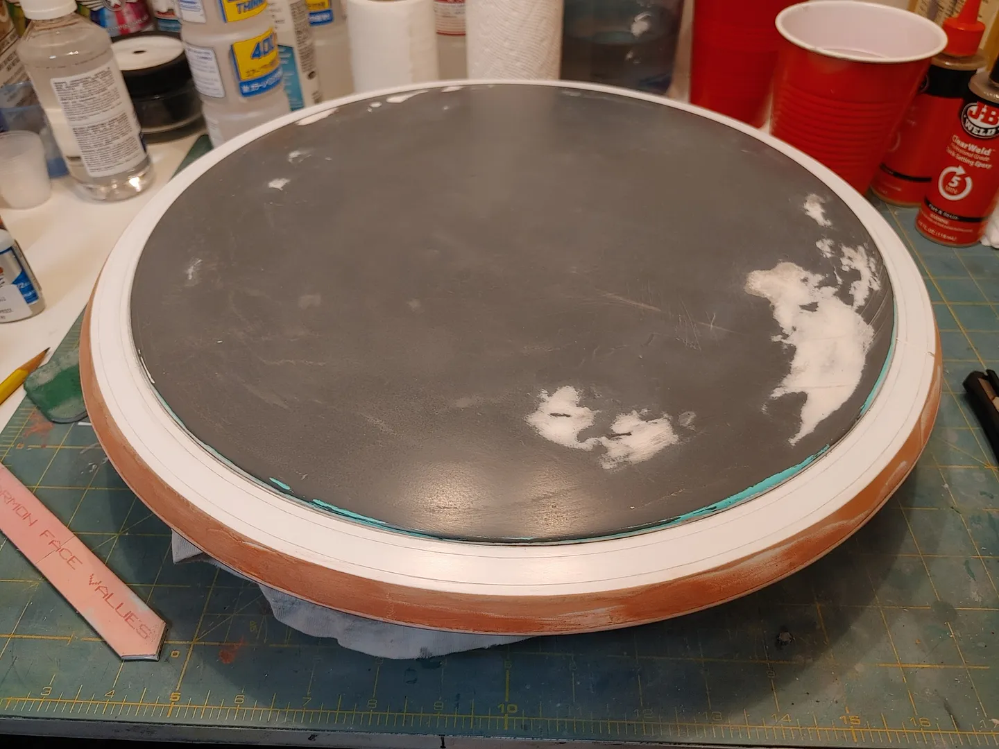

The second layer of filler dough was applied, then sanded down. Here the first layer of putty has been roughed in...
Sanding done to level the new contour...
Next, the Red Micro filler is applied to fill in scratches and continue leveling the new surface.
Then sanded to its final shape.

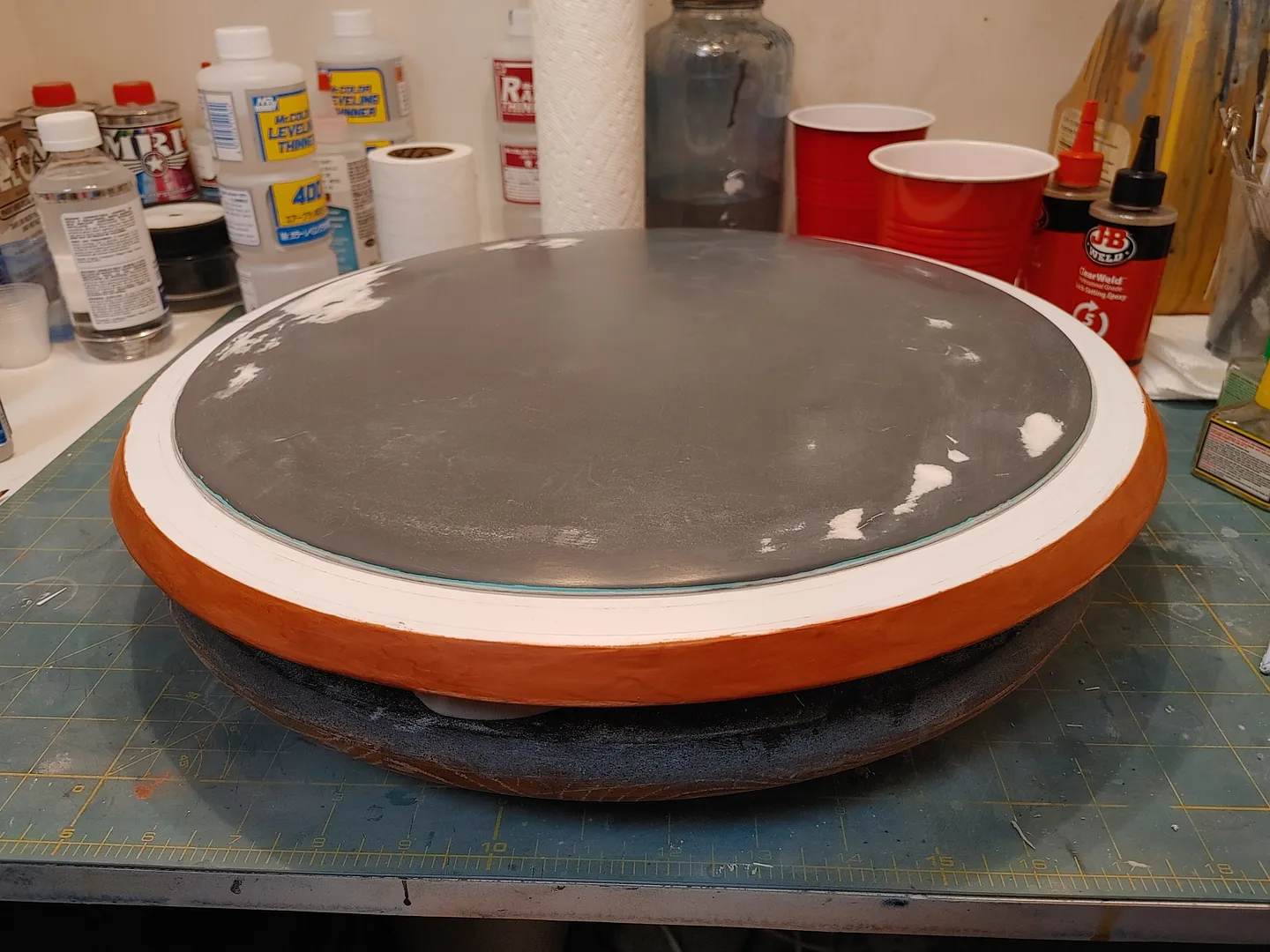

I took the liberty in adding the two recessed grid radius' in the ringed shelf to see how they would look. I don't think they'll pop during the vacuum forming process, but hey... they look cool being there.
I'm still deciding if scribing the grid pattern in the master would be futile. The plan has always been to scribe in all grid/panel lines on the vacuum formed parts for crisper detail.
Primer to go, and I'll FINALLY call correcting the saucer section (top and bottom halves) done!
