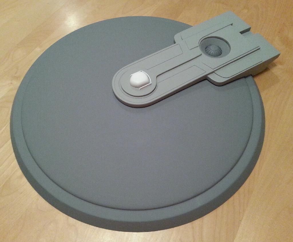

I have started a big project regarding correcting everything that is wrong with the Lunar Models Excelsior. It will all be done by hand because I don't have the computer skills, nor the equipment to 3D map parts, and print/grow them.
I am using scaled up images of the actual NX version of the studio miniature as a guide to correct the kit. These corrections will be made into new masters so I can vacuform new parts in clear to light the model.
I have mostly completed correcting the primary hull superstructure and the top half of the saucer. The bottom half of the saucer is still in-the-works of implementing the trenched details.
The top masters checking test fit.
The bottom fitted with the main trench. The neck trench is next.
The secondary hull had to be resized and the bow reshaped to match the studio model. At this scale the LM secondary hull was too long by 2.5". Here the finished master is checked to scaled images of the studio model.
Completely scratch built smaller sections are replacing badly inaccurate parts from the kit, such as the Planetary Sensor Dome. part compared to the new master.
The first test on the right vs the final version of the Sensor dome on the left.

Thnx so much for the kind comments! As soon as I get done with a friend's 1/32 scale A-7E Corsair, I'll get back to work on it. With the primary and secondary hulls now in proportion to one another, next will be to fix the nacelles. They are 1.5" too short! A technique used to modify airliner fuselage's to a "stretched" version will be used to fix the problem.
Since the Excelsior's nacelles were never lit on the physical studio model, I am still deciding if I am going to light them or not. CGI effects were used to light Excelsior class nacelles in a variety of ways between DS9 episodes and the one Voyager episode re-enacting Star Trek VI: The Undiscovered Country. In that regard, there is no consistency on how to light them. Some had just the top structure lit (DS9), while others had the grill detail lit (Voyager). I'm still leaning towards staying true to the studio miniature.

The nacelle grills, dorsal assembly, and the base of the warp pylon blister assembly will be laser cut, or hand cut styrene depending on how deep my pockets are at the time. I will be painting them a dark metallic gray/gun metal.

The tops of the nacelles however are light blueish-gray with medium gray strips (one on each side). The light blue is what I was "thinking" about lighting. Images of the studio model nacelles in several shots here.
