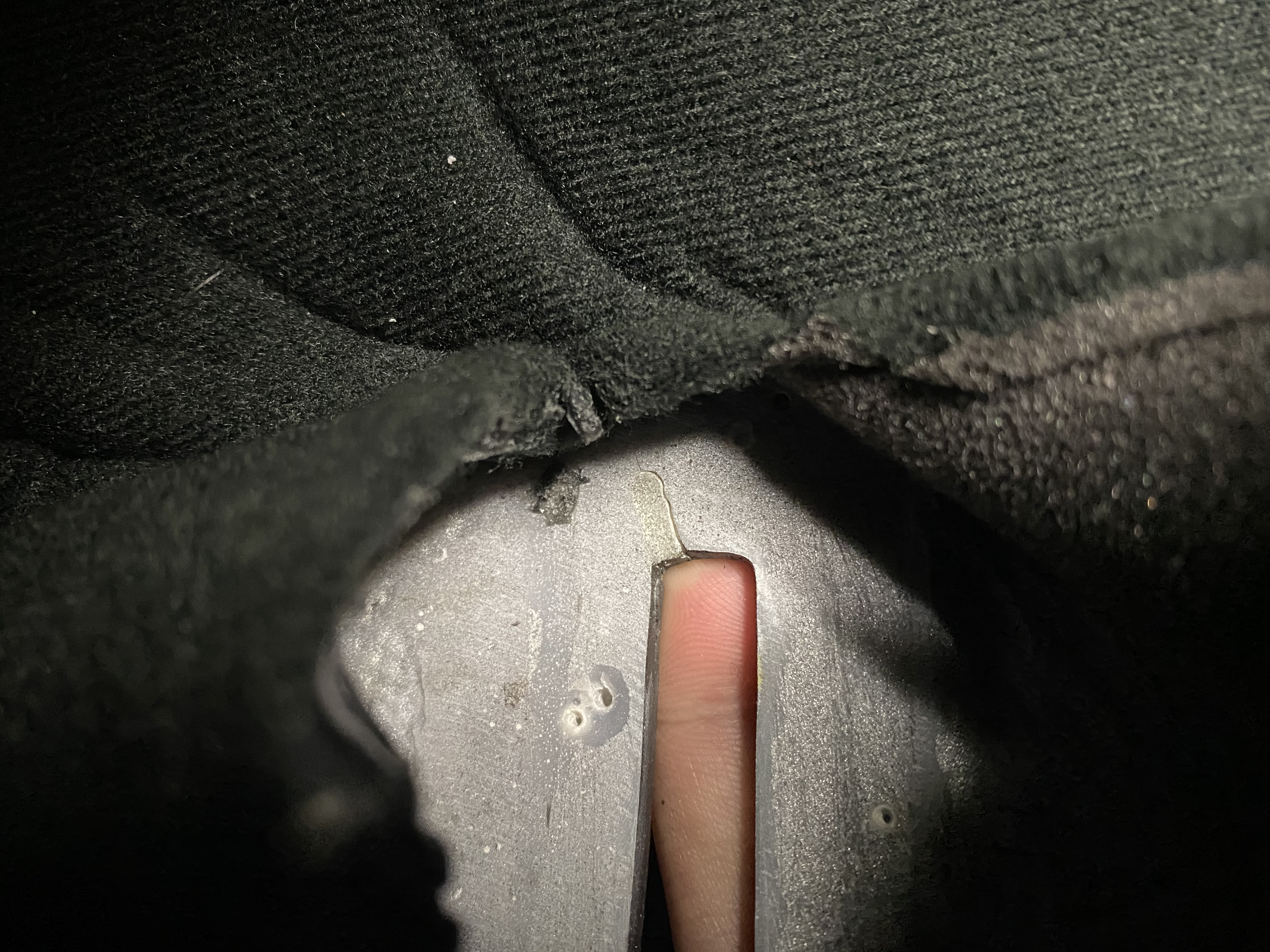

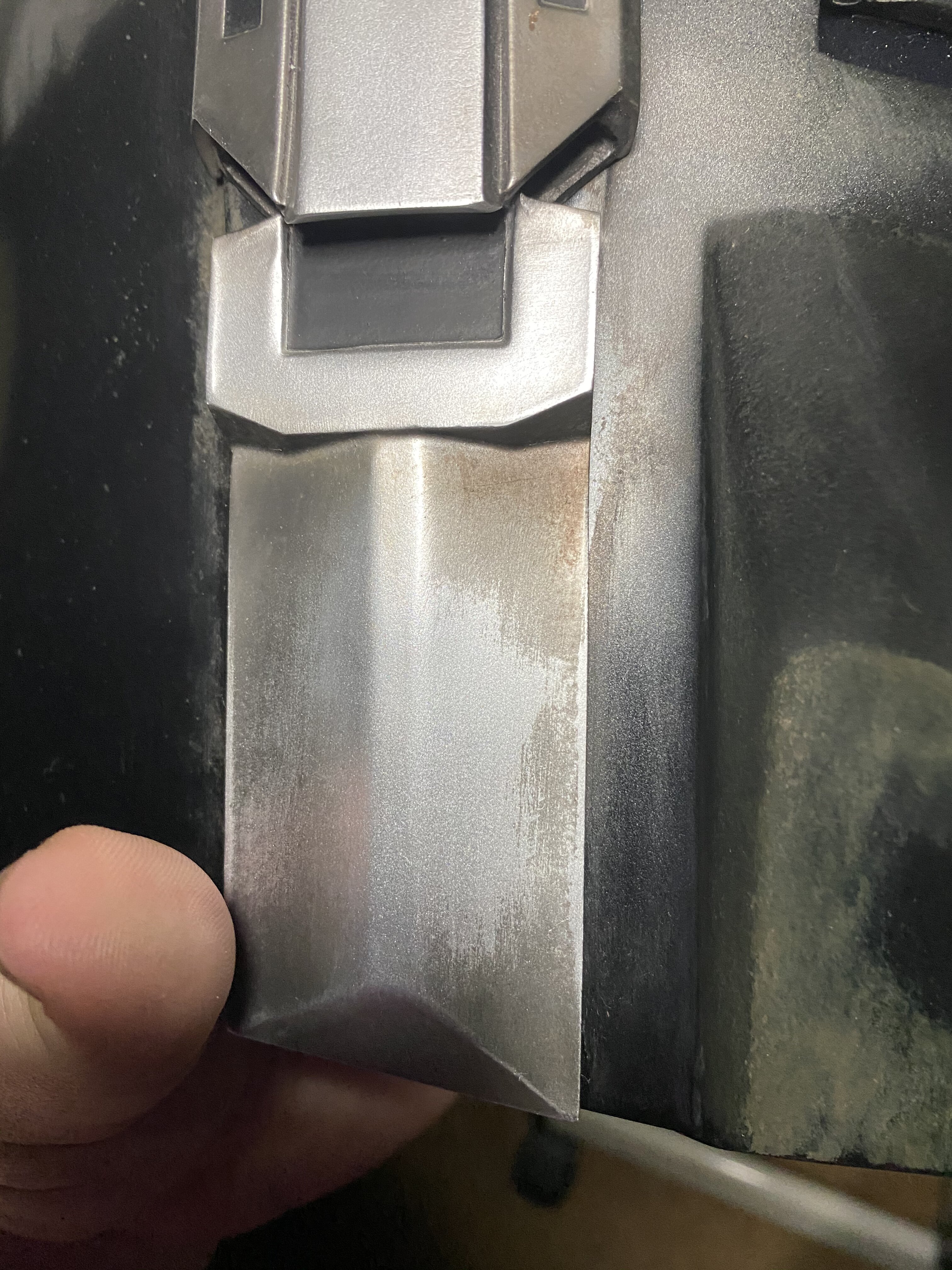

I just started disassembling the first EFX I received.
Here are a few notes.
First off, 99% alcohol does take the weathering off without affecting the base helmet. This also means it takes off the paint applied to the upper cheeks, so if you do try this, avoid those areas or have a plan to repaint them at the least. I didn’t grab a photo of this, sorry. Just imagine the helmet with a clean spot.
I was correct in my theory on their ears. They base coat the ear in a brighter silver and then used black to airbrush next to the stripes. In theory this could easily be corrected by stripping the ear back to the base metal, masking the highlight, and reapplying the black with an airbrush to tone the silver down.

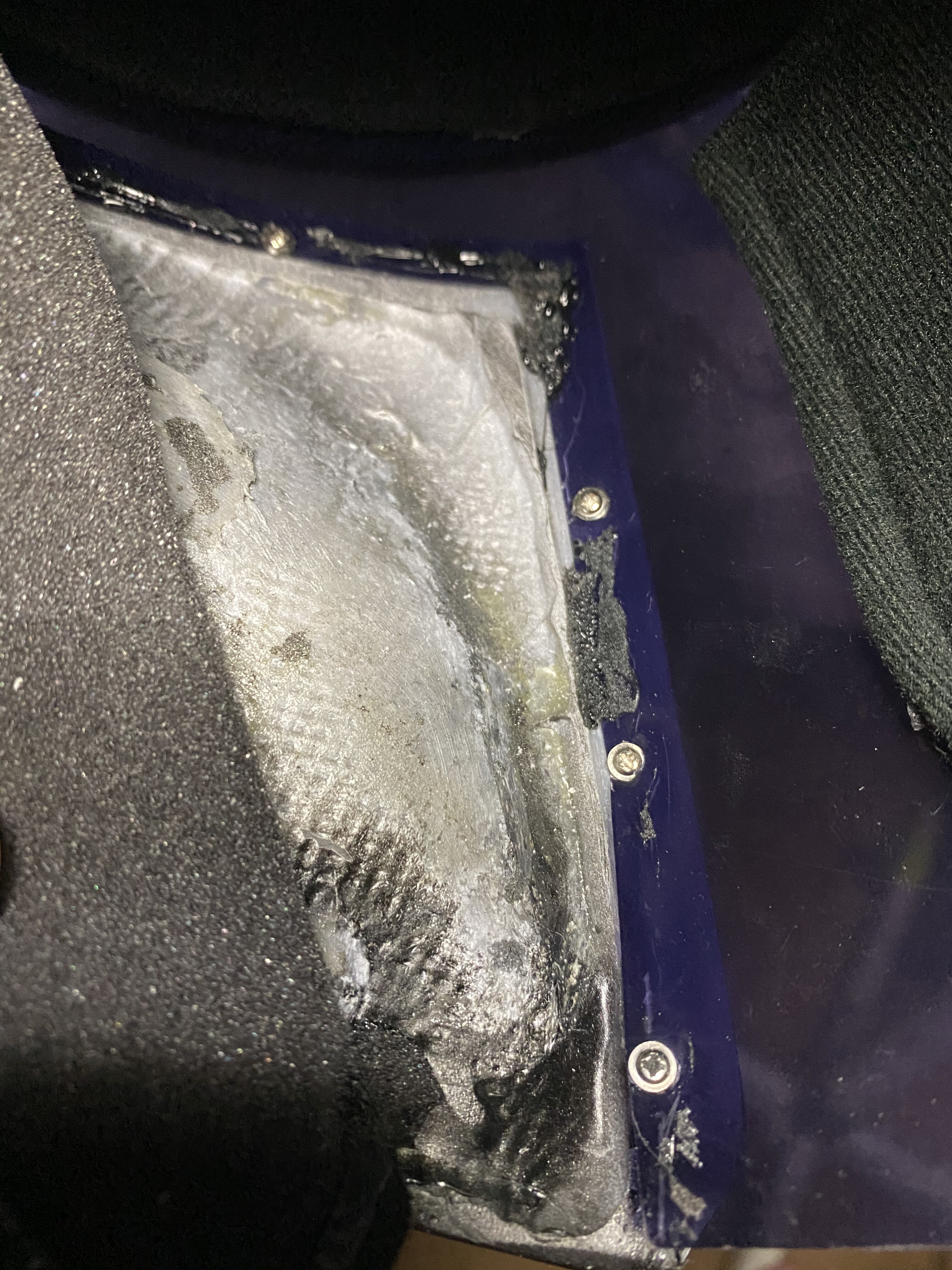

Finally, the visor, for whatever stupid reason.. has a ton of tiny screws all along the edge. I had assumed it was just glued in and couldn’t tell until I had gotten that bottom edge up. Unfortunately the liner overlaps these screws and hot glue has filled in a lot of the ends.
I just got it out and noticed another interesting thing. There are two holes in most places, (and three or four in others!) which tells me this visor must have been installed twice. I believe the visor was installed in the higher holes when I removed it, I wish I paid closer attention.
One more note. The crack I mentioned a few posts back travels all the way through the helmet to the inside. It is not just cracking in the paint or gelcoat on this particular helmet. When I removed the visor I accidentally flexed the helmet and sent a chip flying.
