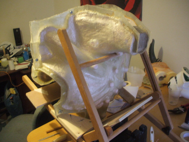

I can't put a date on it TBF, I would have started the last part of this mould last night, I was thinking about doing the rubber part with the fill spout. The problem I have now is how to support the whole thing while I build the last part :confused
Its very heavy! It was heavy before I started doing the mould but its a fair bit heavier now! I'll need to figure out a structure of some sort to support it while I do the last bit. So I'm thinking it over ATM while I'm doing some grouting in the bathroom :wacko Too many things going on!

I figured out a way support the mould so I could make the last bit :D
A folding chair! real technical :D

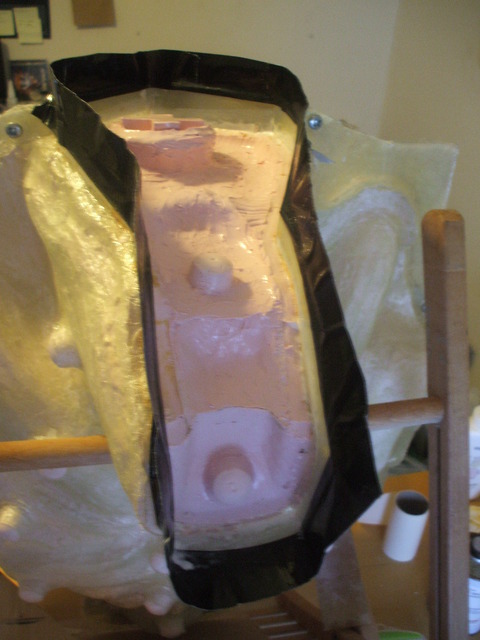

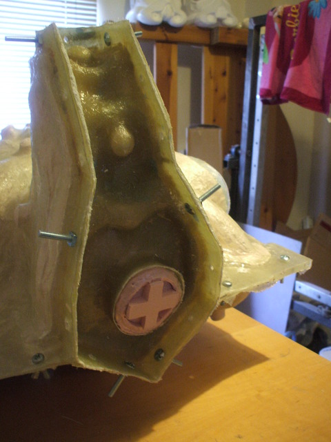

I've made the rubber part with a fill spout & plug & it's all prepped & ready for the fiberglass jacket.
Just got to get on with that now. I still need to order nuts n bolts & the casting resin for this part :)

So bust and neck are one. It is a complex piece. But the chair is a stroke of genius! :) Really good!!:thumbsup

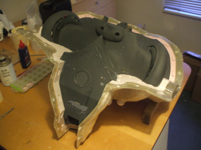

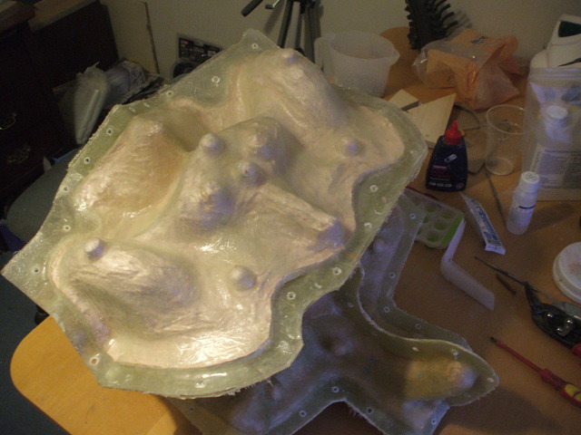

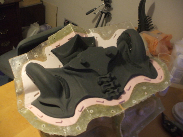

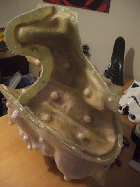

OK, I got the final bit of jacket finished :)
Then it was time to de-mould :D

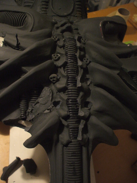

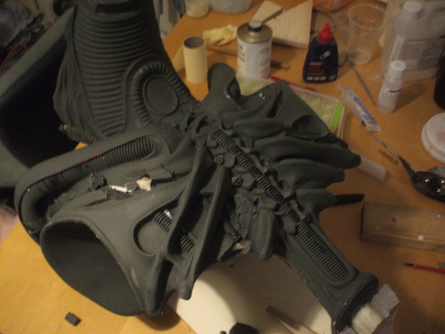

Most of this part hasn't seen the light of day for a long time:
The sculpt didn't fair too well during de-mould, the clay was like hard cake icing :confused
The sculpt is beyond repair & will be destroyed.
The moulds look good :) Need a bit of a clean up just to remove bits of paint & clay & they'll be good to go :D
