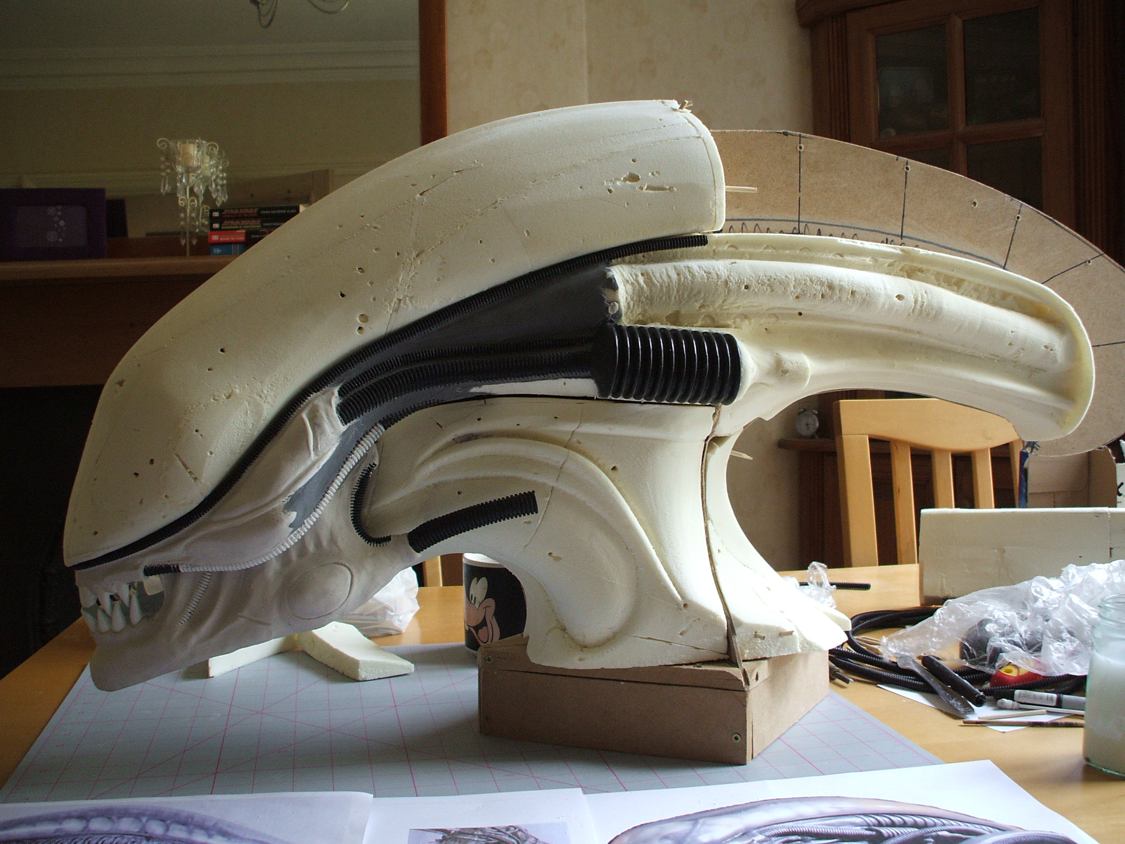

    Hi folks, I thought I'd share my project with you guy's. I'll admit from the off that I'm after some advise here & there & I'd like to know what people think so here goes....
    Firstly he's called Bob as my missus doesn't share my enthusiasm for this sort of thing & it add's a little lighthartedness when talking to her about him :)
    I'm having a go at making an Alien creature (head & neck) loosly resembling the creature from the first Alien film, its something I've wanted to do for years. Now I've never really sculpted anything before & I've never used silicon moulding material before so I'm a bit of a novice in this field but I've commited myself to finnishing this to a standard I'm happy with.
    I'm not trying to make an exacting copy of one of the original prop head's, I'm making it how I think it should look so it may not be to everybody's taste but hopefully you'll like it.
    It's at a fairly early stage at the moment & I'm learning as I go. I've read a few posts on here in search of info & found that this community seems to be just what I'm looking for.
    I'm using pic's I've found on the net & I have the book Giger's Alien for reference material as far as trying to capture the features of the Alien so heres some pic's....
    [​IMG]

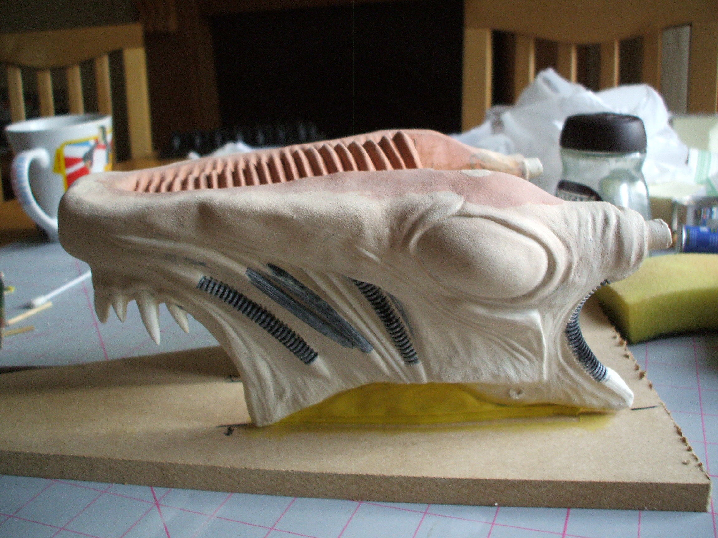

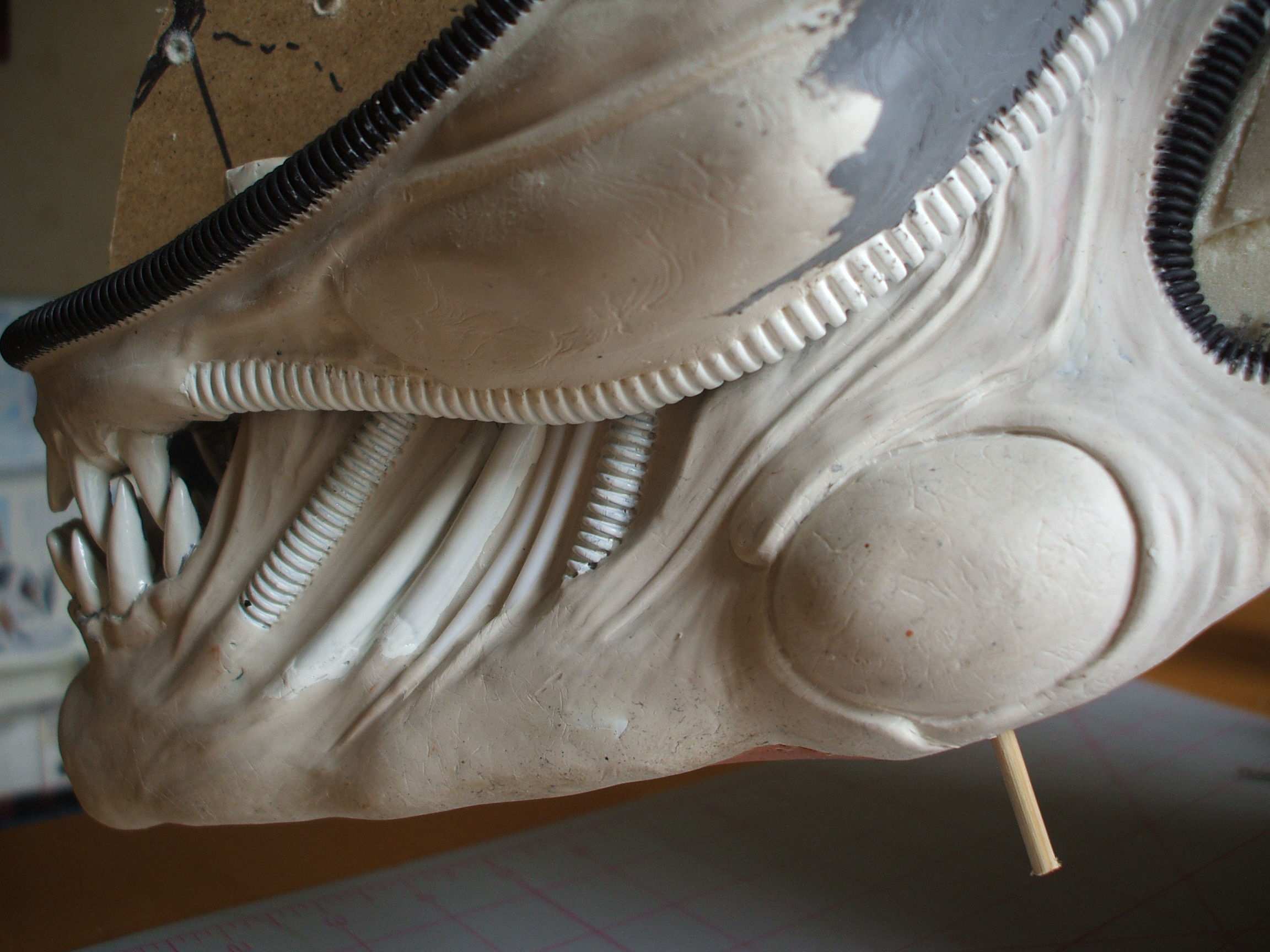

    I started off with blowing up a good profile image of the original & using it as a rough template. I then made a hardboard armature, then pinned insulation foam to the armature & then carved the foam into the shape above. From there I started adding detail with the pipework & I'm using Newplast clay for the rest.
    The Newplast happened to be available at my local artshop & it turns out its free from sulphur so I should'nt have any funny reactions from the silicon (hopefully).
    The shape of the mouth has changed a little bit as its progressed & yes there are two too many teeth in the bottom jaw, thats deliberate as I've made the front teeth slightly smaller & closer together, I've also added more detail to the sides of the jaw as I've gone along.
    With regards to the top of the head I wanted it to look right as a complete thing so I've started by roughing out the outer shell & when thats shaped up I'll start work on the bit underneath. At the moment I've just got the bottom jaw to a standard I'm happy with so I'm ready to take a mould from it so it can be reproduced in resin, I can then handle it without leaving marks in it & I can start to scuplt the underside of the head & neck to it.
    I've bought a kilo of Repsil E30 with a thickener to use on the jaw to mould it & I'm intending to brush it on all over & then use a cut line & a resin shell & separate it into two peices.
    The last pic show's the jaw textured, I lightly brushed white spirit over the surface & then textured it with a brush & a sponge.
    So what do you think?? How am I doing :confused??
    Thanks Leigh

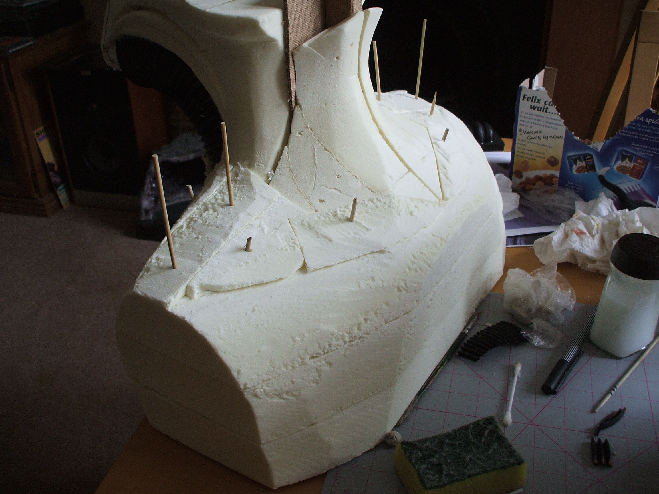

    Can you talk about how you carved the foam? This is turning out fantastic!
  7. Leigh
    Leigh Sr Member RPF PREMIUM MEMBER
    Trophy Points:
    1,830
    Re: Bob the Alien creature
    Thanks again.
    The foam.... theres not much too it really, I'd say its the easiest bit.
    Its meant for loft insulation, comes in sheets 50mm (2") thick with foil either side. Its not ideal really, blue foam (styro foam) is better.
    The foam I used is very fragile, dusty but cheap. It cuts very easily with a kitchen knife & you can sand it very easily. Once I'm happy with the shape I used PVA to seal it which works well & makes it alot tougher however once its PVA'd its not so easy to sand & makes a bit of a mess if you try.
    Sealing it also allows things like car body filler & clay to stick to it.
    Shaping it is very quick, I cut the parts out of the sheet oversized slightly, peel the foil off & then I just cut a little off at a time untill I was nearly where I wanted it to be & then sanded it smooth. I didn't try to do the whole thing in one peice...I made up the lower part of the head in 4 sections, after I'd shaped them I glued two sections together to make 1 for either side. I used PVA to glue them together (not ideal but sort of works) & I used 12" kebab sticks to pin the parts to the armature & to reinforce the glued parts.
    Thats about it really with the foam, Hope that helps.
    Edit, Heres a pic showing it with the top of the head off:
    you can see the foam sections one either side & there temporarily help in place with the kebab sticks. The upper jaw required something a little more substantial than just the foam when I started adding weight to the lower jaw so I made that part from stainless steel sheet.

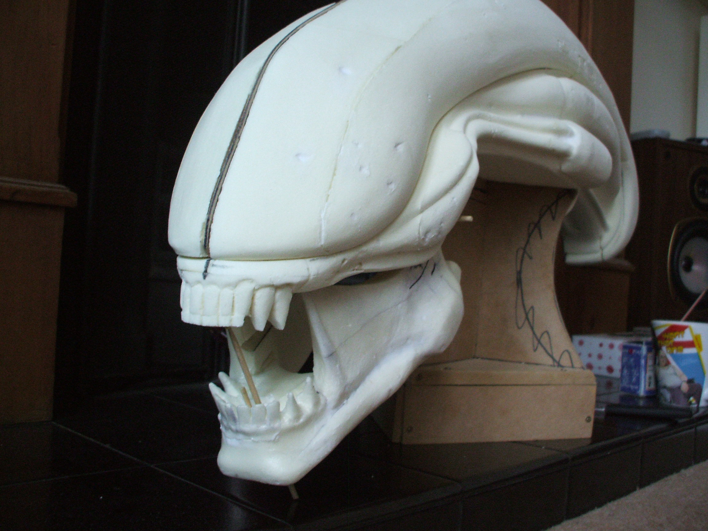

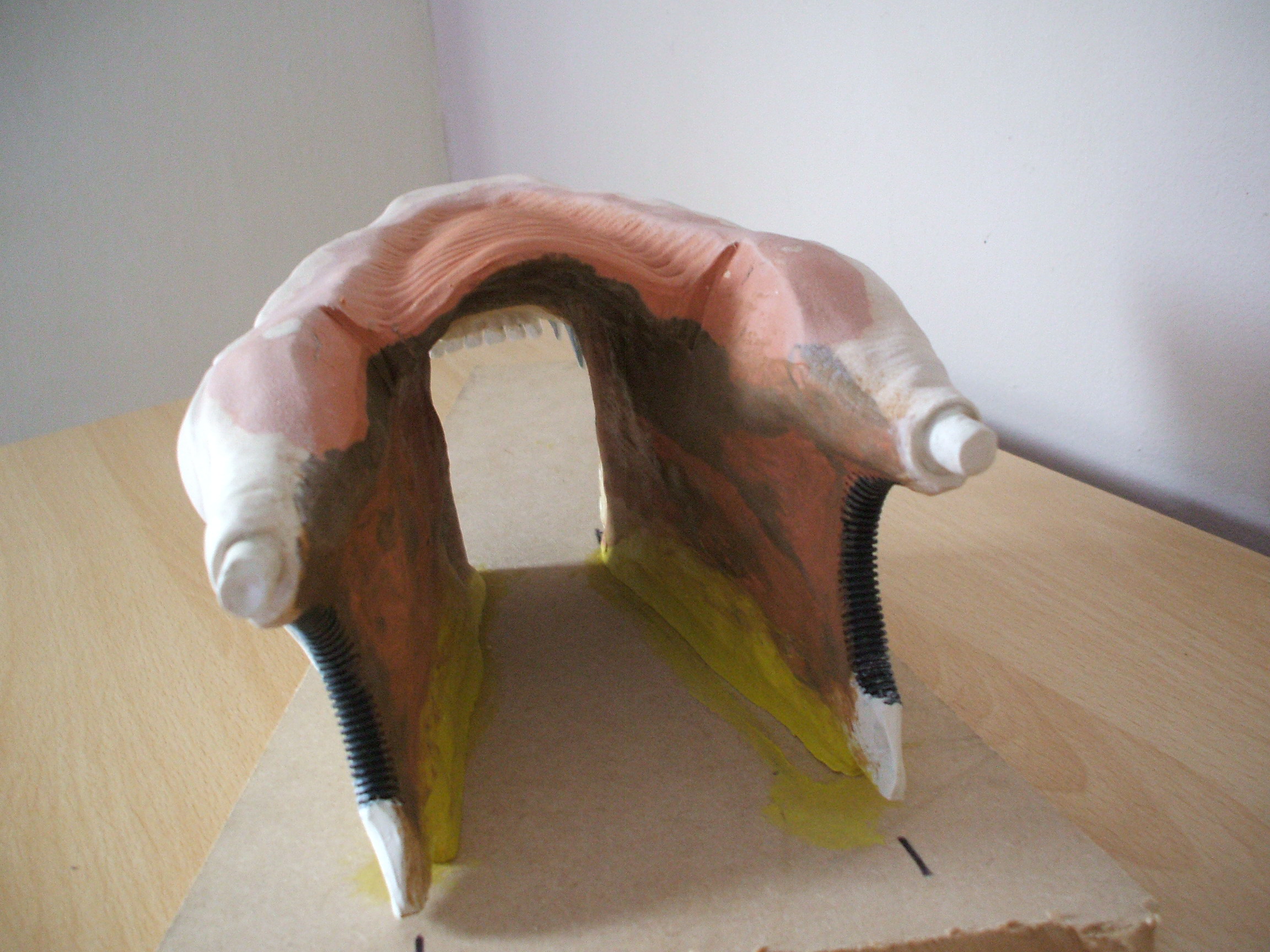

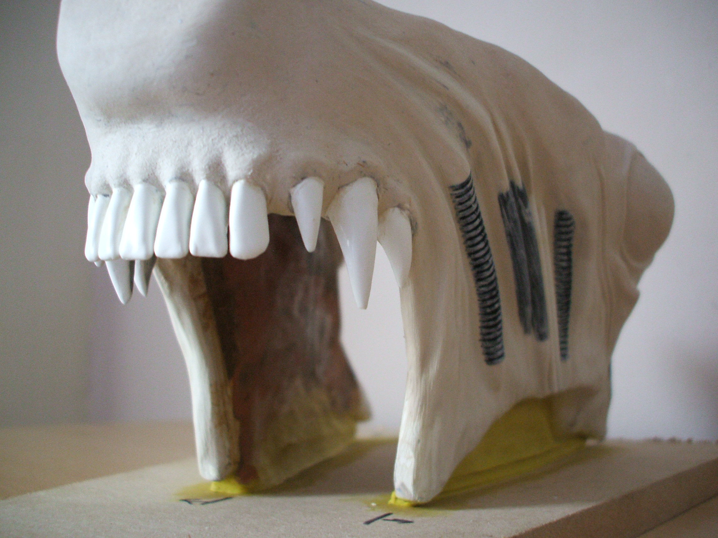

    OK my silicon (repsil E30) will be here in a couple of day's & I'm hoping to get right on moulding the jaw.
    I cant afford to * this up so I need to get it right first time.
    Can any of you moulding guru's offer any tips or constructive critisism with with regards to the moulding process & materials I'm intending to ues??
    Heres some more pic's of the jaw :
    I'm intending to brush the silicon on all over & then use a cut line from the chin, down both sides, arround the tube mountings at the rear & across the throat with the intention of pouring a solid cast from the areas that are currently in yellow.
    Can anybody see any problems I may not have considered here?
    Thanks :confused
    Edit: Should I have started this in General Modeling or is it OK here?

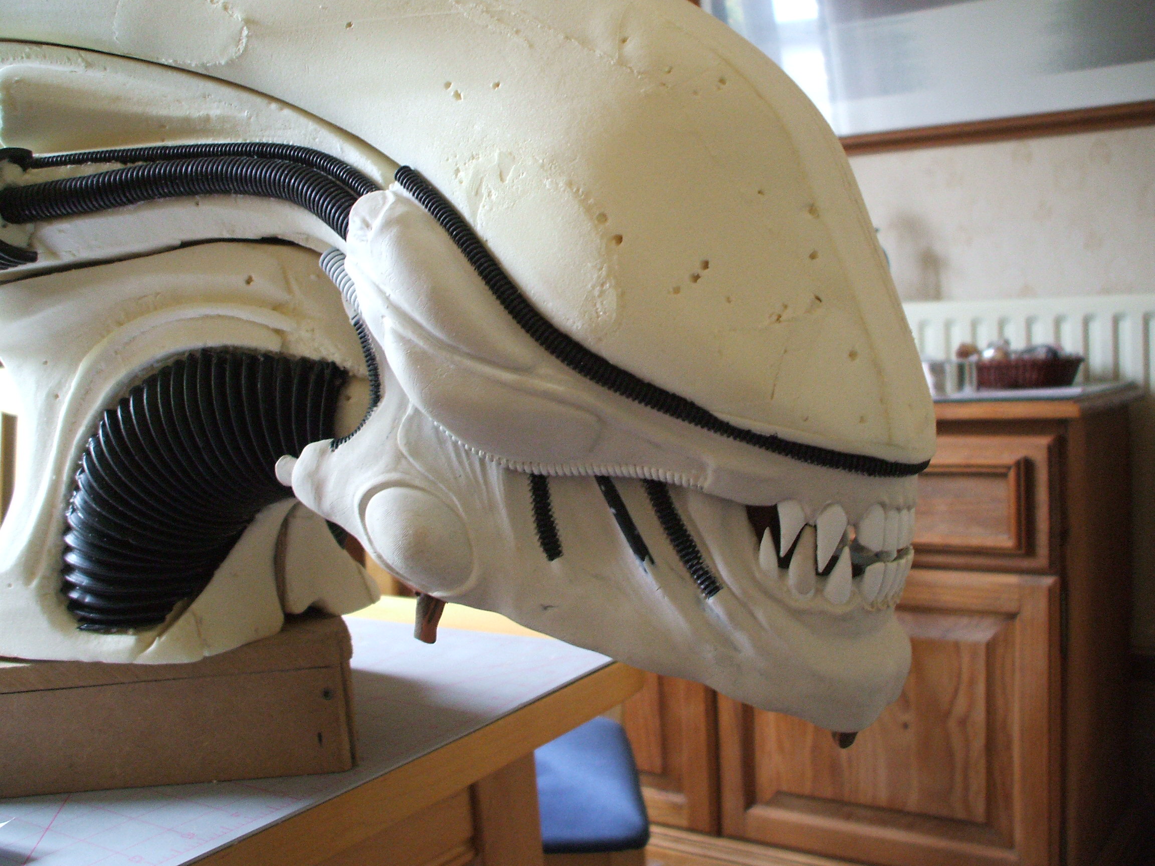

    What have you used for the teeth, it doesn't look like you sculpted those (unless you did them before the rest of the sculpt ).
    Again looking awesome. :)
  10. Leigh
    Trophy Points:
    1,830

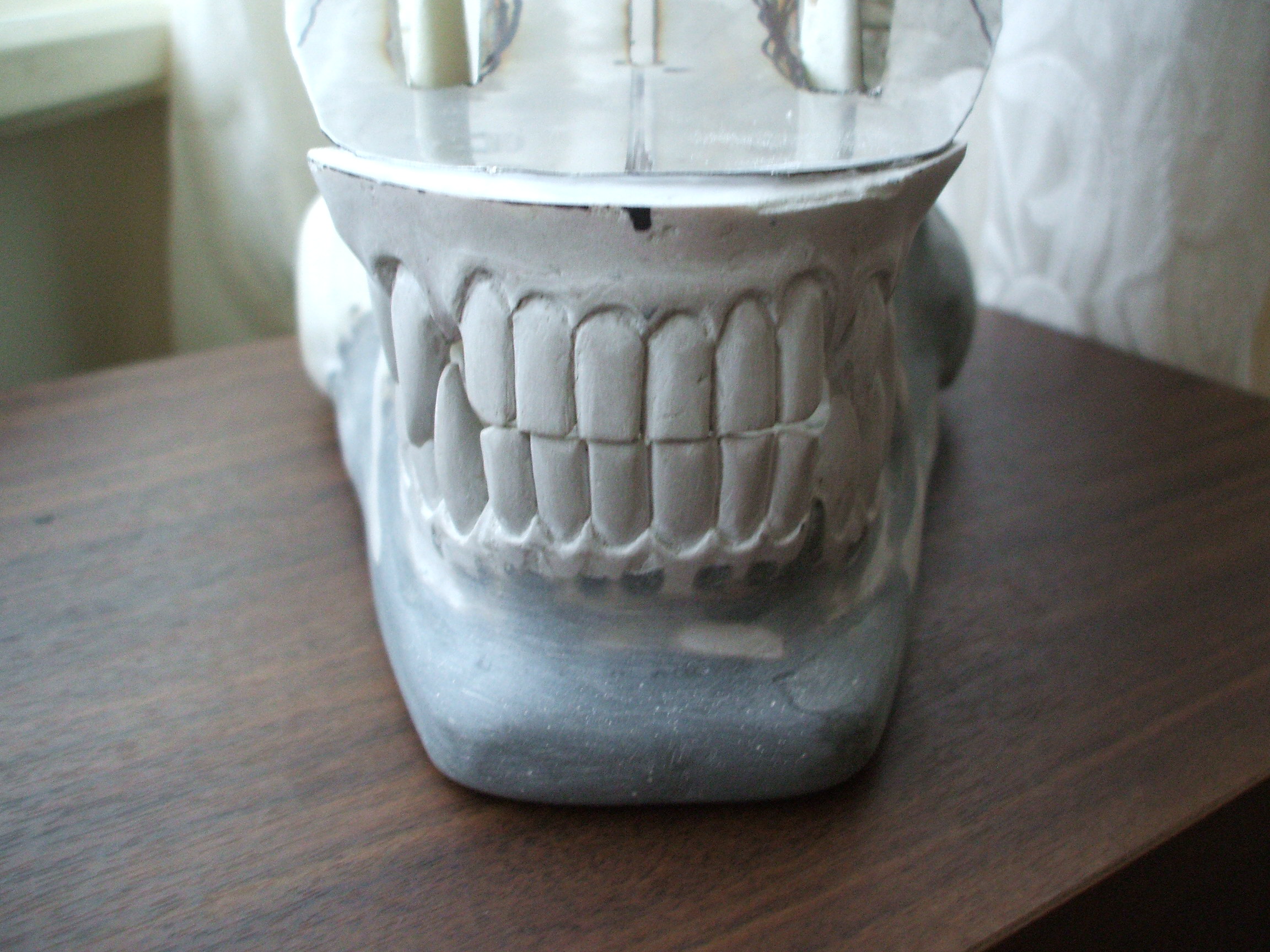

    Thanks, Yeh I made the teeth out of car body filler & then painted them with white enamal gloss paint, using enamal seemed kind of fitting.
    Heres an early pic of the teeth:
    Leigh

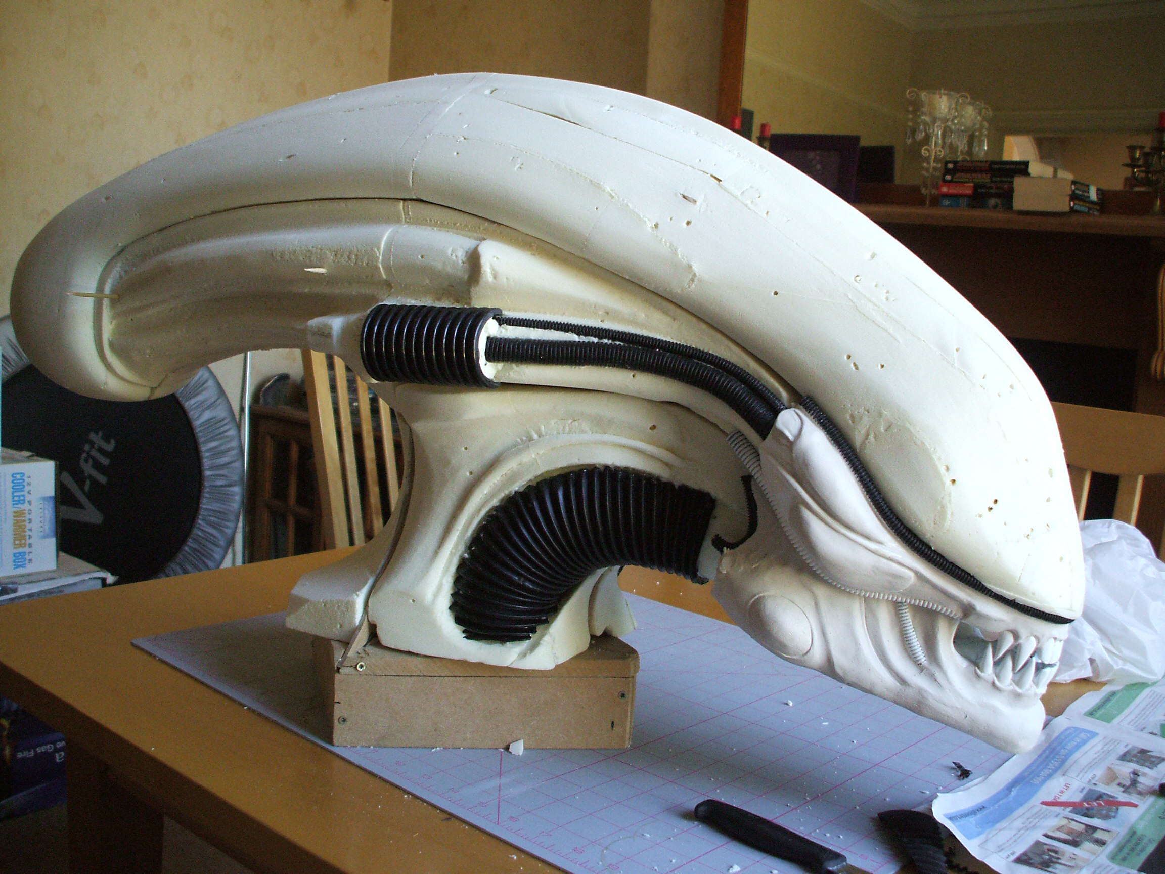

    I was thinking Maybe I should add shoulders & a small part of the back & chest ommiting the tops of the arms making it a proper bust?? in a similar fashion to the Sideshow warrior but without the pose....Any thoughts??

    As for the shoulders and upper arms/back piece. I say do them. It's
    always great to see the top part of these bad boys.
    You could always make the shoulder/back piece as a seperate section
    to where you could place the head and neck in place should you want
    to display it with or without them. Just a thought on that.

    As for molding, I think most people when they are ready to mold, they cover the piece with some sort of acrylic sealer first? That may fill in the fine detail, so someone correct me if I'm wrong.

    as far as sealing for the mold you can use pretty much anything. a friend of mine used shilack on a helmet before casting and gave it a quick spray of Pam to keep it from sticking.

    I still have alot of shaping On the upper body & I need to add more foam, its in its rough cut state at the moment but its what I had in mind.
    He's going to be leaning forward slightly rather than just posed in an upright stand.

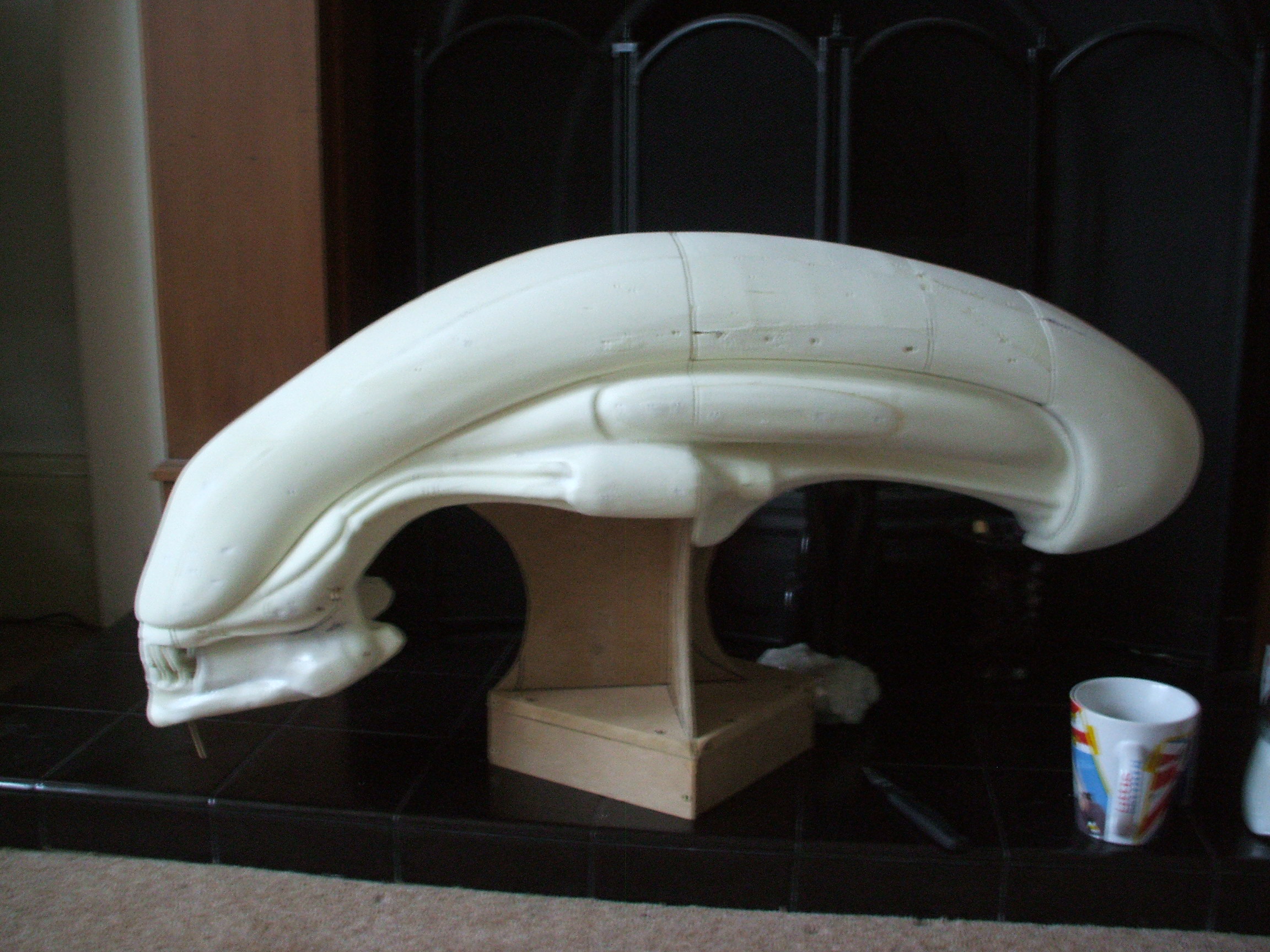

    It does look better with the head on:
    All Glued now, I'll see how it is in the morning, gotta find those muscles in the foam & then on to some detail :)

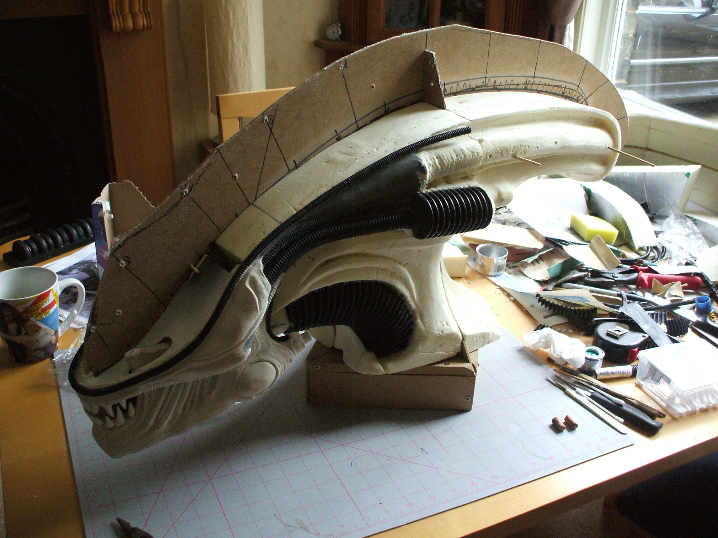

    Thanks for the great feedback :) as far as the back detail I'll get the top spiney thingy (the one in the middle top) on & hopefully the two either side top ones.
    Once I've got the body to a human shape I can start fitting those spiney things & he's shoulder pads etc.
    Done a bit more shaping up this morning but I'm back to wet glue again, the PVA only drys where the air can get to it so I have to do a bit then wait before I can do a bit more, Its comming along though slowly.

  29. crypto
    crypto Active Member
    Trophy Points:
    361
    Not knowing to much about the whole art of sculpting, I have to ask. What are the sticks for ?
    Holding it all together or there to add stuff to ?

    The sticks are for pinning the foam together while the glue dries, They also make for good reinforsement in structurally weak areas.
    They're "Barbecue Bamboo Skewers" bought from Wilkinsons for 50p, they're 10" long a little over an 1/8" in diameter & pointed on one end in packs of 100. I break them to length as I need them & re sharpen, I also shaped a couple of them for using as sculpting tools for the clay as I dont have any proper clay sculpting tools.
    Edit: I also dont know alot about sculpting, I'm learning as I go, This is my first sculpting & moulding effort but I am determined to do a good job of this.

    Cheers guys :), I've been busy the last few days attempting to mould he's jaw.
    I made a major * up, I didnt think to use a release agent on the silicone mating surfaces so it stuck together :cry
    I managed to salvage the mould but the original jaw didnt fair so well:
    The mould & the sum of it parts:
    I decided to test the mould with very watery plaster of paris & cast this:
    After all the trouble I'm quite pleased with how its come out, very little flashing & I'll need to do a little bit of cleaning up on the teeth but otherwise I cant complain.
    I've learned alot through these little mistakes, hopefully next time I'll know what I'm doing :confused:)

  43. Leigh
    Trophy Points:
    1,830
    Re: Bob the Alien (Giger Alien)
    Just another pic with he's new (temporary) plaster jaw fitted:
    I must admit I'm pleased with how he looks :)
