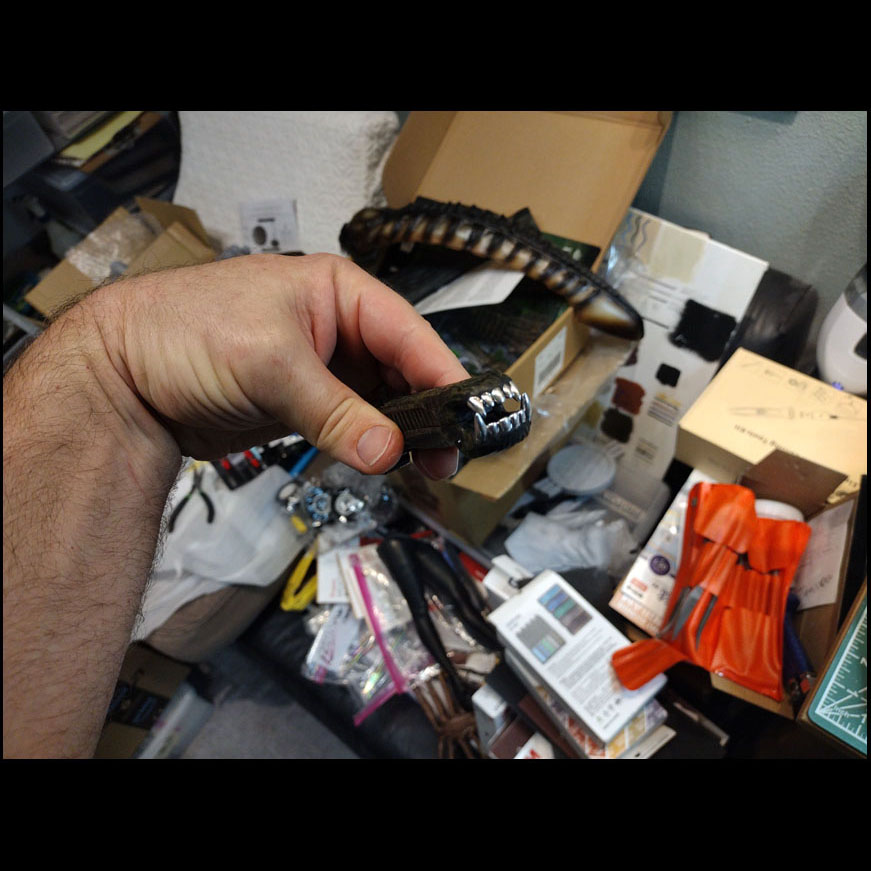

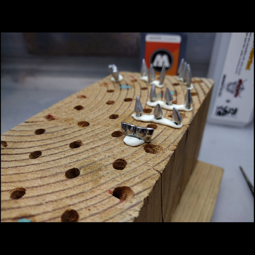

First thing was painting the teeth. They were a dull silver. I used Molotow Chrome and a brush, one nice thick coat and let it self level. Upper teeth done.

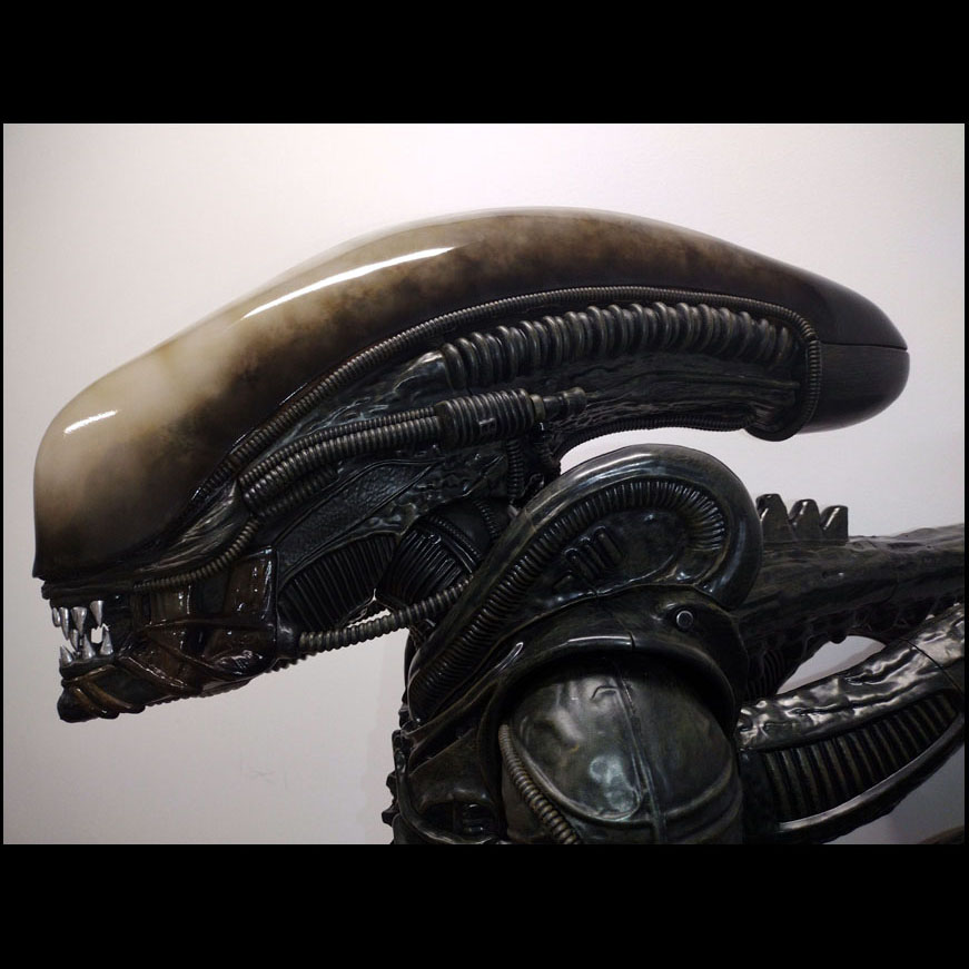

I first toned it slightly with brown ink.
Then slowly snuck up on darkening some areas to give it a bit more depth and create transitions.
Then black ink for more dimension and to tie it in with the OEM black areas.

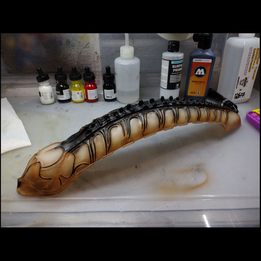

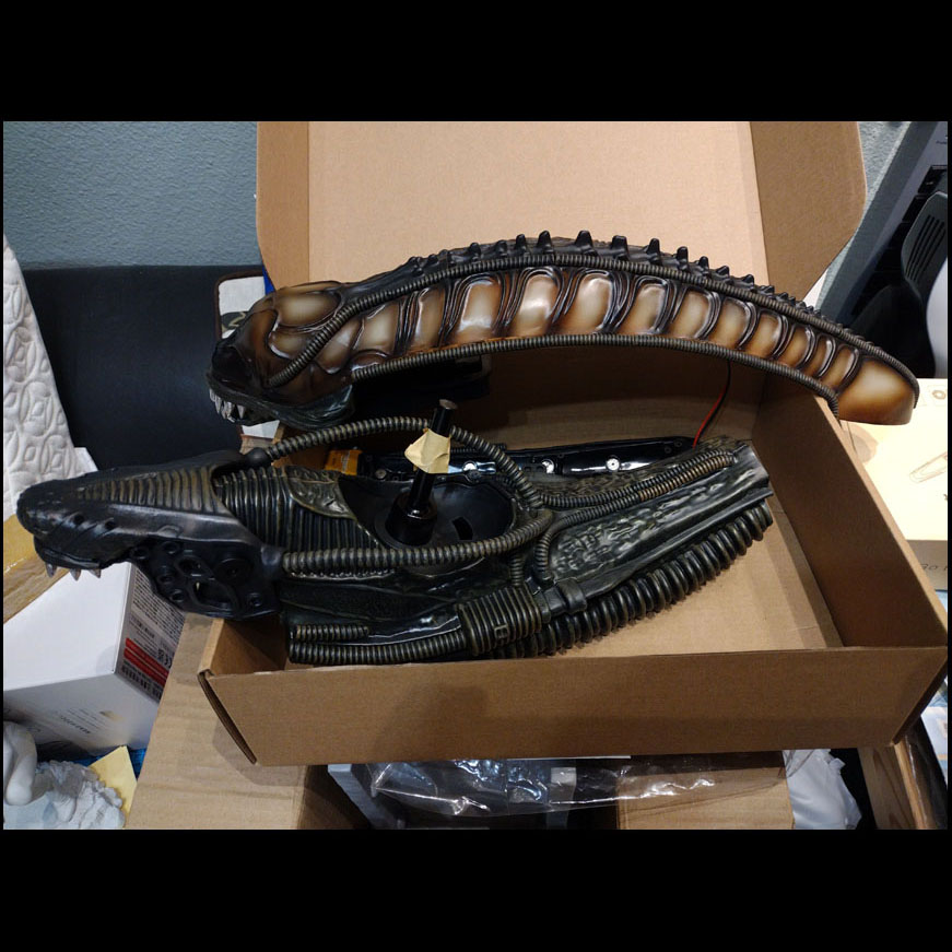

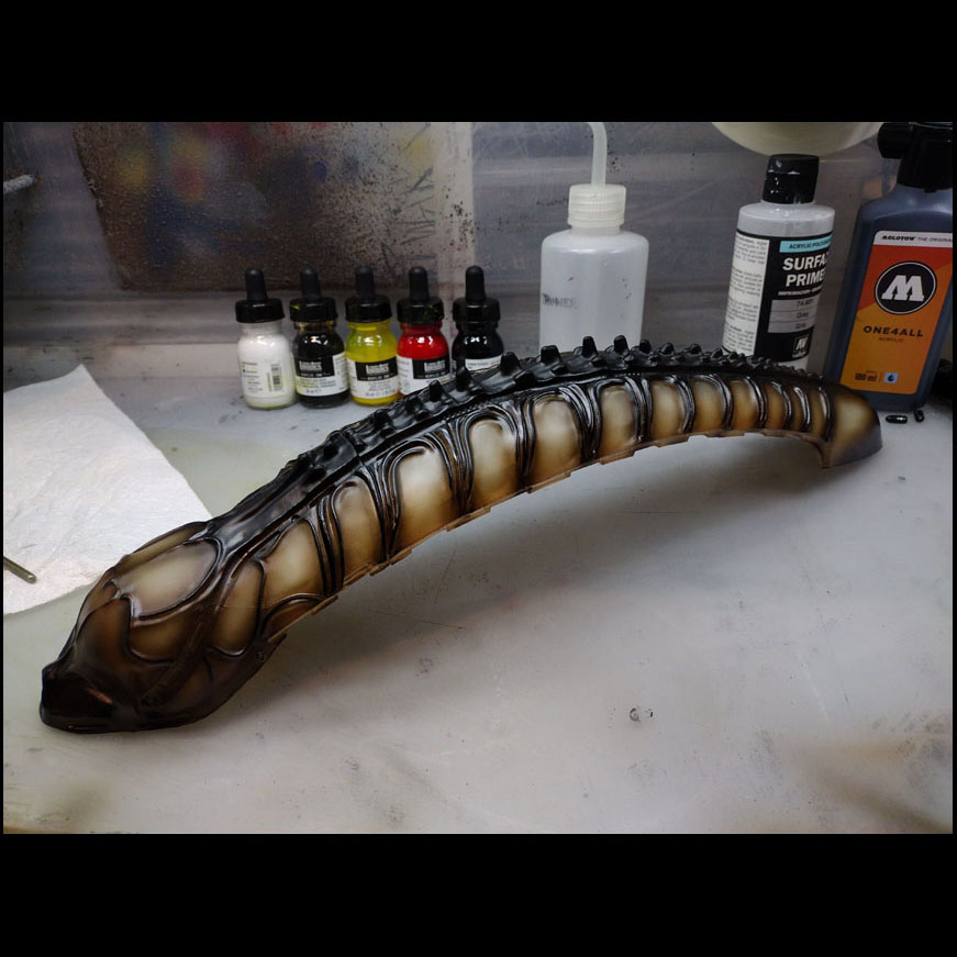

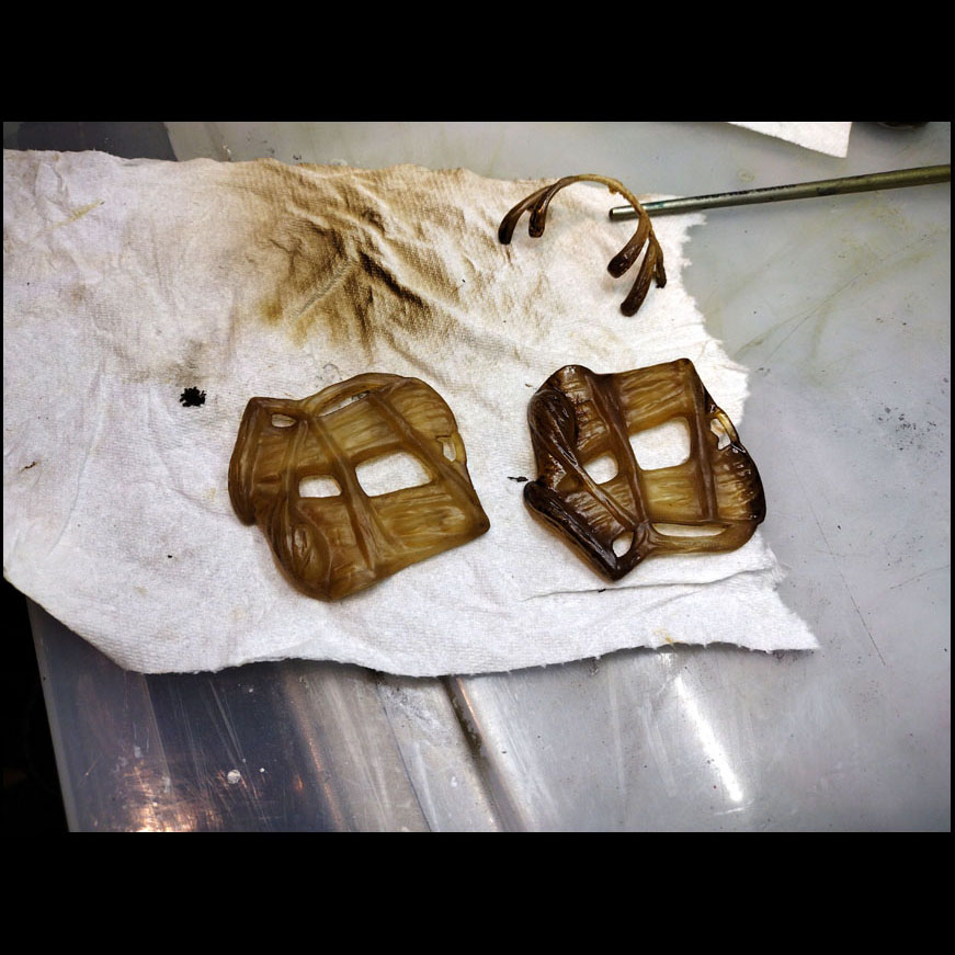

The OEM "color" of the mouth tendons was terrible. Stood out like a sore thumb. This is as much paint as I could remove with files (couldn't risk a harsh remover), and the plastic is dyed.
Like the head I airbrushed brown and black inks to give it a uniform tone and then to bring out depth. The black was done darker at the edges to help transition the tendons to the mouth.

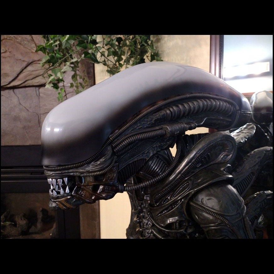

Tendons with head.
Also painted the teeth of the inner jaw.

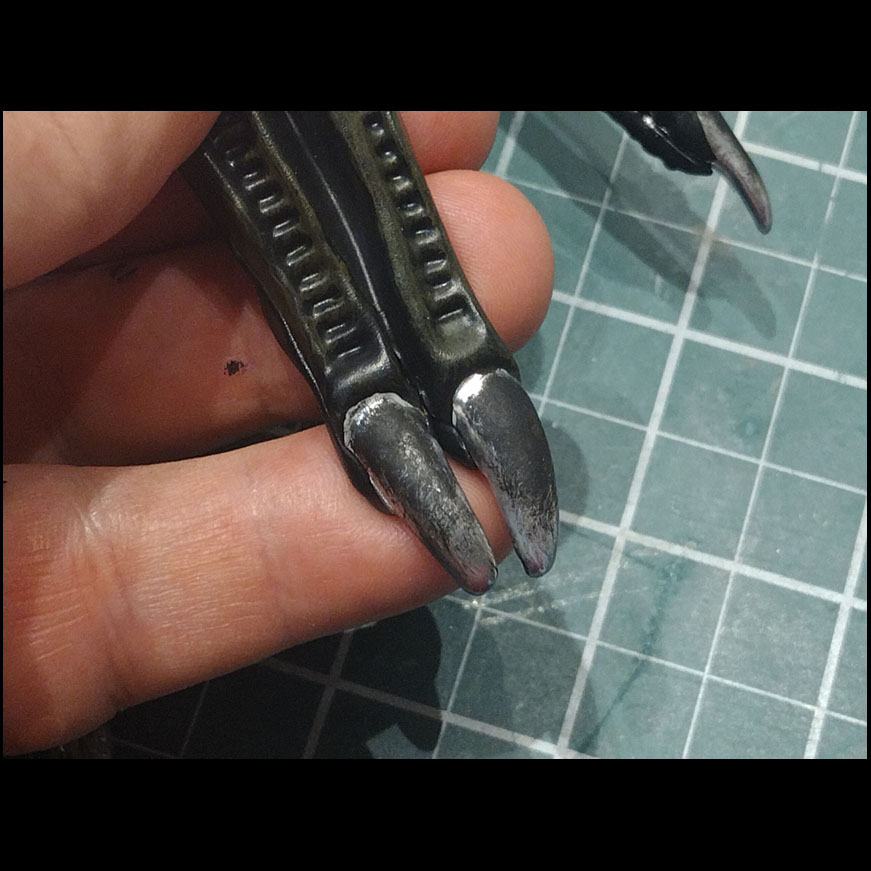

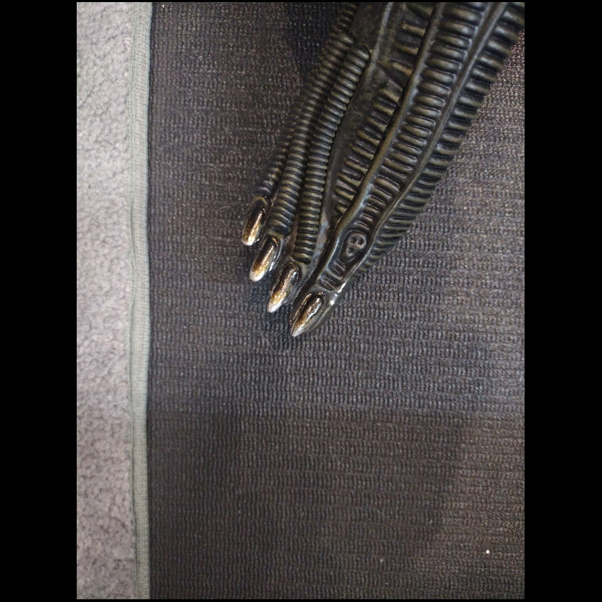

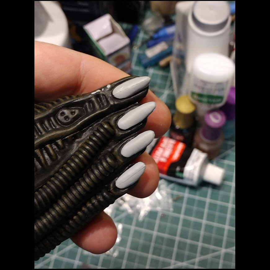

Now let's do something about those nails....
Gross, right?
After sanding the seam lines smooth I painted them Chrome like I did the teeth. Yes, I know the real nails were clear (Lee Press-On I think), but I can't turn these plastic ones clear. And chrome and some drybrushing should give them appropriate depth and also tie them stylistically to the changed I made to the head.
Like the body of a DeLorean I sanded the black paint unidirectionally to add a little texture.

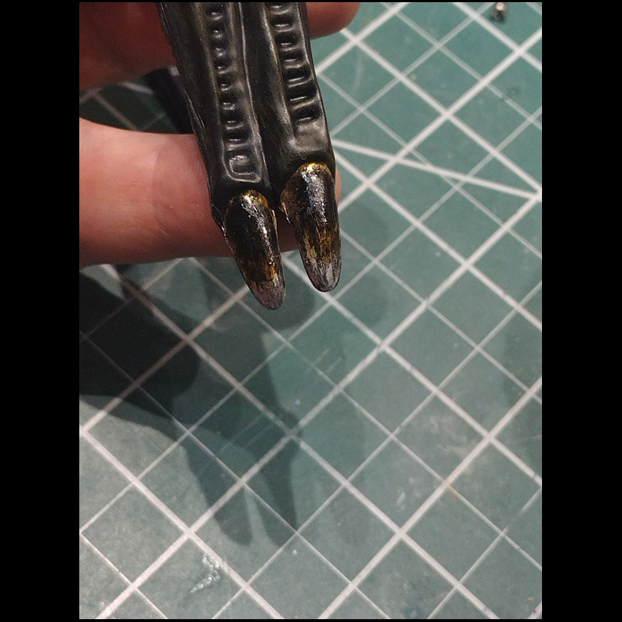

Then stained them with the brown ink and one of my scrungy brushes.

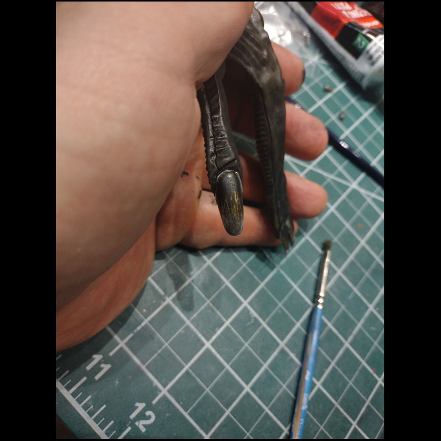

Glossed them with a little Liquitex High Gloss Varnish (the toes are rubber so I wanted a flexible clearcoat). To be honest they don't look that great up close.

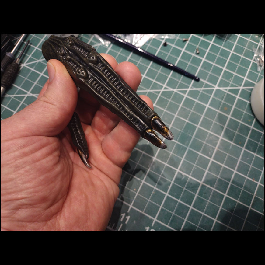

But at viewing distance I think they look pretty good. Note: This pin was before I cleaned up the overpaint around the cuticles.
Little piggies.

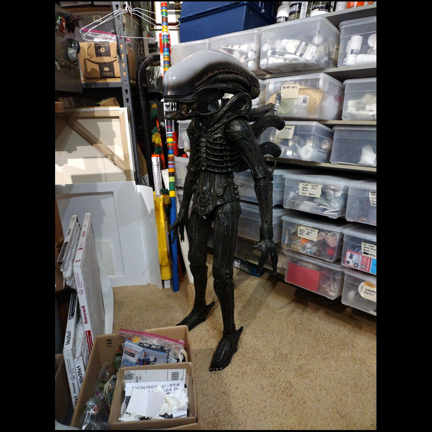

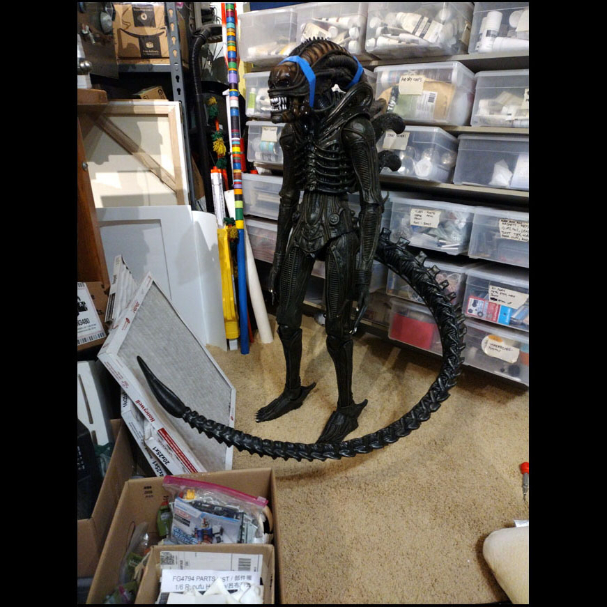

Time passes. LOTS of time. And I got him built. Mostly.
And this is with the supplied dome. We're gonna circle back to that, because....yuck!

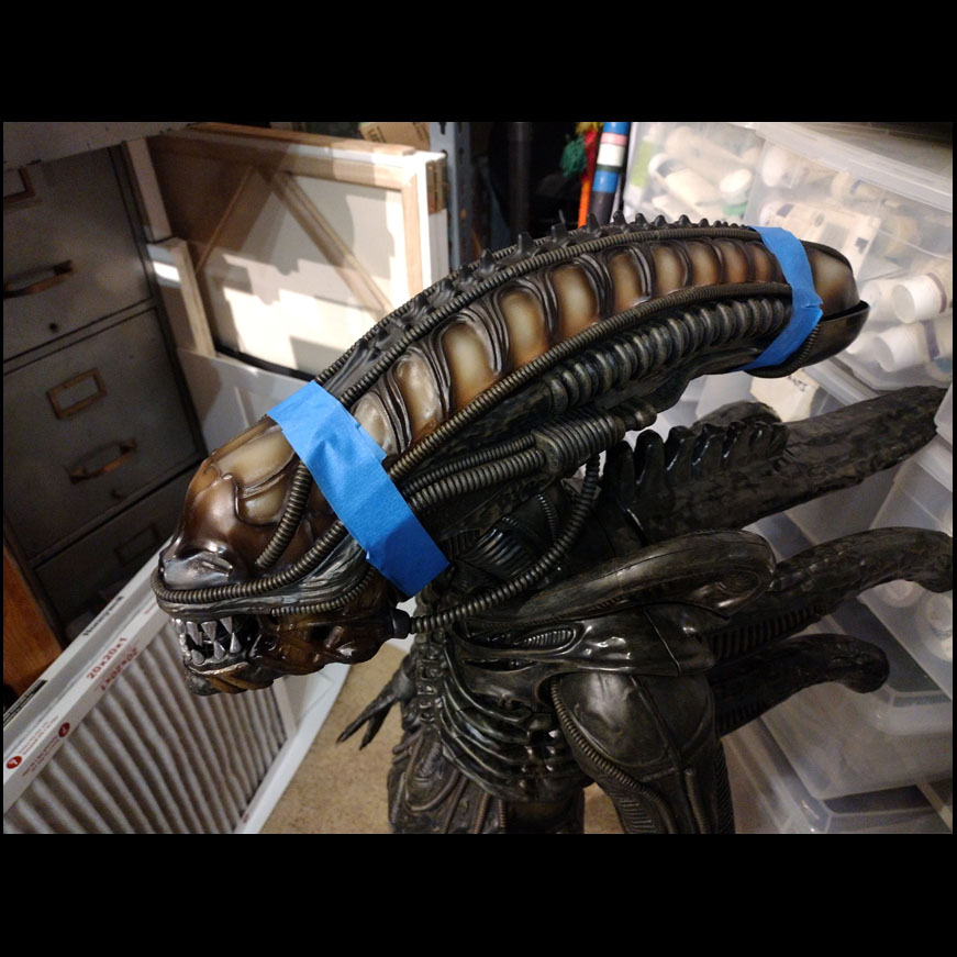

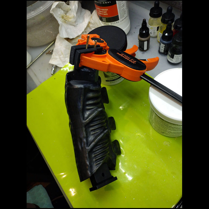

Fun fact. I wanted to clamp the head top on the secure lower portion (still needed it loose to check on internals), but didn't want to risk tape pulling off my paint. So I wrapped this blue tape around it sticky side out, then did anther loop over that using the sticky to snug up the fit. Made a pretty good, and safe, clamp.

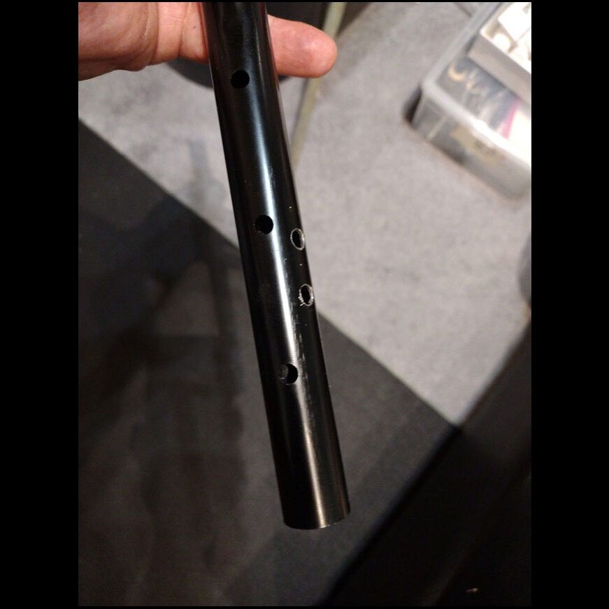

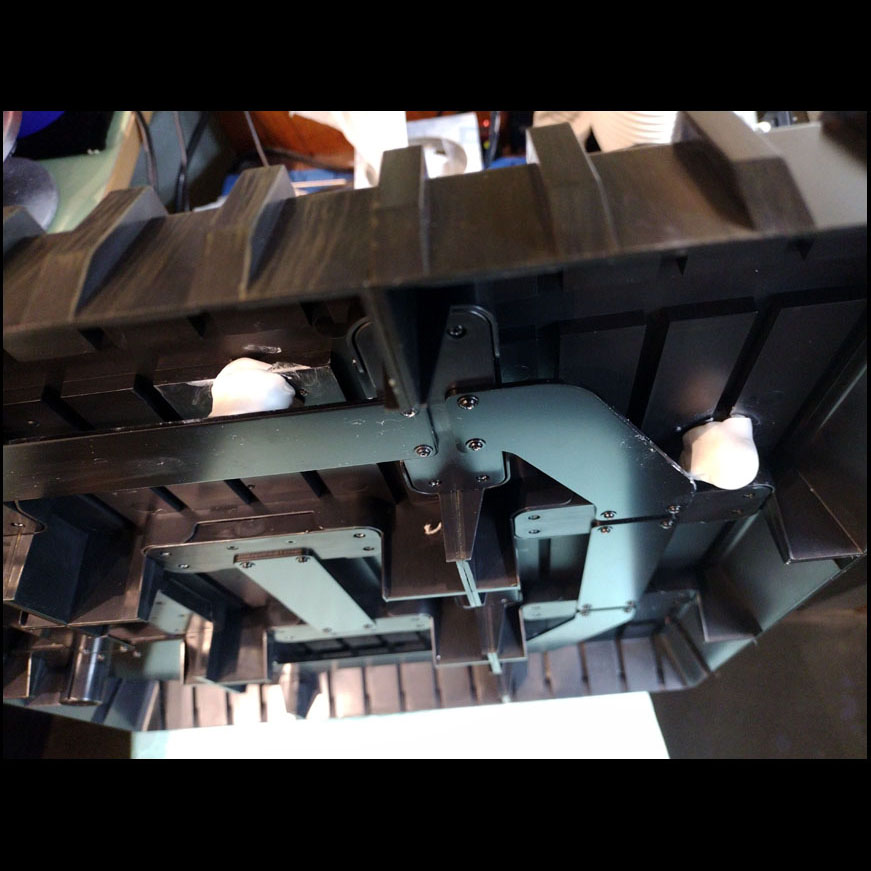

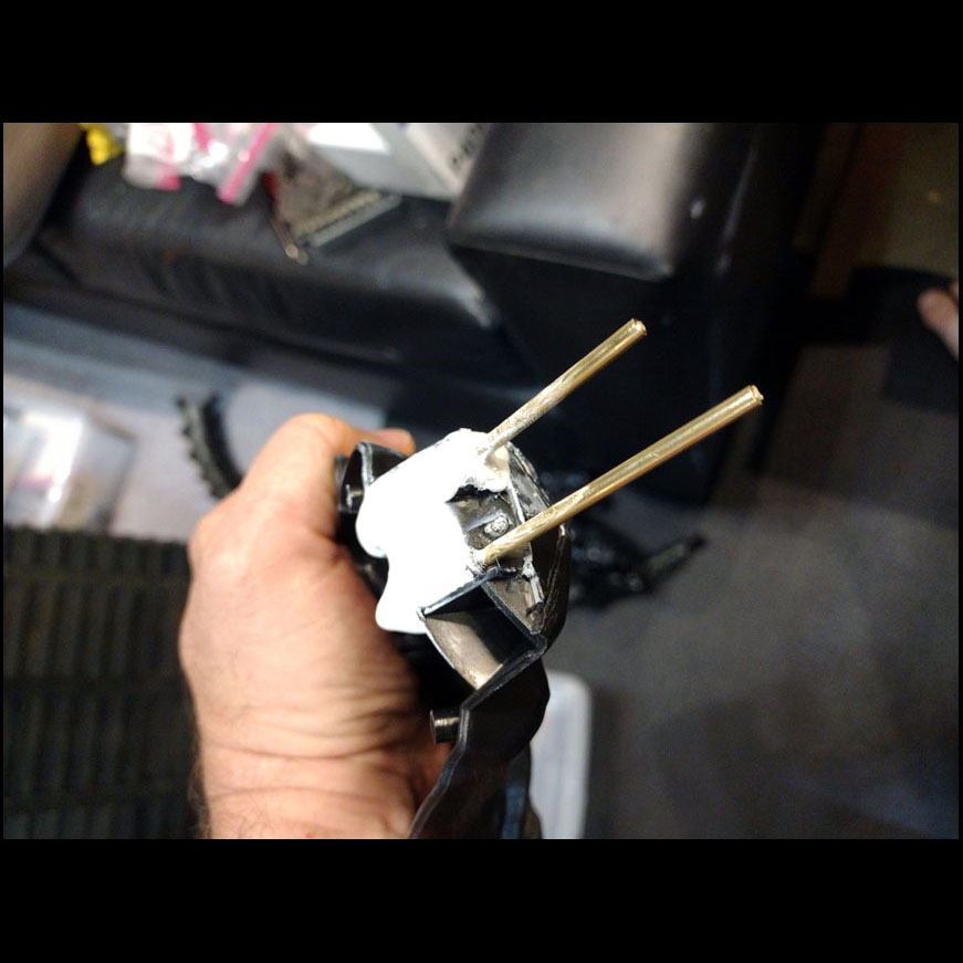

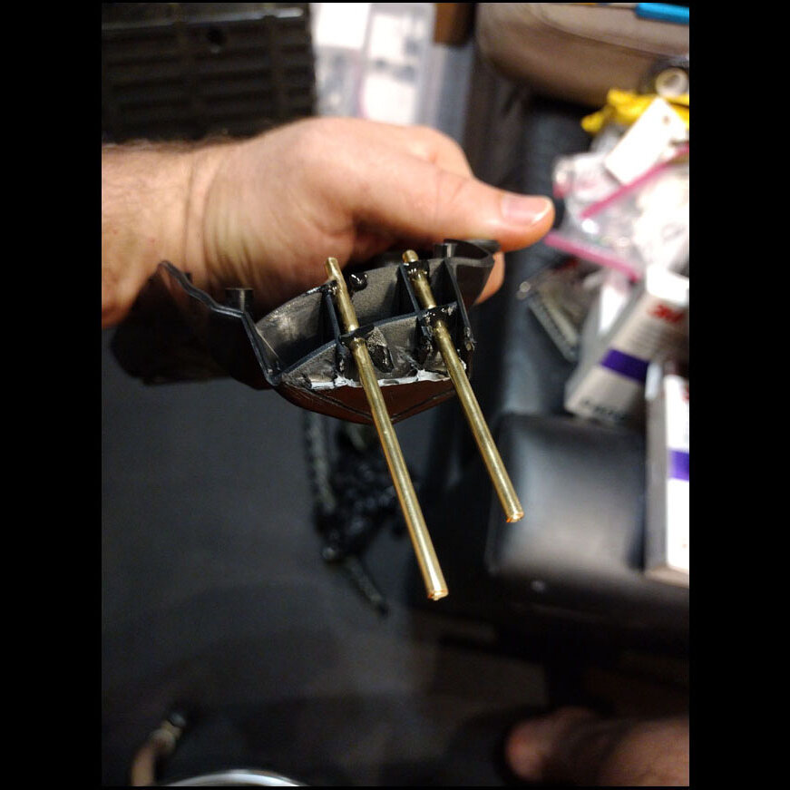

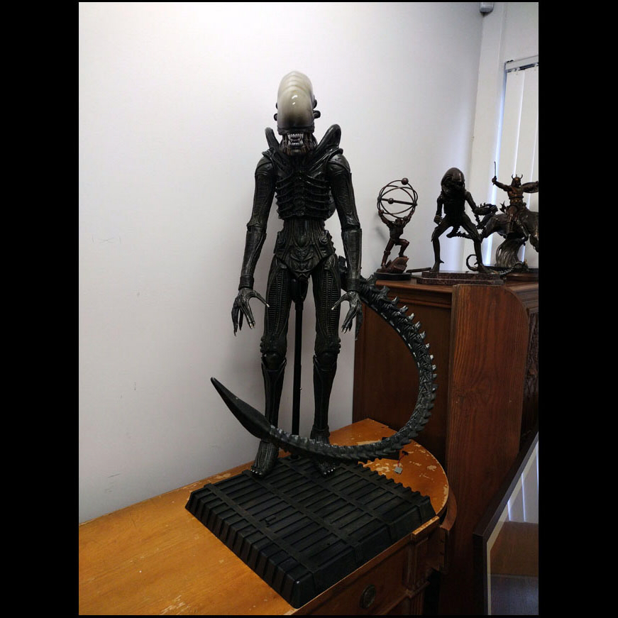

Now to fix the tail. There are two REALLY stupid design flaws with this kit. One is that the tail has NO physical connection. And second: The base's stand is supposed to support the ENTIRE heavy xeno by just touching the tail in one spot. I don't know what they were thinking. Instructions say to simple epoxy the tail into it's socket....Ok, so now it's 4' tall and 2' deep and 2' wide with a huge lever arm on a non-reinforced connection supporting 8lbs.

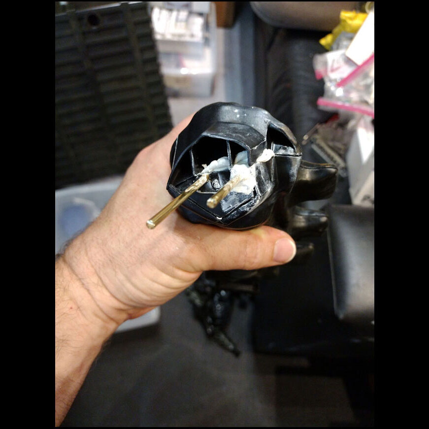

So I did some surgery on the end of the tail and his, um, rectum, and decided to try pins and a magnet. The former to support load and the latter keep it from sliding perpendicular to load. This is half of the tail base, drilled (sloppily) and pinned.
Then Apoxie shoved all over it with excess and clamping the two tail halves together.

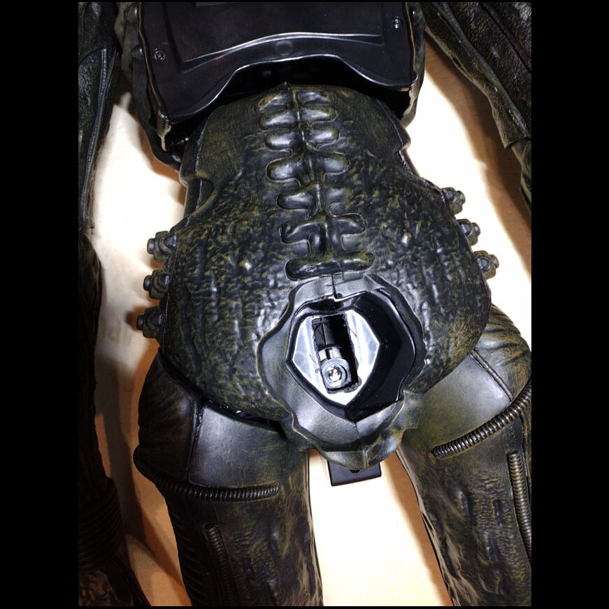

This is his butt. It's a little butt. And within this little butt there isn't much depth for pins.

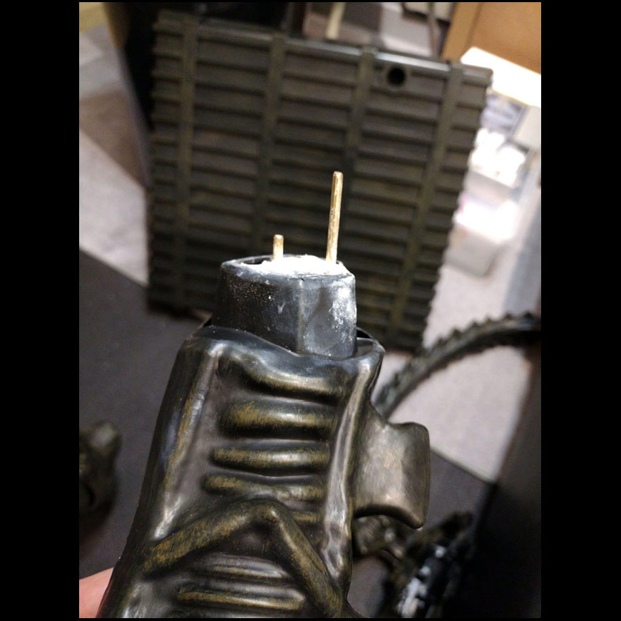

So I had to trim one. But it's enough to keep the tail indexed and the big one is overkill for load.

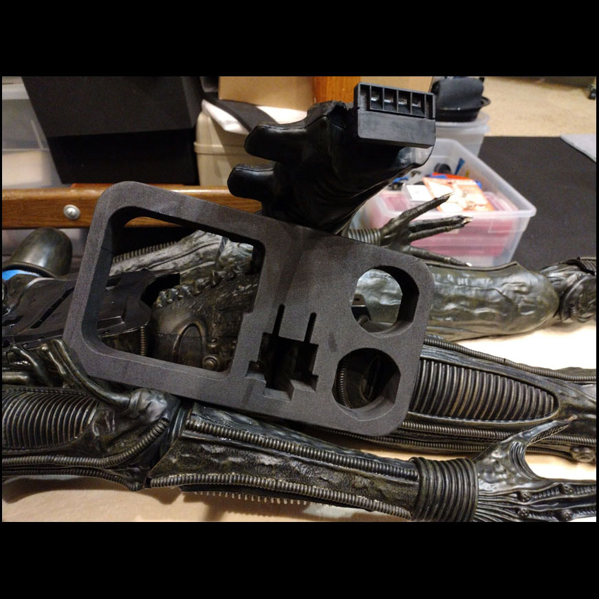

So I filled his butt with Apoxie, inserted the tail and used this piece of foam to hold it overnight at the right angle while the Apoxie cured.

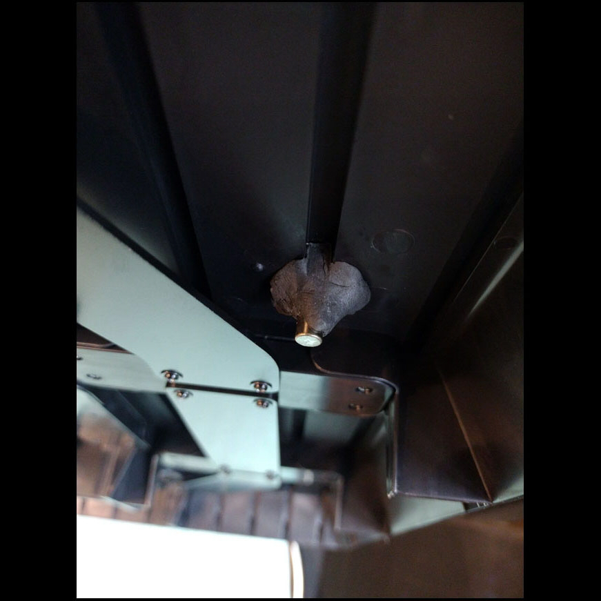

Removed the tail, cleaned up the Apoxie, and drilled a recess for a magnet (also added one to the tail).
And it worked! He's leaning back on his dorsal growths but that tail is completely unsupported besides the connection I made.

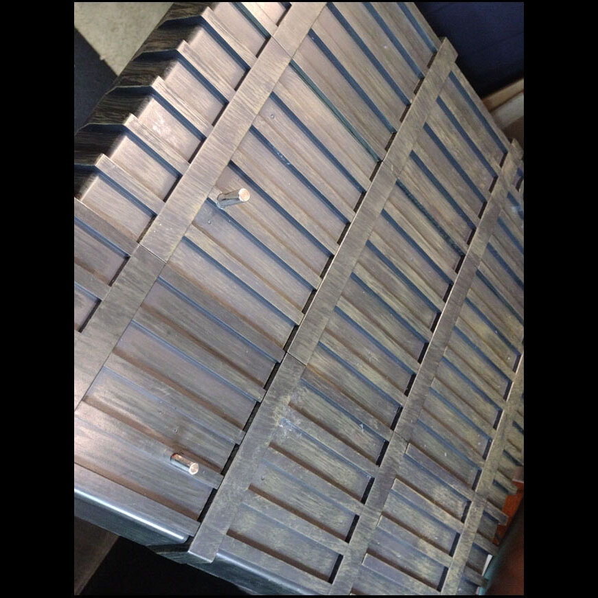

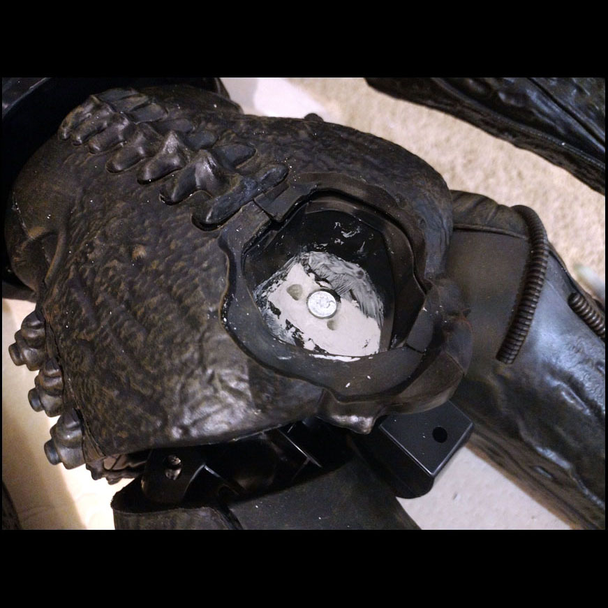

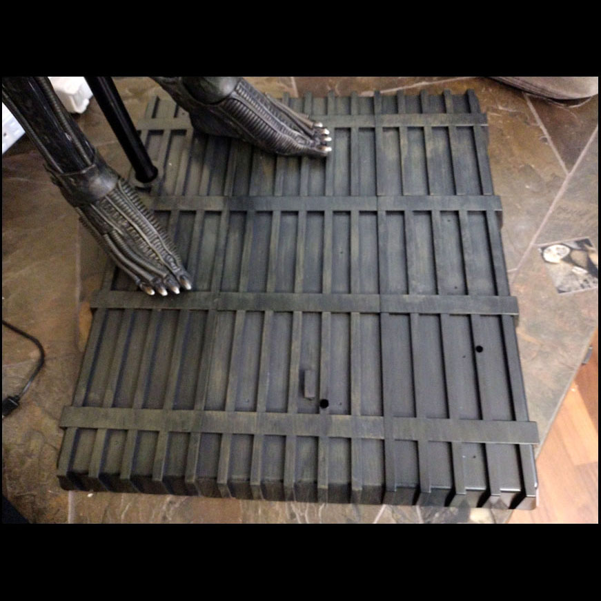

Now about that other problem. The tail should NOT be responsible for all this weight. And the supplied post is very strong and the plastic end pretty much wanted to be a crotch grabber, which makes SO much more sense for a figure like this. However the keyed hole for this post was at 1 corner of the base. Long story short: I had an idea and clocked the post 45 degrees and then drilled these two holes to give me some wiggle room for height.
Then I drilled two holes for someone else's foot pegs. I used ProPoxy20 for the structure of these peg holes, because the figure is really heavy.
Then bulked the areas out with Apoxie for more compressive support.
Pegs in place.

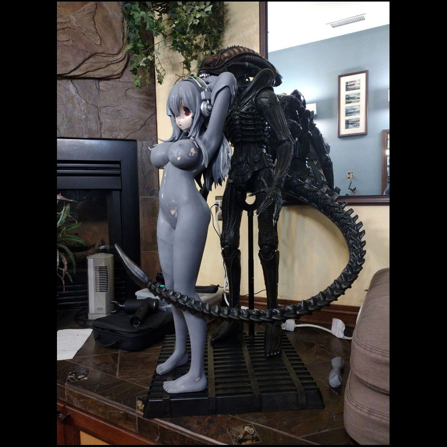

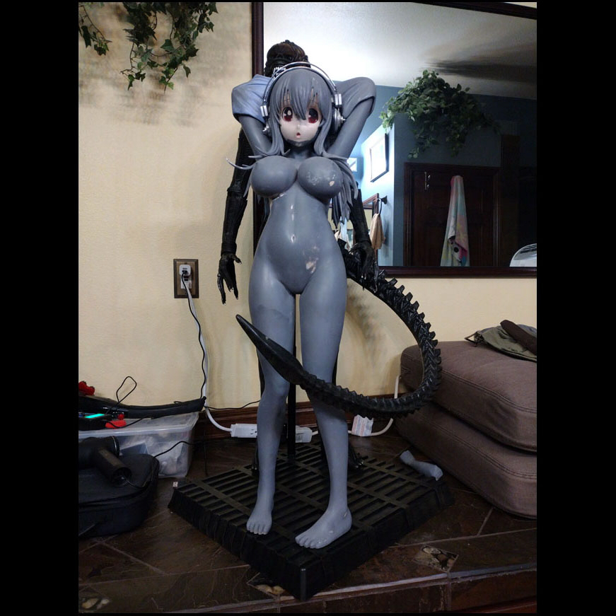

Is this NSFW? She's in primer, don't know. Point being that the only other 1/2 scale figure I have is this Super Sonico cast resin piece that was grenaded during shipping by a crap seller. She was my first ever serious repair job (much of her was shattered), and I never got around to finishing her paint. And she takes up a lot of space, and so does this xeno...one thing led to another and sometime in the future she's going to be cosplaying as Ripley.

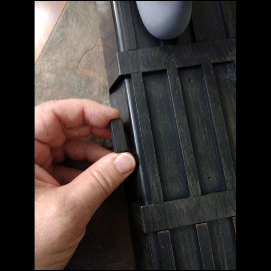

But she's heavy, and her right heel fell in a gap in the base so I had to quickly make a support. A popsicle stick, black paint and drybrushed to match the base.

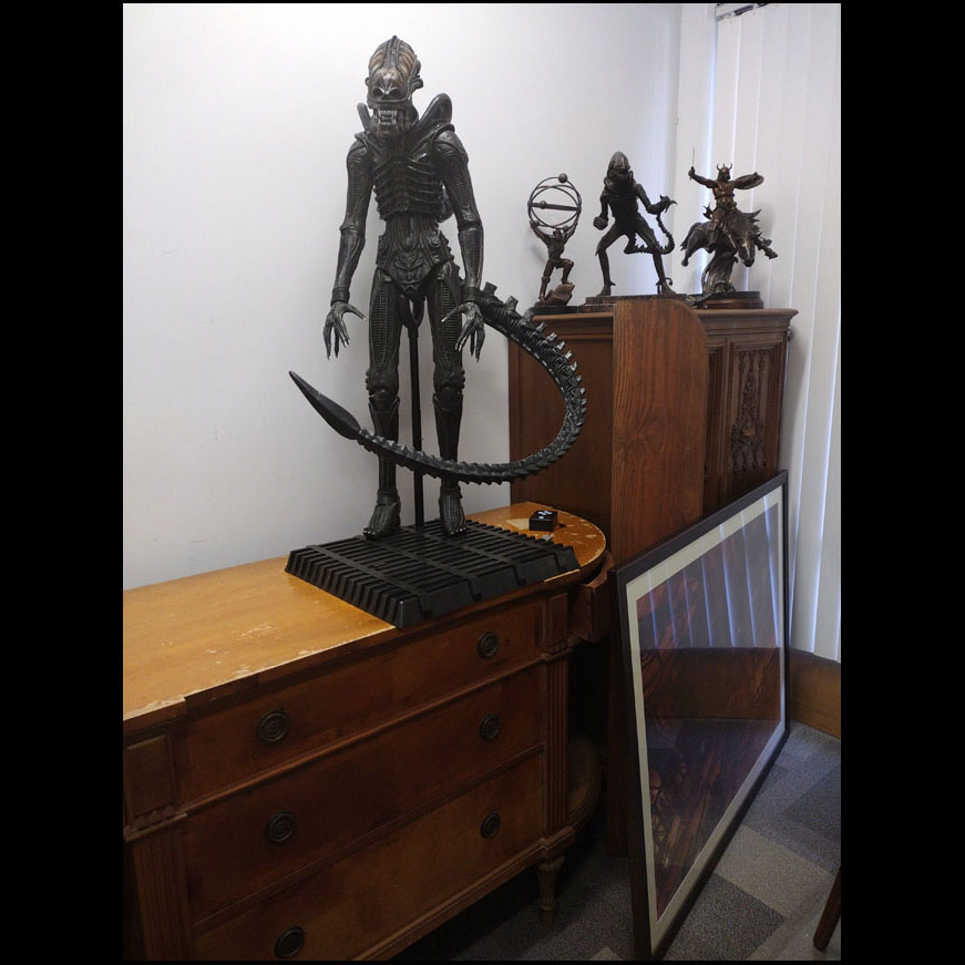

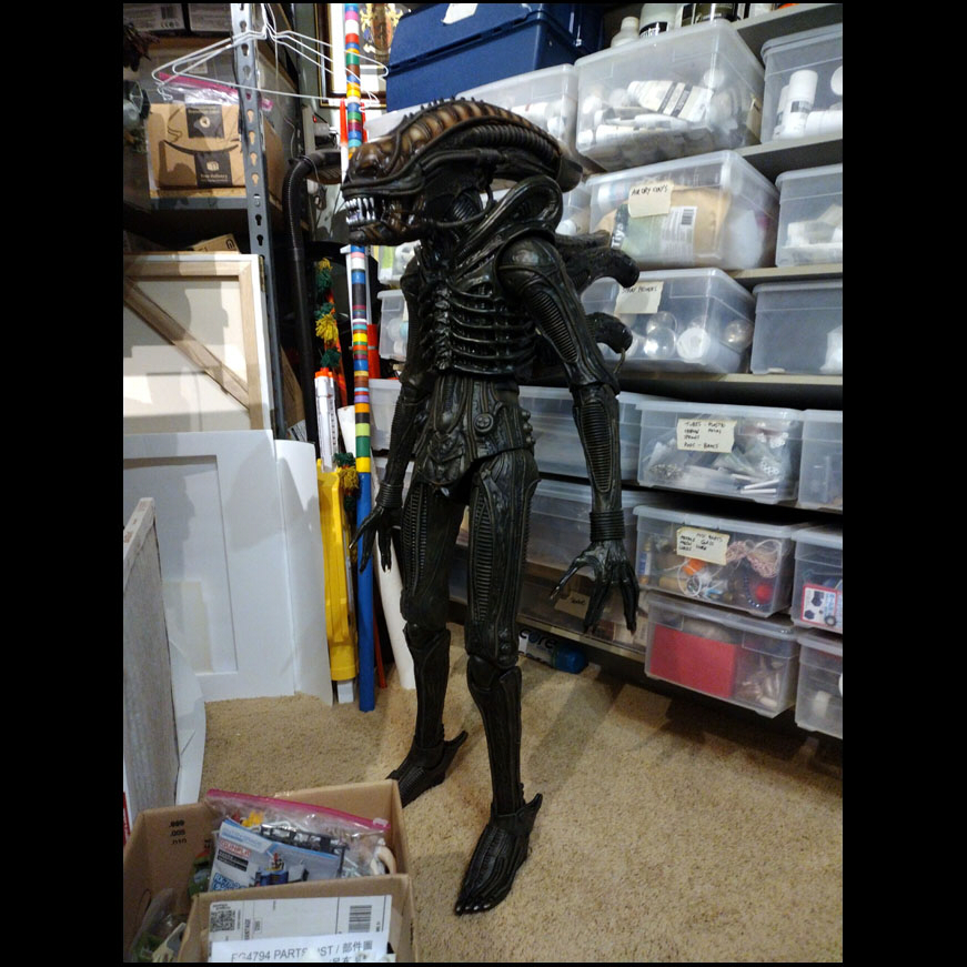

Moving him to my office, sans dome. Needed to get him out of my little studio. Imagine trying to move him if his tail wasn't detachable!
Set up where I think he'll live.

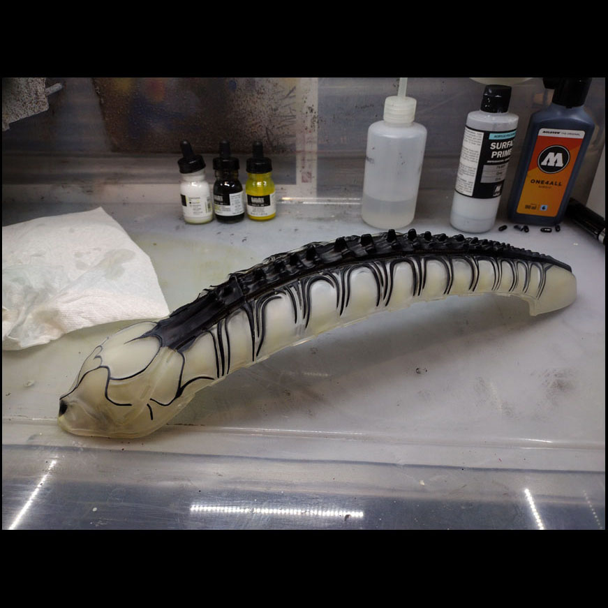

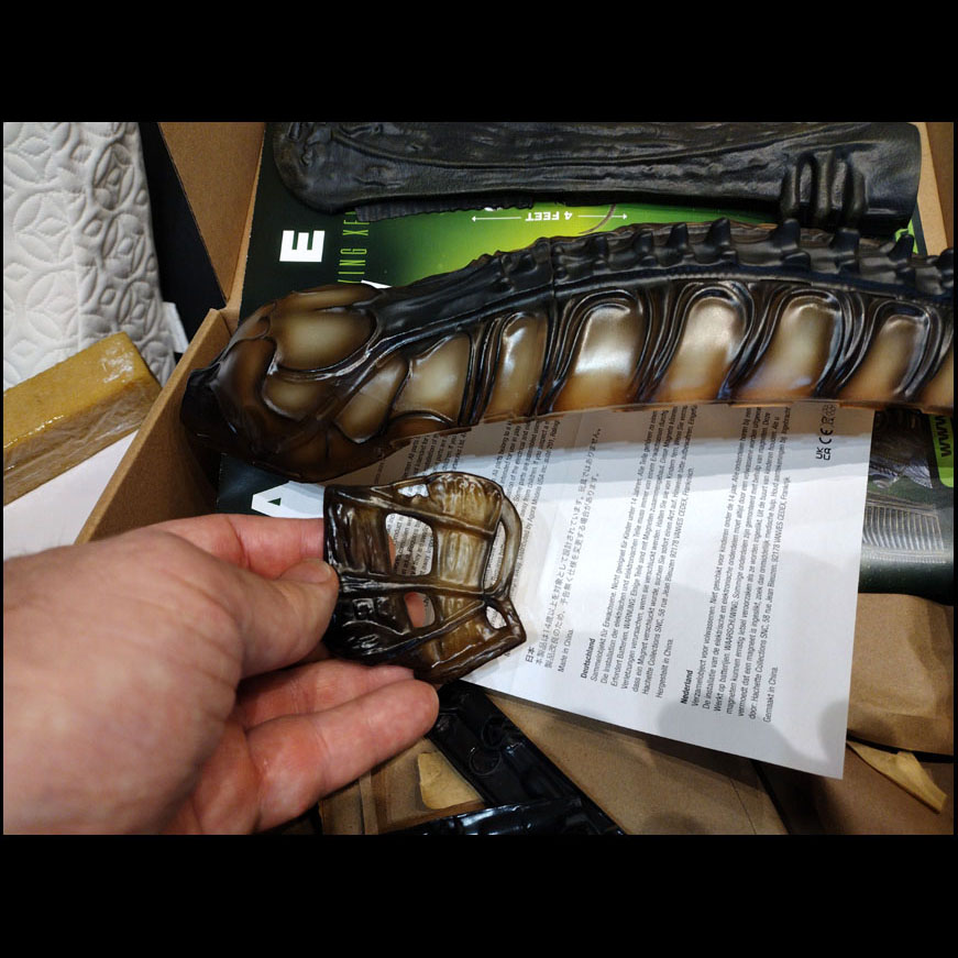

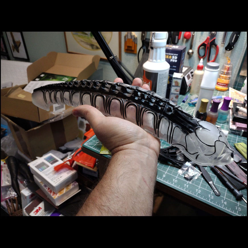

Circling back to the supplied dome....Blech!
First thing was to sand the crap out of that sharp lower edge, rounding it along the entire perimeter of the dome.

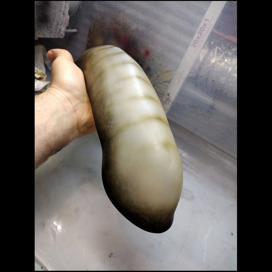

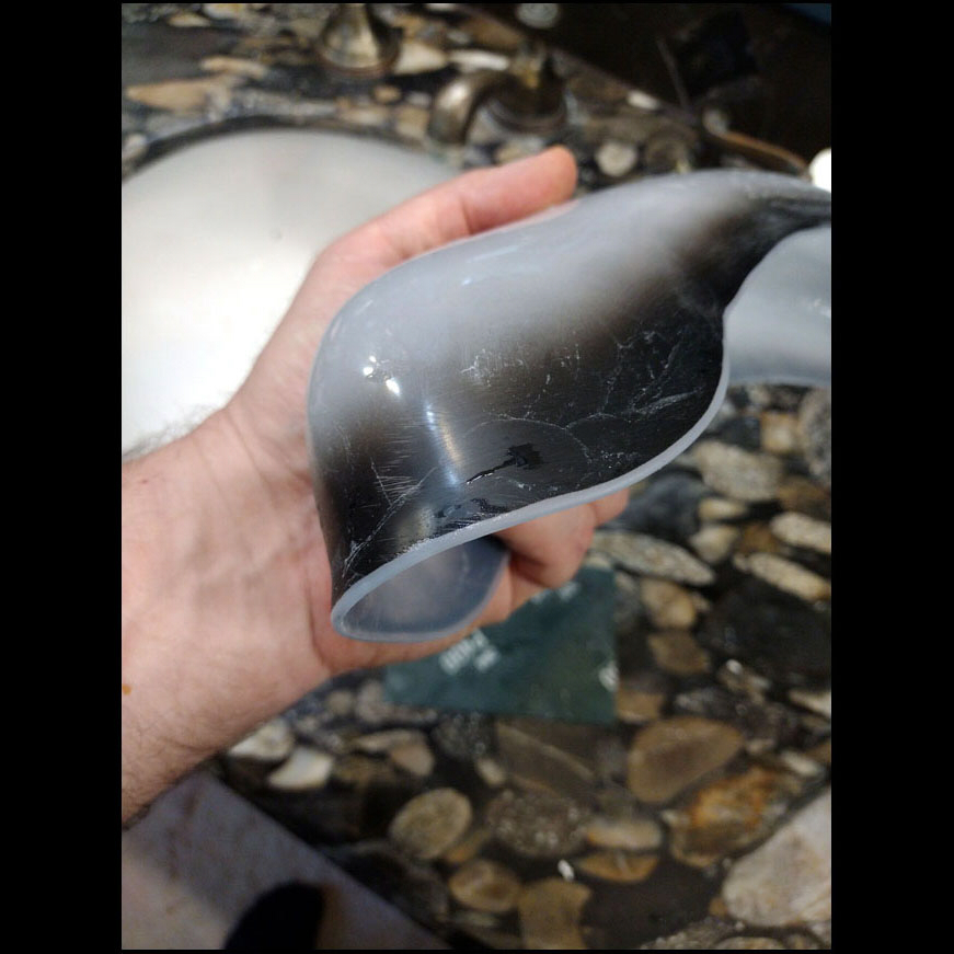

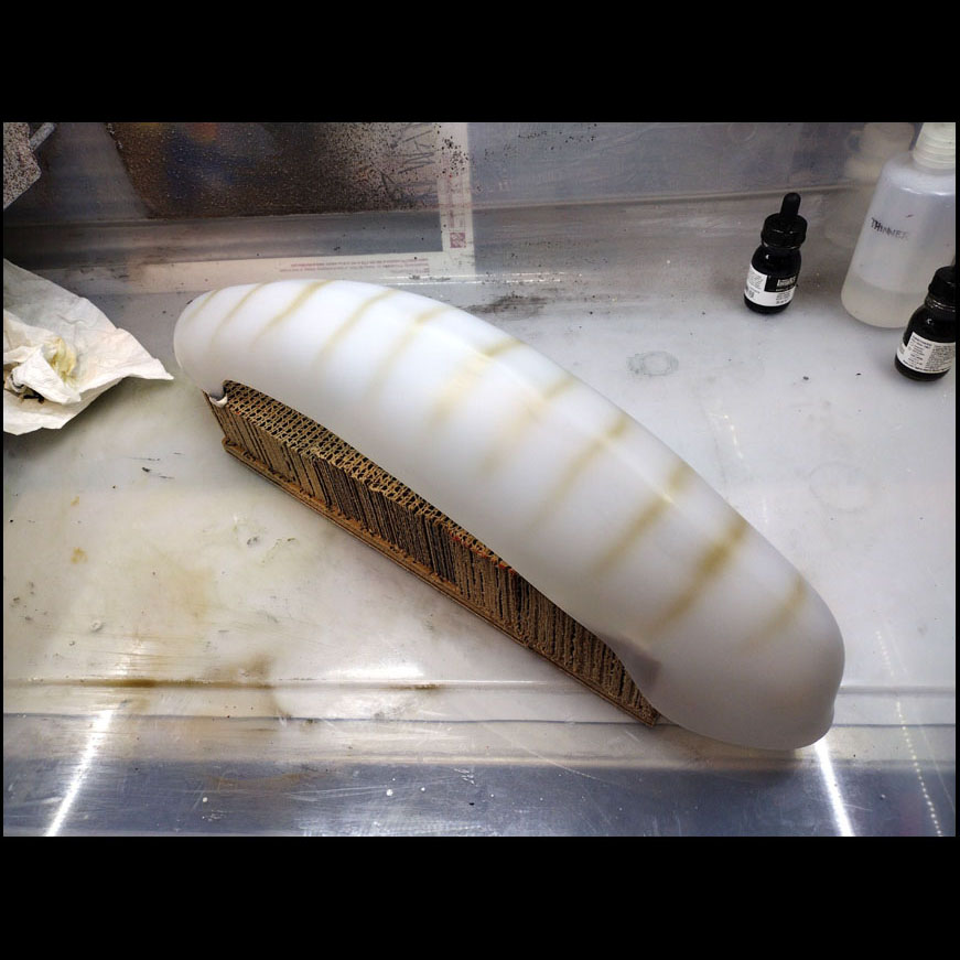

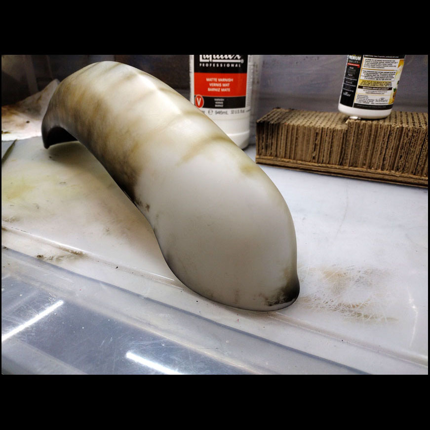

Then I sanded the black paint off and then sanded the whole dome to p800. I had originally hoped to sand it clear but it is cast in a translucent white so clear isn't an option. But I have to make it look better than that original crap.

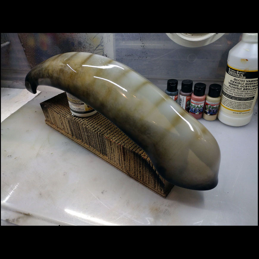

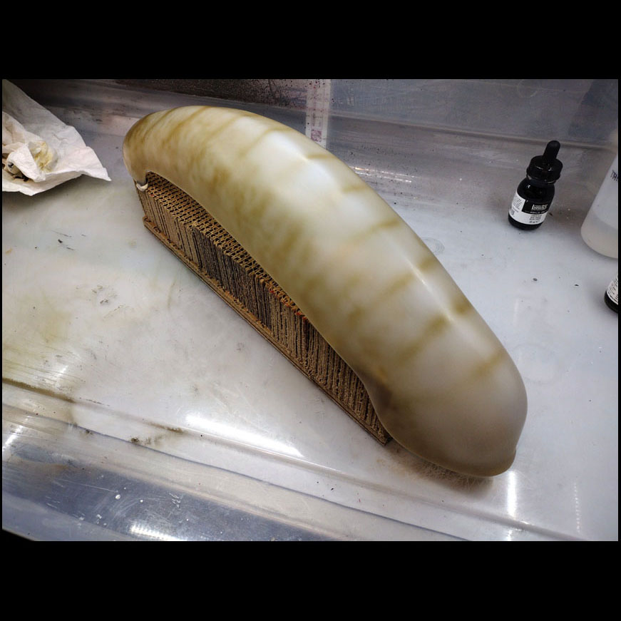

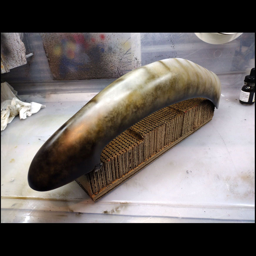

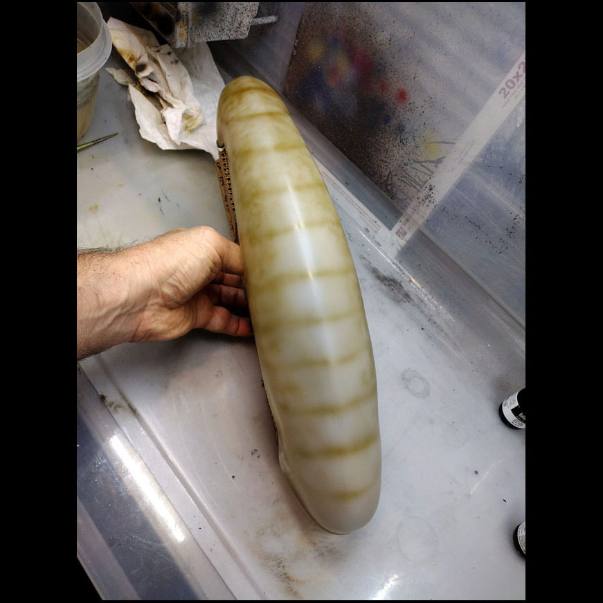

Yes, you guessed it: Brown and black inks. Because consistency is its own form of correctness. Airbrushed some freehand stripes, inspired a little by the Romulus xeno.

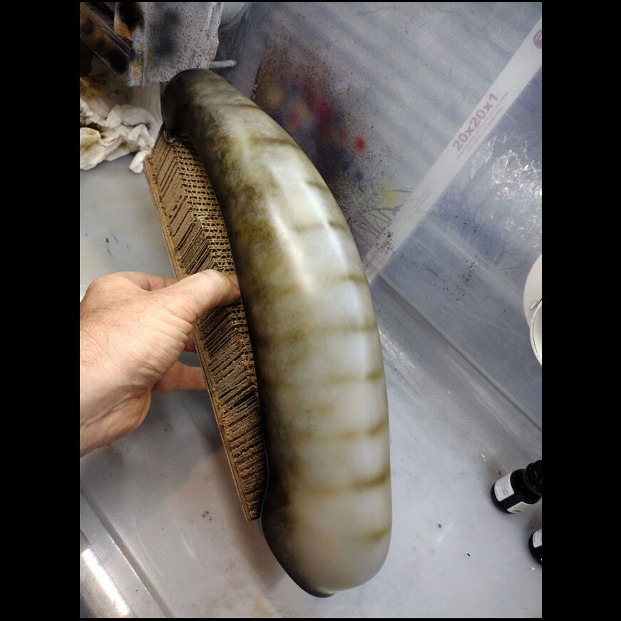

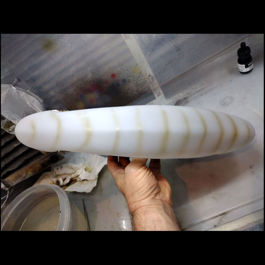

I varied their angle, making it more severe toward the back.
Then I did freehand squiggles with the airbrush, multiple light passes, to add visual texture to the open areas. I feathered the intensity toward the rear, knowing that it would end up being almost completely black.

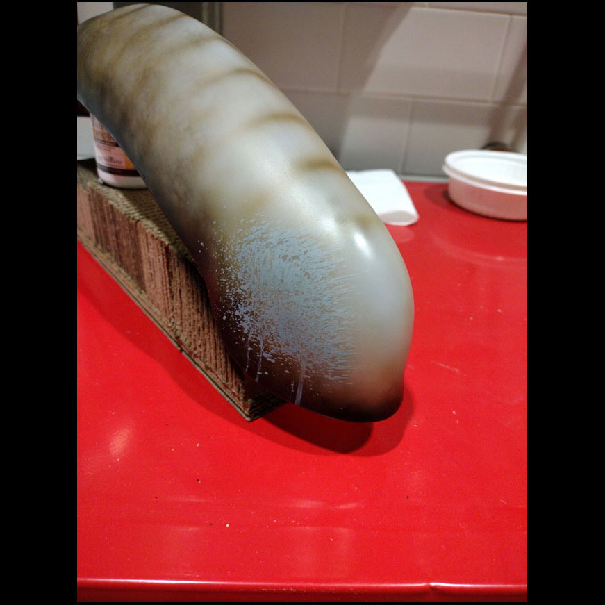

AND THIS HAPPENED!!! I wasn't paying attention and grabbed Upol high build primer instead of clear. I was not happy.
Turned out brake cleaner removes urethane primer really well. And inks.
So I fixed it. Wasn't pleased with this event, but was at least relieved that I was able to repair it without a complete repaint.

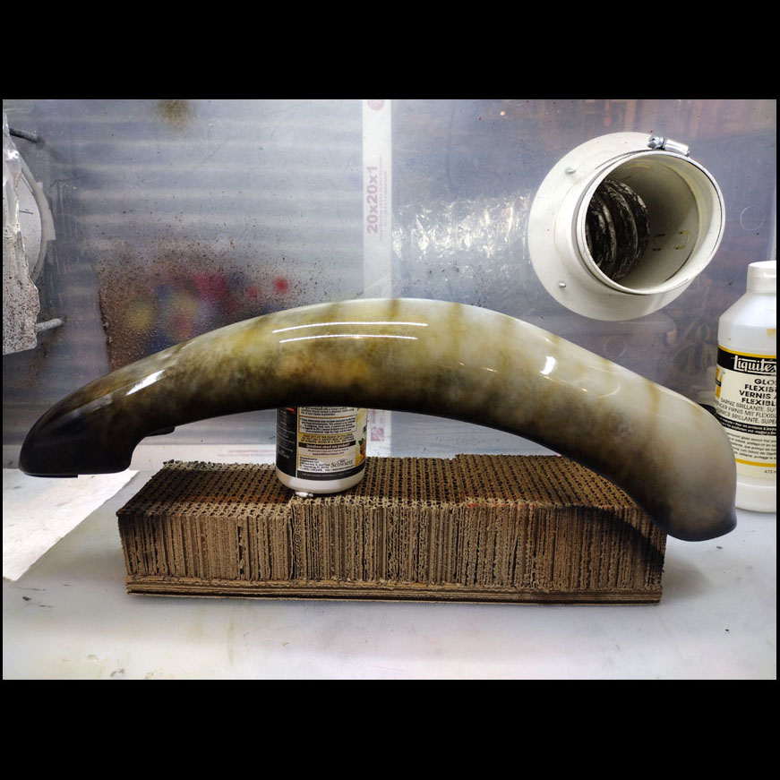

Then I cleared it...with CLEARCOAT.
