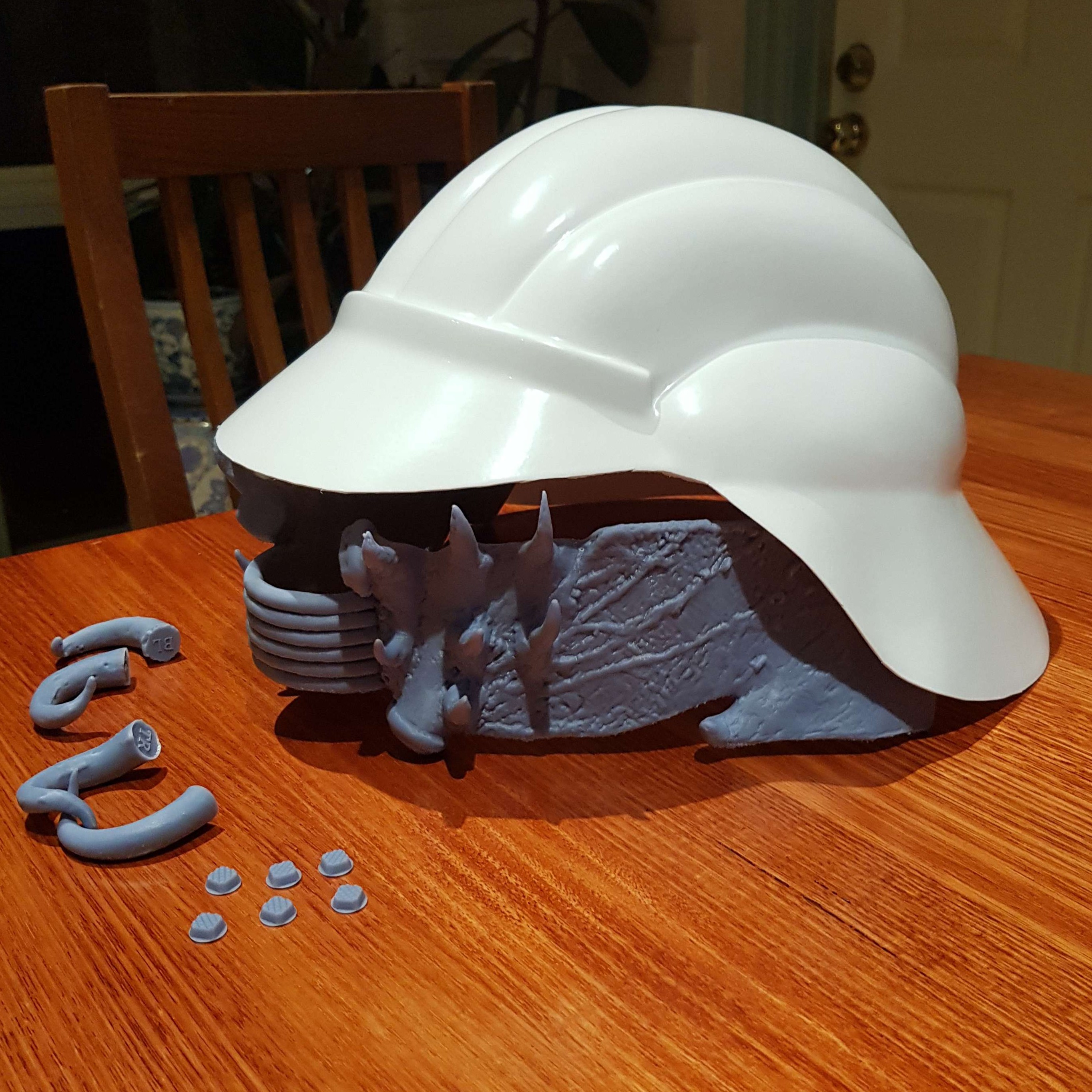

Hi,
Over the past few months I've (with a lot of help) been researching how the Lando skiff guard helmet was constructed for ROTJ. Alongside this i've also been slowly making progress on collecting all of the custom parts for this build and have just received the vac formed shell. Here's what I have so far:
Above is the shell, jaw, horns and studs for the helmet. The shell and jaw have lineage back to the hero helmet from the film while the studs were created from scratch using measurements of the found part. At some point I'll have to create a mould to make the jaw properly from a red urethane to be correct (although its painted either way) but this grey resin one will do for now.
Still to complete is:

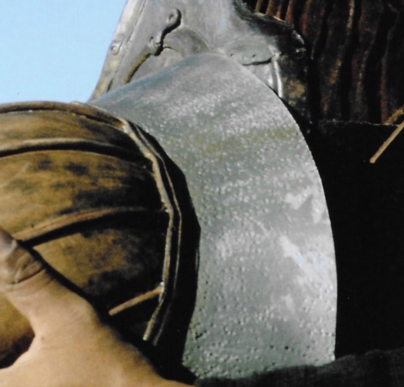

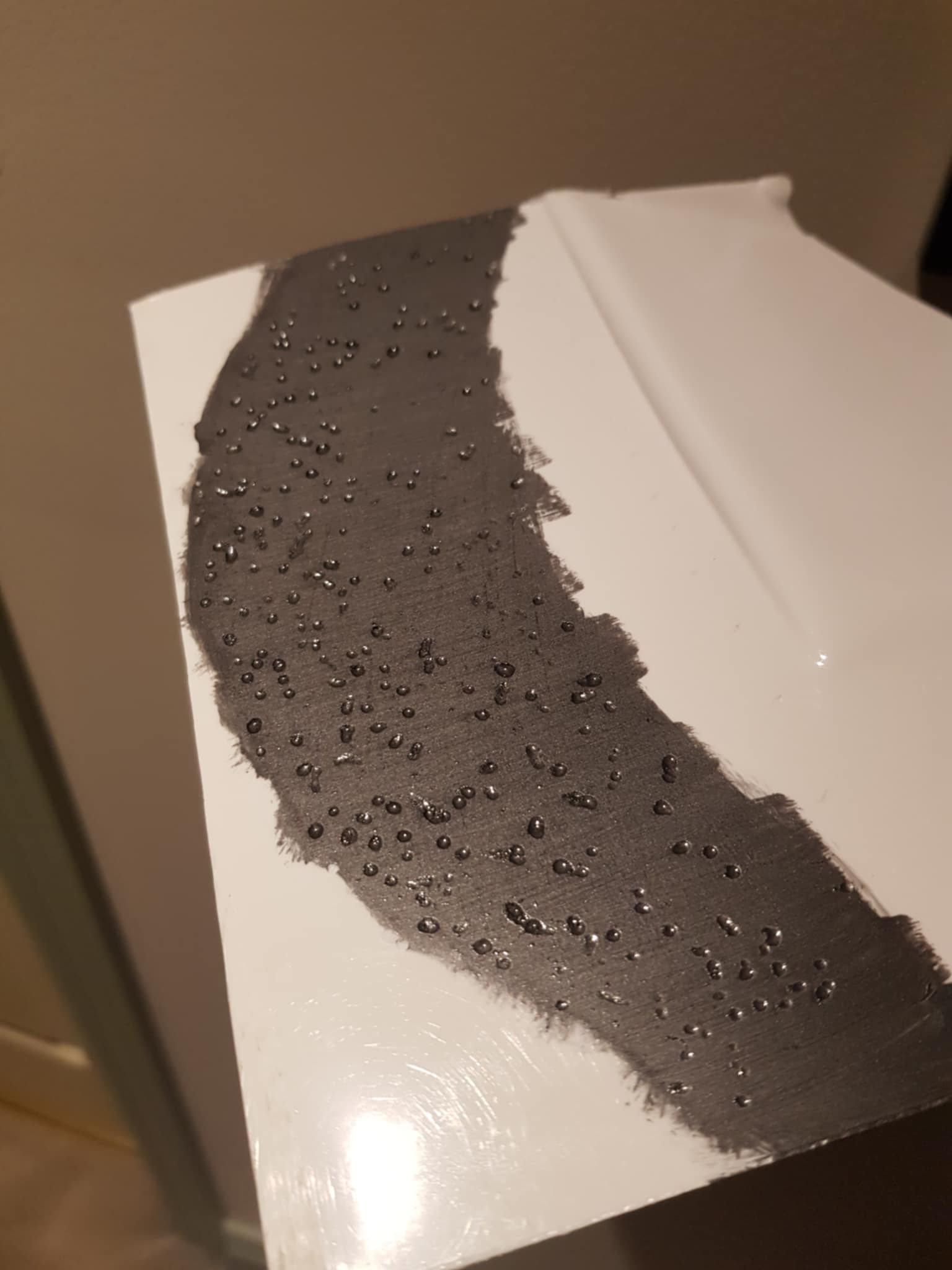

1. Transfering the 'divots' onto the plastic from printed maps of the hero helmets surface
I need to figure out how to properly replicate the finish (see below).
2. Dye and attach the leather section
Currently working on this and learning as I go as I've never used leather before.
3. Fastening the Jaw to the Shell
This is something that has been bugging me for a long time as the image I have of the fastener is just a bit too blurry to fully make out what the fastener is, my thought is that it is some type of brass t-nut for wood but I could be totally wrong.
4. Paint
I don't even want to think about this yet, it's always the most stressful part.
Just wanted to post this to log my progress and incase anyone had any advice or insight on how one would put something like this together, if not I'll get there eventually.

I think that would be the ideal way to go about it, the only problem I see is that I have to stick down a template with the divot locations marked out over the plastic so won't be able to directly melt the plastic like this. I've bought a dremel ball end engraving bit and playing around with that now to try to get the same effect.

The file is my own, though the shell itself is vac formed haircell abs from printed moulds.
