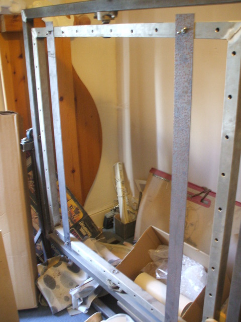

There's still work to do though! I've got to extend the mould & fabricate something to mount it securely into the rotocaster frame. Its a heavy mould so the mounts need to be built well. I've also got to consider 3kg of liquid plastic sloshing about & (momentarily at least) having an effect on the mounted weight.

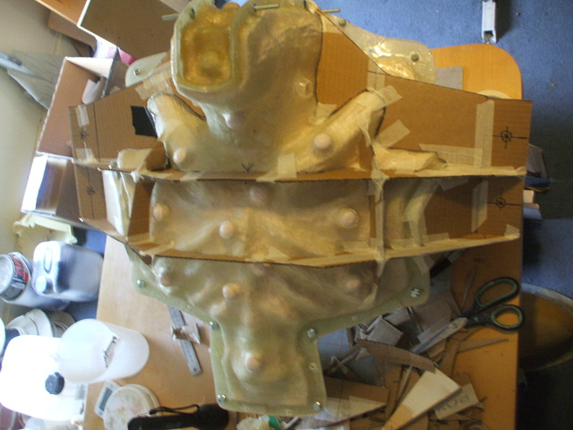

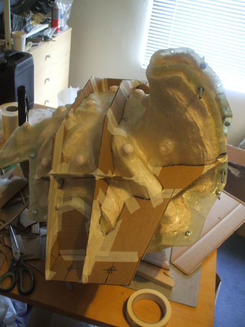

I've been busy figuring out how to suspend this heavy mould in my rotocaster.
This may seem a little over engineered but I can't think of a better solution that'll be strong & light :)
I started by trying to find the centre of gravity for the mould which was relatively simple & I marked it out.
Unfortunately I couldn't use any of the flanges.
I then started to fabricate reinforcements out of cardboard & this is what I have:
This is as simple as I can do it & holding it up to the frame it fits like a glove :)
The plan is the recreate the cardboard sections in fiberglass. I'll take this lot apart & lay each section down on a flat surface & build a low clay wall around each piece. I'll then just lay some FG in with resin & leave it to set.
I'll bond each piece on to the mould with FG paste with glass strand & then overlay with FG matt.
Lets hope it works :)

Outstanding construction! Worthy of engineering!:eek:thumbsupI:thumbsup
In your opinion, it was not possible to use at least three well-tensioned wire ropes?
Re: Bob the Alien (Giger inspired Alien) Its back on!
In order to hold this mould steady it would put too much tension on the frame, also if the mould moves about it'll overload the gears.
This why I'm doing it this way, finding the centre of gravity, centering the mould in the frame & fixing it rigidly so it doesn't move. Unfortunately I can't do anything about the 3 or so KG's of liquid plastic sloshing around momentarily changing the centre of gravity.

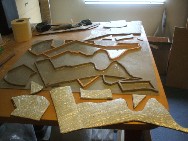

I've made up walls & cut the FG for the most of it, there will be just two pieces to do either side after these
I'm using 3 layers of FG for all but the mounting plates which will have 5 layers :)
Thrilling.:) Yours, is true love for the technique! :loveYou drown the fibers in the resin inside those little walls?
