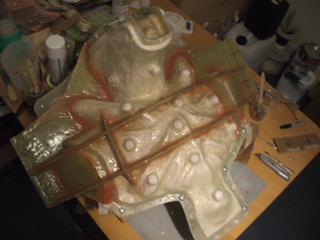

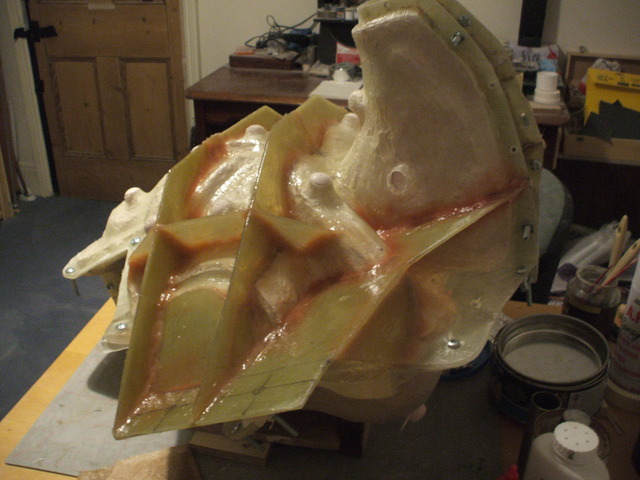

Thrilling.:) Yours, is true love for the technique! :loveYou drown the fibers in the resin inside those little walls?
Well wetted out :)

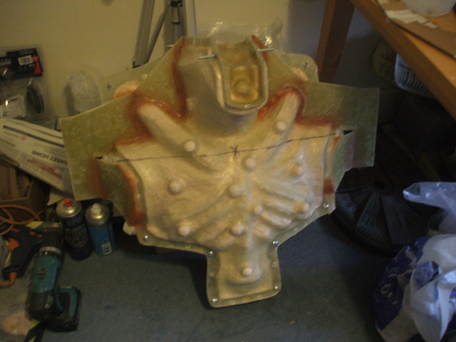

I done the last bit of FG this morning & I'm leaving it to fully cure for the rest of the day. It doesn't look much different so no pic :)
I'm getting my Hallway floor sanded & sealed tomorrow so there won't be any progress on Bob tomorrow.
On Tuesday I should (fingers crossed) be able to run the first cast out of this mould :D
I'm looking forward to putting this one behind me & moving on to the base. The base will be a different process to the last moulds as it'll be used differently :)

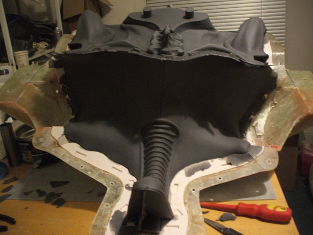

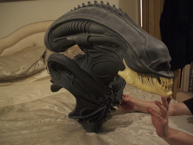

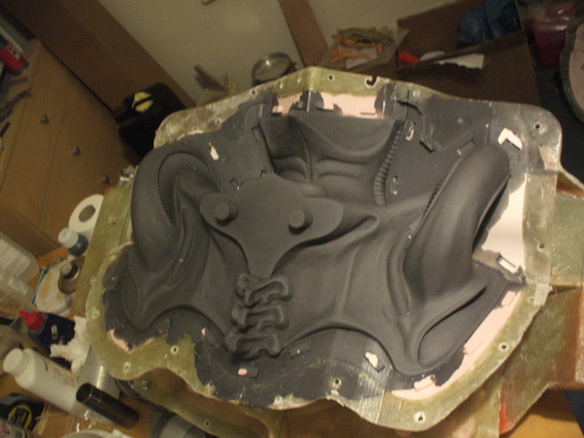

I must be getting impatient.....
Its not 100% but I'm happy :D
I'm happy with the colour :) I did this cast in one 3ltr pour, in future I'll have to do it in two pours of 1.5ltrs each. It leaked either side of the neck so I'll need to investigate why it leaked & I need to use all the bolt holes! :$ not every other one:facepalm
For a first cast I'm pleased :)
Re: Bob the Alien (Giger inspired Alien) Its back on!
an absolutely great pro mold! I just have experiences with "as cheap as possible" molds out of plaster and with lots of plaster mixes into the silicone too, and of course these normally are just needed for one or maybe 10 casts. but your mold is nearly industrial. AND, ... I already said it... your alien bust may be the most correct one ever! even the original ones are not as good as this one, because of the bad condition they are today. thumbs up!!!

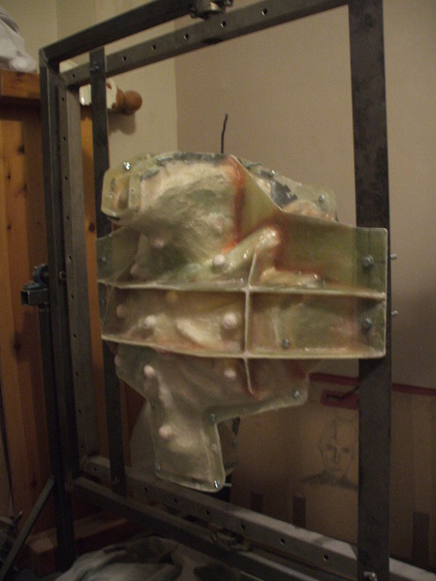

I love the fg extensions you built on to attach to the frame. Great work!
