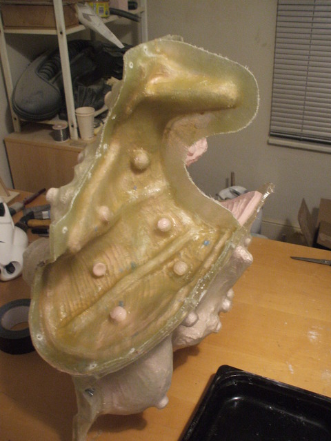

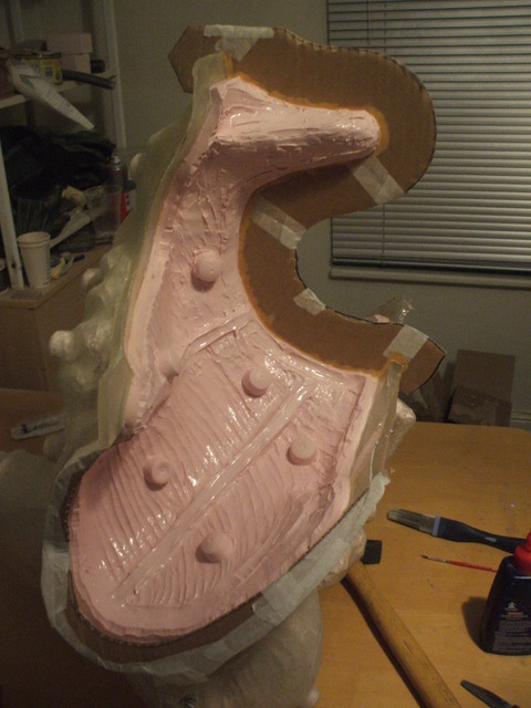

I've been breathing too much Styrene & Thixo fumes lately & its made me a little ill, so I needed a little break :)
I've got the mould ready for the next lot of Styrene fumes :D hopefully the wind will stay down long enough for me to keep the window open, then I can get this done without blowing the fumes all round the house :lol
I've decided to use PVA as a release agent on the fiberglass flanges. Its waterproof PVA so wont be affected by the petroleum jelly I'll also use.
Made a cardboard partition for the jacket & sealed that with PVA. Hopefully (weather permitting) I'll get the fiberglassing done today :)

Its been windy today but I went ahead & did it anyway :)
Fiberglassing upside down against silicone is tricky :D
So I need to prep the partition for the next part & do some PVAing & hopefully I can do the other half tomorrow :)
