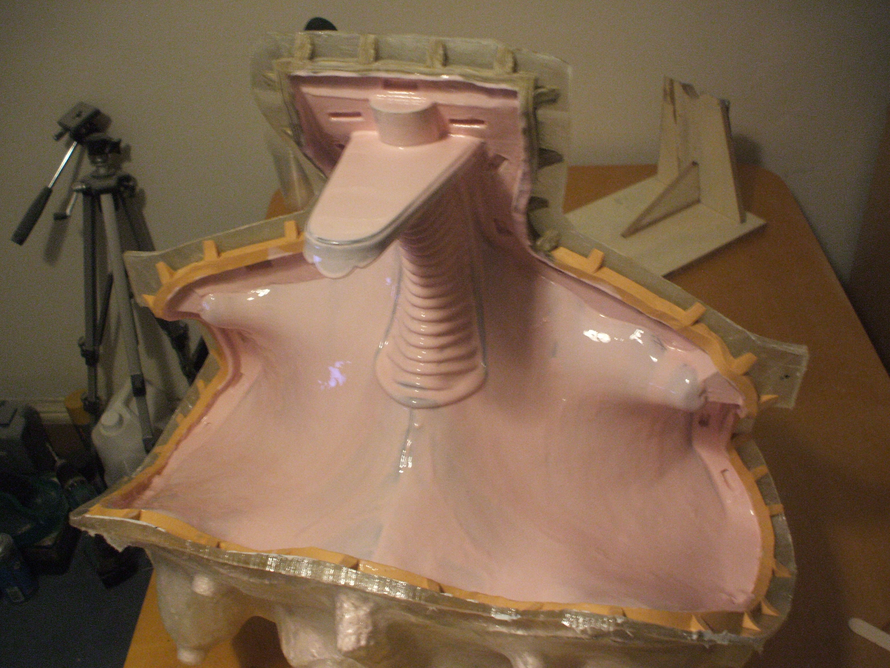

OK, These are the parts I'll be dealing with for now :)
I need to finish creating the moulds for the body & this is where its at this morning:

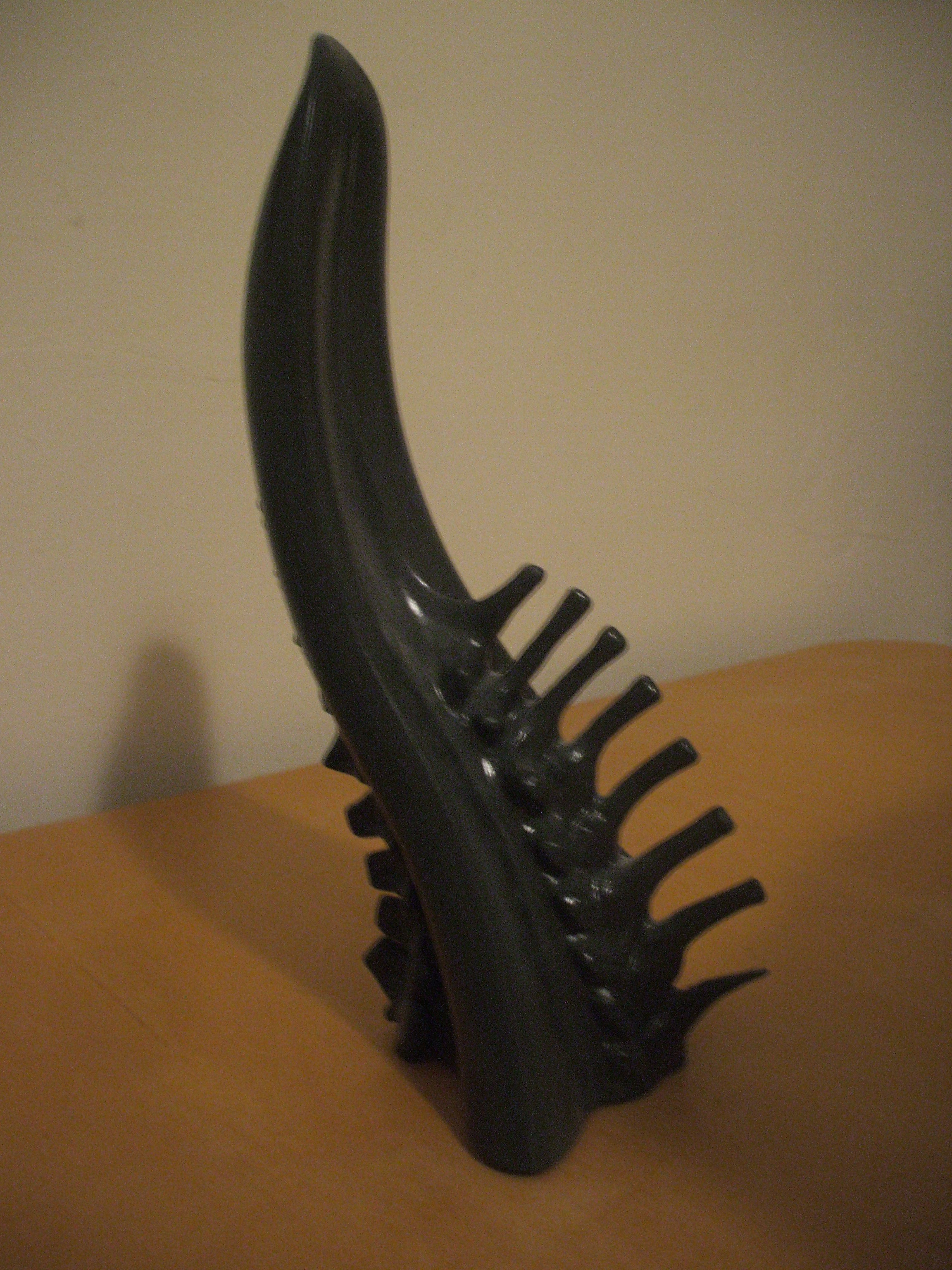

I'll also be making the moulds for the fin, here:
http://i74.photobucket.com/albums/i246/LJH74/Alien stuff/824_zps9a0nftx5.jpg
Beautiful! It may also be sold separately as an ornament.

I stopped halfway through because I ran out of rubber :)

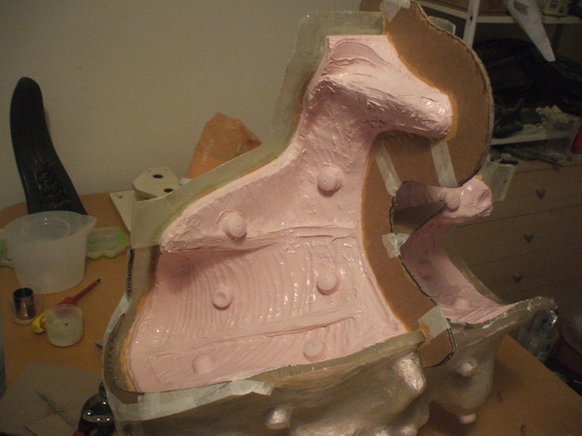

Re: Bob the Alien (Giger inspired Alien) Its back on!

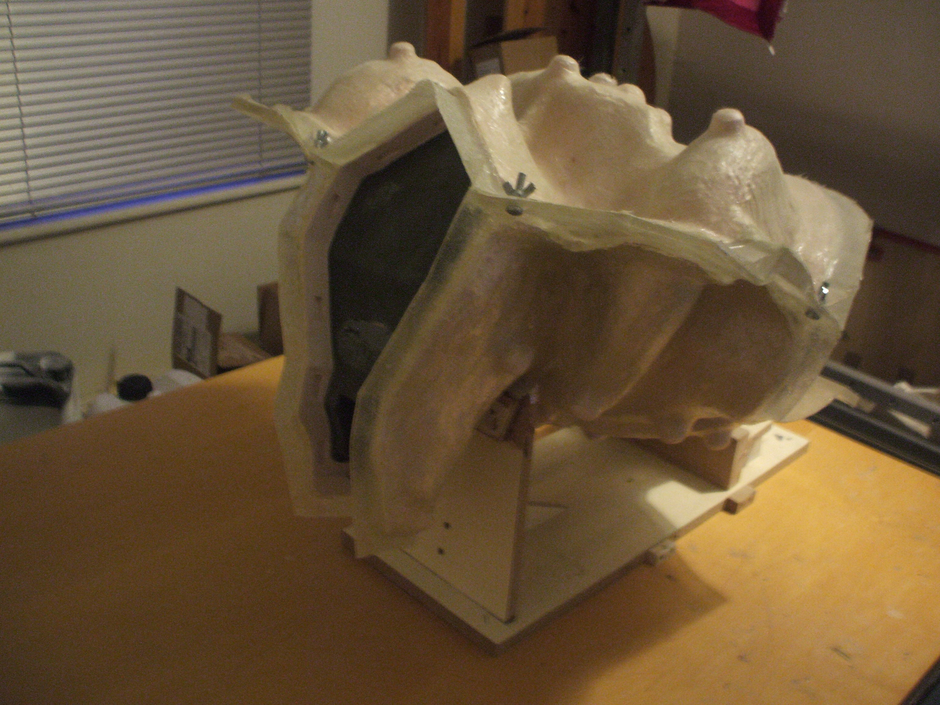

This piece will be one piece rubber & two piece jacket with a partition right down the middle :)
I wondered how long before someone questioned that :D
I should really have made a separate part for the underside of the foot of this piece :unsure
The second coat is on now, just the Thixo coats to go :)
I killed an ostrich along the way. :)
I had never worked with fiberglass. When I started, I did following the technique you've just told you, because it is the one that is the most popular. But I was scared, because I not like working with the resin, is a very slow process, get dirty gloves of resin and fiber, pan, that should always clean. Then the large pieces tend to rise on tight bends. Maybe you do not have this problem, because uses the silicone rubber that prepares the surface of the model. But I layered directly on the model, making more breakdowns to overcome the undercut. I actually use the pieces very small, 3-4 cm, I get tearing, roll, Mat. within 20 minutes it tears 2 square meters. It supports quite well even on vertical surfaces. The advantage is that you can draw on all fiber model, already with very thick, and at once, without getting your hands dirty, the brushes over the resin that you keep in a plastic cup to throw away. There remain only the brushes to clean once after work, leaving them to soak in the tub with the solvent. This method is 10 times faster and cleaner. It is not so necessary that the fiber is woven, because these pieces are not of motorcycle or boat hulls, which have to withstand the stresses of the wind or the waves of the sea. This technique taught me one that makes the molds of the trade, and that is also used on the silicone rubber.
