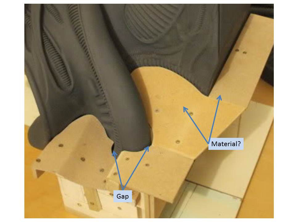

Here's where I'm going with the supporting structure for the partition, it's quite sturdy & all slot's together. Over this I can build the partition out of what ever is suitable adding key's etc :)
If you can see me going wrong here or forgetting something important please say so :)

Hello Leigh,
impressive work also for the support structure.
I have some questions for you:
What material is hazelnut color connection to the mold division? (It seems folding, a mixture between the cardboard and wood.)
If and how you closed the small gap that remain between this material and the model?
See you soon :)
DD
Re: Bob the Alien (Giger inspired Alien) Currently in Limbo
Its quarter inch MDF on a wooden structure.
I filled the small gap between the MDF & the clay by mixing a little silicone with the thixotropic additive & applying a bead of that with an artist brush prior to my first detail coat :)
HTH :)

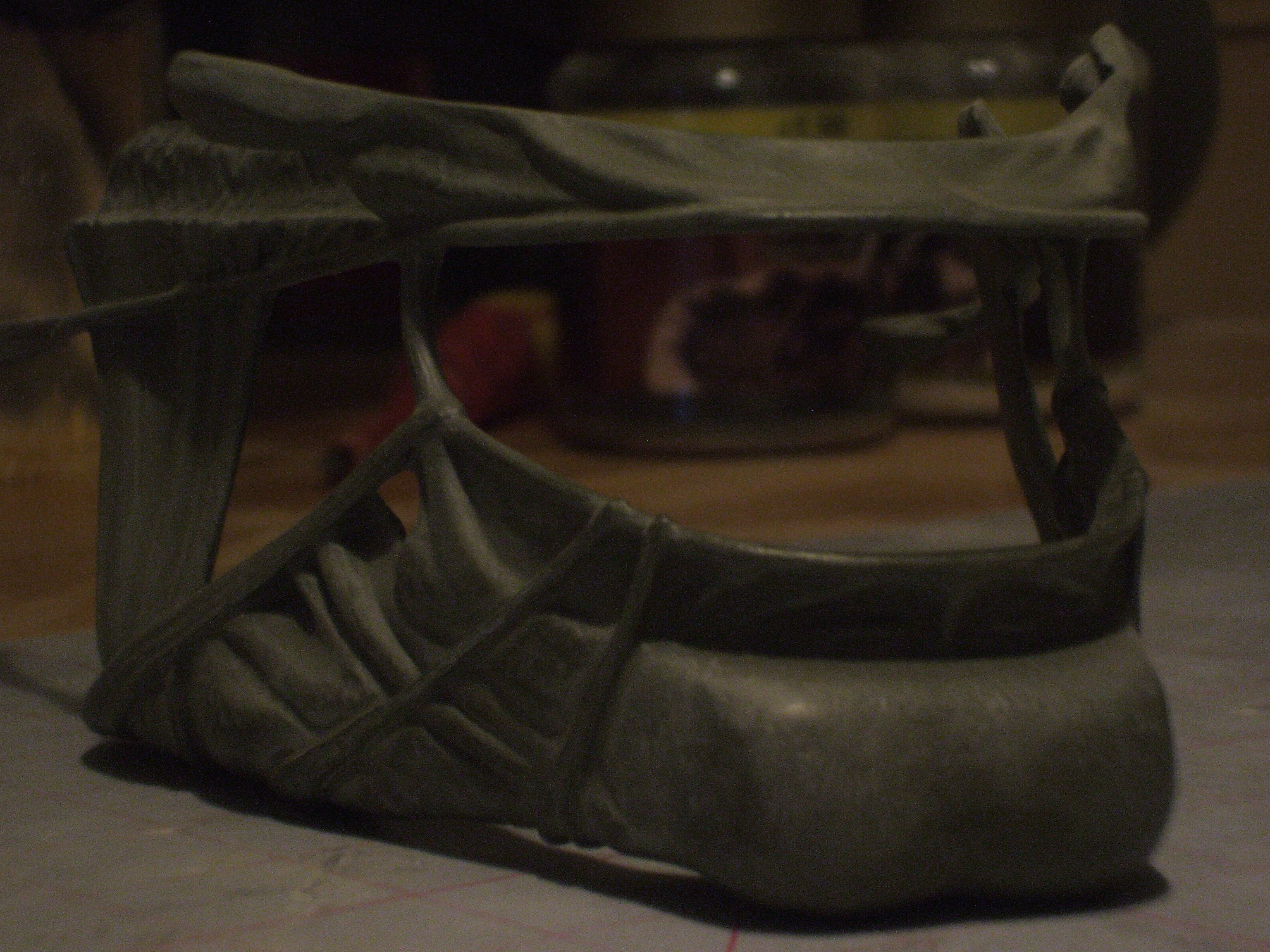

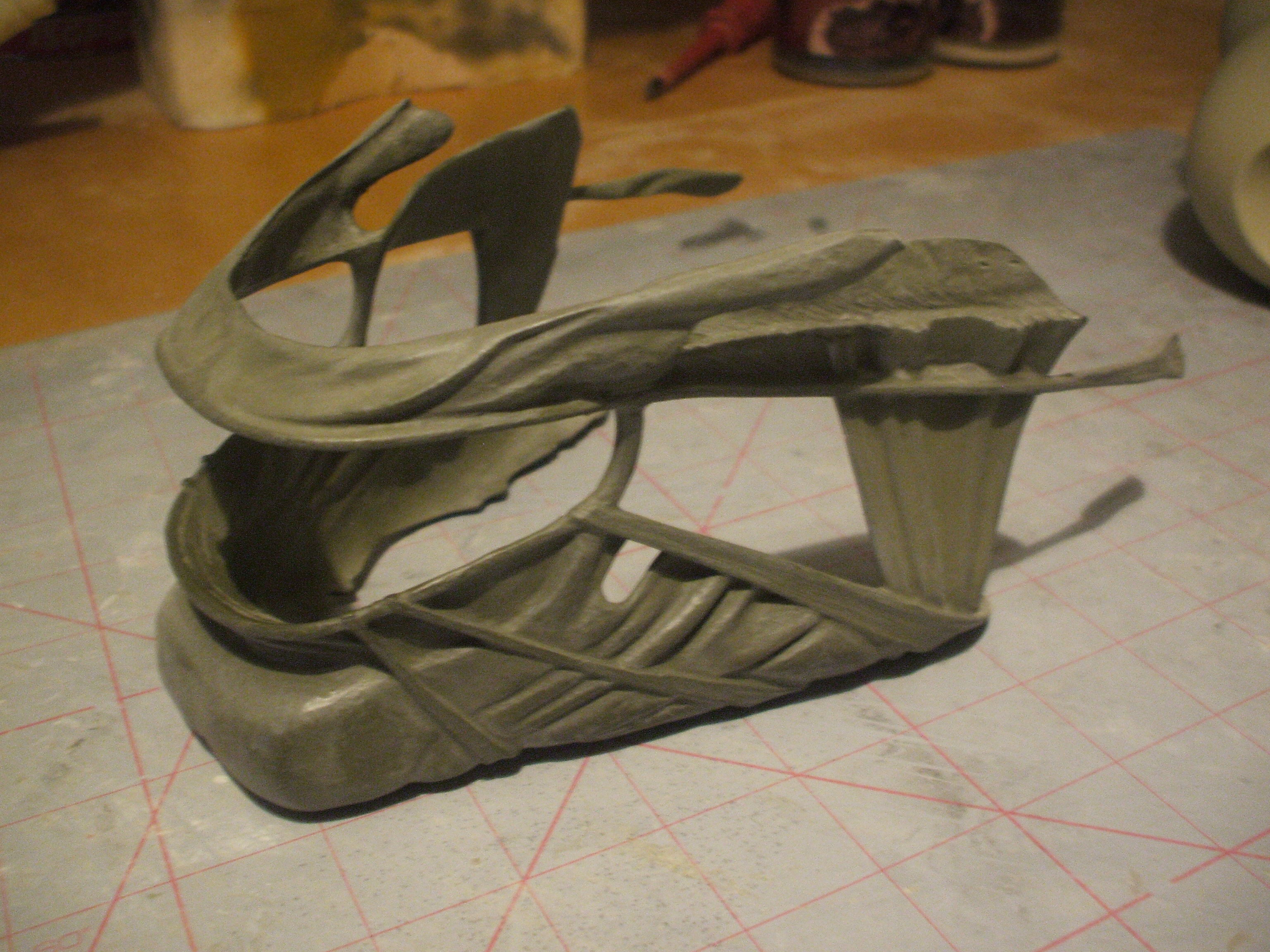

I have a small update:
I've run a disposable plaster mould over the lips & tendons & cast them in polyurethane plastic. So they're now rigid & separate from everything. I changed a couple of details & I'm pretty much ready to make a master mould.
I'm planning to build the mould out of the hardest silicone I can find. It needs to be just a bit softer than something like bicycle tyre rubber when set, has anybody got any suggestions on a type of rubber & a supplier in the UK??
Thanks
