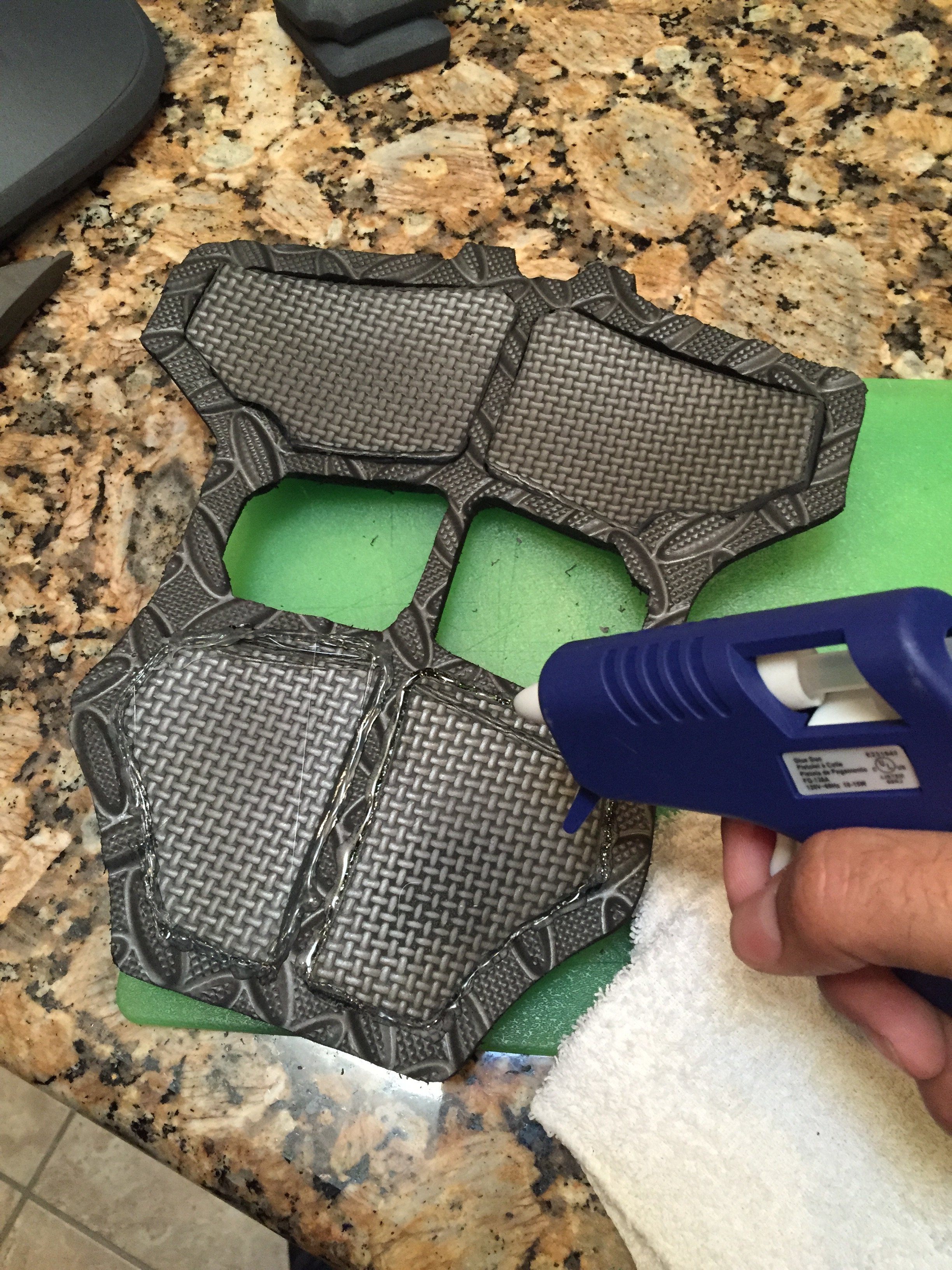

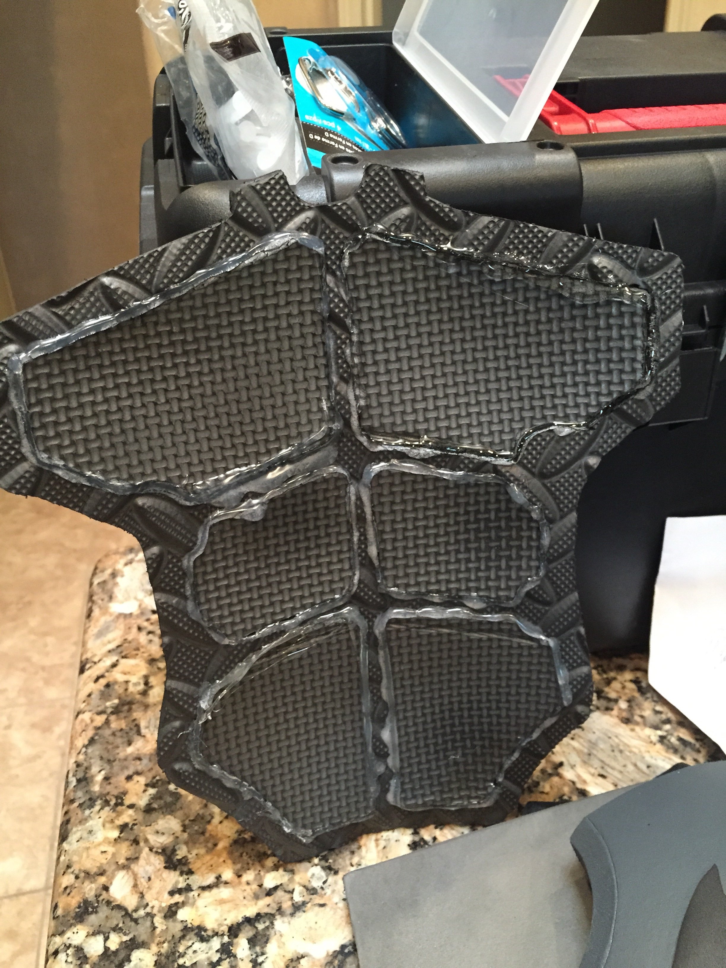

In the meantime I've glued the abs into place and curved the frame a bit to contour my torso. Right now im making a backplate for the chest so it will protrude a bit further than the abs. Also will allow me a frame which to tether the abs and chest together.

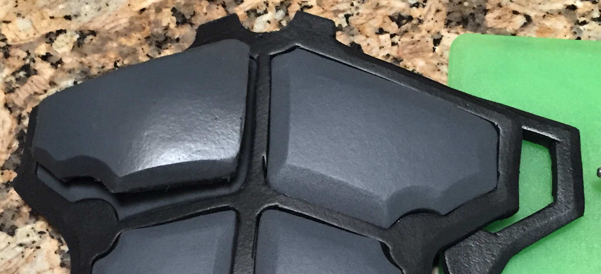

On the painting side of the house I tried adding a layer of matte clear to some test foam pieces. I didn't like the results. Made the pieces too shiny and also messes up the smooth finish... Looks like an orange peel effect. You can see the difference in the gunmetal but not so much the black. I want to keep it looking flat. Any repercussions to just using plastidip as a color without a top coat?image.jpgWhich do you guys think looks better? Keep it flat or go with the matte clear?

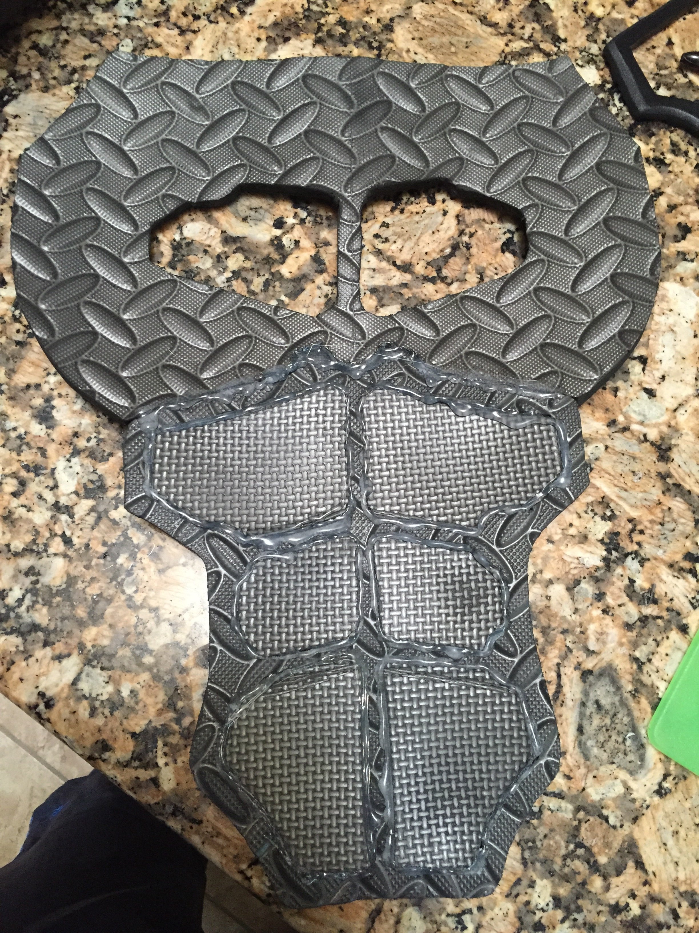

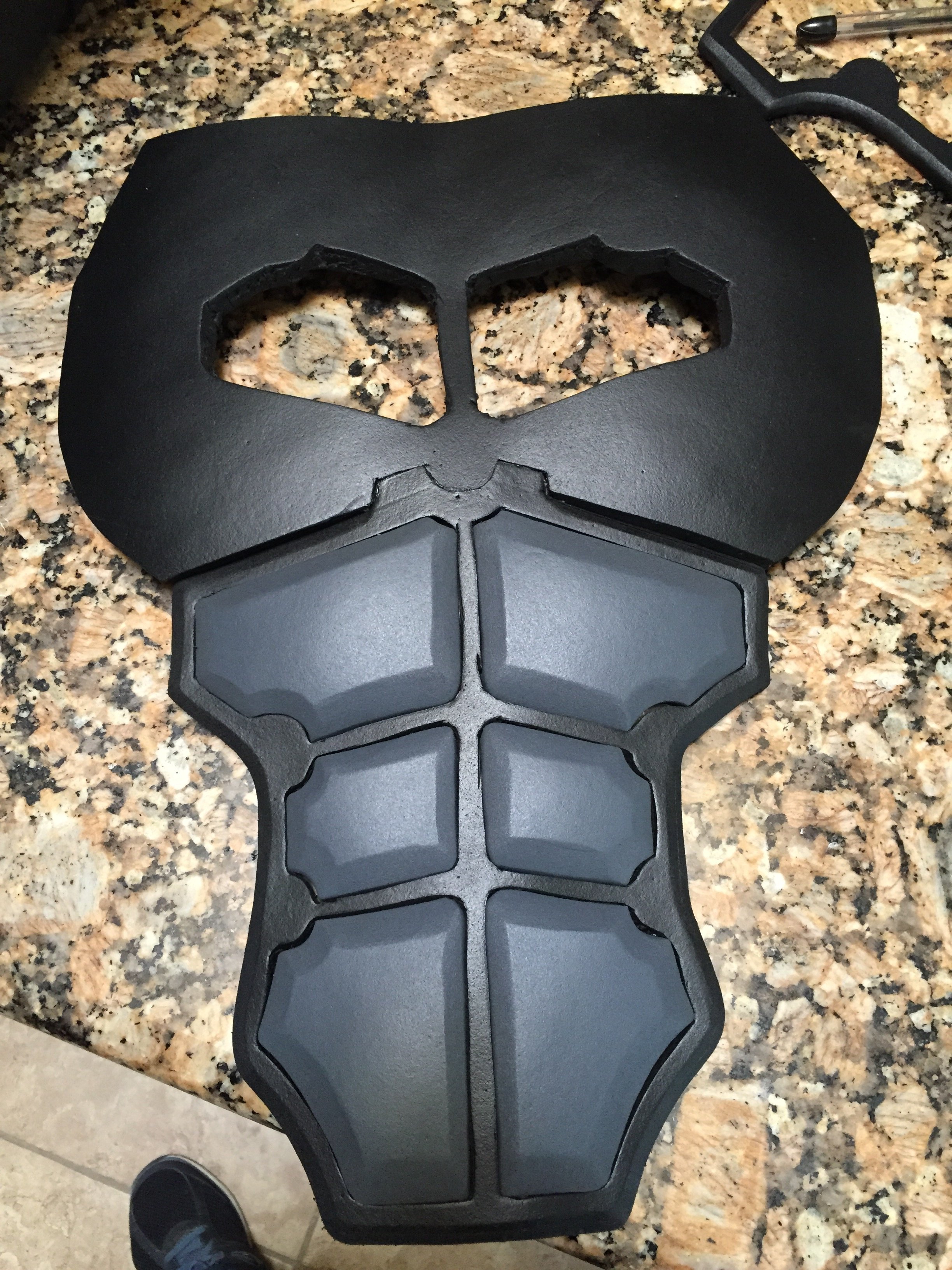

Just made this really quick out of scraps(that why you see those two holes where I cut out some extra ab pieces to practice on). Plastidiped it. Glued it on. The chest plate will go on top of this.I'll probably have to reinforce it somehow as I'm not sure if the glue will hold it all together as is since the frame around the abdomen is a pretty thin foam sheet, which I beveled on top of that. Maybe I'll go gangster and bust out a strip of black duct tape. Lol

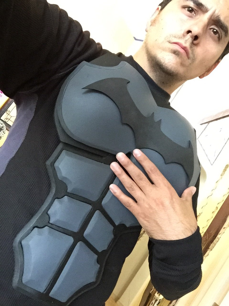

Re: WIP - Batman Arkham Origins
Selfie time. Proportions are still good. Need to figure out how to strap this thing on still.

Thanks! I'm trying. A little stumped on how to mount it. Might be too heavy to use velcro. So not sure if I should make straps that go over the shoulders around the neck or what.
From what I understand, there should be elastic straps from the breast area to the shoulders, from the shoulders to the plates on the back and buckles in the back.
Yeah. I already purchased the elastic straps and the metal ring/brackets too. But I figure they are more cosmetic than functional. I think it needs to be pulled flush to my chest somehow so it doesn't move around too much when I walk. Maybe the ribcage armor will help with that if I get around to it. Not sure how to tackle it yet.
maybe some elastic straps from the back plates under the arm to the chest?
Subbed! This is cool. And that is how I would keep it tight in, elastic straps from the chest - under arm - to the back pieces. I would actually make a plate back there specifically for the straps to come together, you won't see it with the cape but it would sit well. Same idea could be used for the abdomen too, though it could run the risk of bunching up if you bend over too far. Keep up the good work.

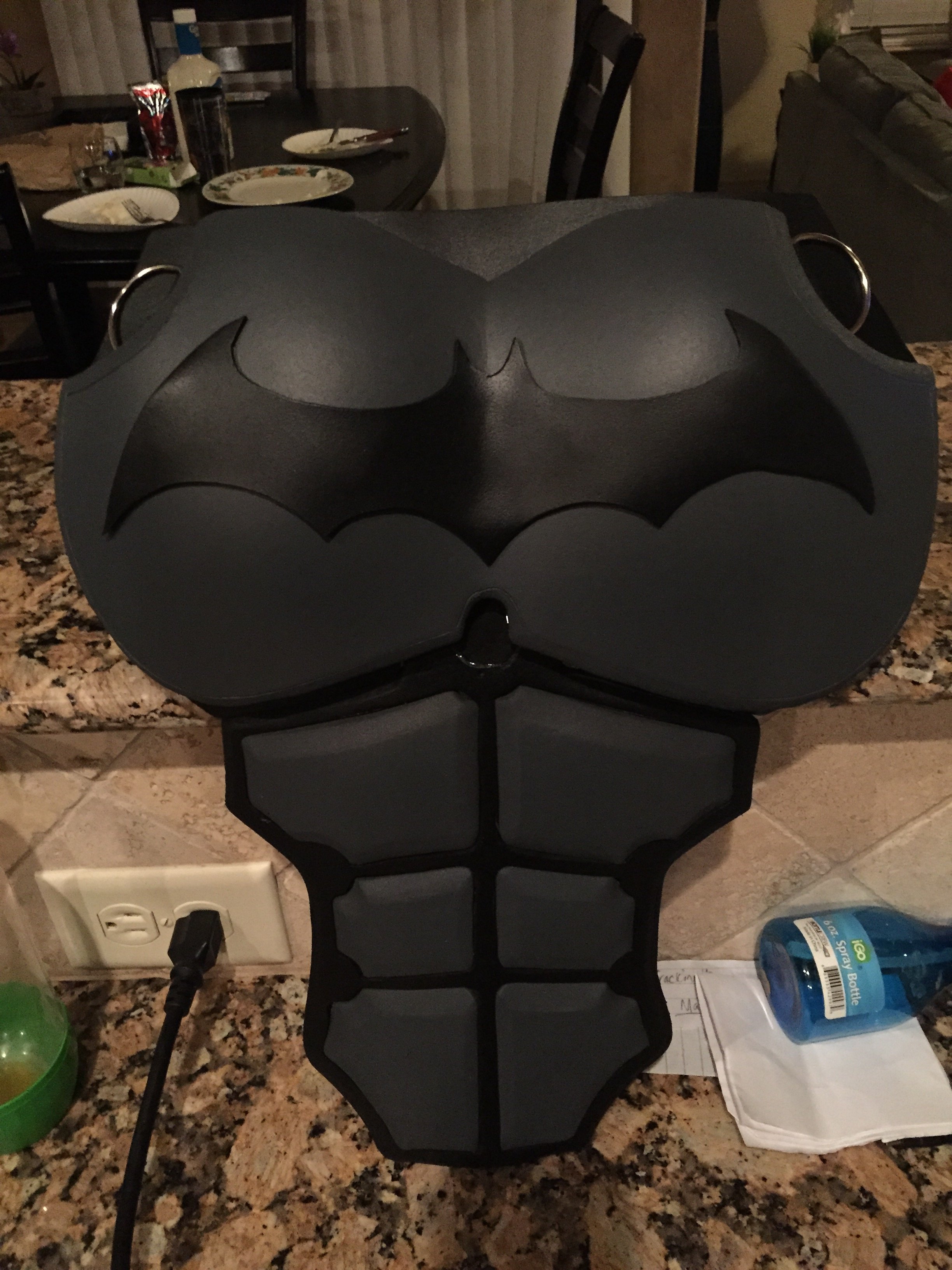

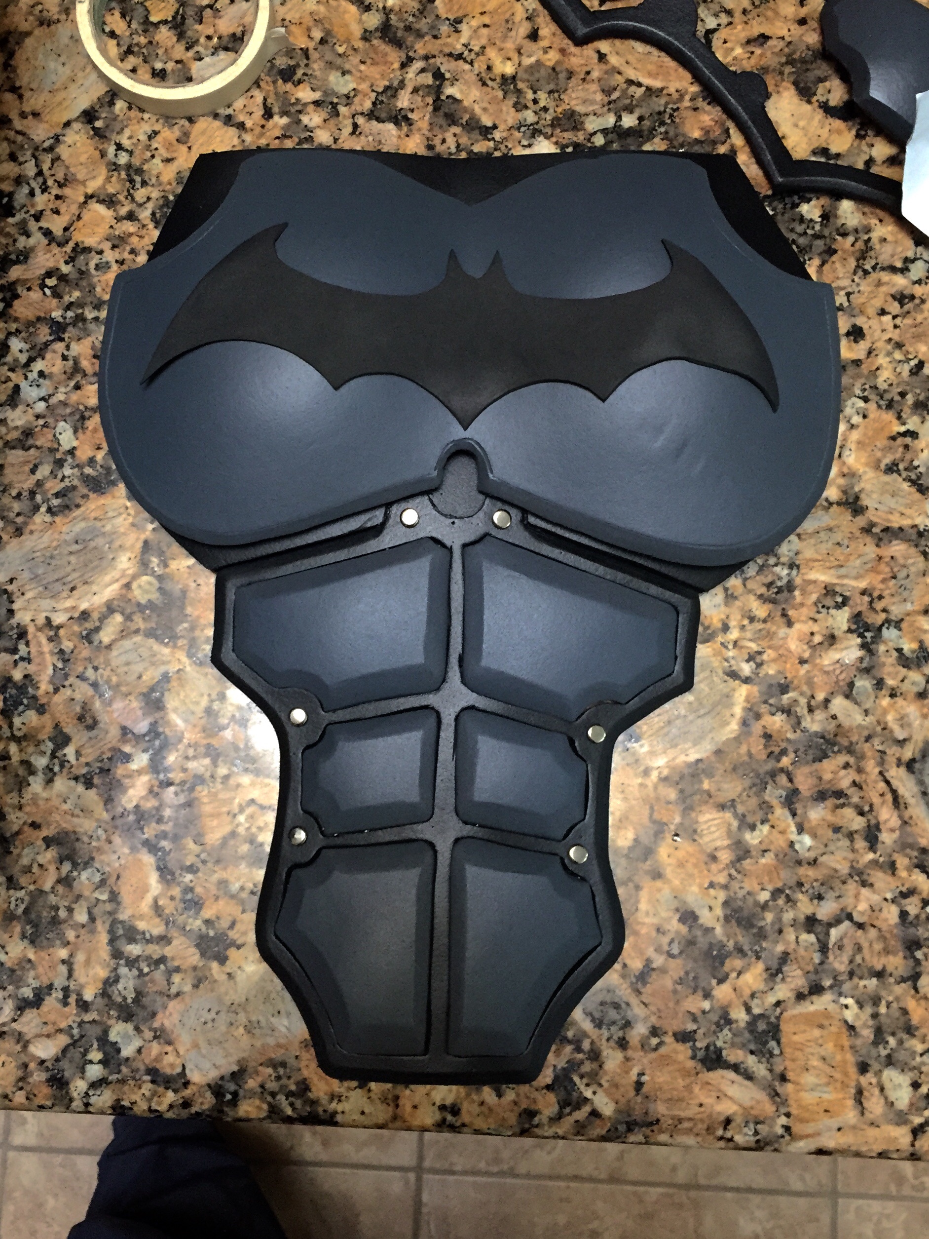

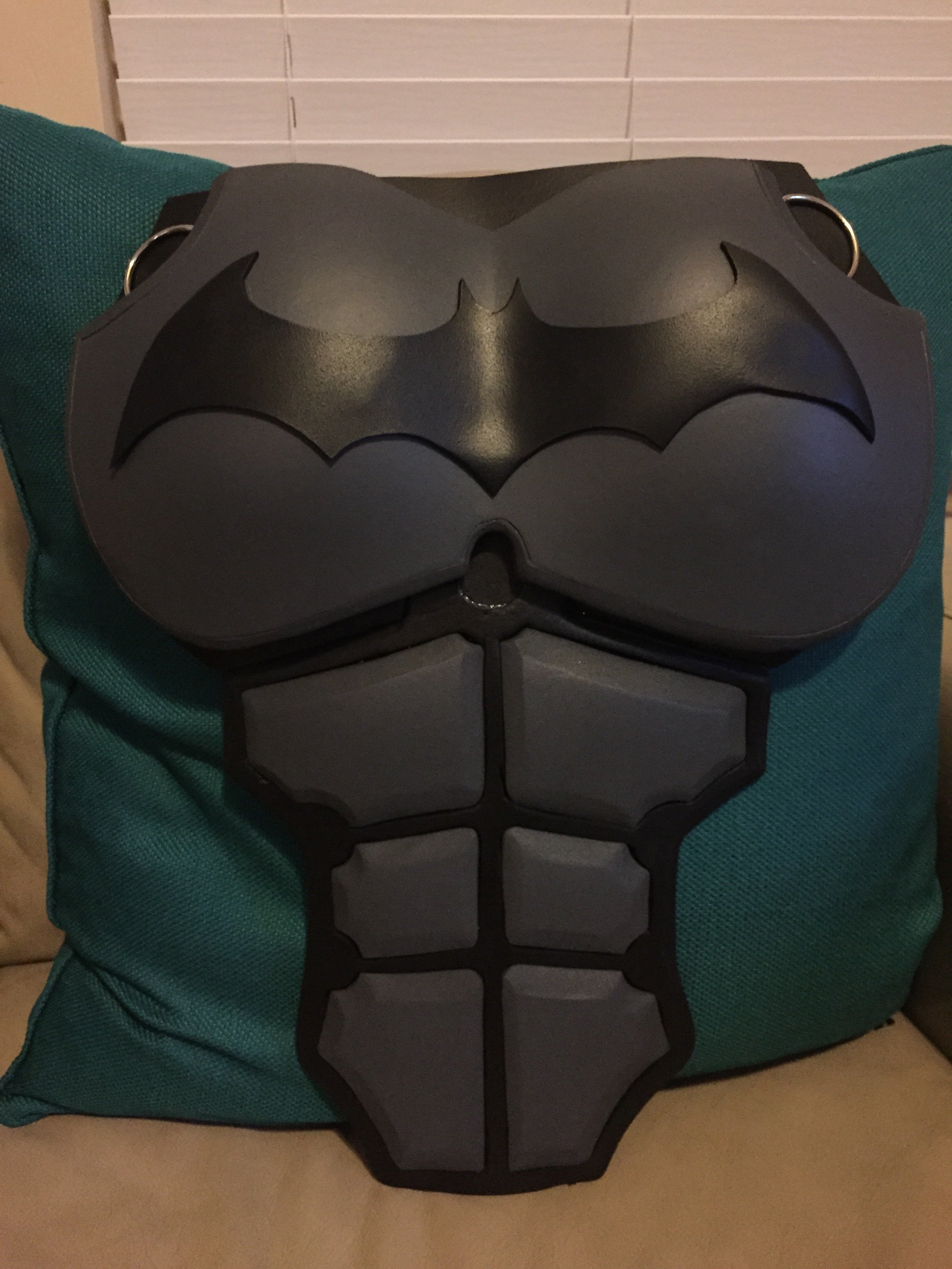

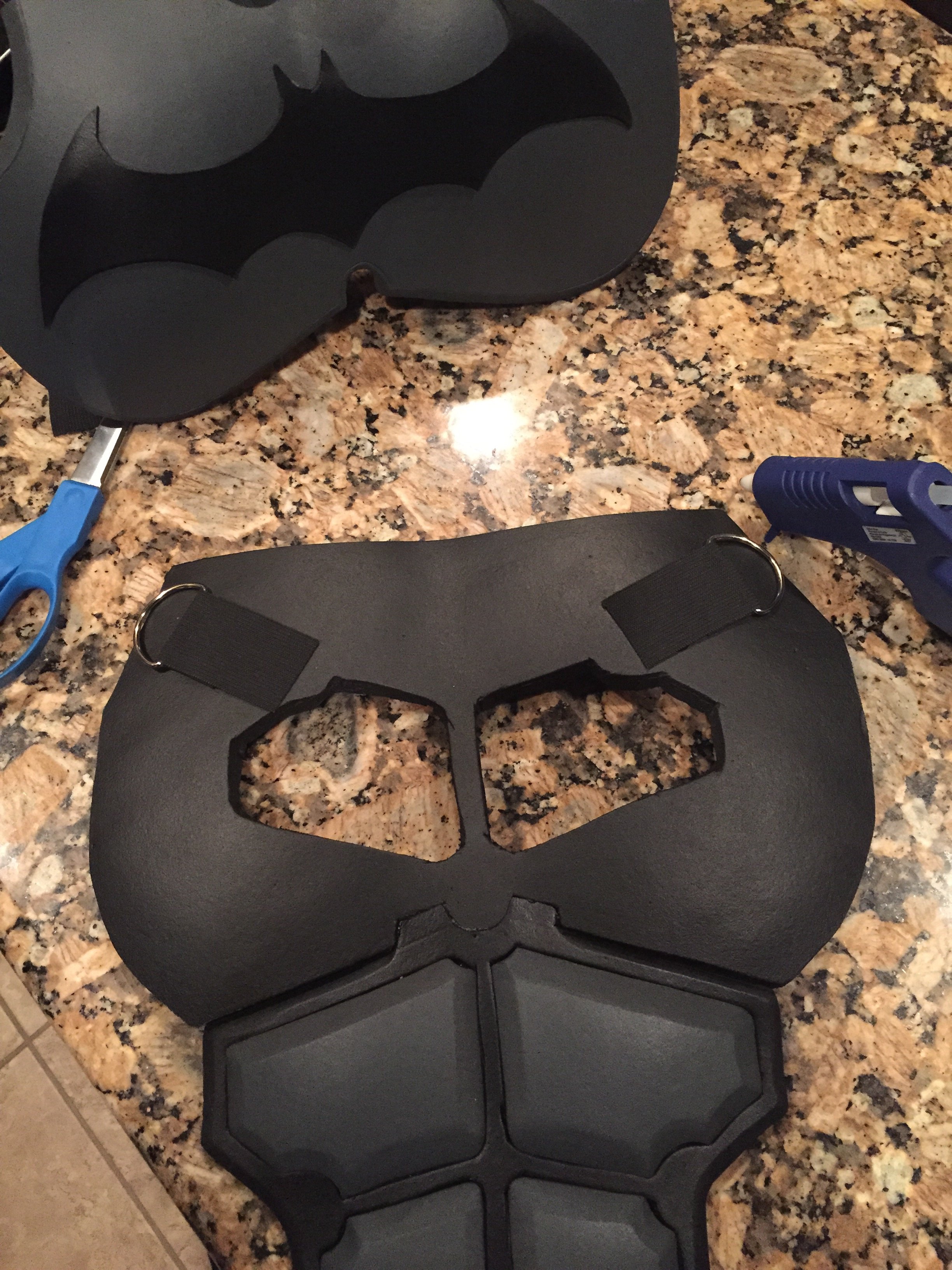

Glued the elastic straps the the under plate. Then glued the chest plate into place.
i also plastidipped the bat symbol. Then threw a couple coats of matte clear. Made it look like leather or vinyl. It's the only part that I think needs a little shine.
That looks really cool! That's it, I'm starting my armor over. Lol
Lol. Your gauntlets, boots and cowl look bad ass. Haven't seen the rest of your things assembled though. Feels good that it's a one piece now. Come a long way since my first version.. Still haven't decided on those snap rivets I bought or looking for some small hex bolts. That's why you don't see them glued on the armor yet.
