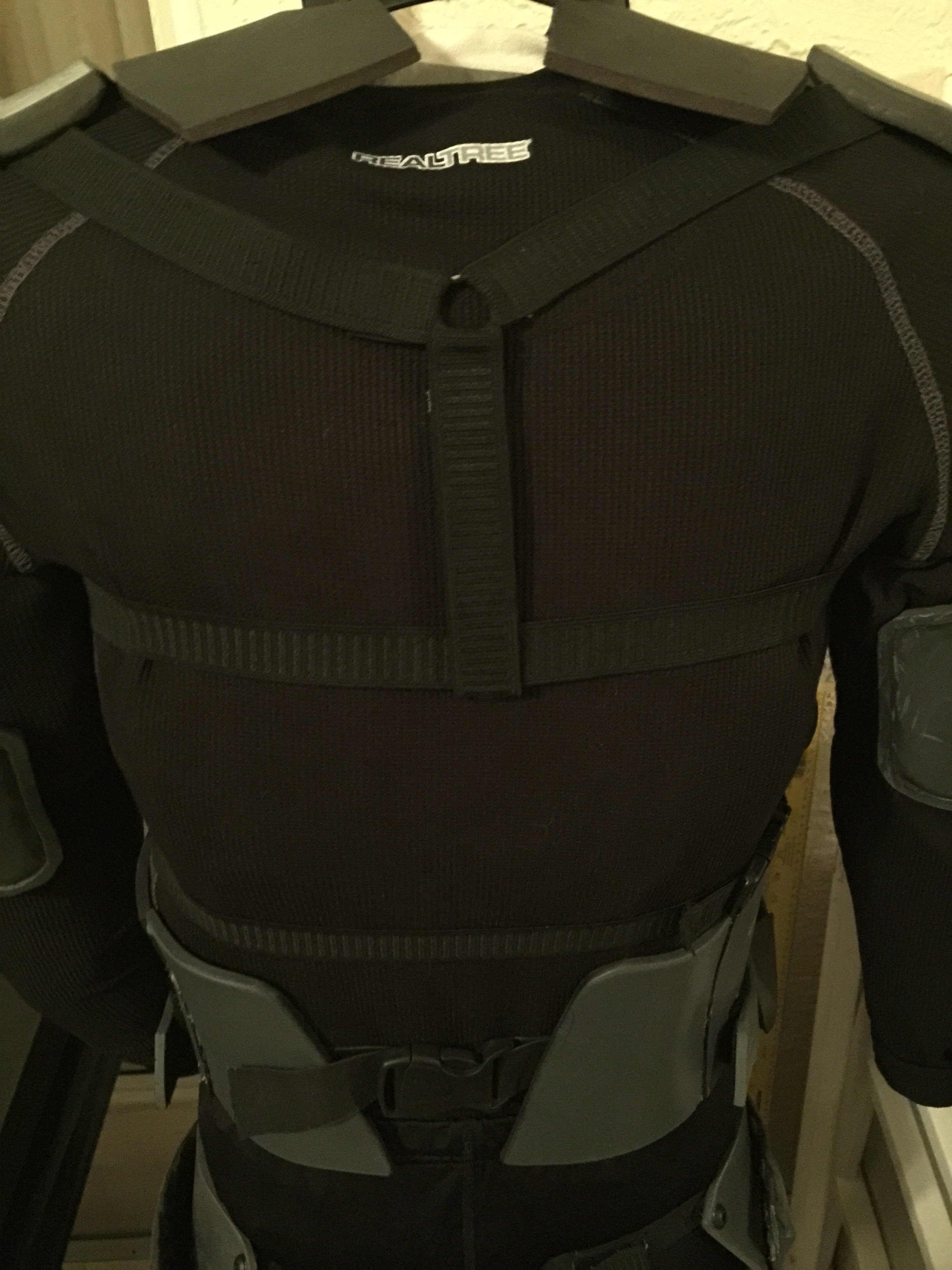

image.jpgThis is how I had it harnessed Floyd. All the straps adjustable and attached to parachute buckles.

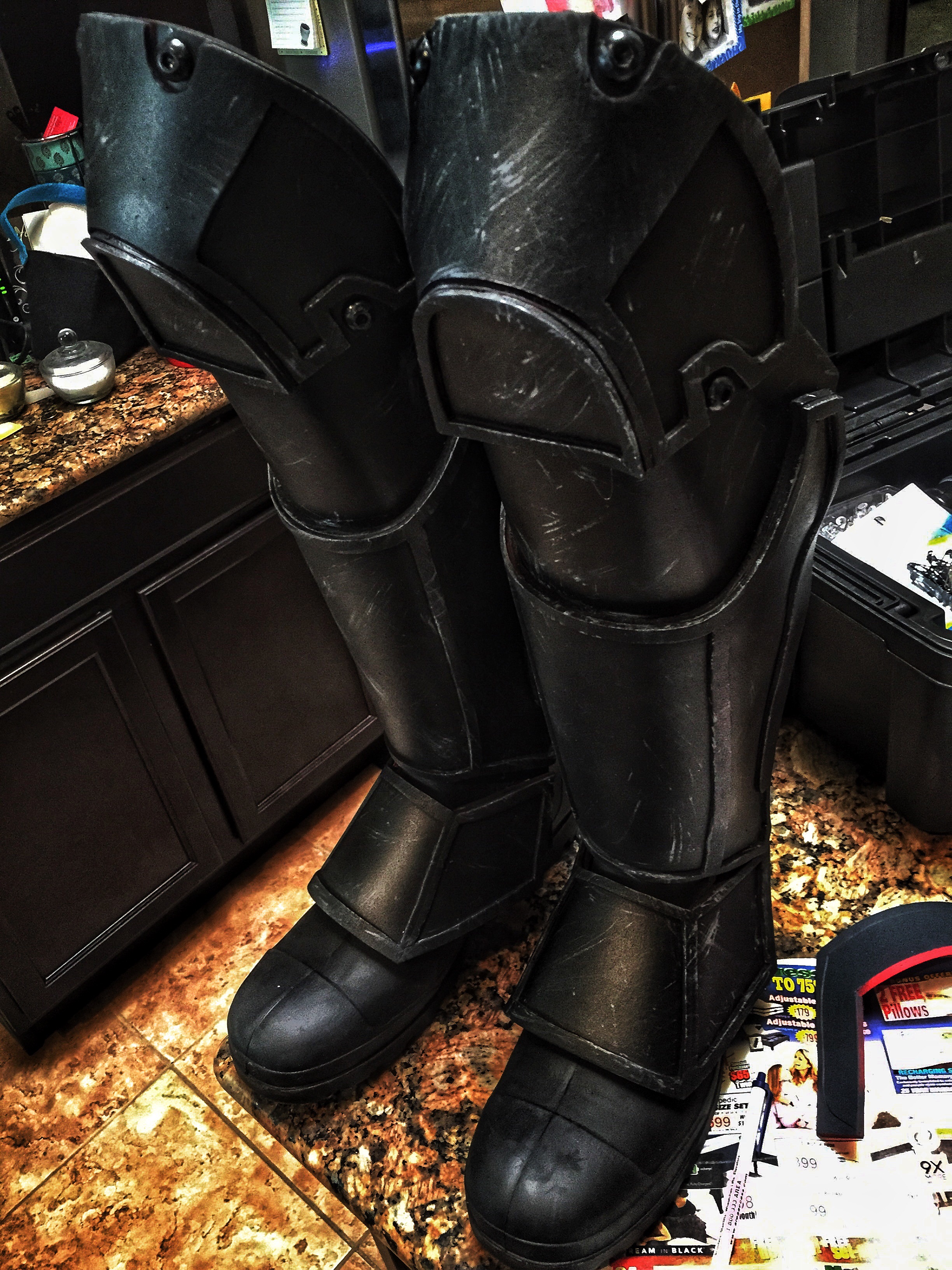

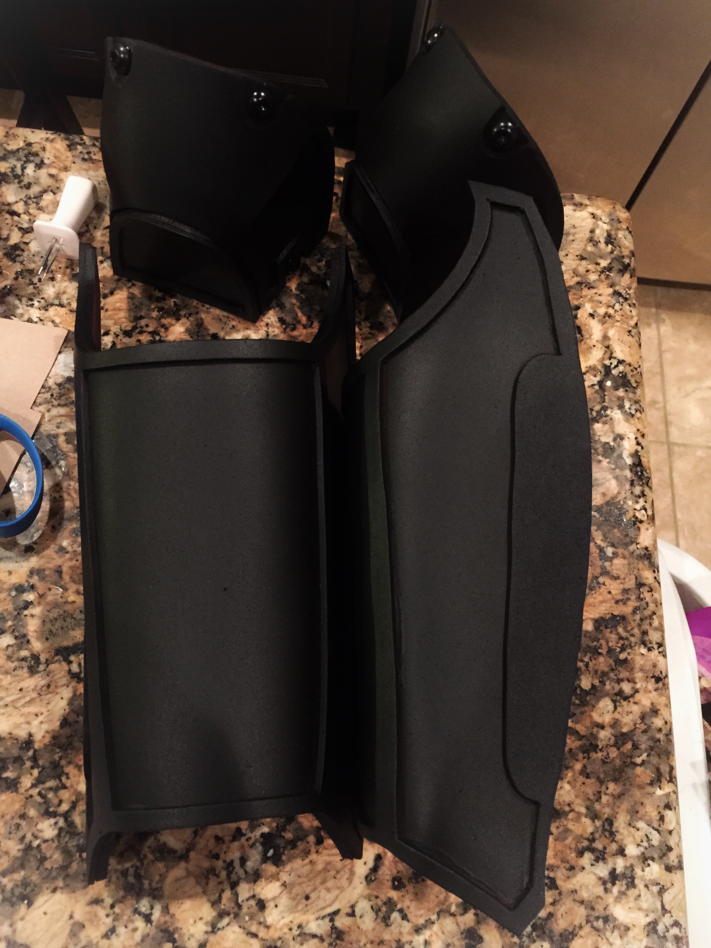

Note to self. Never use red eva foam if your going to plastidip it black. I should have known thay reds and oranges are the hardest colors to cover up. I've used more dip than I used on some of the other pieces trying to cover up the crevices that still show the red eva foam. I then had to go in with acrylic paint and a paintbrush to get the spots the plastidip wouldn't seep into. Live and learn. I'll try the brown next time if the black isn't available. Right now im working on the boots again. Bought some more elastic so I can pull the shin guards more flush to the boot. I found that hot glue doesn't really stick to the rain boots rubber surface. Even after letting it dry for some time it peels right off. Maybe an epoxy would work. But I'm actually better off with the elastic so they are removable allowing me to reuse the boot for the next build. Also going to try adding some of the grey padding under the armored plates to give it some additional color and dimension.
Scrubbed the idea of placing more grey padding under the armored pieces. Looks kind da cool but makes a squeaking noise when I walk. Lol. Not very batman-ish. :p
You say that there are crevices that show red and orange, but I see no such thing. Here's some advise that my instructor told me: If the audience needs to come closer to see the imperfections, then your doing it right. And these shins...I would've mistaken them for metal shins, given a different background. They're AWESOME!
