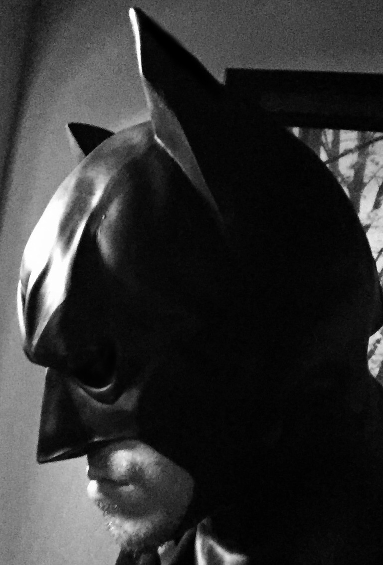

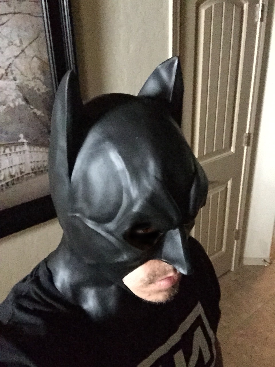

image.jpgimage.jpgimage.jpgHere are some images of the store bought cowl.
Not great, but not bad either. One of the ears is floppy so I'll have to prop it up a bit and the eye holes don't seem completely symmetrical but oh well. Gotta work with what I got.

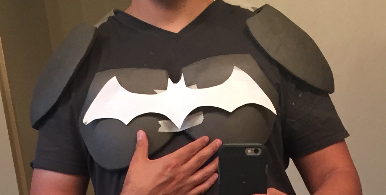

I decided to start with the chest plate and on my first attempt cut two separate pectoral pieces which I was going to glue together. Cut was rough. As were the shoulder pads.image.jpg

I had one of those batman masks, i found if i needed it re shaped, i used a hairdryer on low heat to warm it, then reshape it then run it under a cold tap. Also cut crude 3d triangles and taped them into the ear to keep them upright and solid. Hope this helps!

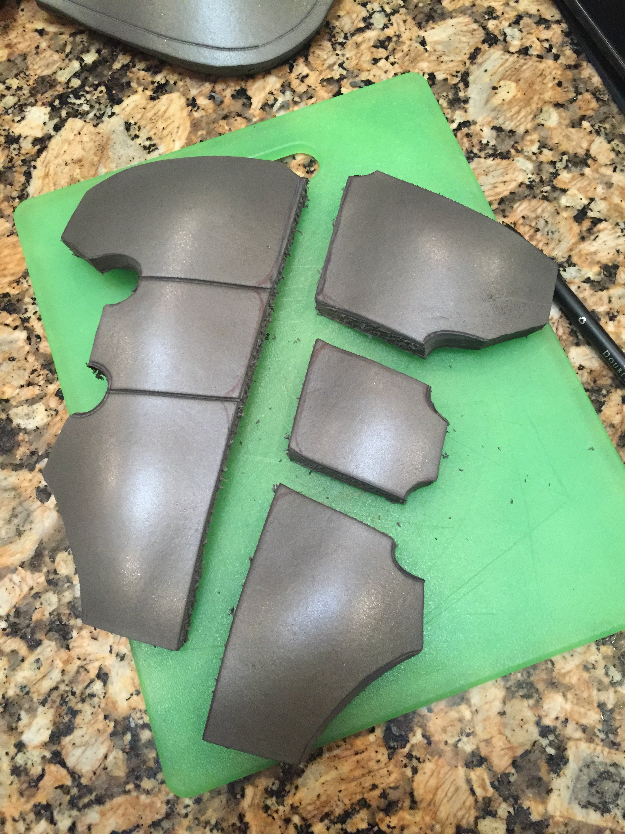

Now it's time to shape those abs baby! Time to get cut in the gut! Added the cuts for the bolts or rivets that seem to run around the abdominal armor plates and separated the plates into 6 individual pieces. image.jpgimage.jpgimage.jpgNow that looks better.
Thanks for the advise. I'll give it a go and see if I can reshape the eye and prop them ears.

image.jpgimage.jpgimage.jpgThink it displayed them in the wrong order but you get the picture.
I think the bevel of the edges really gave it some much needed dimension. I'll try it on in a bit.

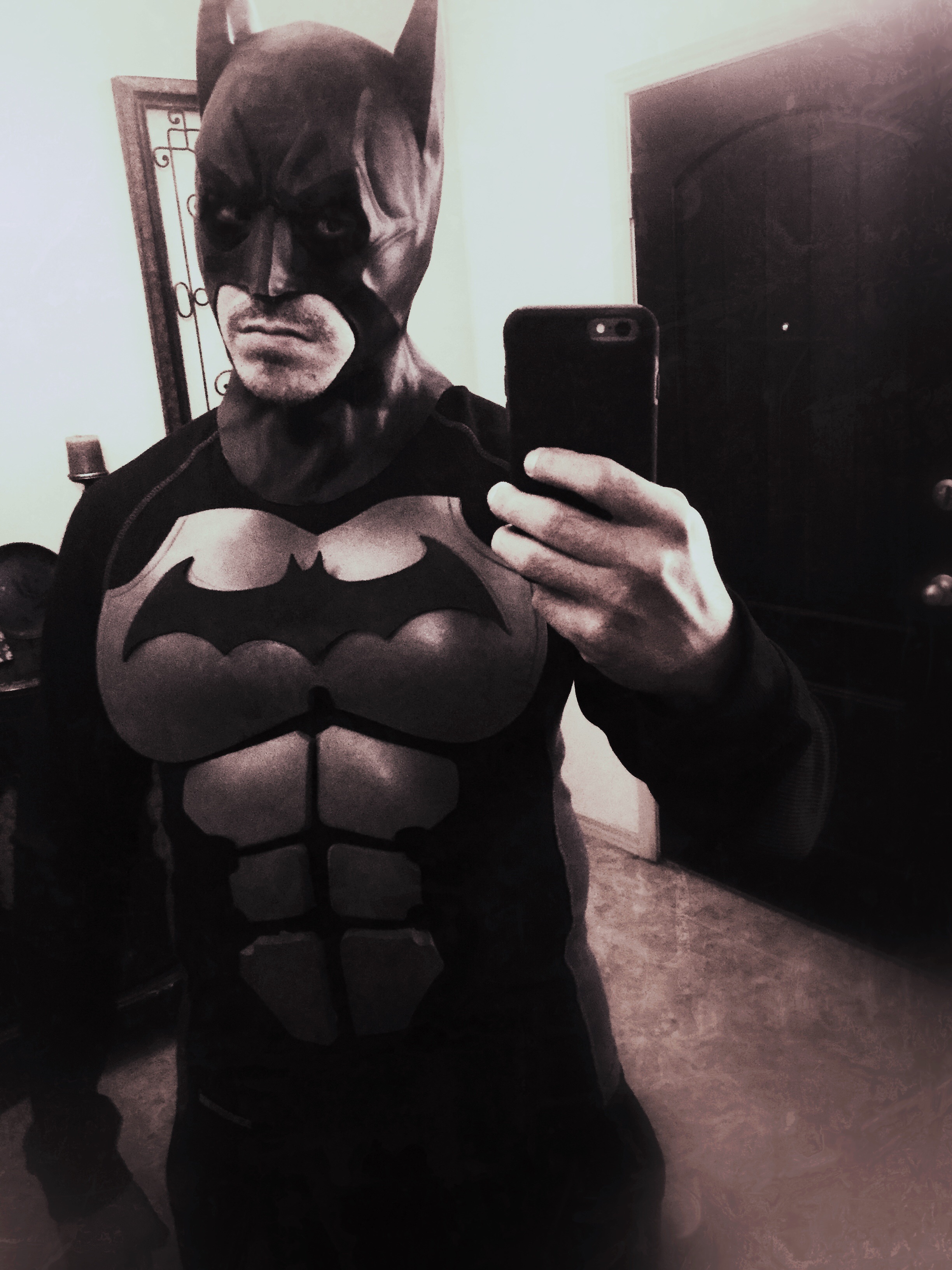

Taped up against the body again. I'm digging it. Need to stop by the fabric store to get some black vinyl. image.jpgimage.jpg
