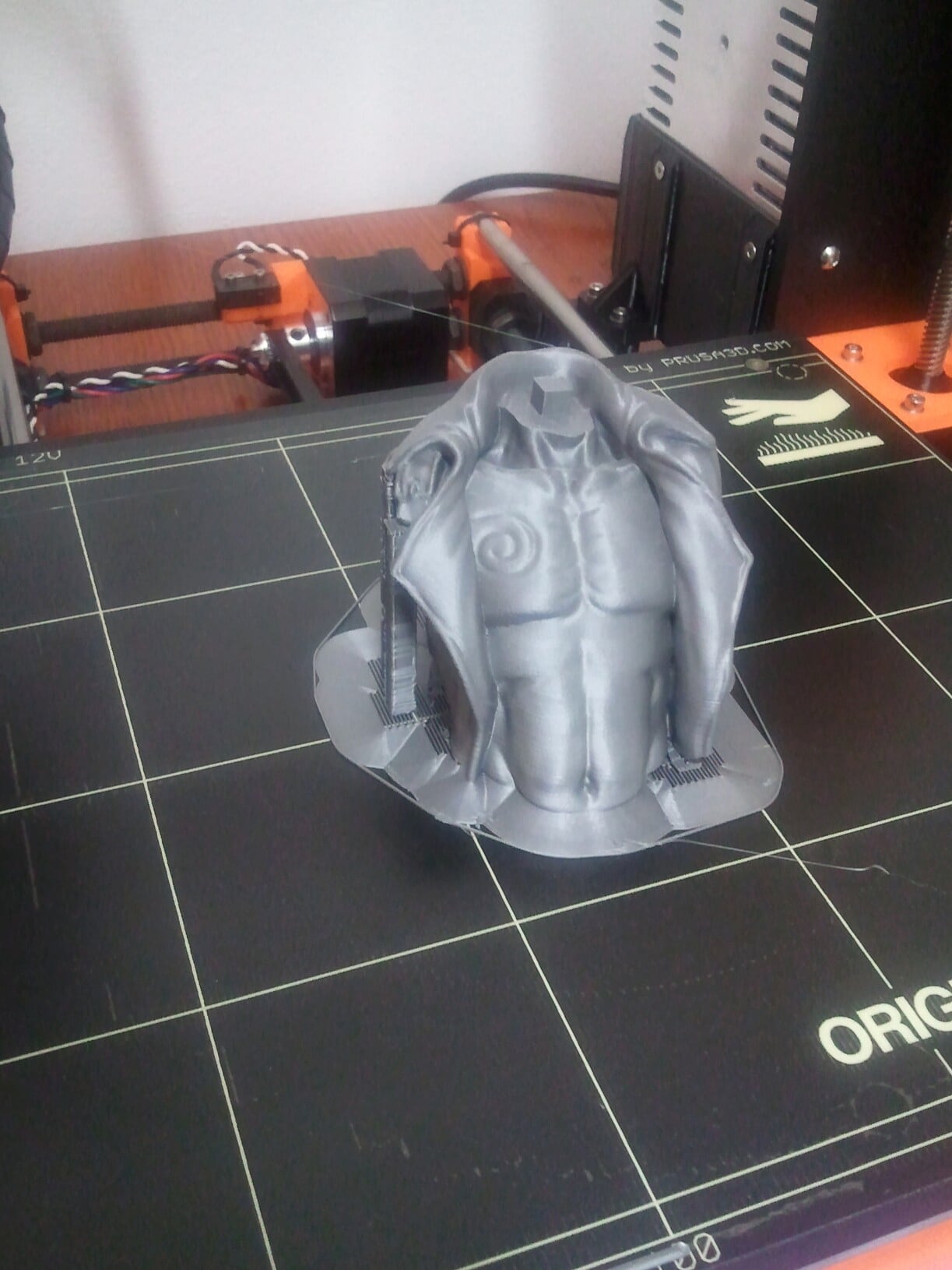

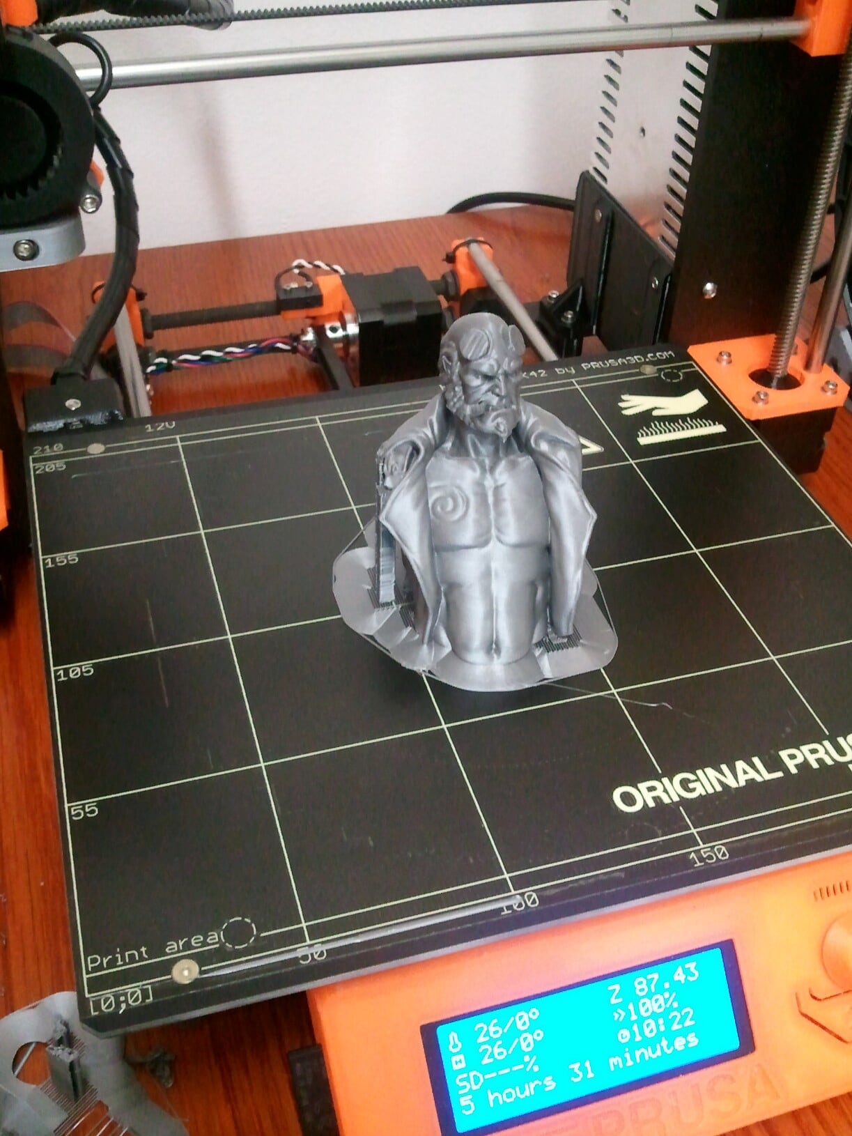

Here are examples of what I can do with my Prusa I3 MK2 printer stock with just some fine tuning and a bit of trial and error to get the specific filament to print nice.
Hellboy
nz1jVPZVI-jOm35j0Gznjw3vrR20-lPY5H1YuegCTSako4B48G7RHx2I0eg?width=1223&height=1630&cropmode=none.jpg
Head is a seperate piece I printed prior in a higher resolution @50 microns while the body is variable layer height for a quicker print. They took about the same amount of time if I recall correctly. Scale is about 1/8. It's a free model of Hellboy made by "Printed Obesession" on Myminifactory if anyone is interested.
VRVZYdn1uPXvdw_r48OUBKDNRmX9sUqfbuPHfLet3tL7MZ_GbwV5Dkaddqg?width=1223&height=1630&cropmode=none.jpg
Here it is again without the head. Sorry for the smudgy pic.

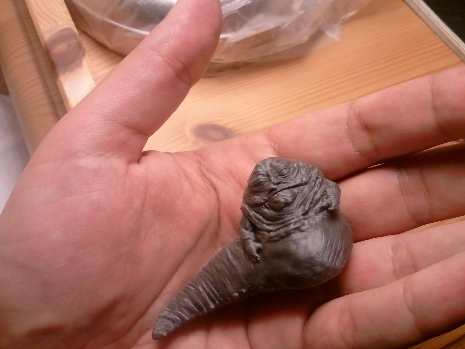

Miniature game size Jabba.
Also a free model available on Thingiverse I think? It's basically the second model I printed before I knew what was what exactly and it turned out pretty great except for the overhanging fingers as I did not use any supports.
Jcp_6QNkGx0Zwd61WTLOvawRySLc13bWKjD3_sSPICO-6VZ8nmQFbtRsXLw?width=1630&height=1223&cropmode=none.jpg
I hope that gives you an idea of what you can do with an FDM printer besides mechanical and functional parts.
