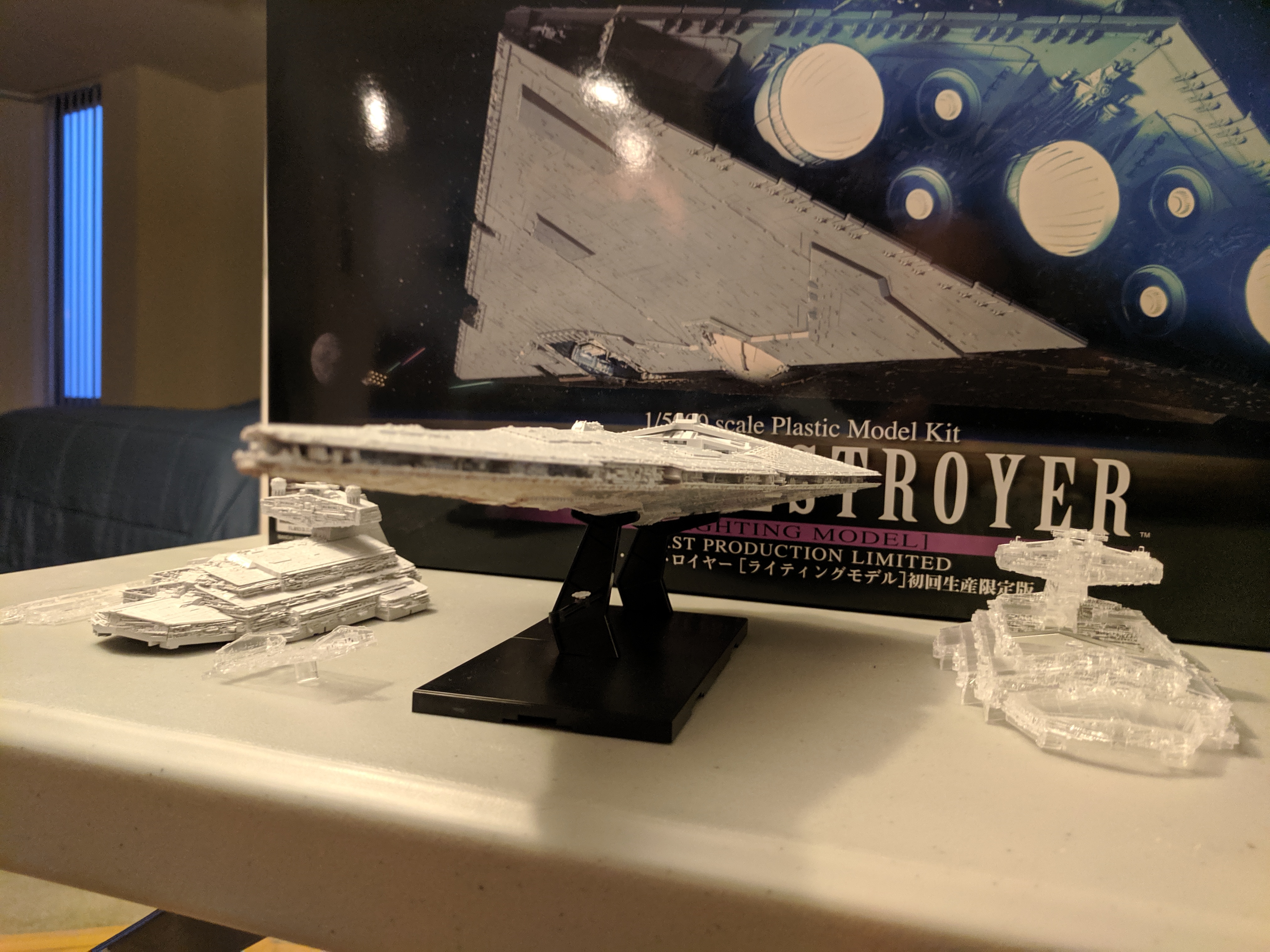

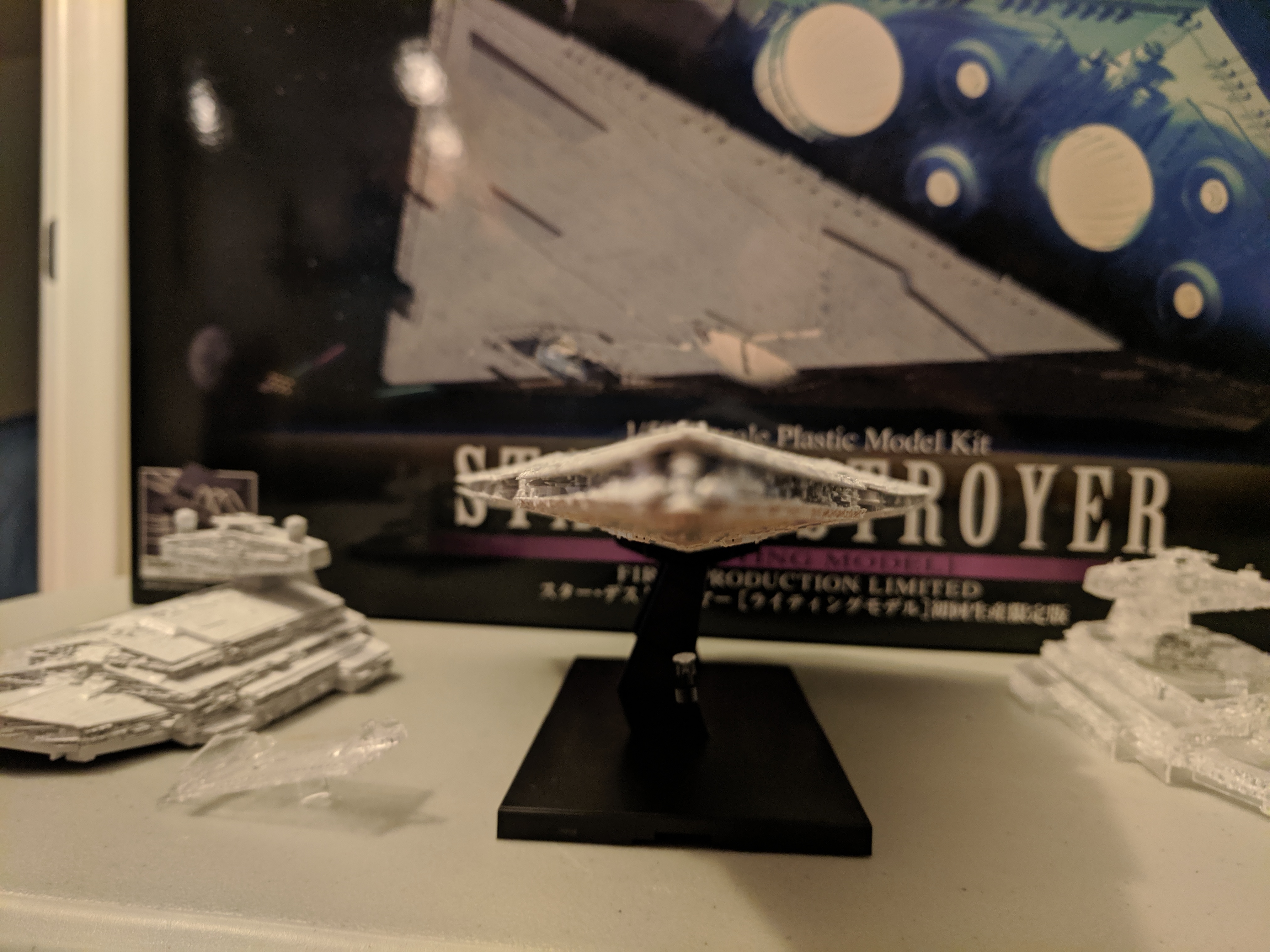

View attachment 1056384View attachment 1056385

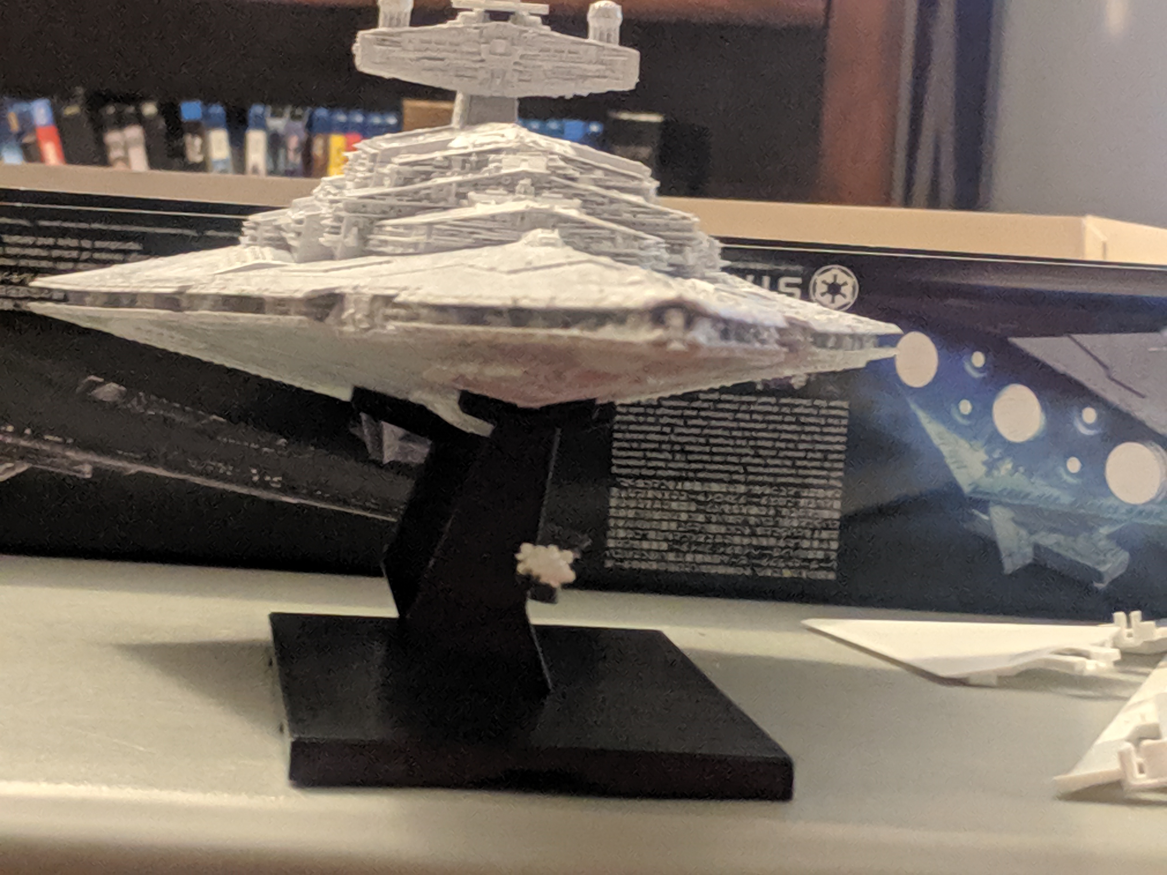

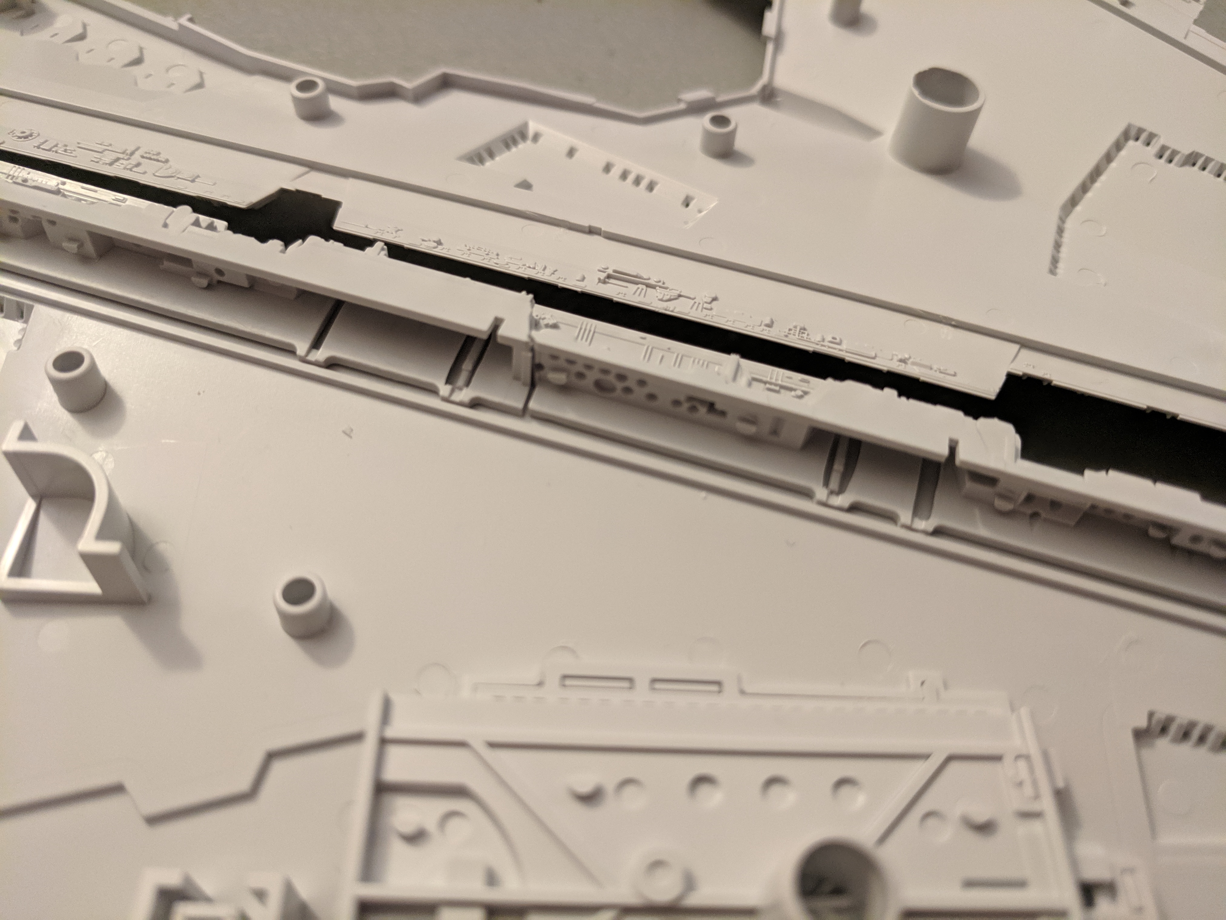

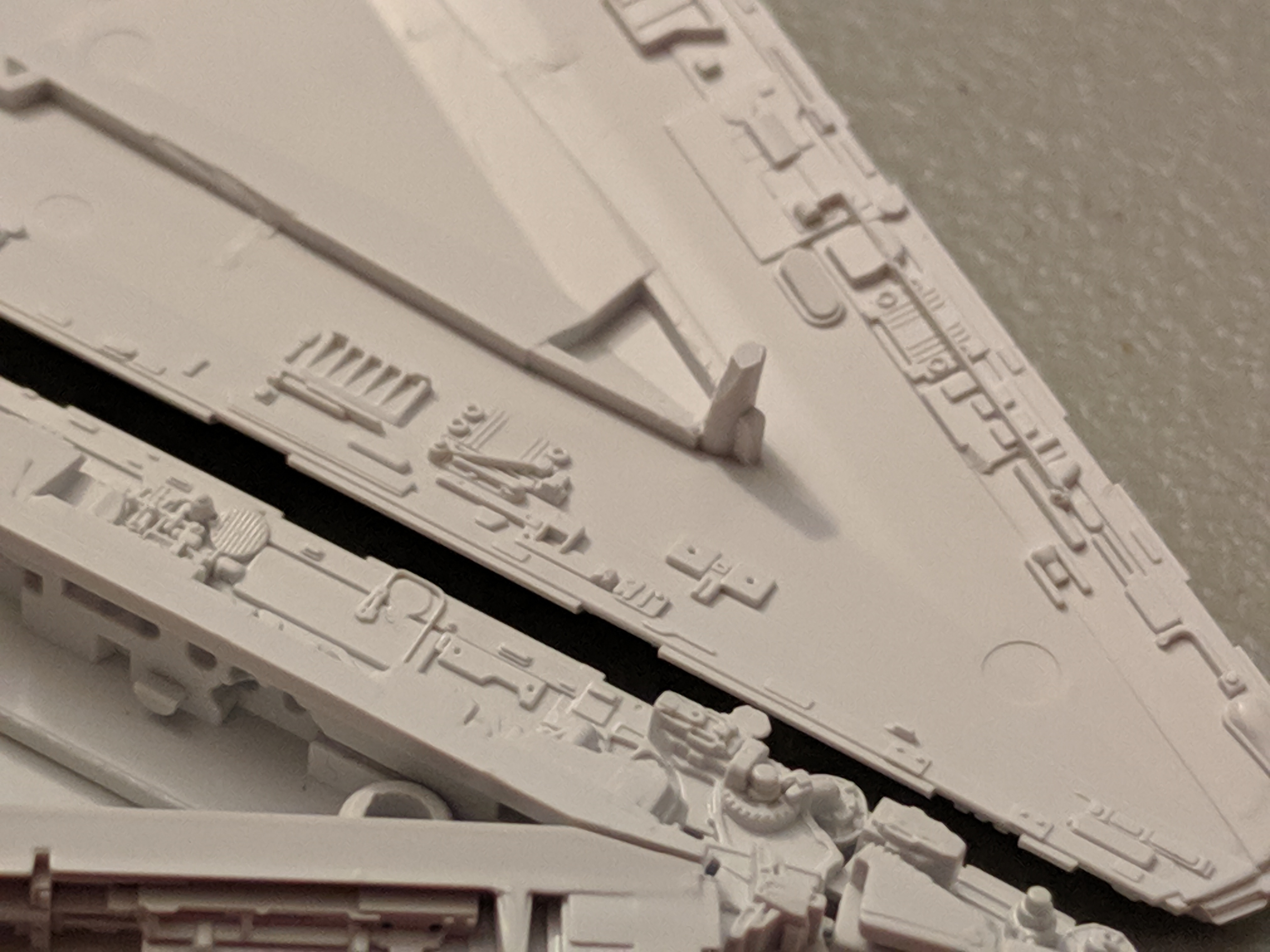

Just got my lighting version of the kit and was test fitting... yea i noticed the warping right away. Will try removing the front trench tabs as suggested. The top and bottom parts of the main hull + the trenches are all straight until the tabs are involved. Im glad you guys brought this up - thought it was just me. This kit has AMAZING detail that I have been waiting for since I built one of those really off key 1990s ertil kits back in the day.

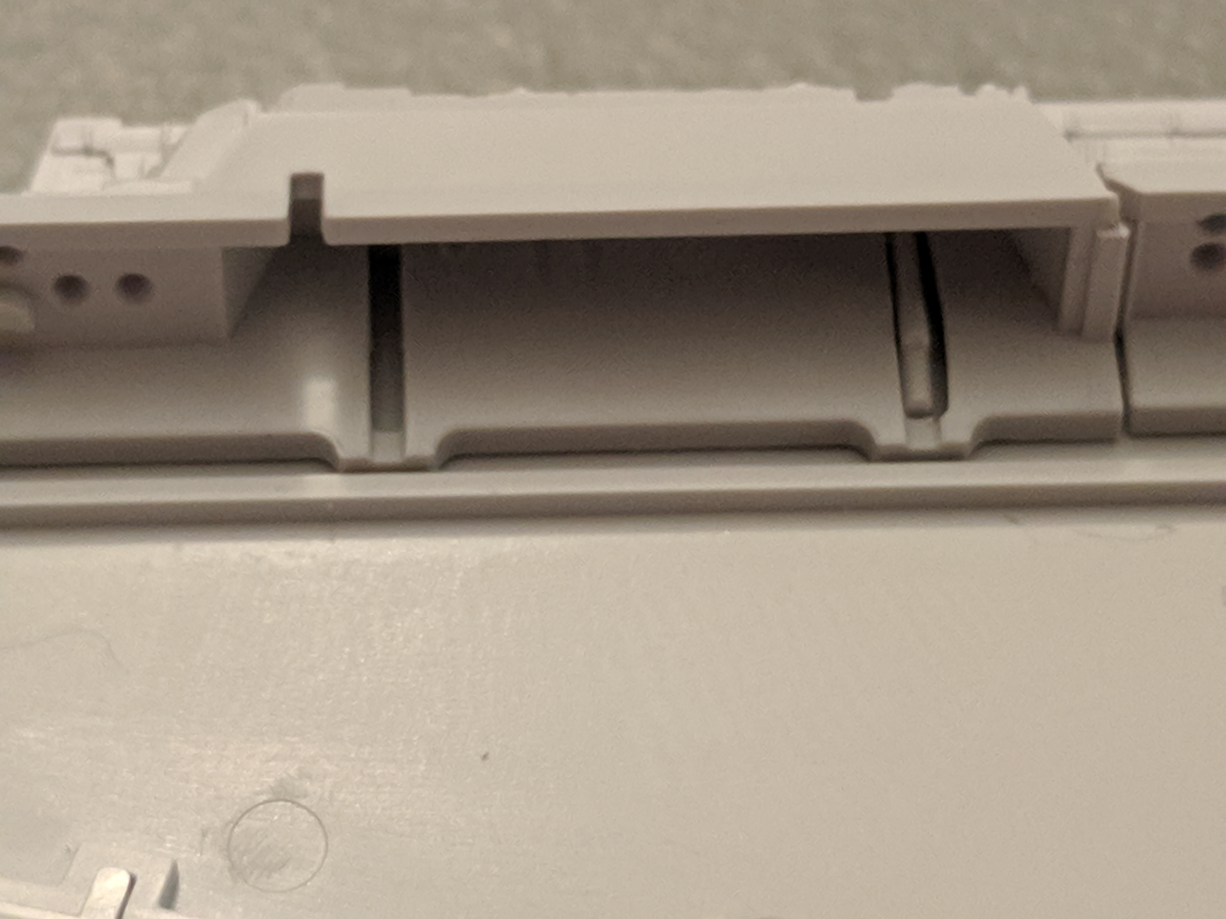

View attachment 1057908View attachment 1057909View attachment 1057910
So is it essentially the tabs that warp the front part of the hull then? And removing them definitely gets rid of the issue. Just trying to prepare myself for when mine arrives.

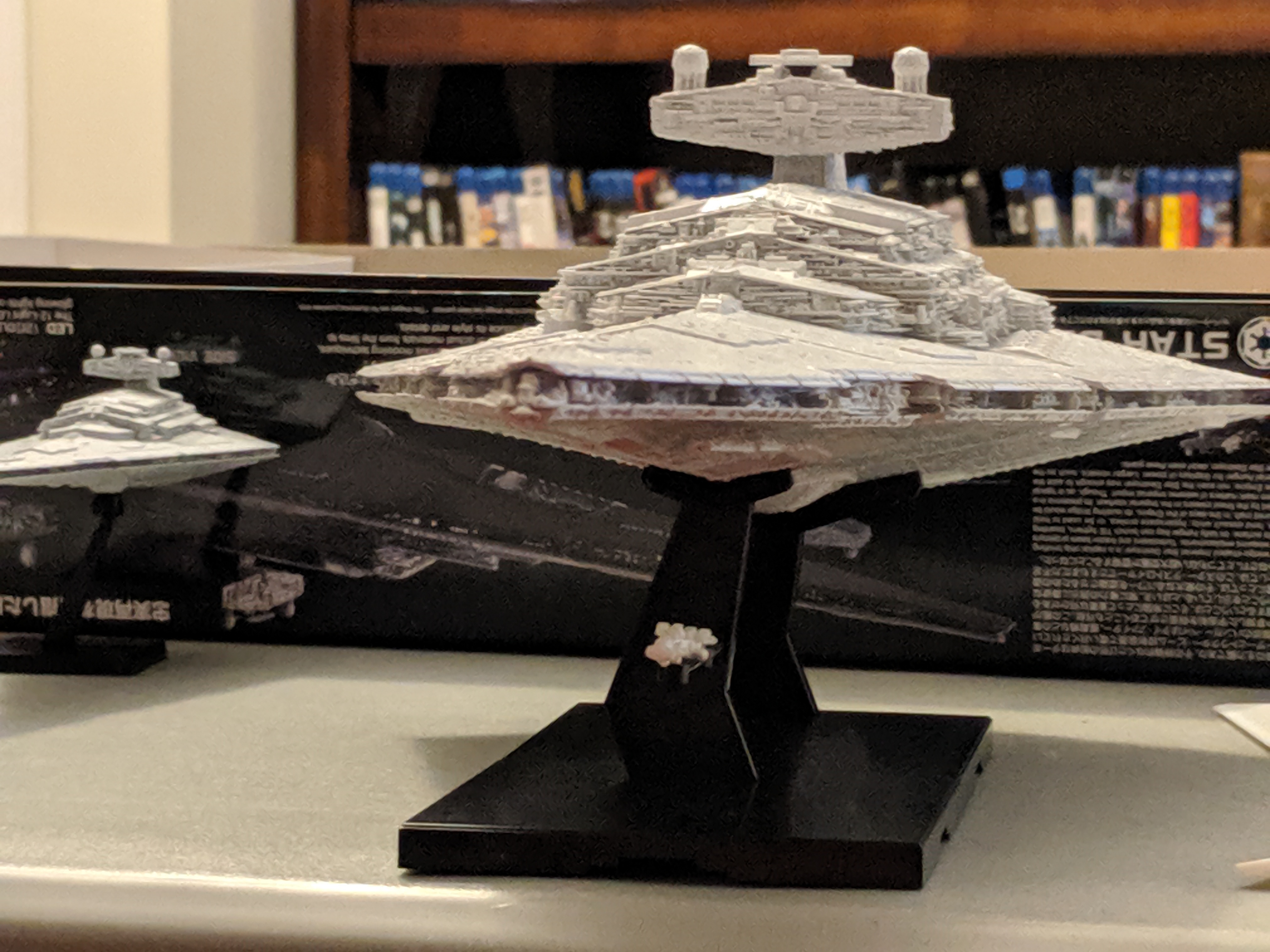

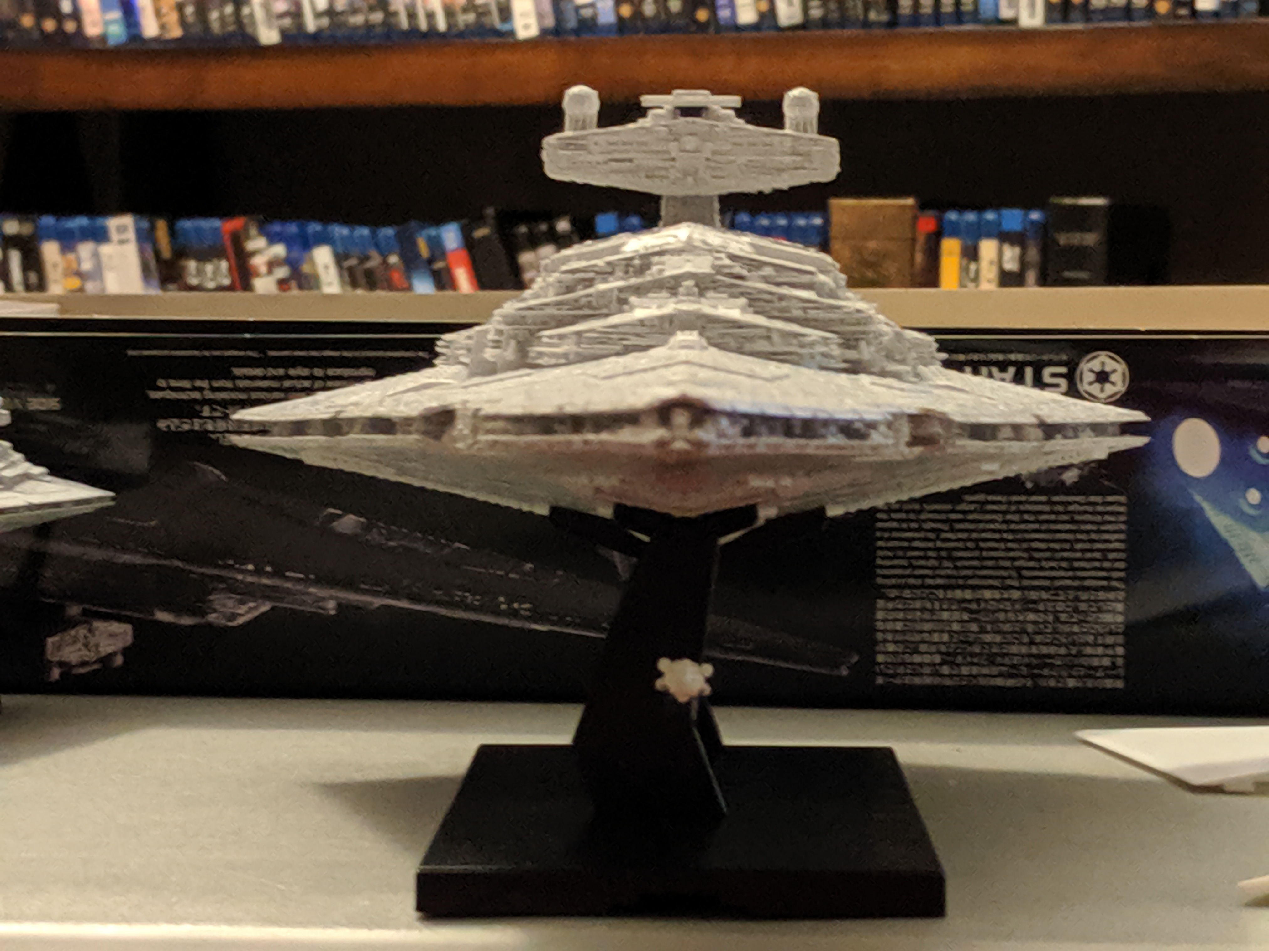

r0ver i think it just might - Here is what I got be removing the lower middle tabs so far from each of the 4 trench inserts. I also widened the tab holes for remaining tabs to help remove some of the stress bringing the bow up. Additionally i shaved the front peg down a bit and removed all the tabs from the top port side. Starboard side seems perfect, port side is still a bit curved but I think the clamp and glue final assembly will take care of that.
I noticed when i assemble the entire thing with the white light blocking interior parts the curve comes back a bit more. not sure if I will just sand away more or do the lighting without the interior parts and go the fiber route.
