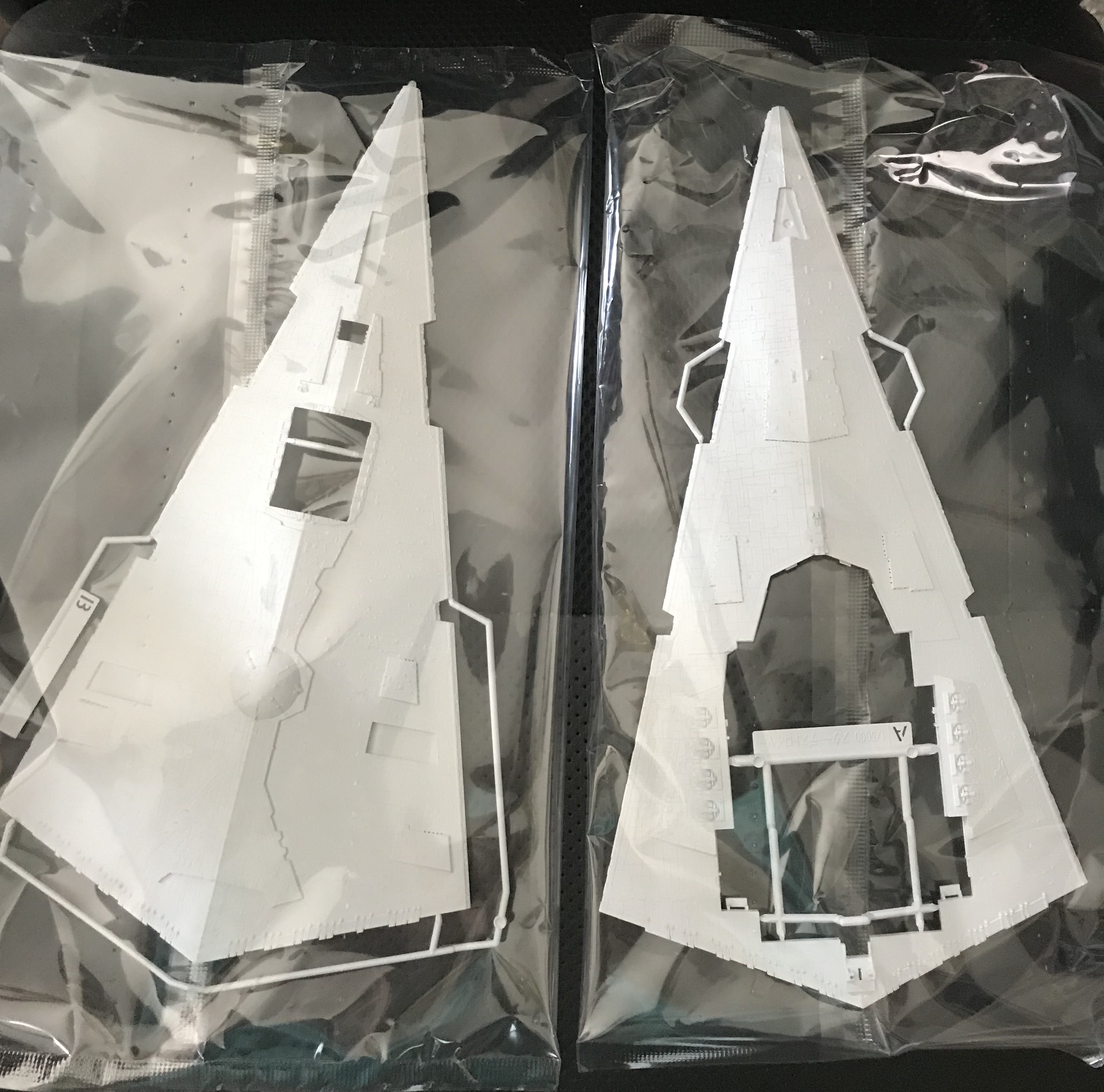

First thing I noticed upon opening the kit - is that the upper and lower hulls ARE NOT taped to cardboard as a lot of unboxing videos from Japan have showed. My kit had them loose in the clear mylar bags:
I do not know if that will in any wise lessen the warping of the bow in a lot of the builds I have seen. Thanks to what Wolfy762 has shared with his kit, I may employ the same method of shaving down the pegs and gluing the hulls and using clamps for the final assembly.

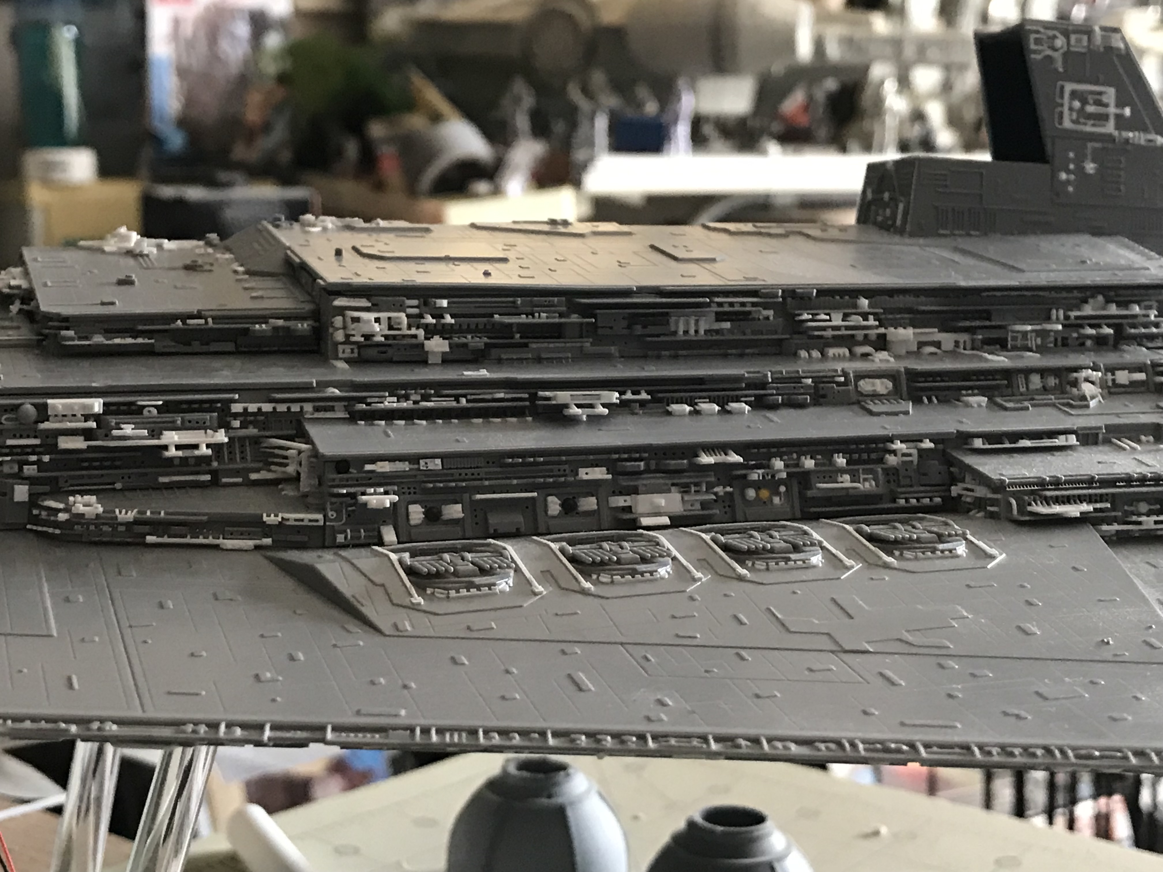

The level of detail on this kit is unbelievably OUTSTANDING and dead-balls accurate in most places I have glanced over. I can say that as an amateur expert given the couple of years I have spent staring at High-Res pics of the ILM 8 foot model and carving styrene details to put on the comparably plain Zvezda. This photo does no justice to the level of minuscule detail and depth Bandai has managed to obtain on a kit at this scale:
For shiggles and mirth here is the same exact section on the larger scaled Revell 'build and play' model toy:

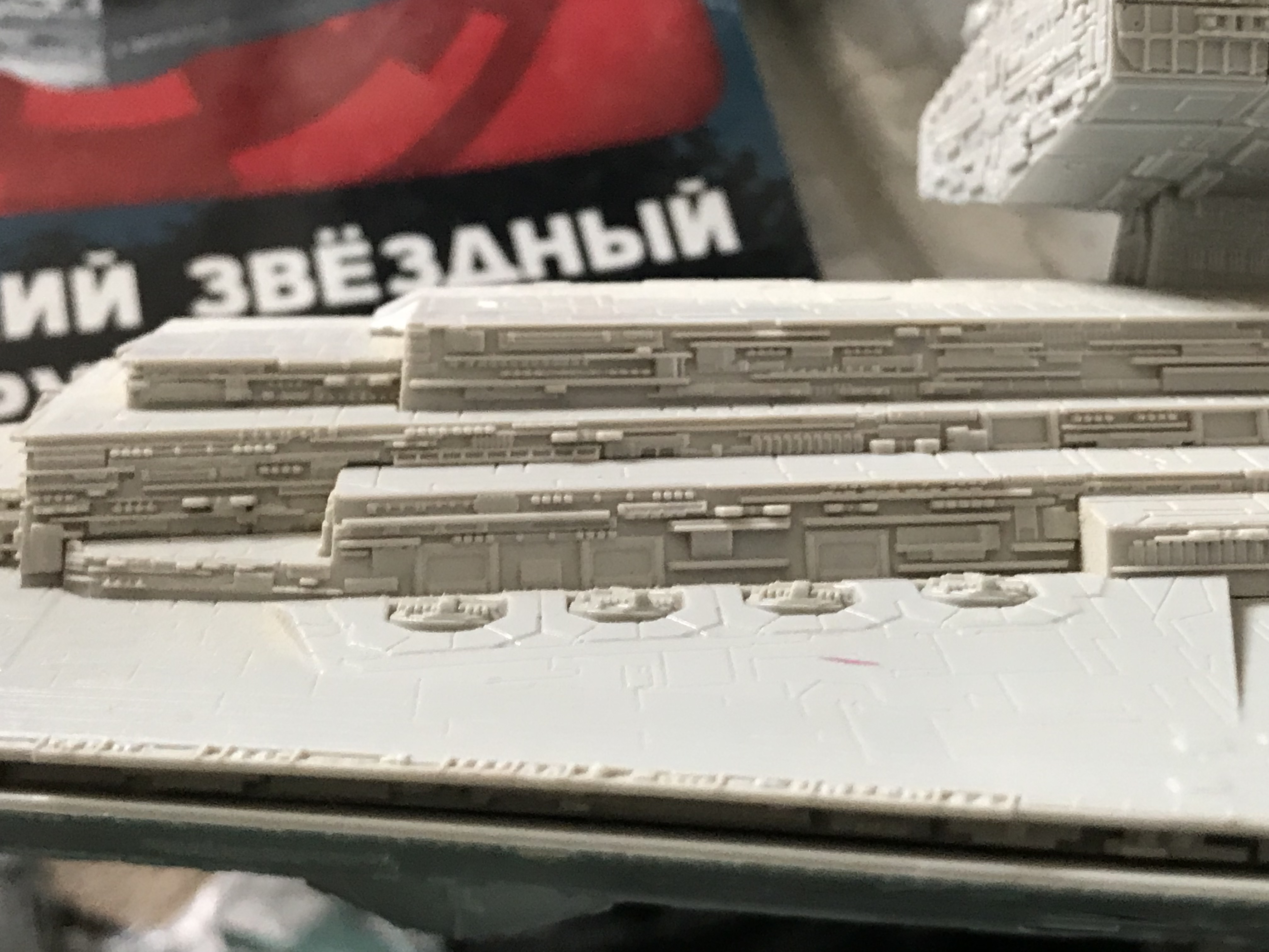

And here is the same section I carved up and built on the Zvezda:

The level of detail on this kit is unbelievably OUTSTANDING...This photo does no justice to the level of minuscule detail and depth Bandai has managed to obtain on a kit at this scale:
Yeah...I don't see much of a difference.
