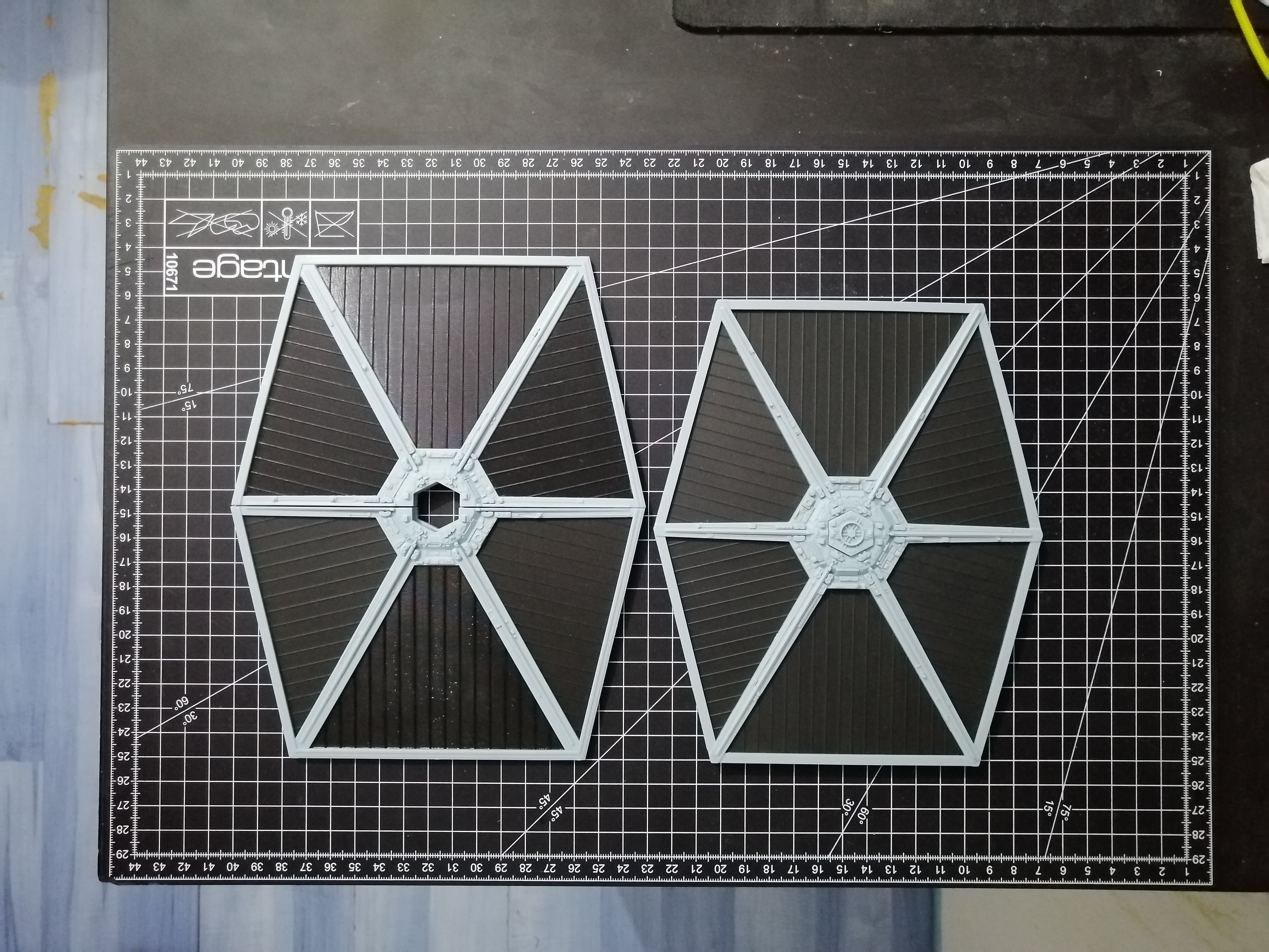

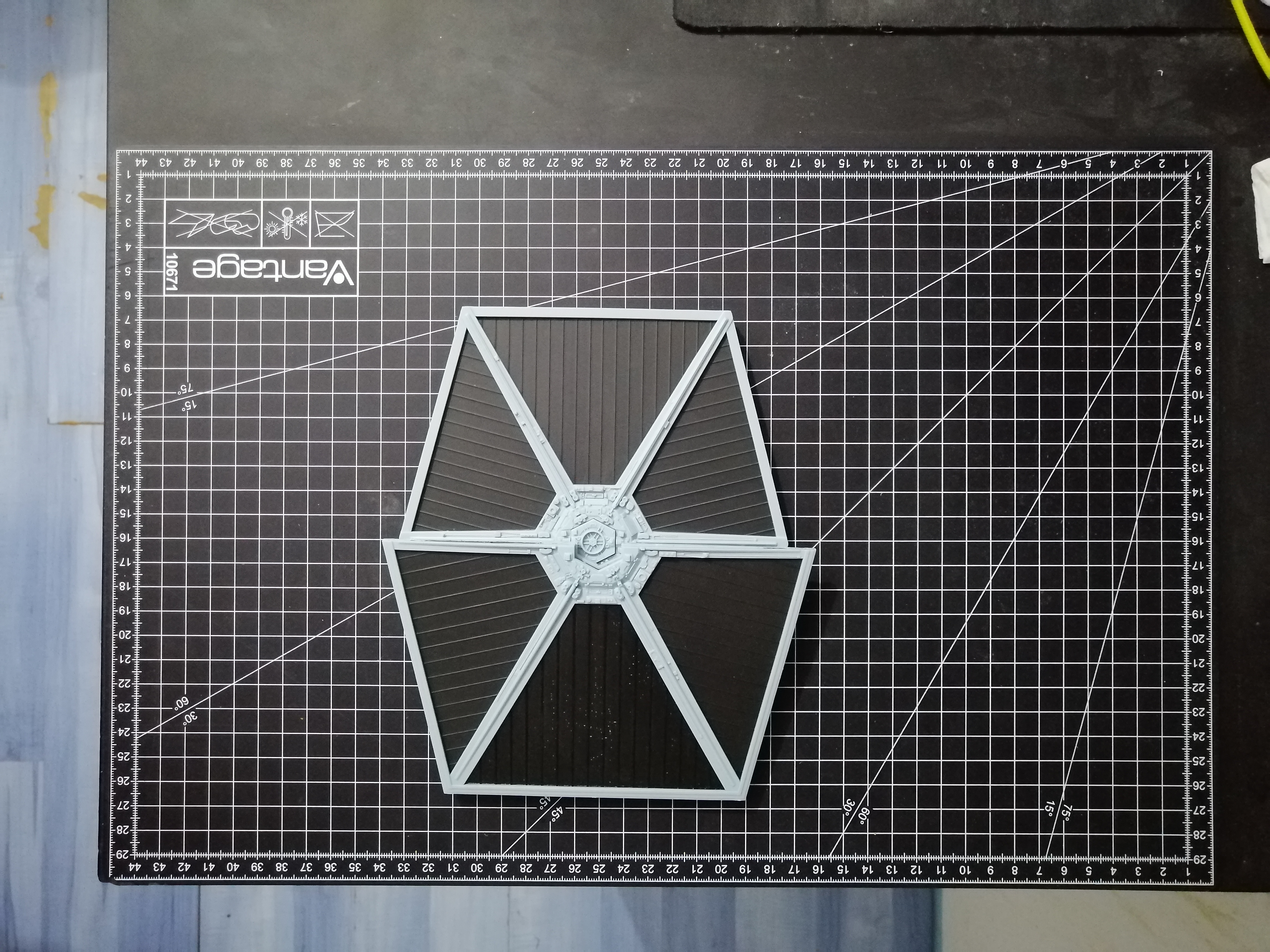

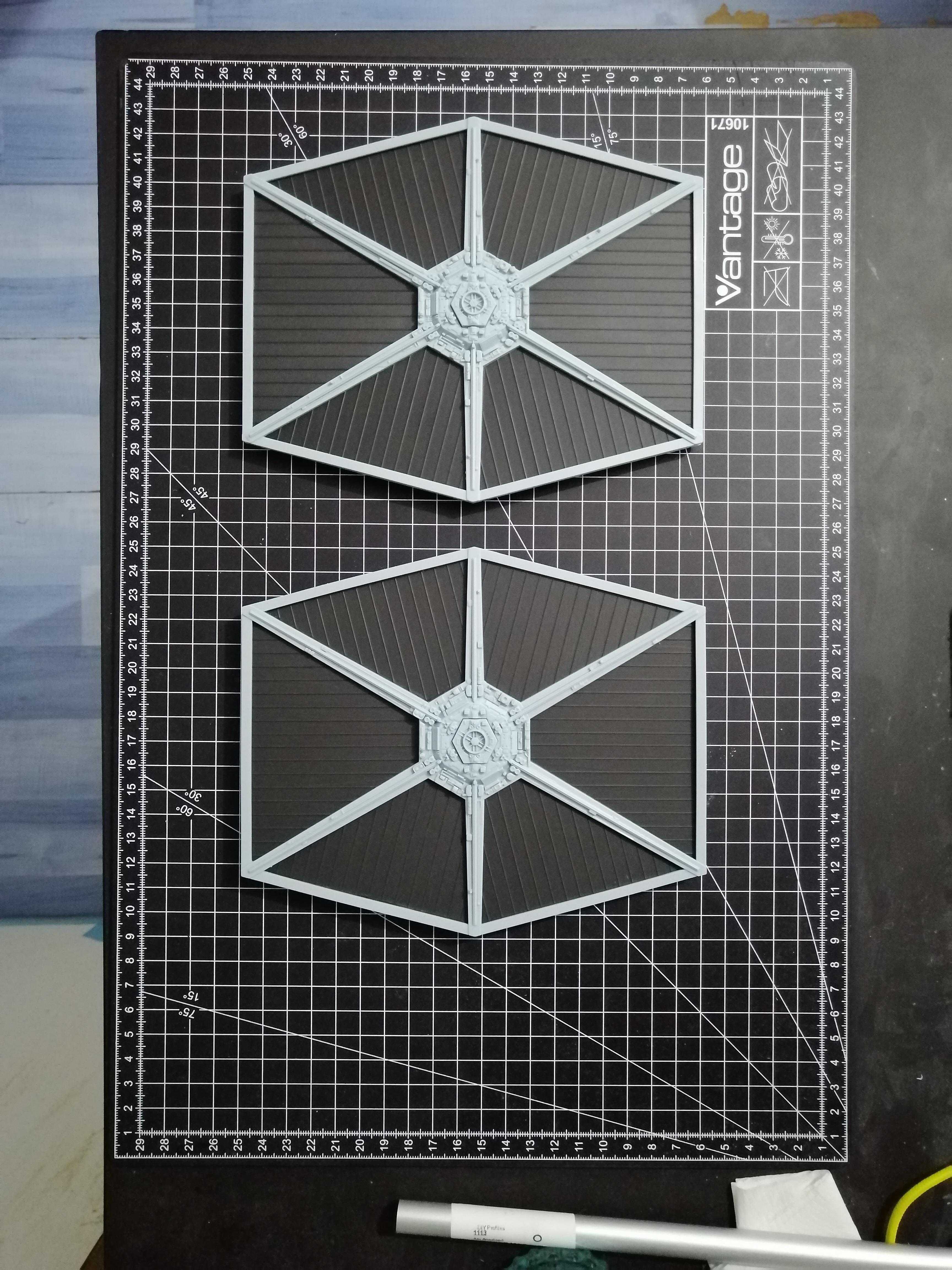

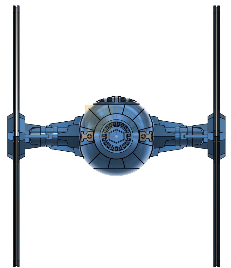

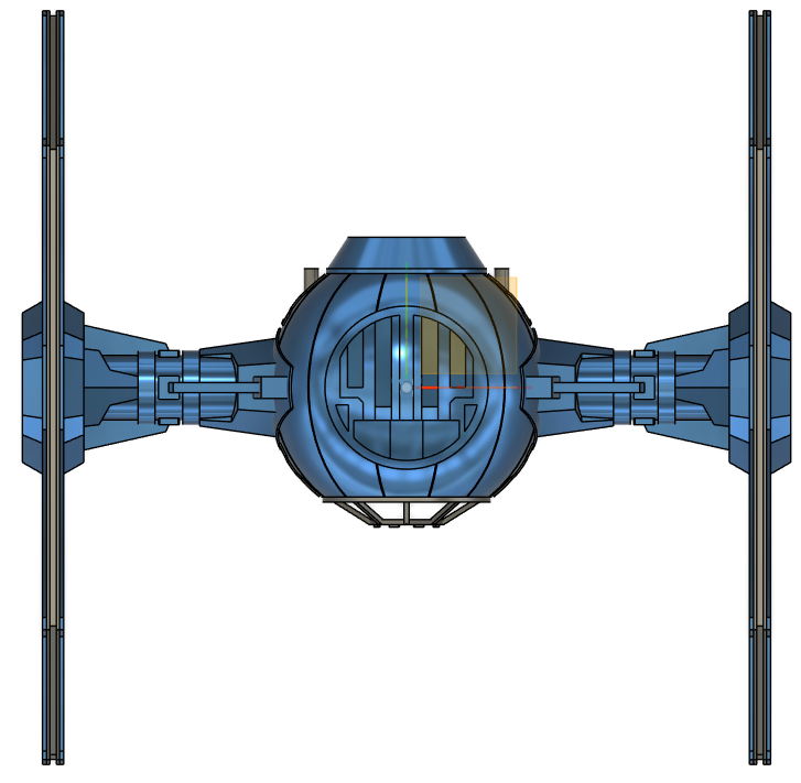

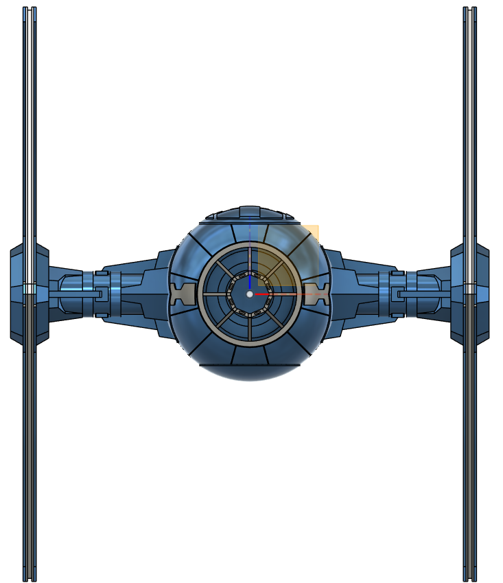

i started last week the Tie Fighter in Fusion360
still early stage, but the "main" features are there

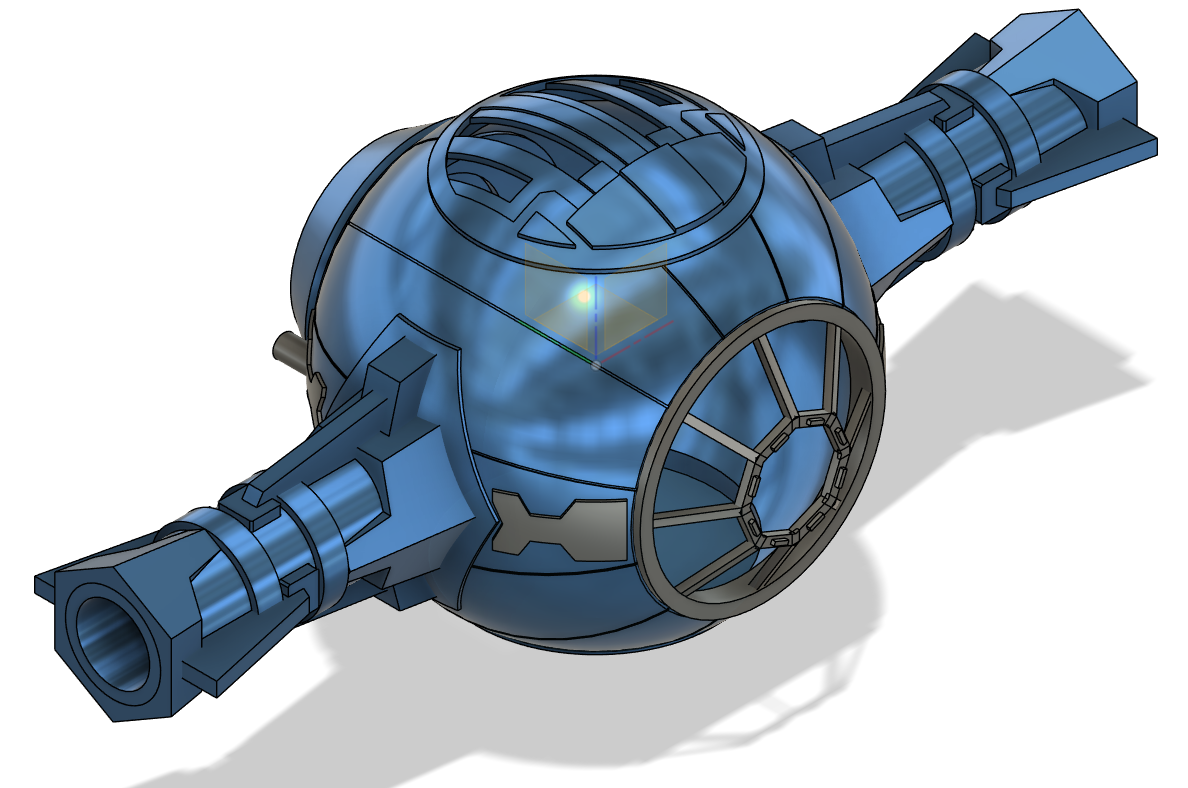

still aloooooot to do, but today i anoyed my self with six hours of fusion360 to get the bottom plate right
its missing the t stripes, some smaller details here and there and the sheridan coupola to close the mounting hole, when not useing it

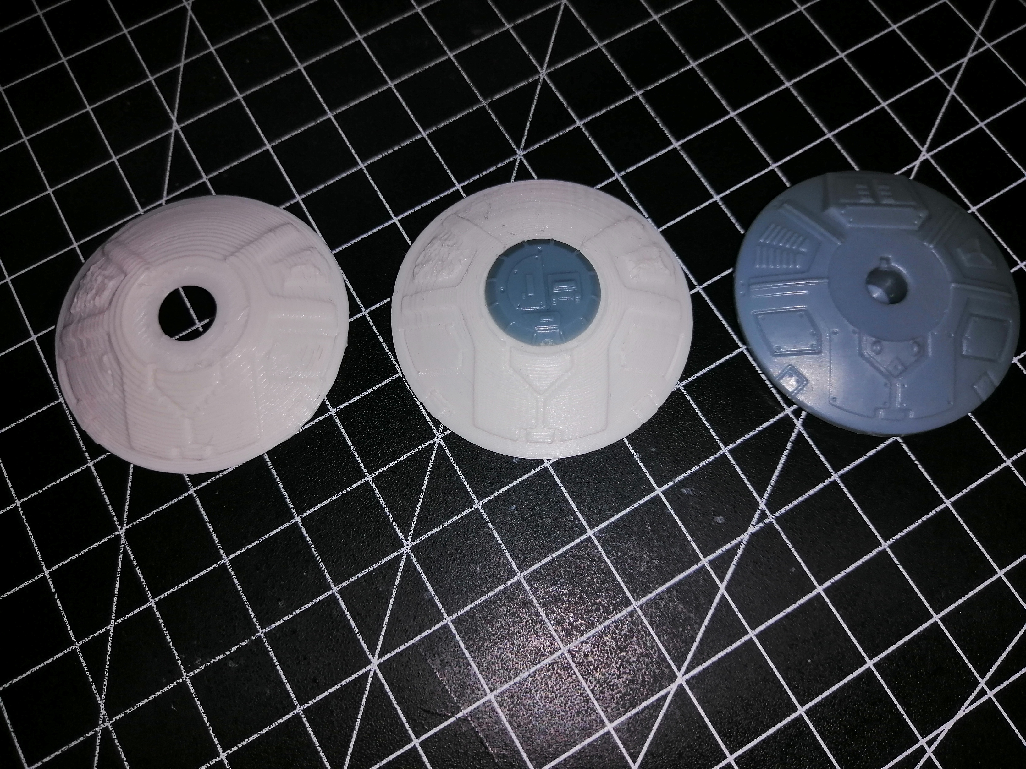

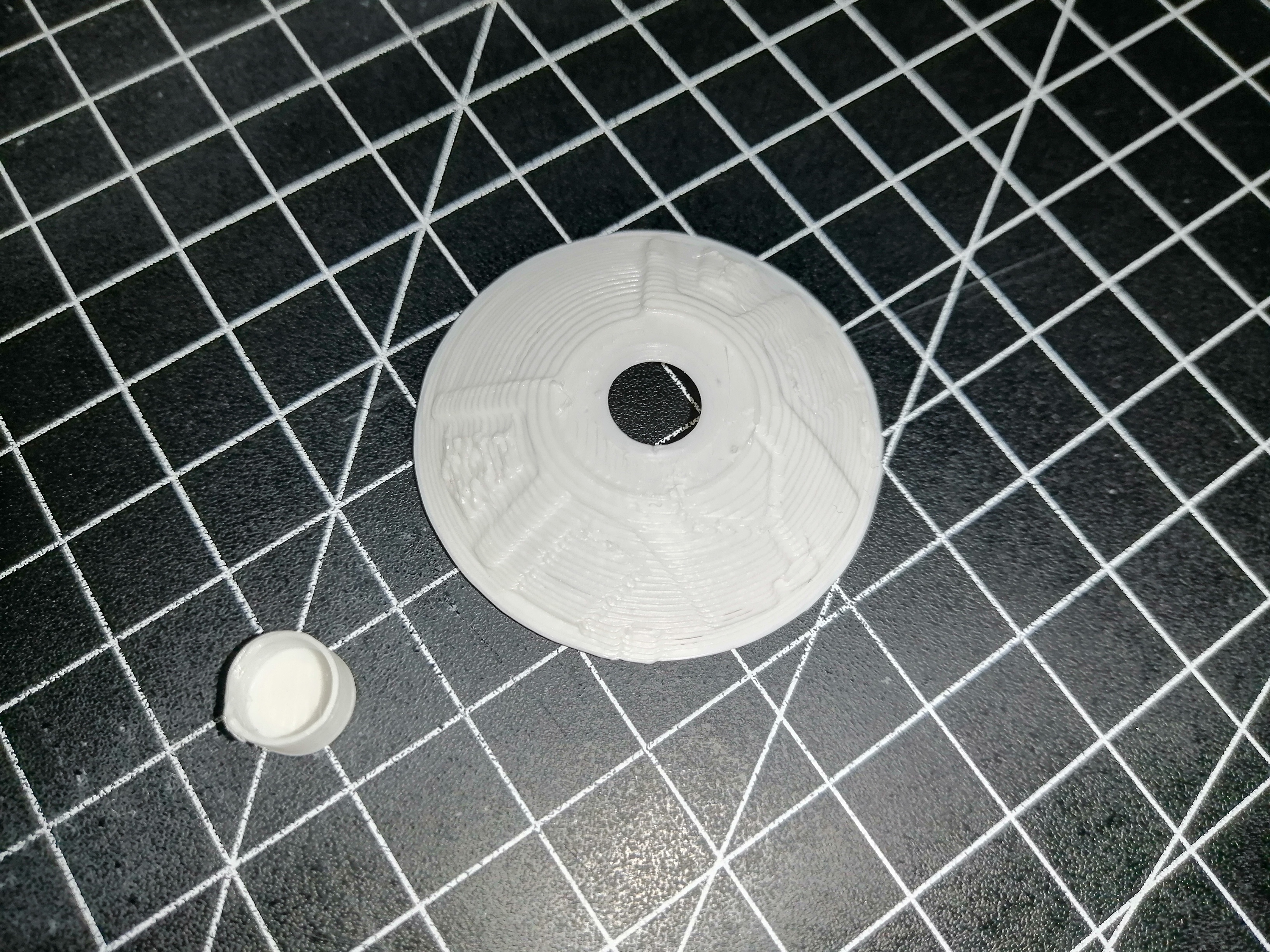

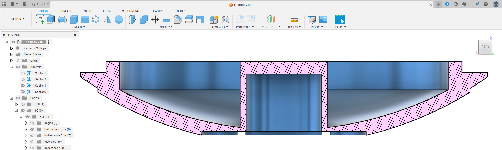

when 3d printing the bottom cap, the middle thing where the post will be sitting, when finished, broke off
so i had to check the file, whats wrong

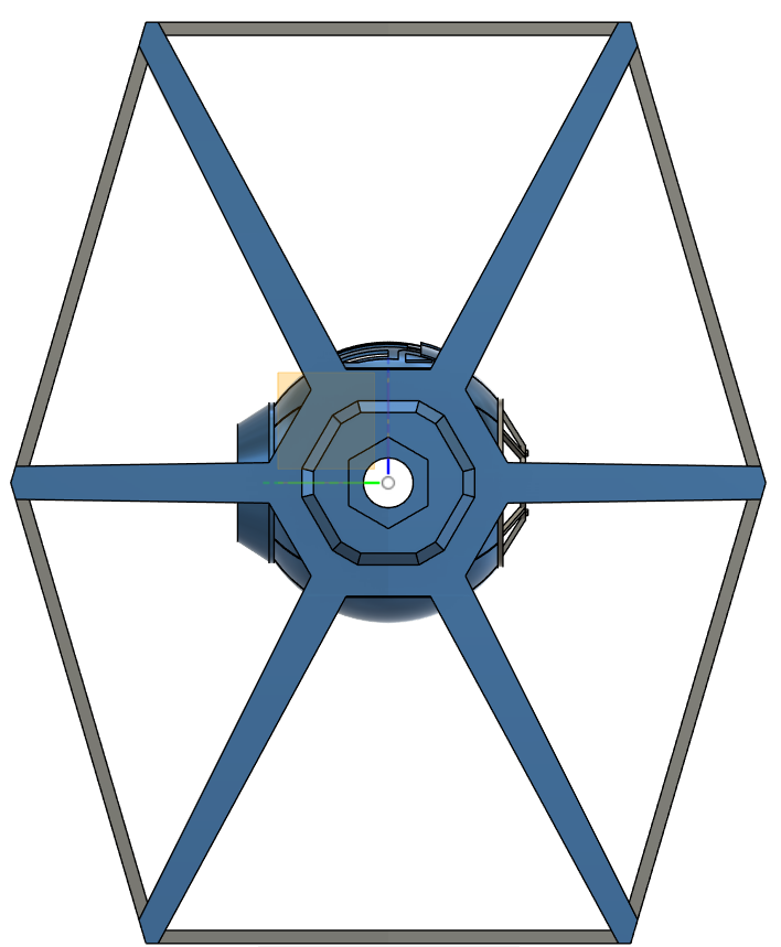

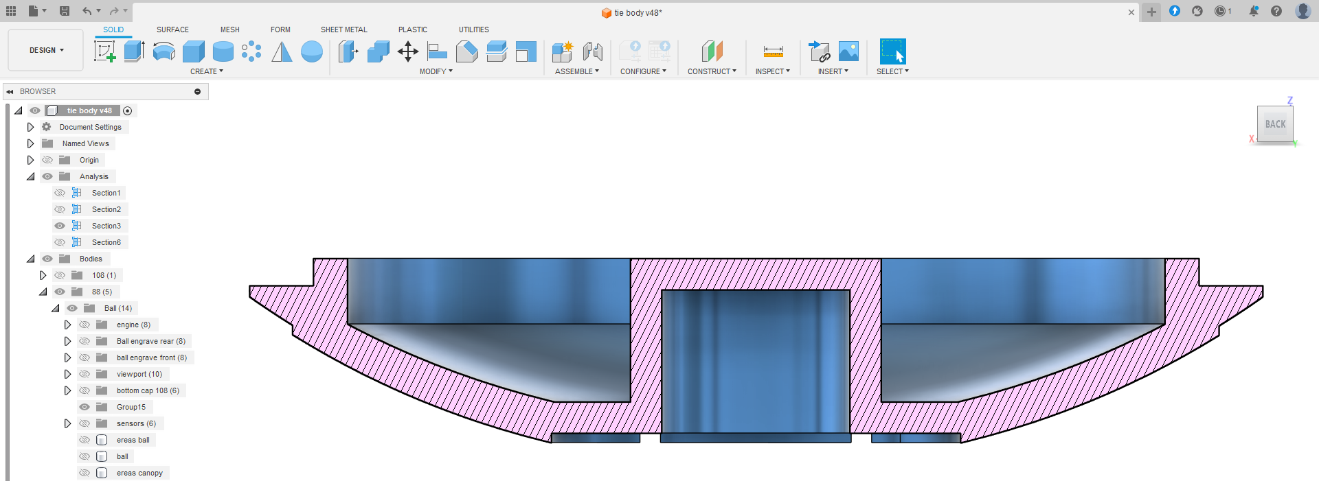

one usefull feature of fusion360, under inspect -> section analysis, u can then chose a workplane
the area is very thin, under 1 mm
so i increased it
and printed again
