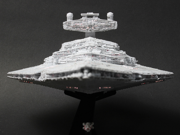

Just a heads up: watch out for warping of the main hull. When I did a test fit of the top and bottom hull pieces with the sidewalls there was an obvious upward bow to the front third of the ship. I had to shave the alignment tabs off the front half of the hull pieces and glue and clamp to get it straight. Might just be my particular kit, but be carefull.

I actually saw a couple builds in Japan that showcase that exact problem and I am worried about it.
They're not warped, they're just happy to see you. :p
On a serious note, I wonder if that is why the started putting some of the First Edition hulls on cardboad? Mine did not have that luxury.
Was wondering that too. Unboxing videos have the limited with cardboard, while mine is packed like the standard.
View attachment 1056384View attachment 1056385
I saw that build video as well. I though maybe it was a fluke, or that maybe it was caused by not having everything snapped together correctly, but sounds like it is a more widespread issue
I had this kind of warping issues with my Tie Striker and Resistance X-Wing, too. Nothing new with Bandai, sadly.
Happens when the styrene is too thin and long.
Here is the solution: Make bigger kits, 1/48 not 1/72, 1/2500 not 1/5000!
Oof. That warped bow shot of the ISD makes me physically ill looking at it. Misallignments and wonky proportions are a big deal to me. I can build a perfect Enterprise, but if the nacelles droop even slightly I want to chuck it in the garbage. Glad this was pointed out. Totally fixable, but had I missed it...
But I thought they were warp engines?
Well, we can just tell ourselves that the Star Destroyer is SMILING... or as edge10 offered: it is just happy to see us.
Seems to me Bandai could have added some internal ribbing inside the front sections to help keep it stable and straight
