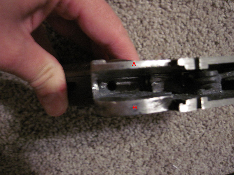

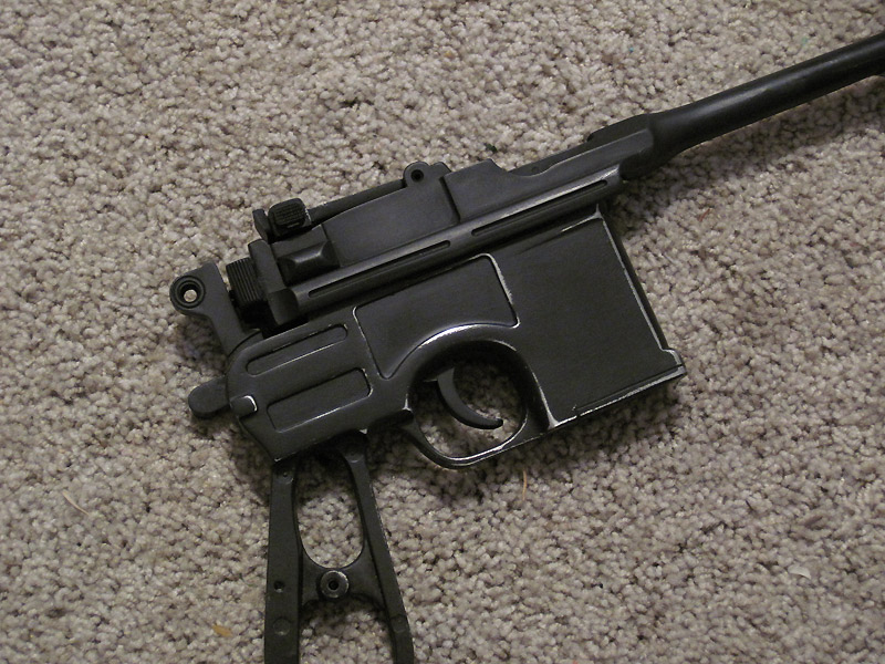

Denix can suck it! Had to get the Dremel out and grind this down. It was so loud, I had to use ear protection. Side A was as wide as side B.
Now the hammer/safety will fit. Still a ton of work to do!
Re: ANH Hero DL-44 Discussion
Wow that turned out great, nice work! :thumbsup
Considering how it's looking so far, when it's finished I bet you'd never notice that there's Denix parts on it!

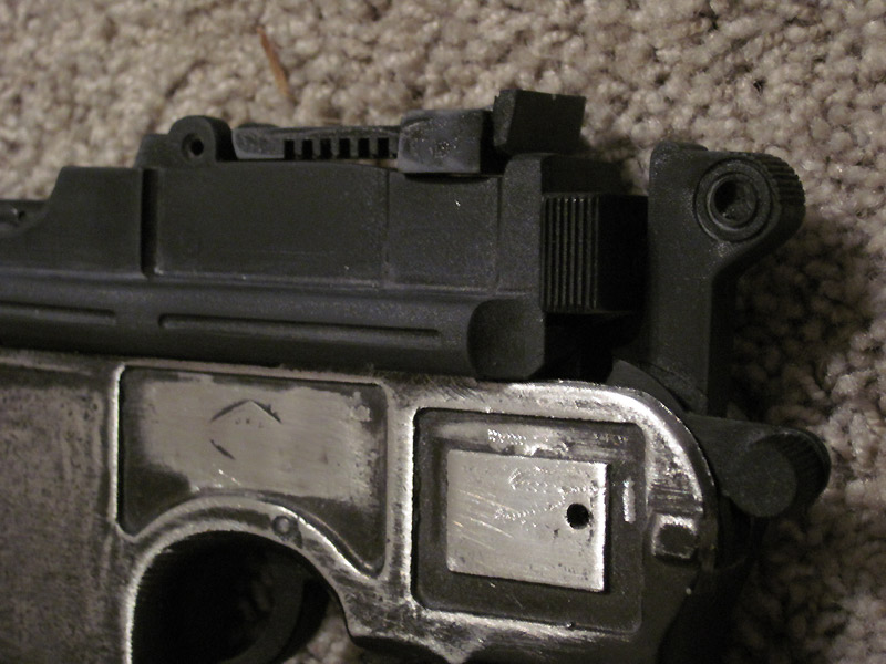

Picture of the other side. Filled the holes with solder. Lots of sanding. Dupli-Color sandable black primer is great. That's why the edges are bare. Lots of sanding and primering.

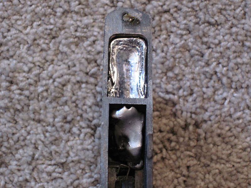

Filled it with lead to compensate for the lighter upper receiver.

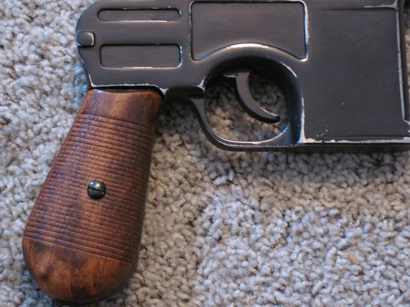

With jheilman's grips. :thumbsup Thanks. I'll darken them up some and get rid of those nasty screws eventually.
Wow, so you filled the magazine area with lead? That'll help. And glad the grips arrived safely - and quickly.
