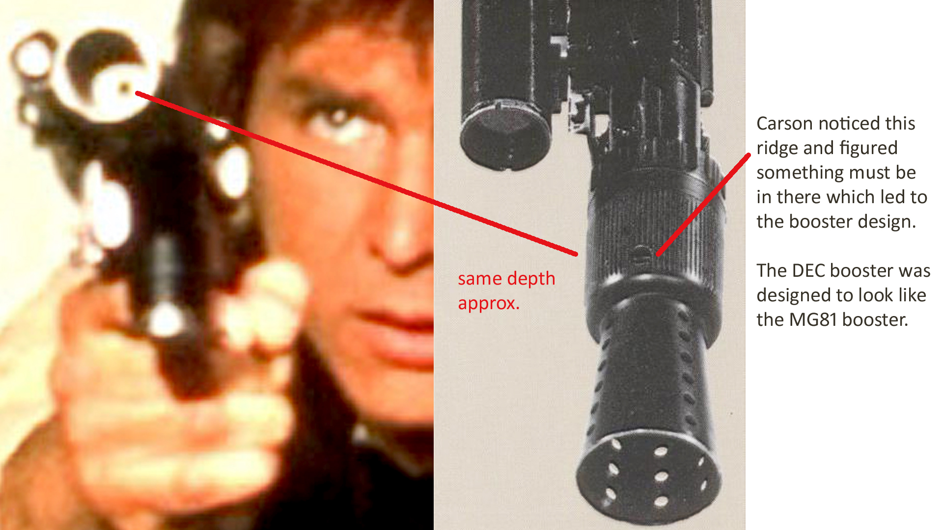

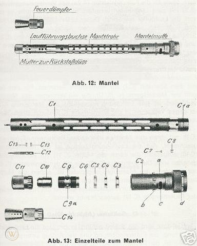

THE BOOSTER MYTH:
The “booster” concept was conceived by me and Carson to help center and secure the FH to the barrel. We designed the booster to fit over the barrel and have the FH Allen bolt secure both to the barrel.
The MG81 used a recoil booster with the HERO FH which is where we got the idea. The real booster would sit in the “tube” of the FH behind the cone and would be held there loosely as the FH was screwed on the machine gun barrel with the rear threads. I believe there was a spring in the rear to act as a spring washer lock. The bullet and line knurls are used to get a good grip to tighten the FH in place. The “Allen key bolt holes are for a spammer type wrench not for a bolt. This type of booster is used by gas operated guns to cycle the action.
There is no evidence that the HERO prop used or needed a booster. The c96 is not a gas operated system. The hero used a small bore barrel constrictor to generate back pressure for the blanks. It is possible Carl made a constrictor cone similar to the booster and our design but it did not apparently center the FH on the barrel.
IF the HERO had the original booster cone in the FH it did not center the FH on the barrel because the c96 barrel was a smaller diameter.
If you note the hero images where the FH is tipped up, this is because the FH was simply tightened to the barrel with the Allen bolt and the FH would “pivot” and tip at that point. The FH sat crooked most of the time.
Todd and FM copied the design and the rest as they say is history.

Perhaps I misspoke; by "booster" I meant the constrictor on the bull barrel which generated the sufficient back pressure. Given how the bull barrel was threaded to accept a rifle barrel, I more or less supposed the idea that the constrictor was made to thread into the bull barrel, which in turn was how the flash hider was mounted (and why it seems to be more or less centered in the pre production images). Certainly later on the flash hider was quite crooked though (probably from all the time Ford dropped the thing), so I wouldn't be surprised if it was stuffed with tape and bubble gun to keep the thing on.

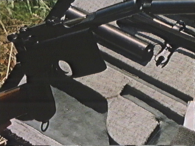

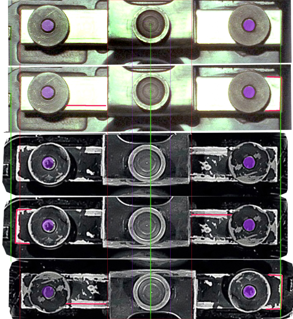

Note the crossbar flip. The front edge in the pre is slightly angled on the top surface by sloppy file work.
The crossbar slides to the rear in the post image. The crossbar holes were likely enlarged to allow a bit of adjustment accounting for some discrepancies in scope angle in some images.
Note the gouge consistent from Carl to post.
Good catch and never saw it mentioned before. I just noticed this recently and mentioned it to lonepigeon. We will never know, but I always question 'why' i.e. was it intentional or just a screw up during reassembly after painting the crossbar. Knowing how things happen during the production, my default is always the latter.

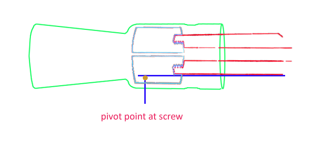

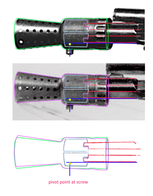

Could be. But threading something on the end of a barrel "could" be dangerous. Could have been a welded plug with a small diameter bore hole ?
The angles of the FH tilt coincide with the screw being the pivot point which extended a bit further into the FH than your sketch but not far enough ( if the bull barrel was the same as the NR barrel) to reach the screw. It needed something to hold the FH on the barrel and keep it safe and secure. Maybe Carl made a simple ring and welded it on the barrel or made a small diameter booster cone and welded it on? Just sliding it in without using the rear threading to secure it to the barrel like the MG81, the FH would fly off first shot.
Maybe a "booster" like part but not long enough to stop the tilting? However it was made it allowed the FH to rock and roll but kept it on... as far as we know.

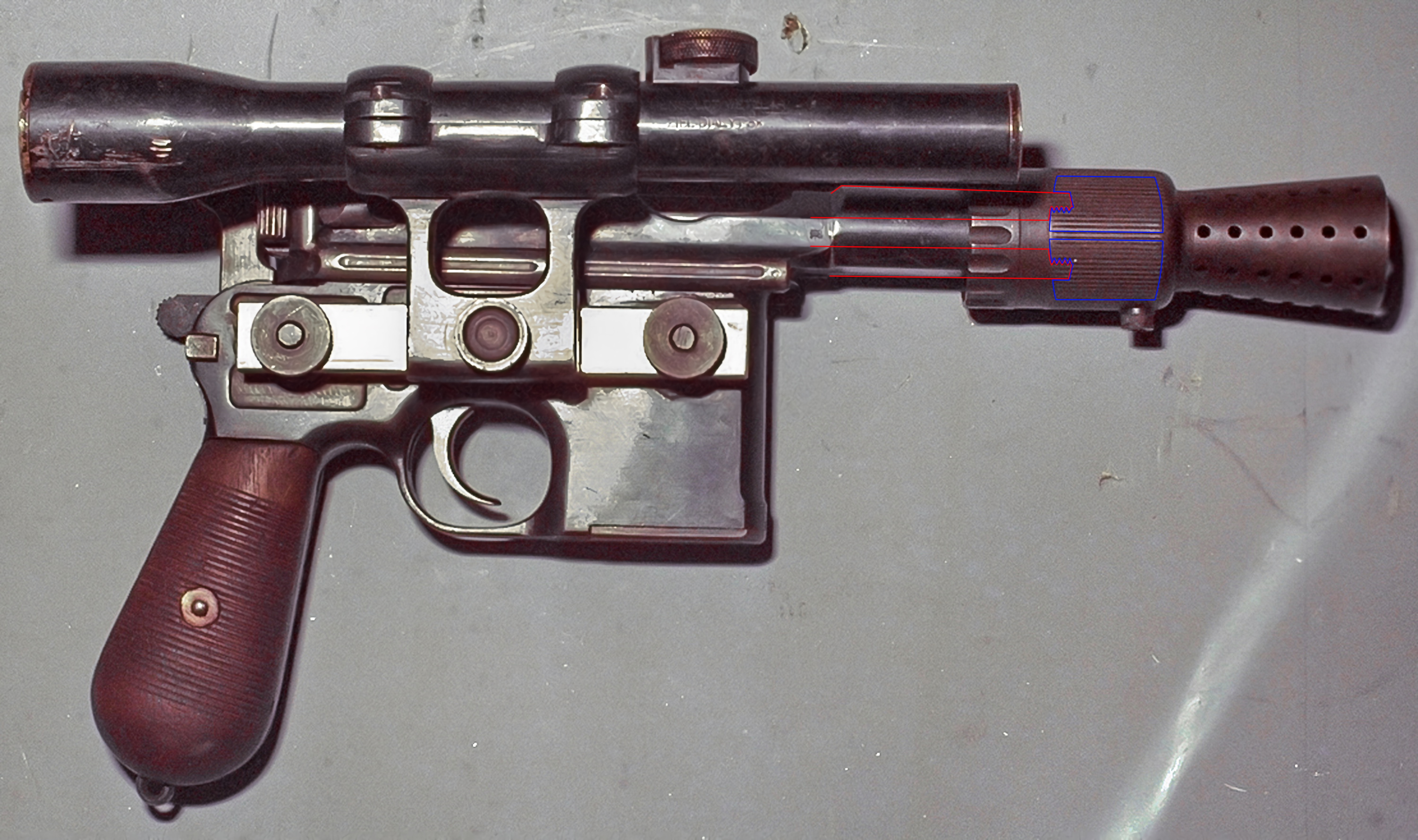

Not sure which parts you have but if you shave down the "booster" area a bit to allow some wobble it will tilt like you want.
Wouldn't take much. Just a little loose and it will tilt.
You really have to just try to remove the mount. Explains it all.

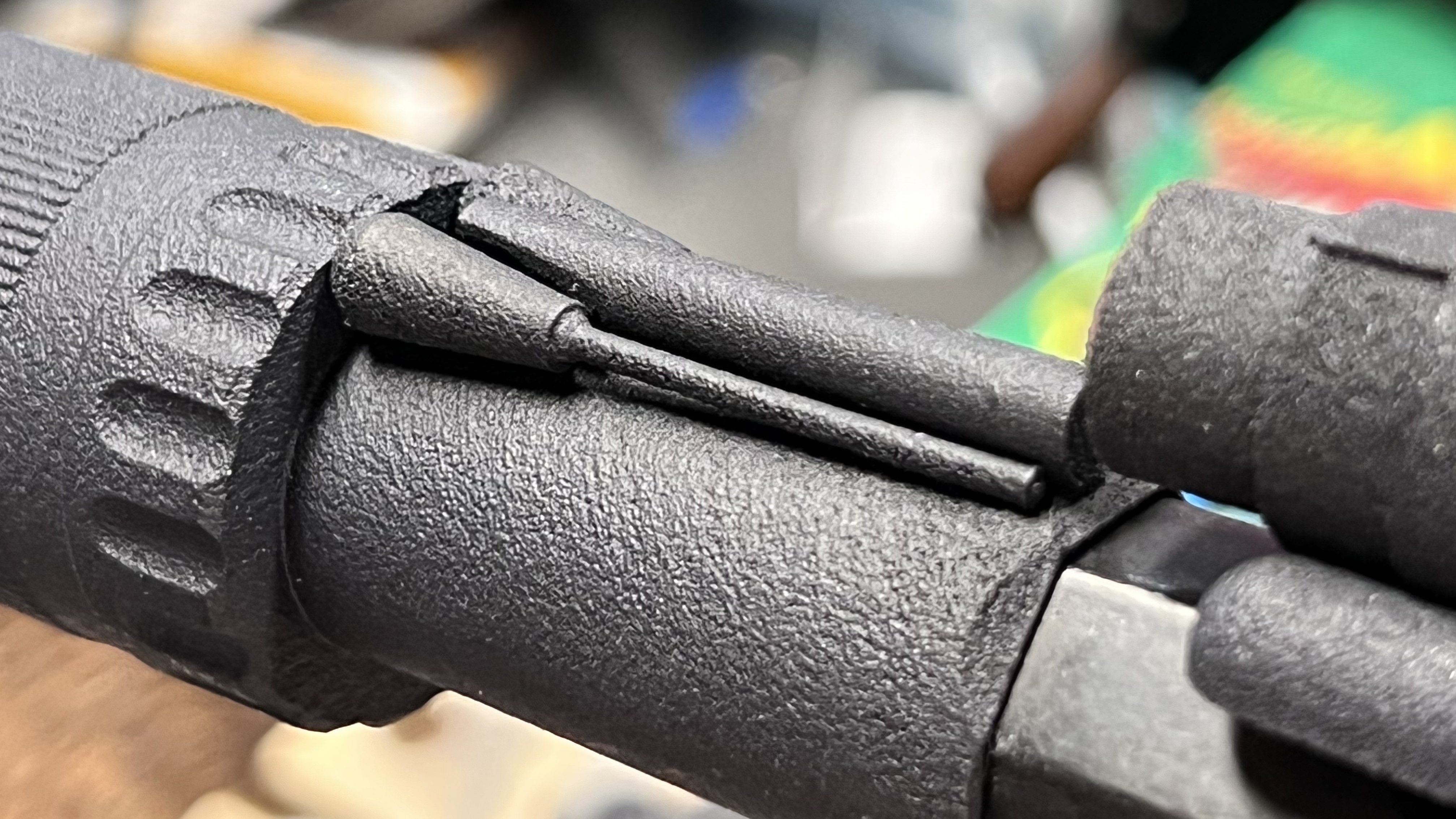

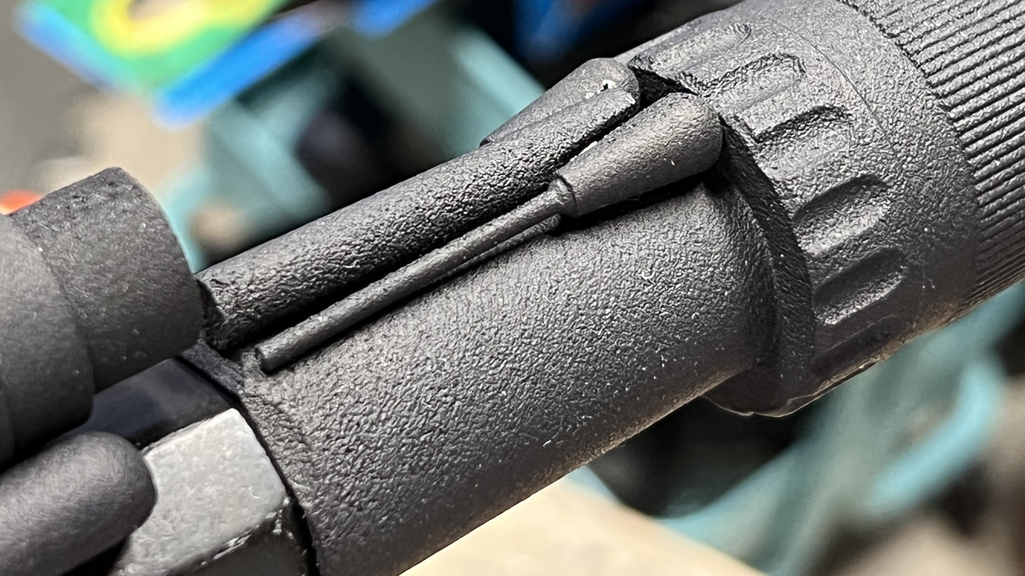

I don’t want to derail this thread to much but I mentioned a while ago about posting pics of the MS and its antenna greeblies once they arrived. Here is how they came out using info that was discussed previously and then obviously interpreted by myself..
I posted a bunch of pics here (ANH mount arrived as well) if interested..

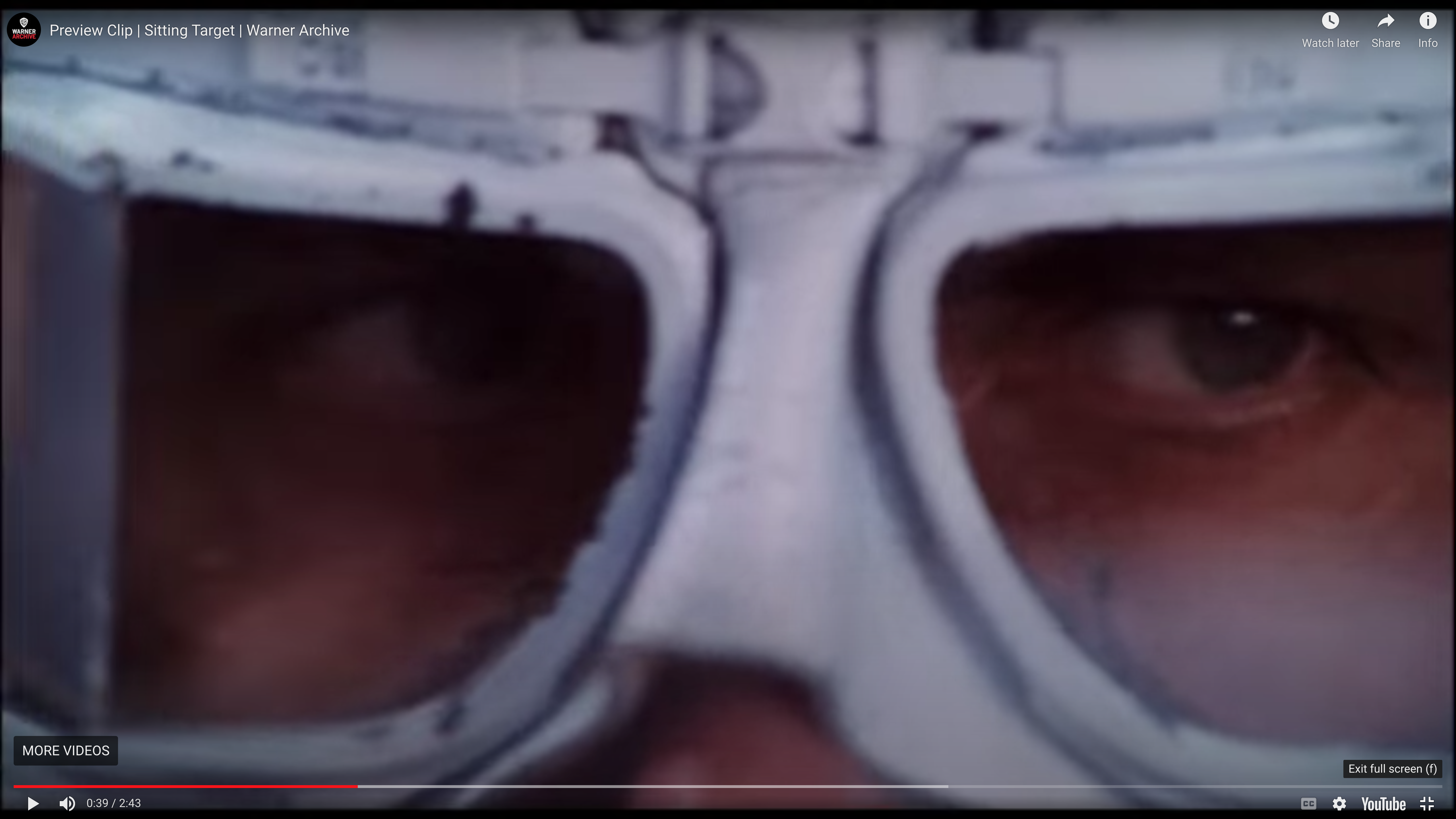

Were those model goggles used somewhere in ESB?
..I didn't notice, I haven't studied those yet haha
-Carson
Yep! Looks like they may have painted them white, but they're the same classic RAF goggles that Luke wears on Tattooine. They come in a handful of colors, but Luke's are all black.
