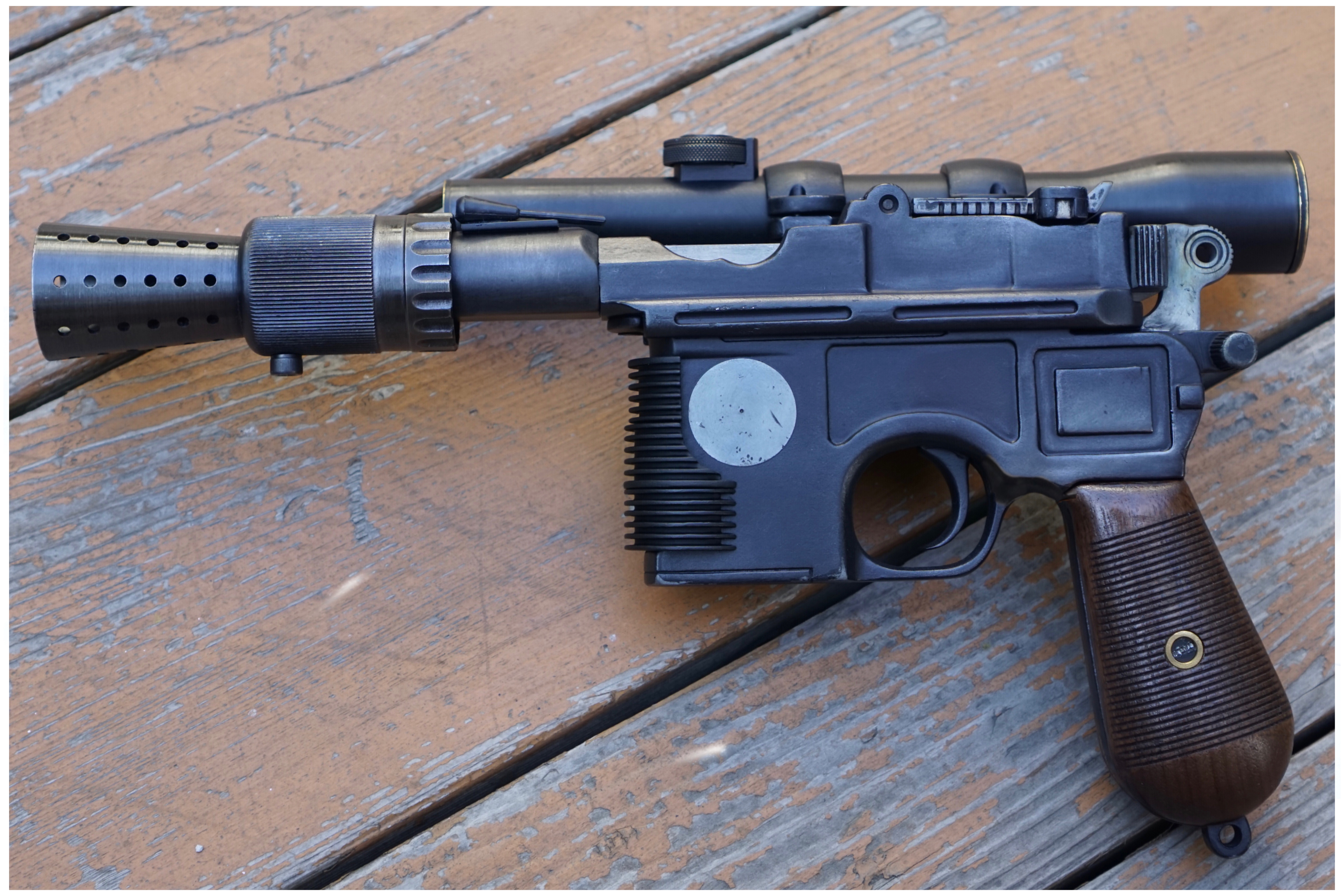

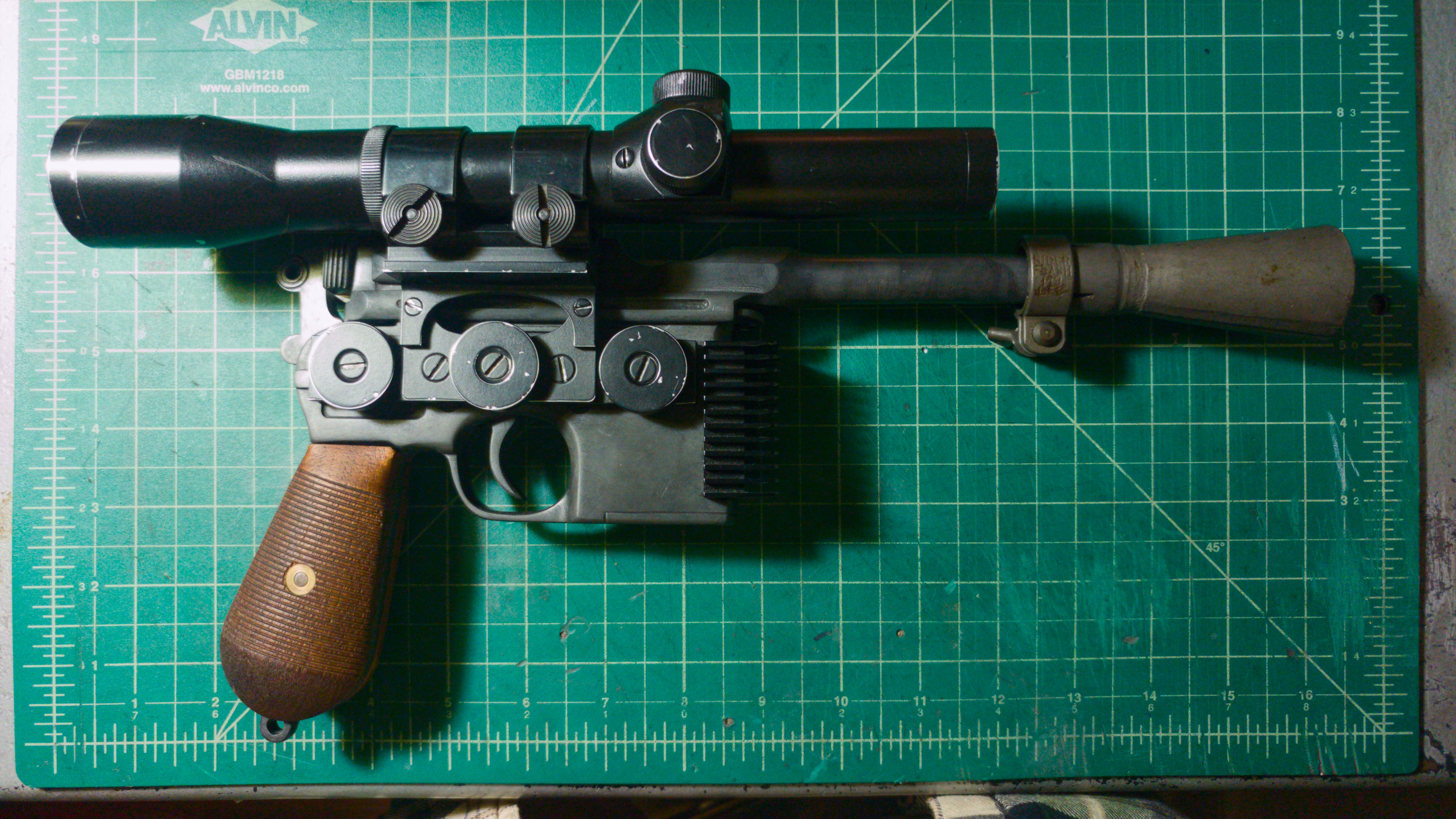

Yeah, the base Denix I bought was Field Marshall’s, with the mods he does. I took it a few steps further by reshaping the trigger, hammer, bolt, and other parts, adding the bull barrel (screw-on, not sleeve), as well as removing the screw connecting the upper and lower and filling/sanding/painting the other connecting pins after final assembly. The final product can’t be disassembled easily (JB Weld helps hold the two halves together, along with the remaining pins in the body), but it looks pretty spot-on.
For what it is, the Denix is a good, cheap alternative to something like those fabulous new FM replica Mausers. About the only complaint I have with mine is the fixed slider on the sight.

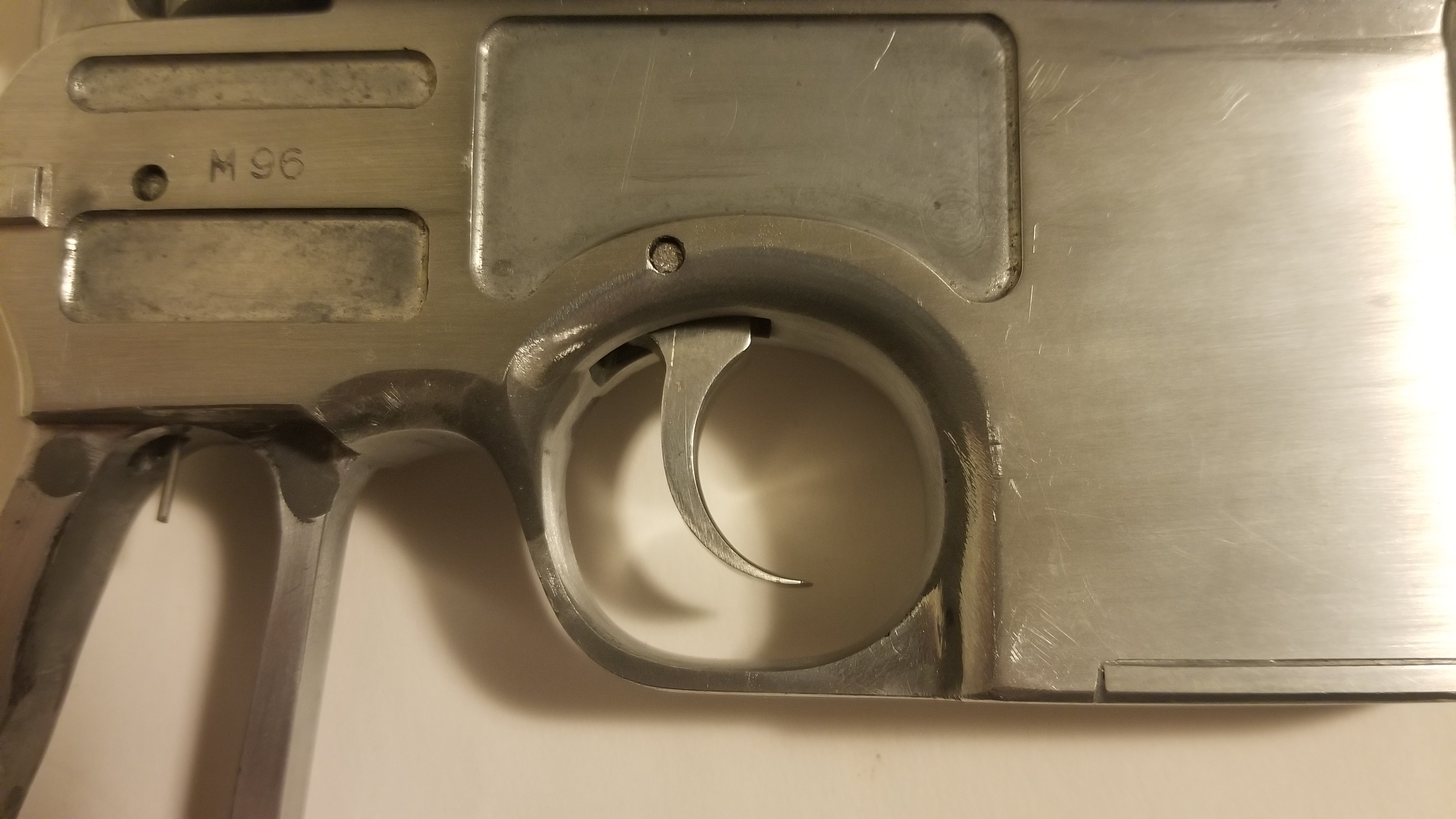

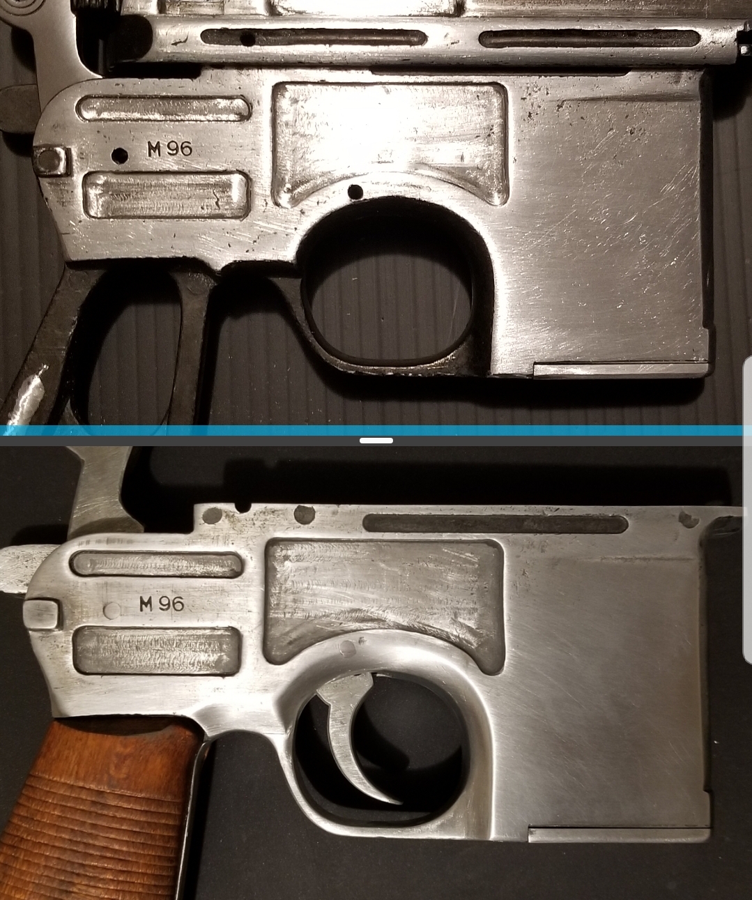

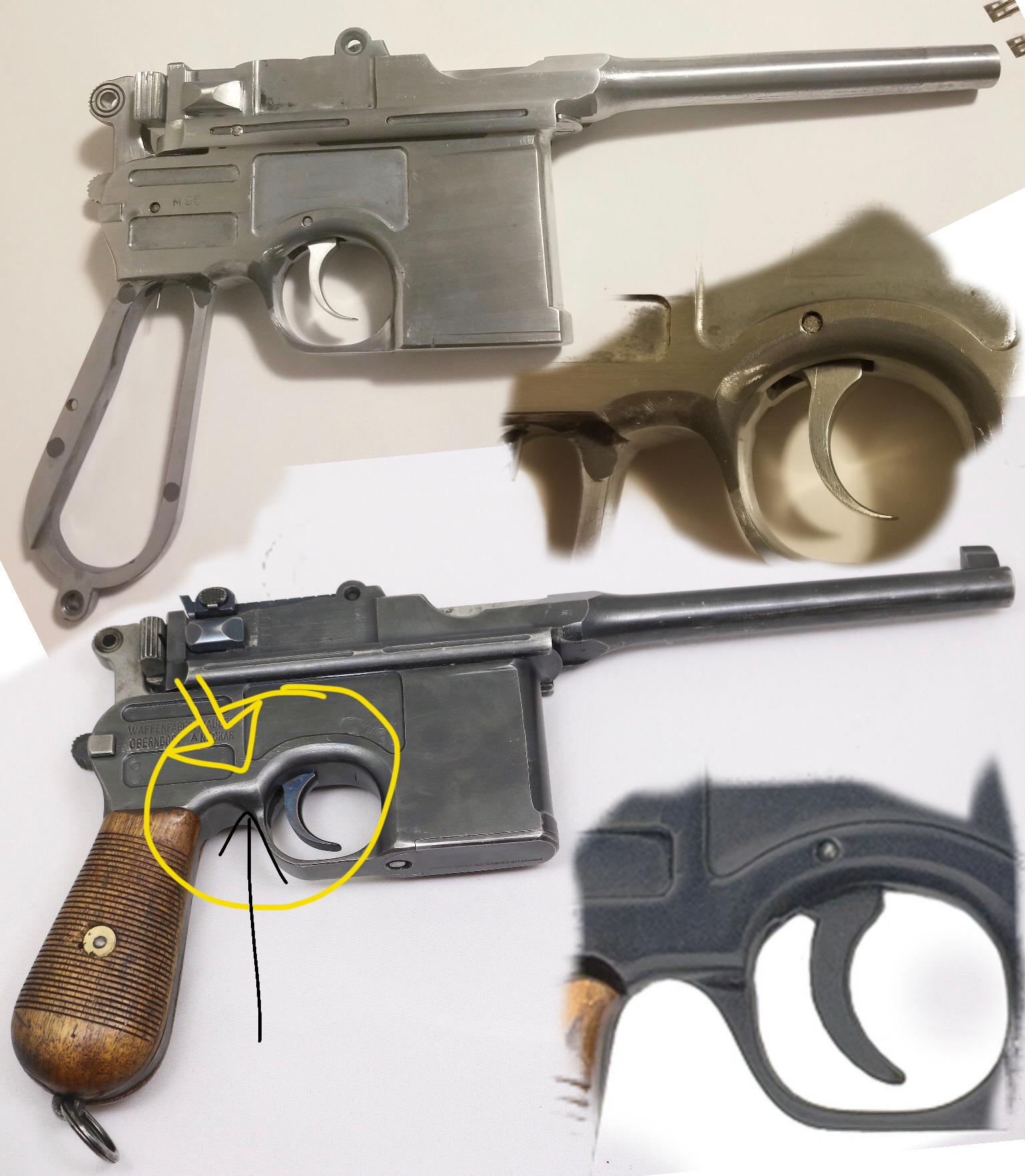

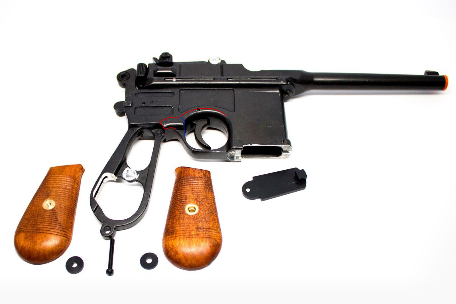

Do you mean the trigger guard blending? If so, then yeah the Denix needs correcting - on it they just shoot straight into the lower receiver without any taper. I hand filed mine using a set of needle files, although I'm sure you could do much of it using a dremel and a steady hand. More or less just go slow and follow the basic shape of a real mauser; I primarily used my MR Elite Edition for reference.
The red line indicating about where material needs to be removed/beveled (it's curved, not a flat chamfer), with the blue line showing about what the curve of the edge should be shaped like when it's done. It's tricky to get right.

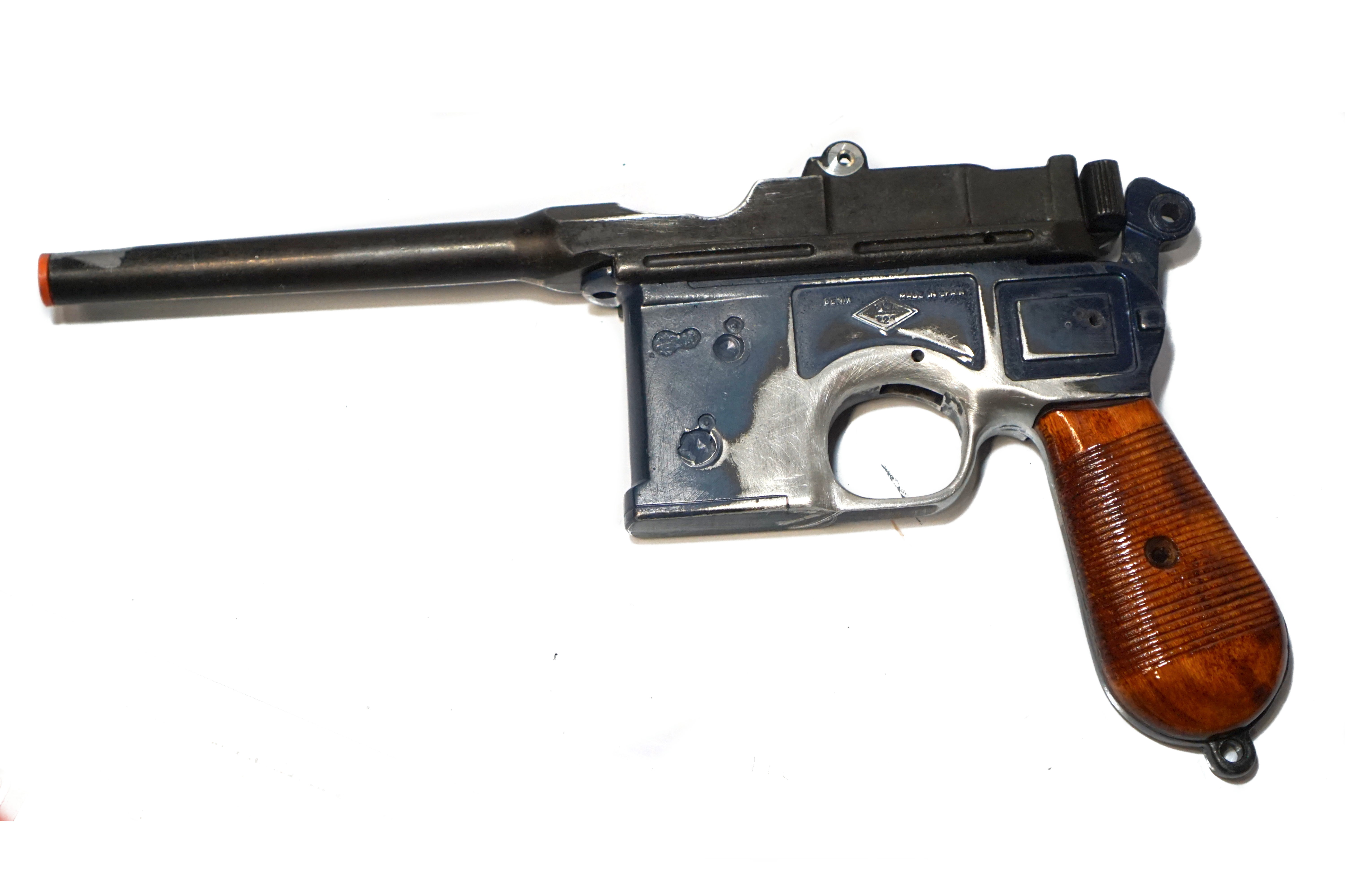

I tried this mod myself. I didn't use filler but I reshaped the whole area around trigger.
Not perfect, but makes me hate the Denix less. ;)
Ya that’s exactly what I’m looking at. I had the MR Luke bespin but it’s more shaped like an MGC than a real c96. I looked at the MR EE and it also looks more like an MGC but you’ve captured the look of a real Mauser with that mod. Definitely goin to try my hand at that! Thanks for sharing. I’ve modified pretty much every part of the denix but have overlooked that part every time. Probably cause I’ve never had a real c96 only a denix and MGC’s to draw from. I have a resin casting of a real Mauser. Goin to have to dig that one out and have a close look..

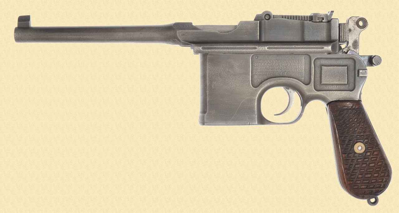

ya that looks great. Without the filler it more resembles an MGC but it’s a definite improvement for sure! Great work. Again very excited to try this one out. I’ve put all the Mausers together in this one pic to have good comparison look. Depending on the DL-44 you are going for will reflect just how much you modify it..

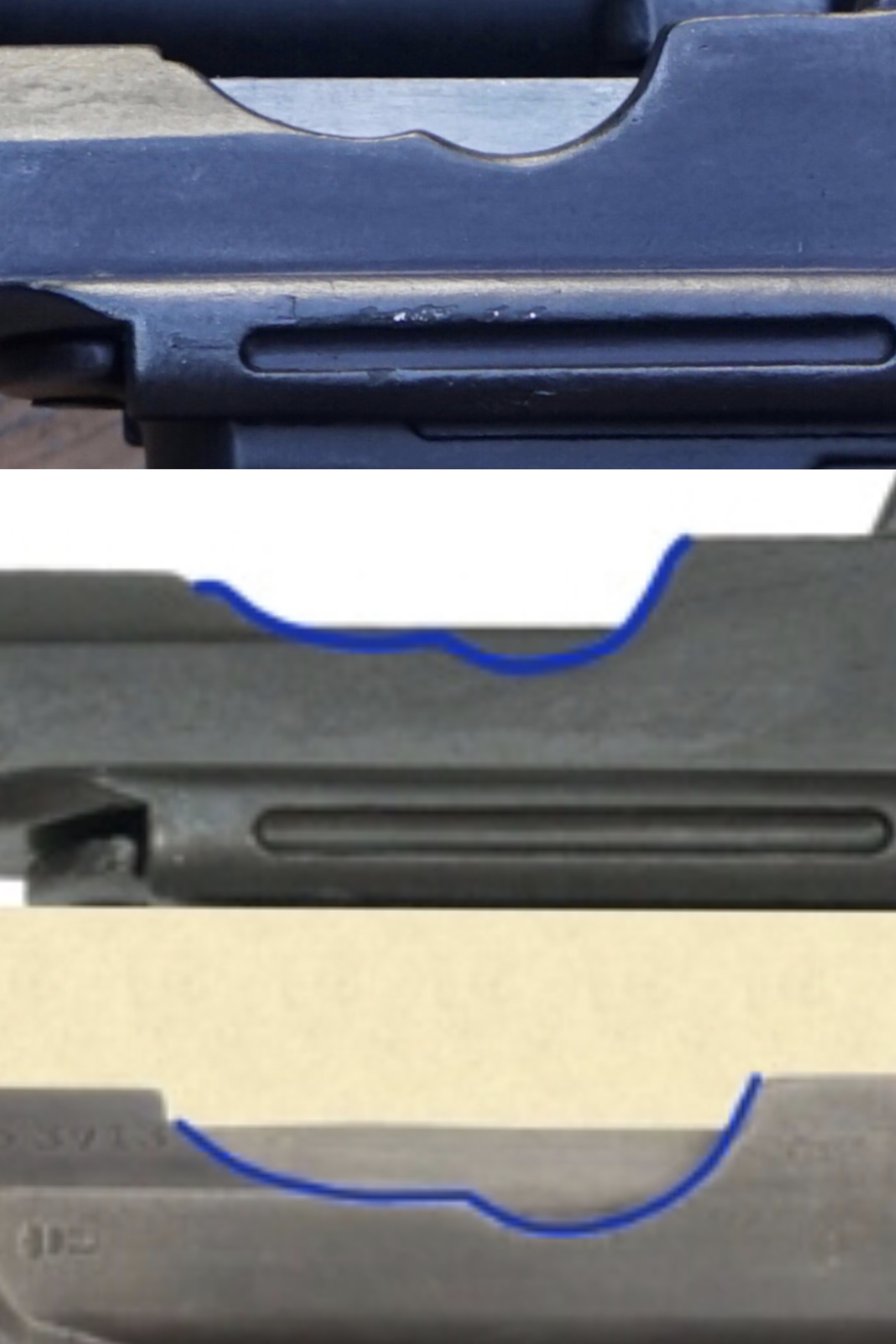

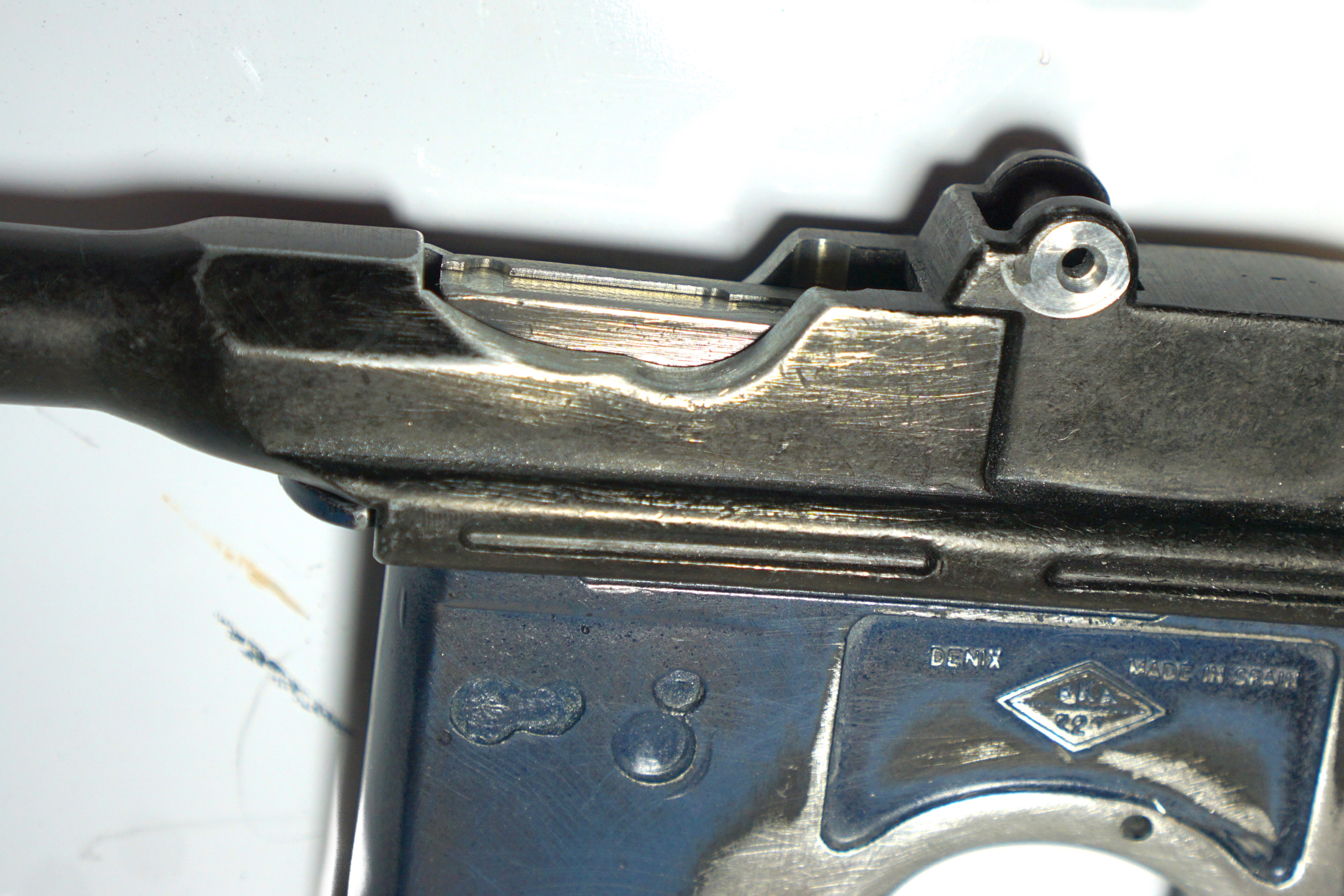

A couple other areas I cranked on pretty heavily are the ejection port scallops; with sanding drums (3/4" and 1 & 1/2") you can correct the shape of the curvatures and match them more closely to a real C-96.

Vanitas thats the old denix fyi. They have raised the slide a bit on the newer model so that’s helpful already. Messing with the scallops makes me a bit nervous as they are symmetrical to each other. Not sure if that’s worth losing to get them deeper?? A dremel and a mini mill is all I have to work with. If I could cut into it evenly I’d be even more willing to try I think :unsure:
I did the sanding drum on the scallops thing. It’s not as risky as it seems.

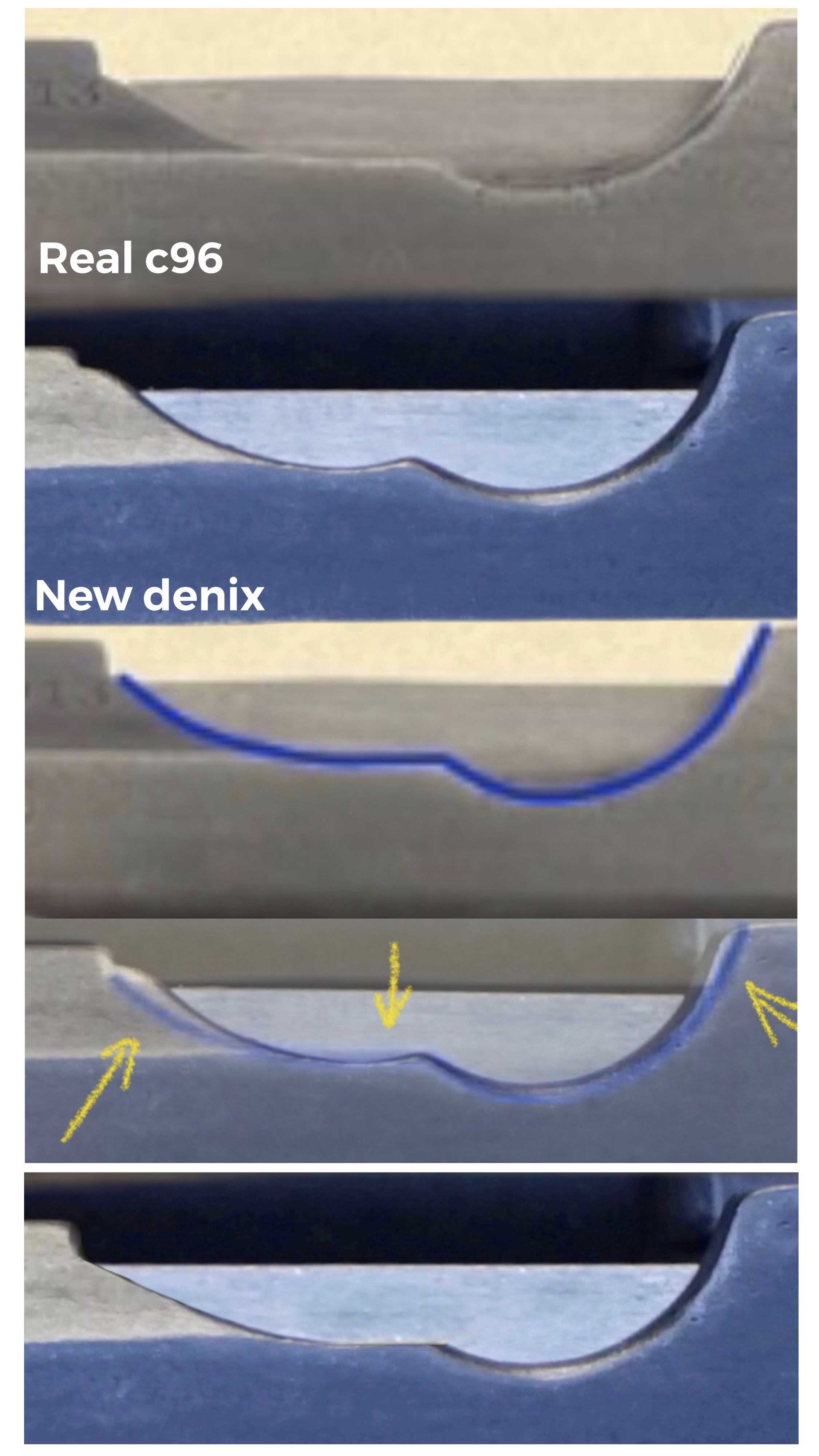

Here u can see how high the new rail actually sits. I also photoshopped in that new mod to see how it will look.
So I’ve been looking at those pics of a real Mauser compared to the new denix and I think it’s a lot less mods than realized? I think it just needs to be flattened in the middle and shaved away on each side. You might even be able to get away with just the one middle mod? I did an overlay and you can see the lines you drew are not that far off the denix itself. You can also see the rail on the new denix lines up as well..

Yeah, most of the material there isnt too far off from the actual thing, but the shape still needs to be refined a good deal. I think it was the 1 & 1/2" drum for the front scallop, and a 3/4" drum sander for the back.

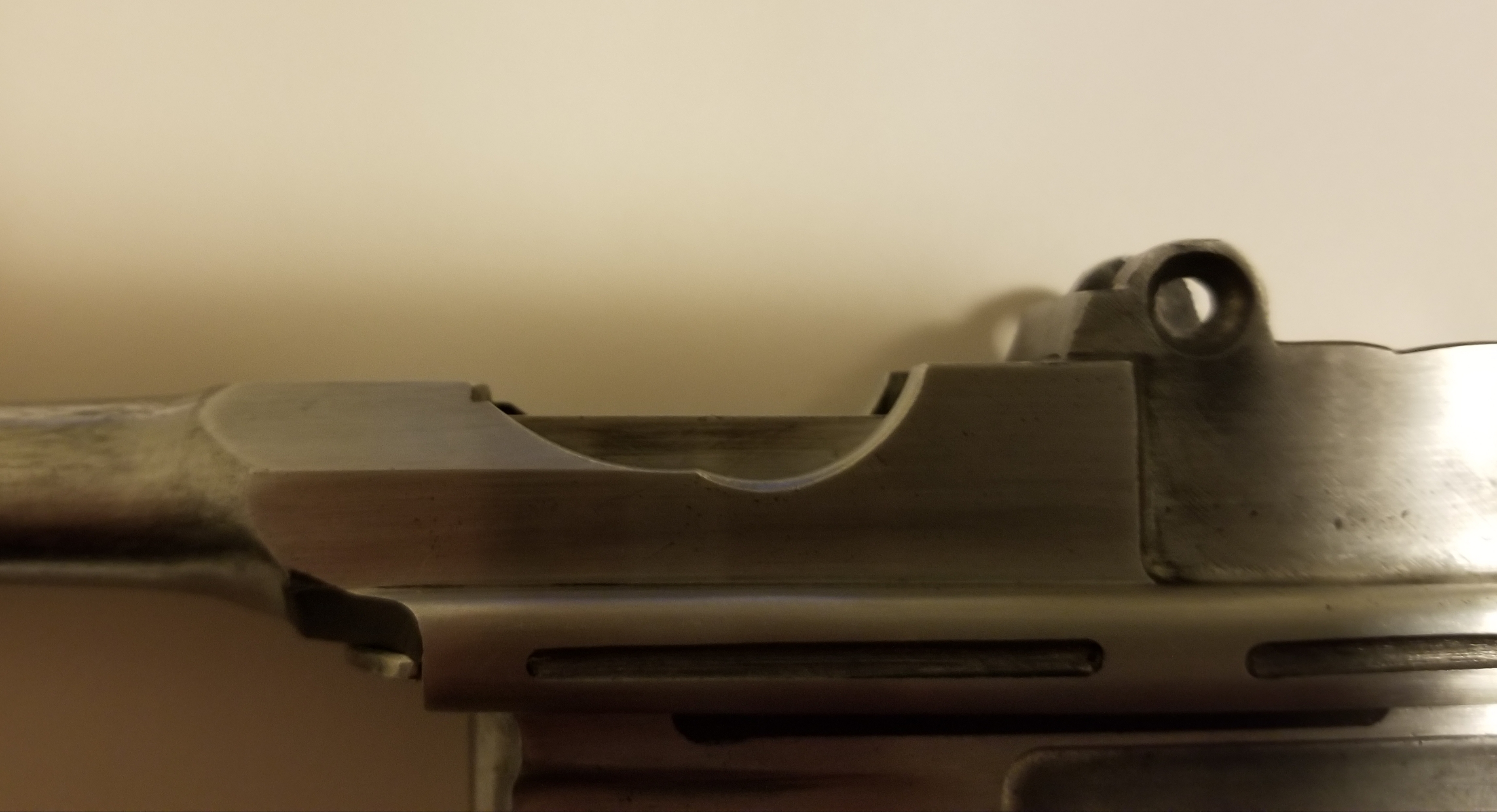

Here's a quick picture of how mine turned out, for reference.
I appreciate you pointing that out. Just got a new denix in and I’m going to take a good look and compare it to the c96 casting I have as well. It’s always fun to discover new ways to improve the base (y)
Just be careful! Taking material off is easy, adding it back on not so much. Practice on a scrapper Denix lower first; I learned that the hard way. Also; this area isn't flat but has a distinct curve to it, so don't just make it a flat bevel.
