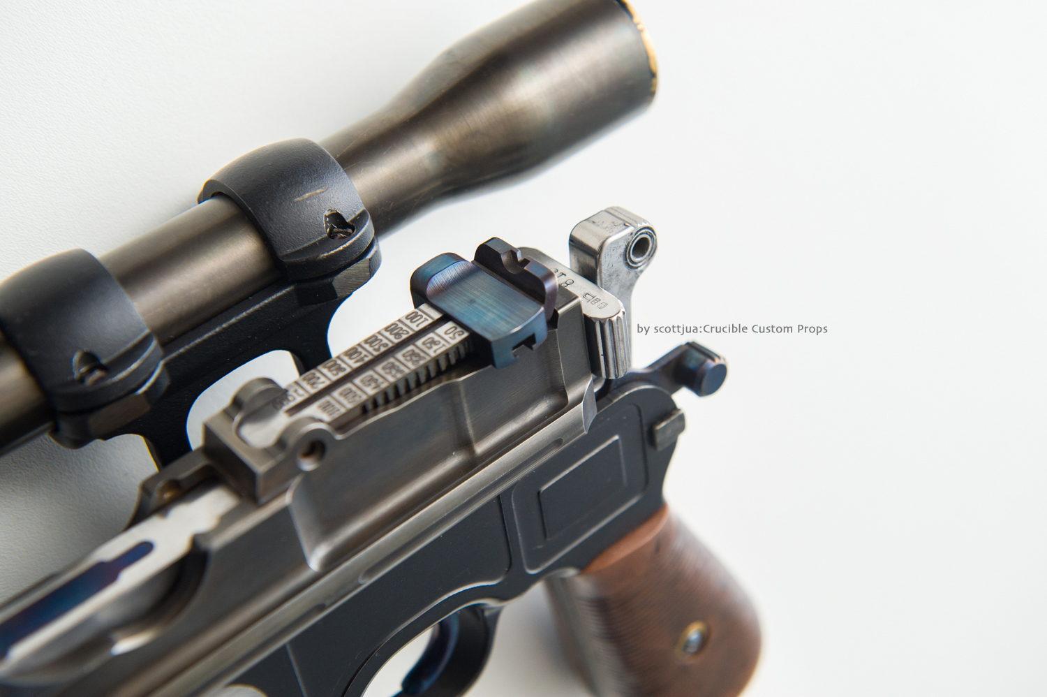

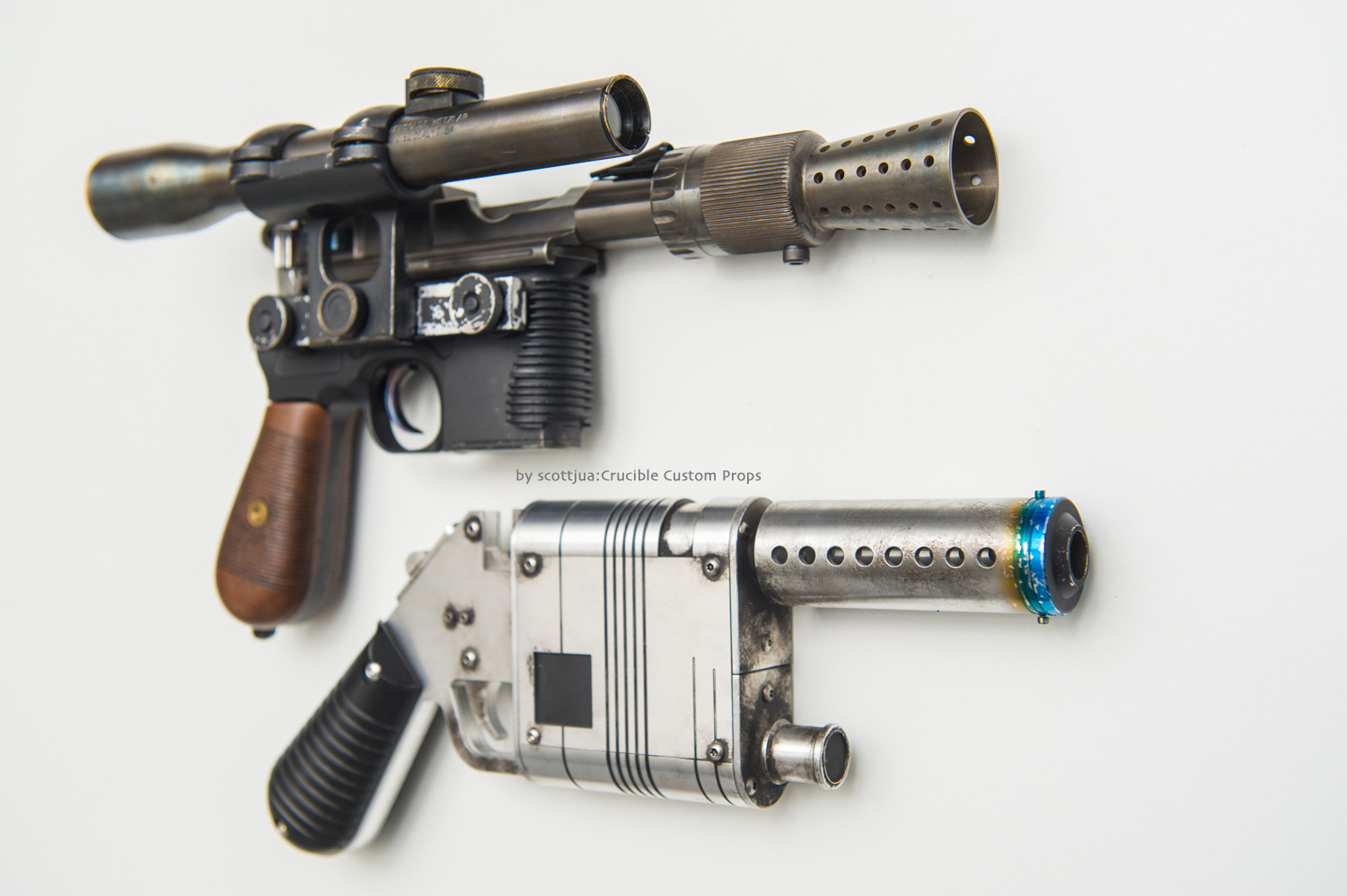

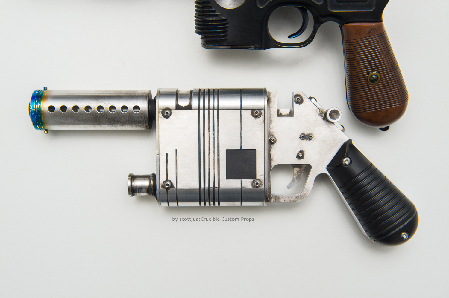

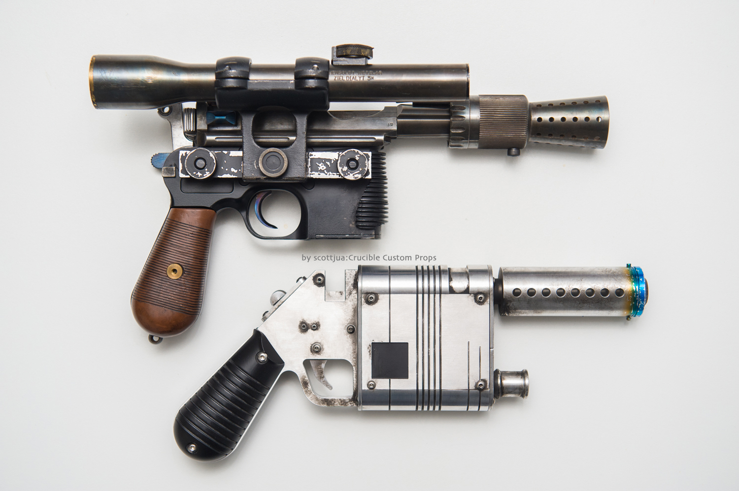

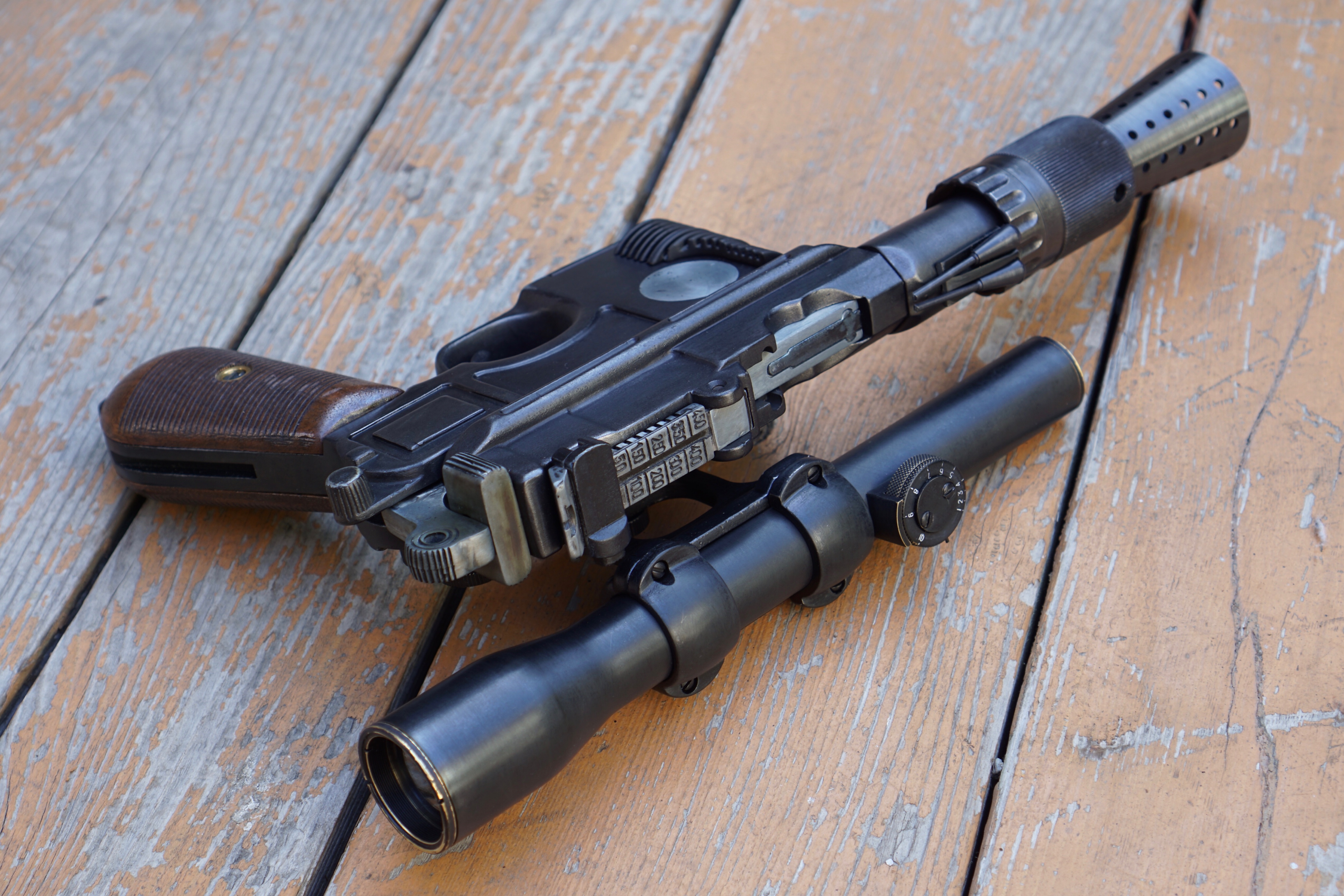

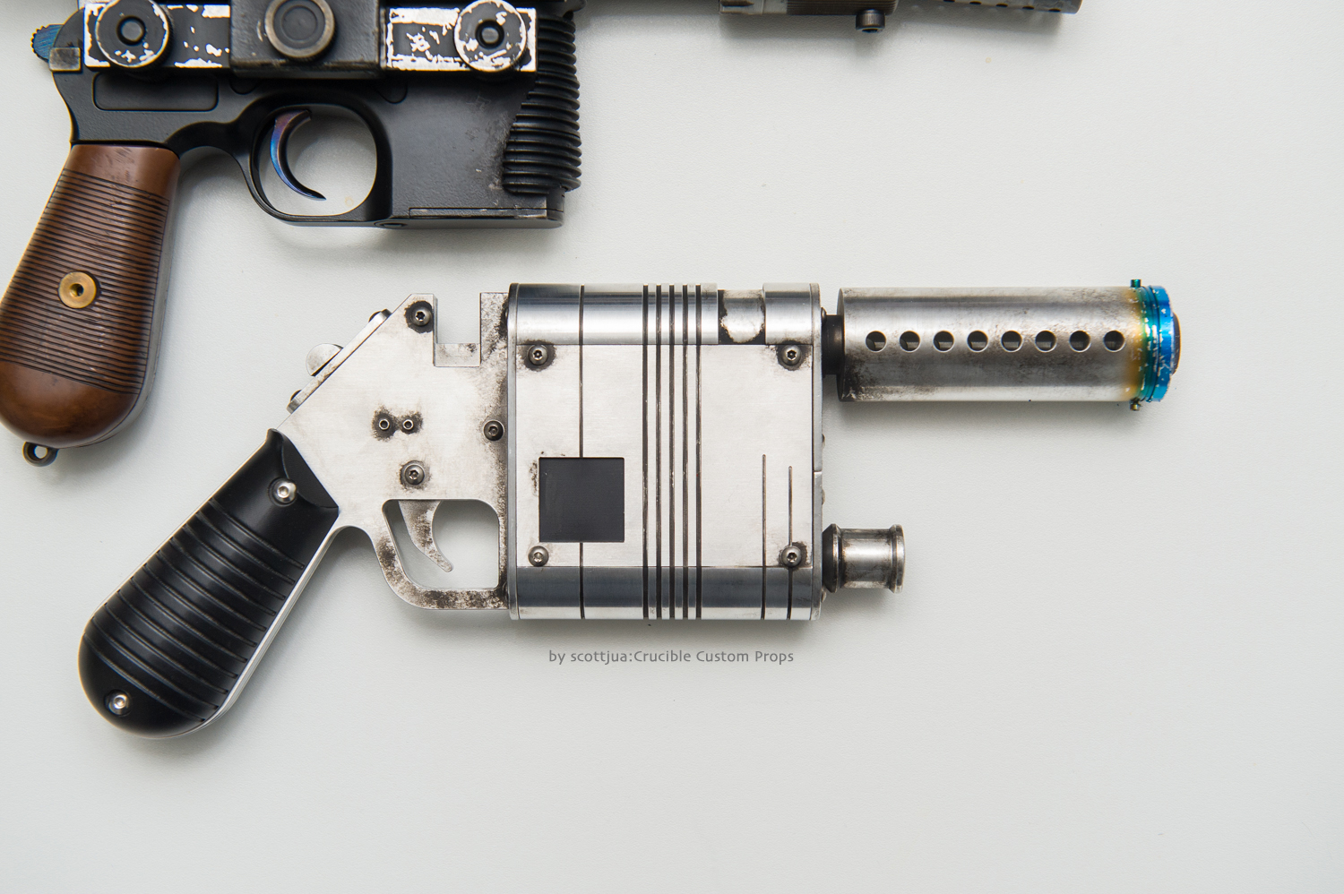

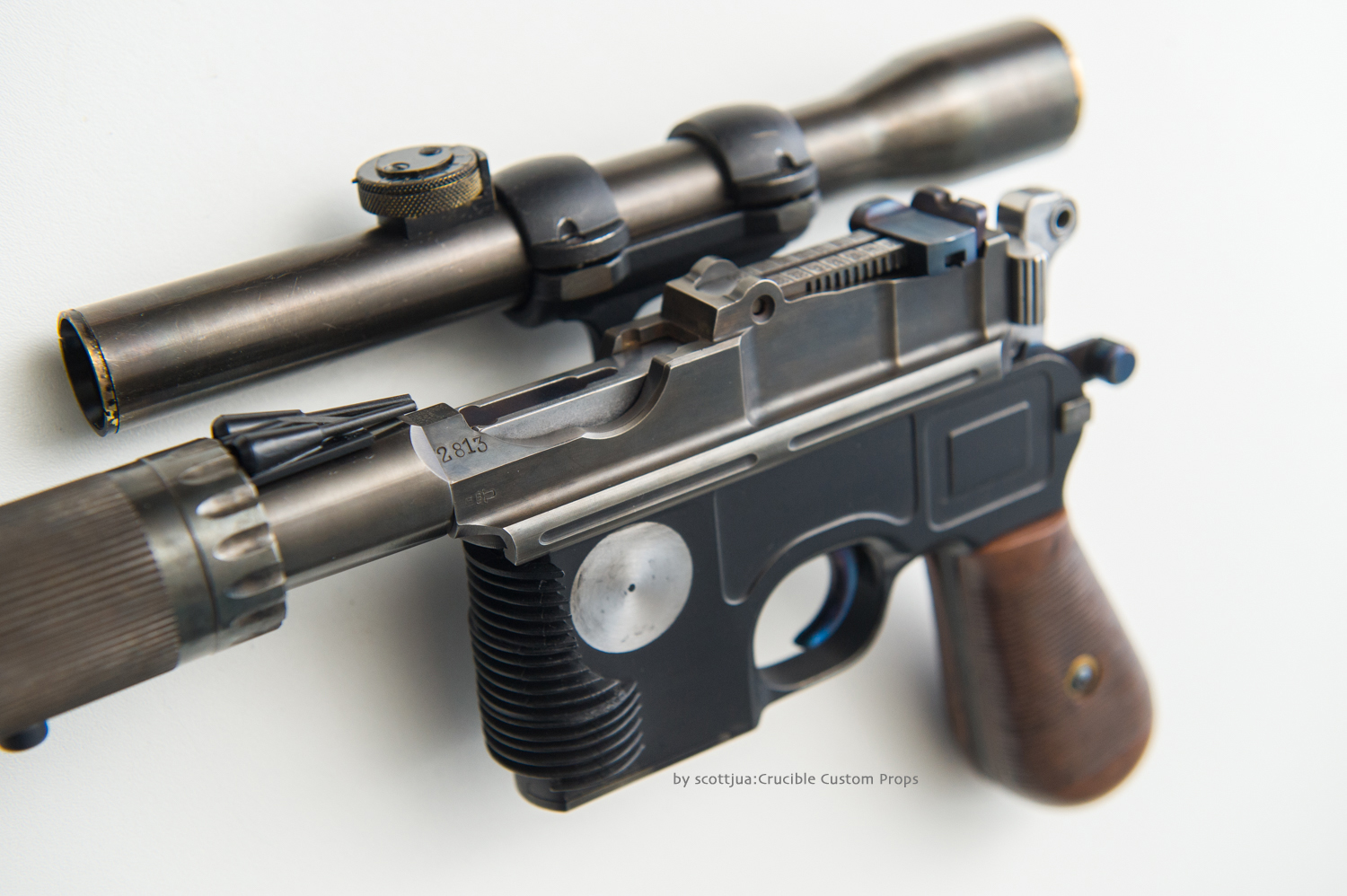

Here’s the latest I’ve finished… well, I’ve built tons of stuff lately, but I don’t always take photos of commissions every single time.
Anyway, here’s the first Field Marshall accurate Mauser project blaster done, and another Solo’s Hold Rey

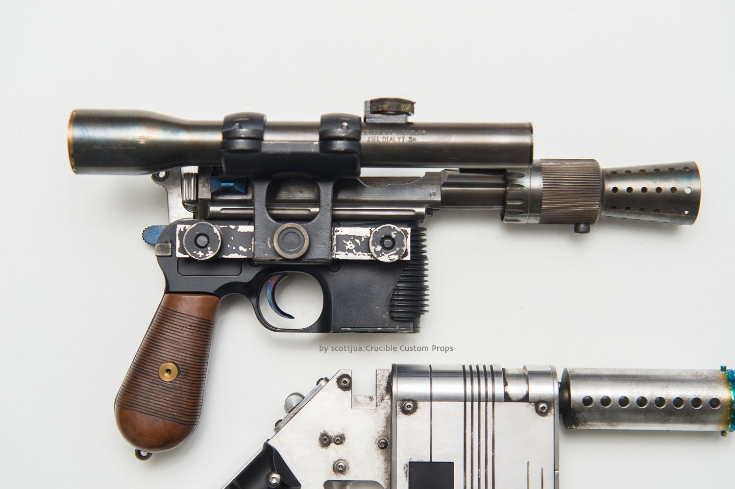

scottjua Just admiring ur hero build once more and have a question for ya. Why blue the trigger if you are painting the lower? Wouldn’t it all be painted including the tigger if that was the case or do you think they took the Mauser that much apart when building it originally?? The contrast it gives to the overall look is great but just curious is all.
Maybe; I'd personally guess that even if the trigger was painted originally then it probably all wore off relatively quickly, both from the action of rubbing up into the lower receiver's trigger hole, and just from all the contact with Harrison Ford's sweaty sausage finger ;)
sure anything is possible really but paint generally doesn’t rub off so easily..

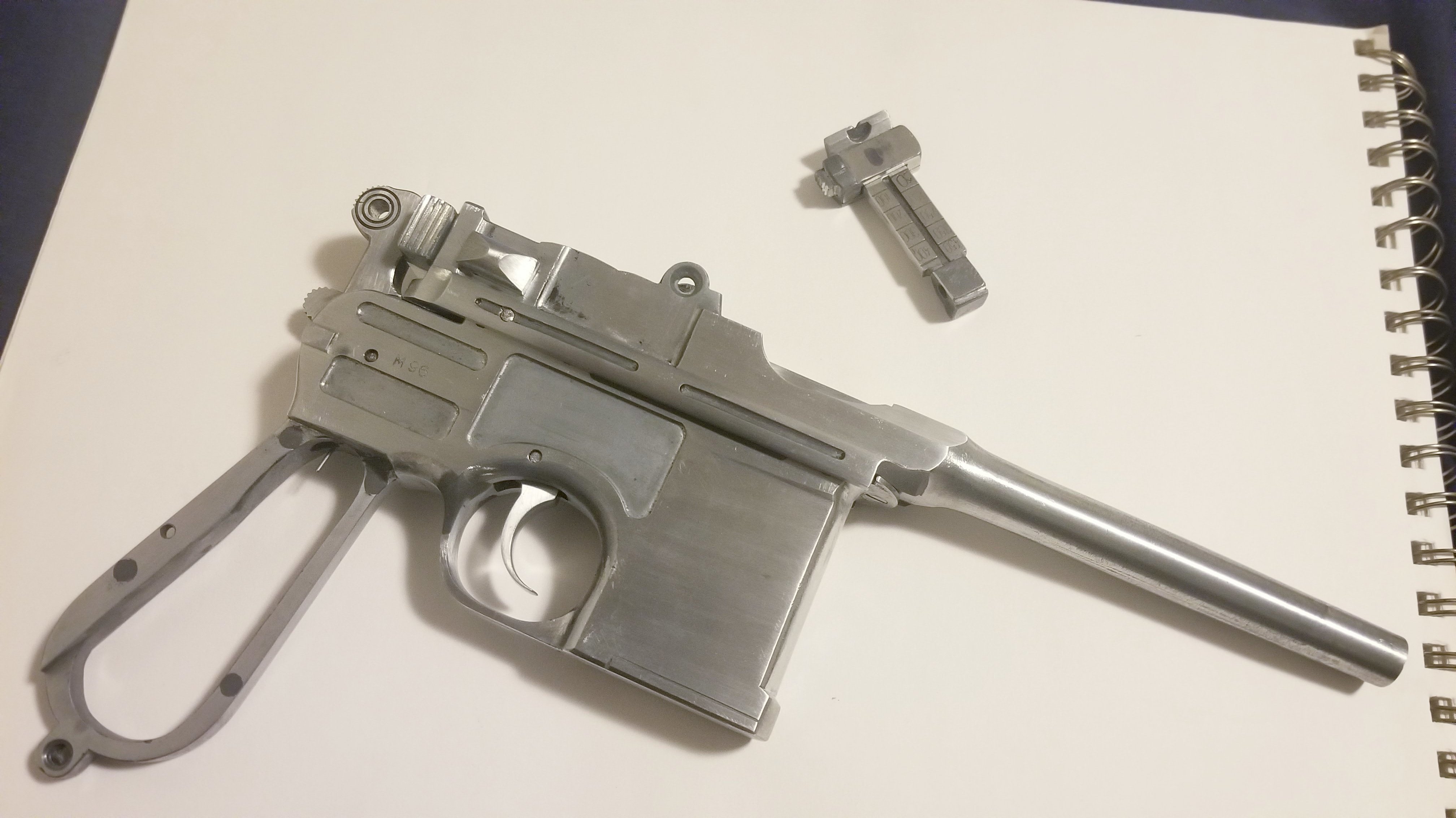

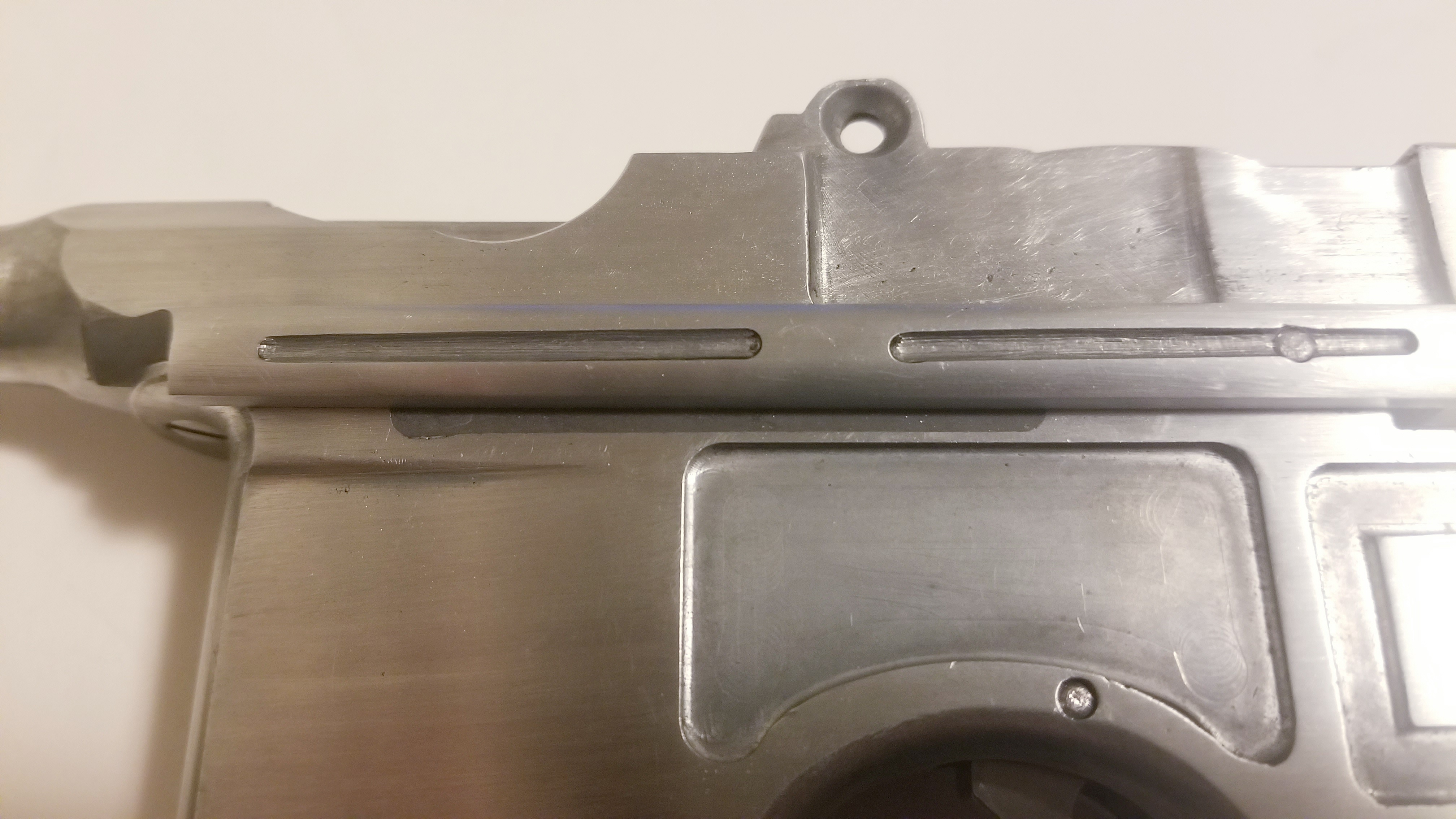

With a bit more free time on my hands I've started doing some work on an old Denix I've had laying around. I think this was one of the Mausers that was originally accurized by Boba Debt, as it has the magplate and extractor details machined into it.
Breaking out the JB weld helped me a lot; I went and filled every hole and major casting mark I could, so once the whole thing is blued and painted everything will be nice and smooth. I also took the liberty of chamfered a lot of the troublesome edges; since the Denix is so soft it's hard to get clean edges without removing an exorbitant amount of material on the major faces. They also end up making things just look much cleaner.
Some other modifications include getting ALL the pitting out, reshaping the grip frame to accurate grip dimensions, accurizing the hammer shape, correcting certain alignment issues, reshaping the saftey (also thinning it out so it no longer rubs against the hammer) and sanding the ejection port scallops and trigger guard contours to accurate shape. I still need to get the pins replaced; and once it's all assembled the holes will be permanently filled and sanded out.

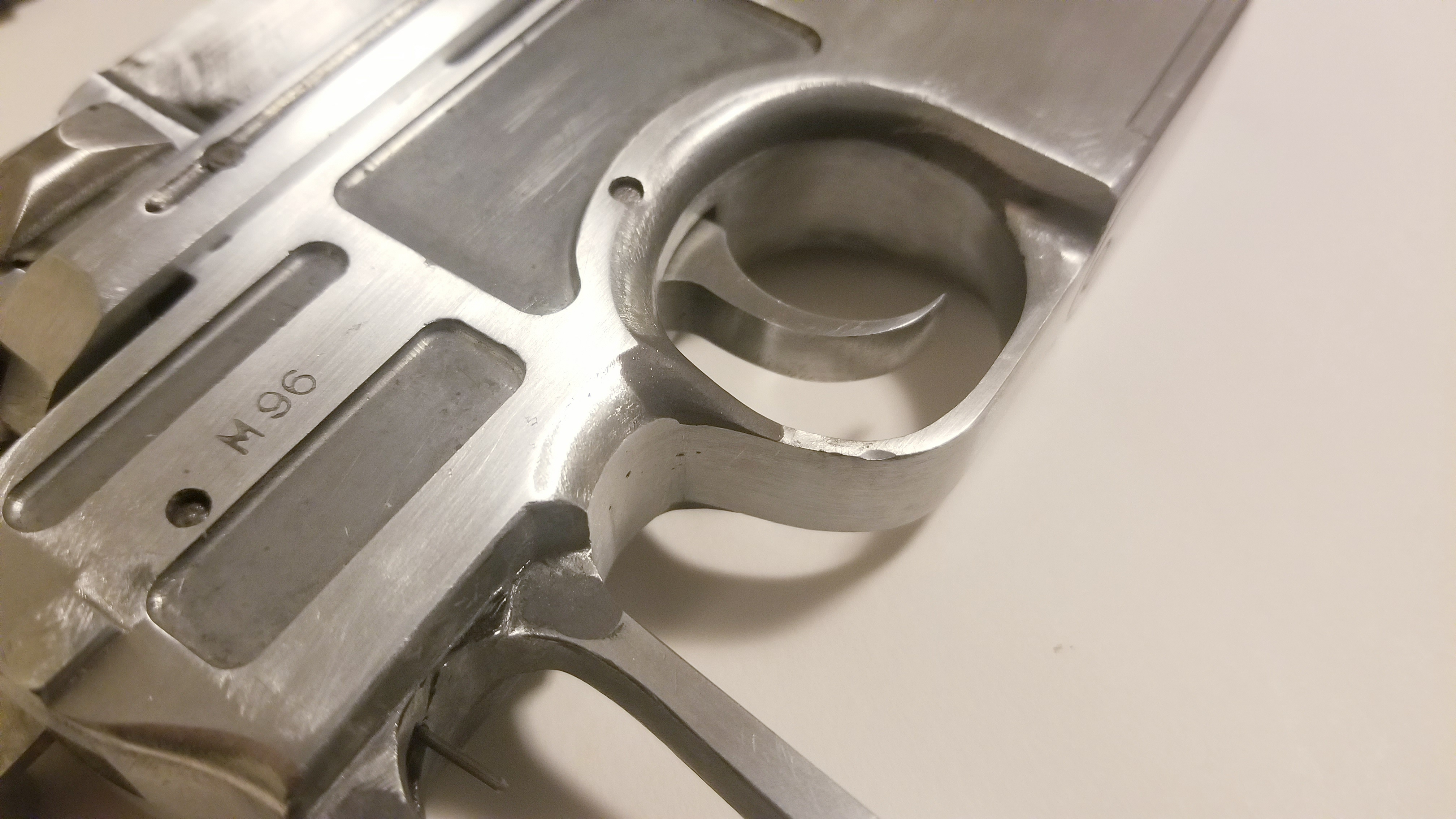

I sanded the trigger as much as I dared (also built up the trigger guard contours with JB Weld; this is one of the few areas on the Denix that doesn't have enough material, I've found).
One of the worst areas on the Denix looks so much better now; it resembles a real Mauser's look so much more! Also, anyone familiar with the way the Denix's upper receiver slopes downwards should know that this little addition finally corrects that annoying alignment problem ;)

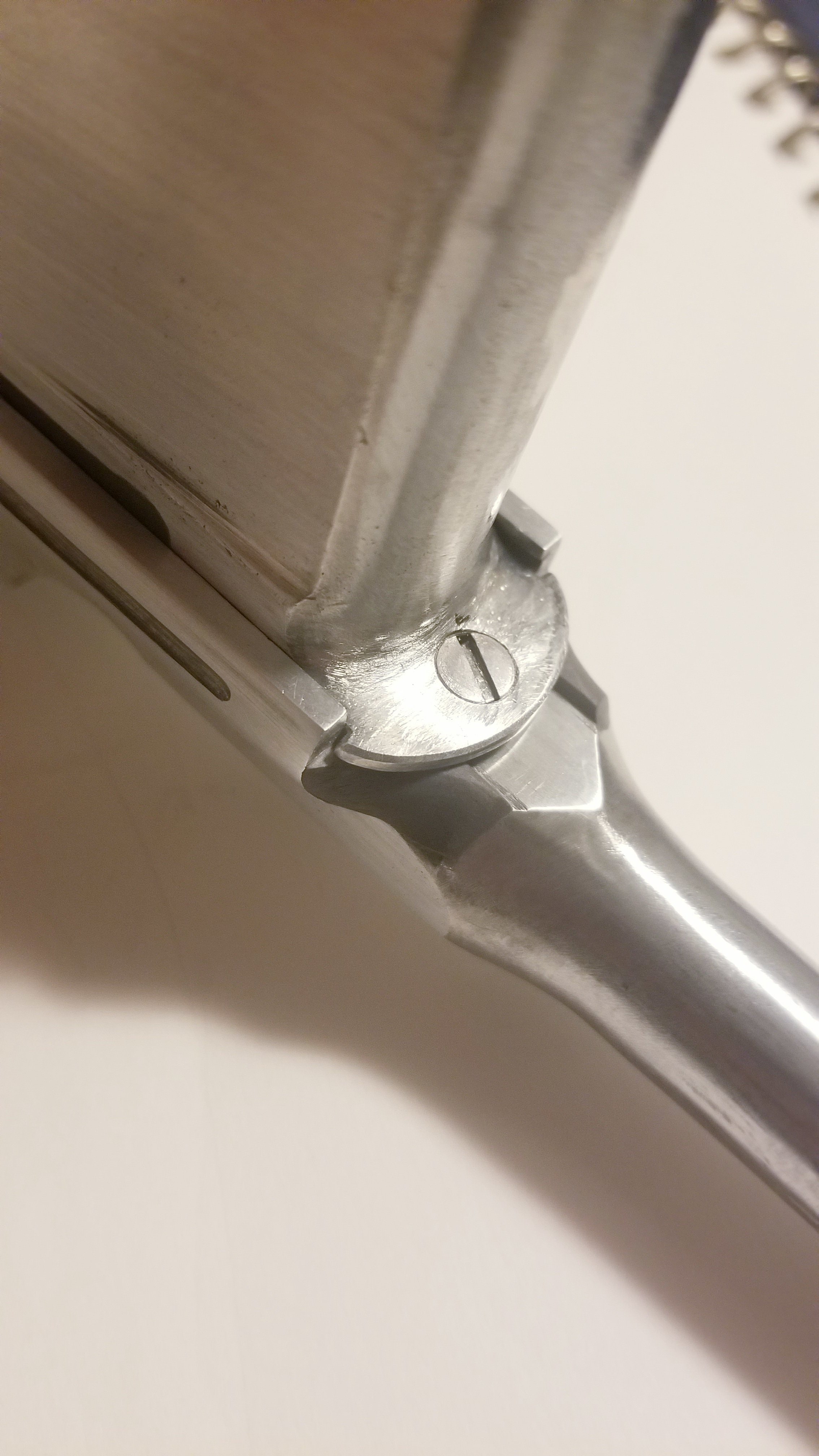

The screw was countersunk so it sits flush, and no longer bulges out. All these recessed areas have been filled with weld.
Sorry for the lengthy post; it's been a while since I've been active and just want to get back into the swing of things! :D Matty Matt's ESB mods were very helpful in getting my butt back in gear with this thing; it had been laying on my shelf for far too long.
