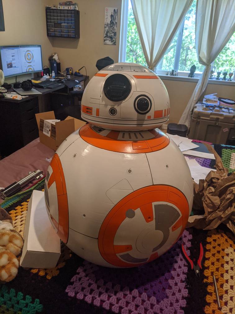

I am currently a senior in High School making an animatronic BB-8 (it's going to be done very soon) and I have been heavily inspired by the work done at ILM since its inception. From what I heard, ILM's animatronic prop shop more or less dissolved after ep III correct? I pretty much know I want to work on film special effects like animatronics, props, and such, so I was curious if there are still small opportunities at ILM to do those things.
Once again, I apologize if I barged in the conversation, but I am just really curious about what you would say. I am planning on majoring in robotics or mechanical engineering in college with a film studies minor, and I am hoping one day to intern maybe at ILM, Legacy Effects, or other companies that have special effects (a pretty bold path I imagine)

Hi Matthew! I'd love to see your BB-8.

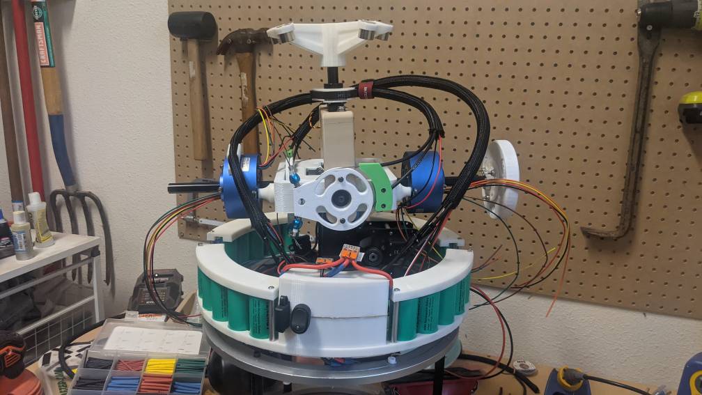

Here's my website with a lot of photos of bb-8: www.matthewwinchell.com
I'll also post some here.

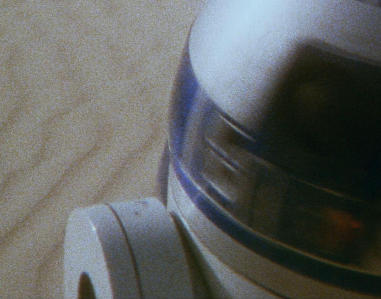

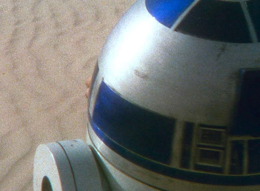

I love that picture of the fingers peeking around R2's dome!
The thing about that shot that I find absolutely hilarious is that those digits have been there, right in front of us, the whole time. Every release of the film, from the very first 35mm prints, all the way through to the Special Edition, contain that person's fingers! We just never noticed them since the fingertips only appear for about 6 frames, and they're pretty close in colour to that of the Mojave desert sand.
A shot a few seconds later includes a dark blue coat sleeve or something similar, down by the base of the dome. Here's a screen grab from a 35mm film scan. This sleeve, that I think Mark Kiger was the first to notice, was digitally erased for the Special Edition.

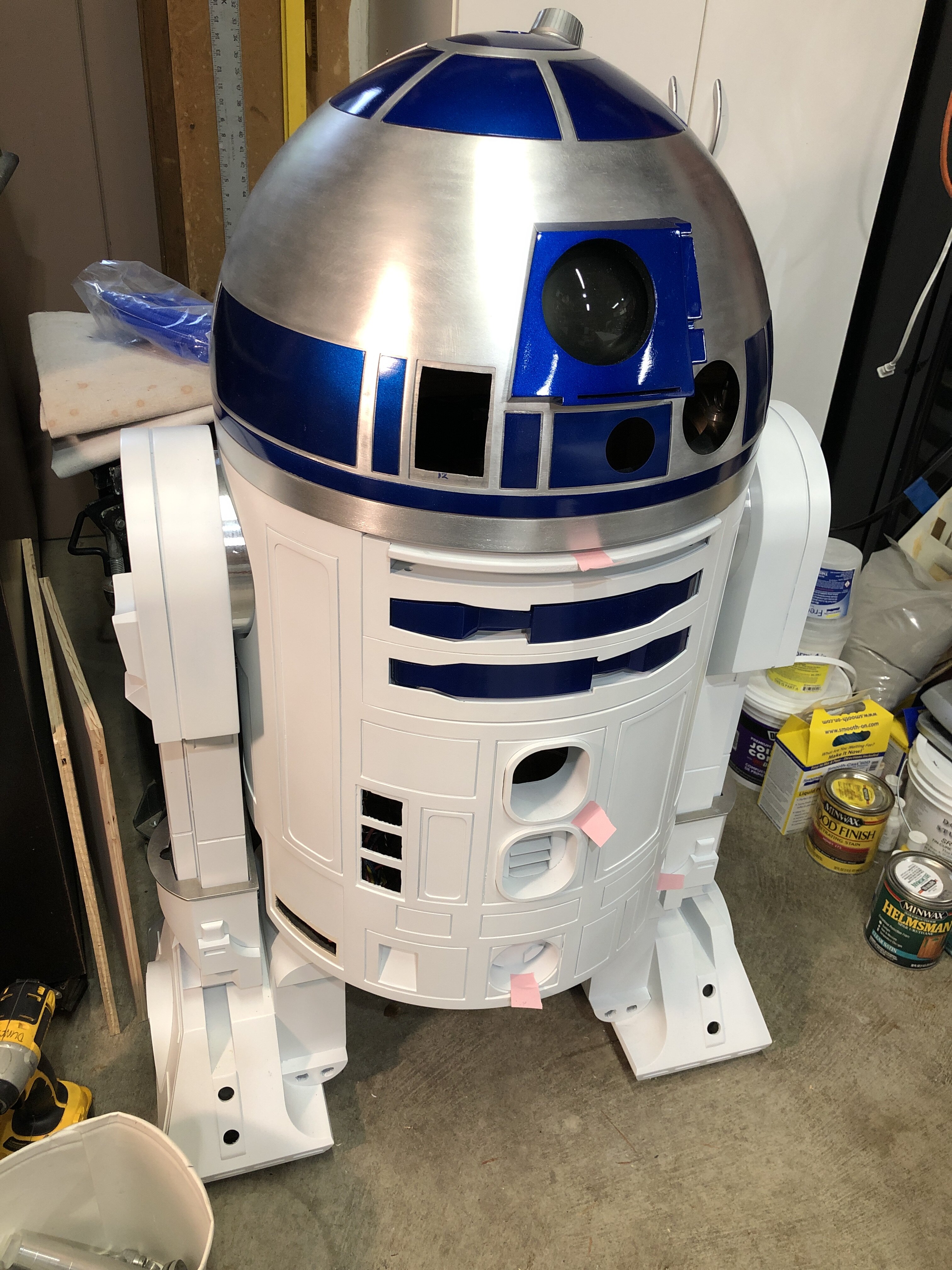

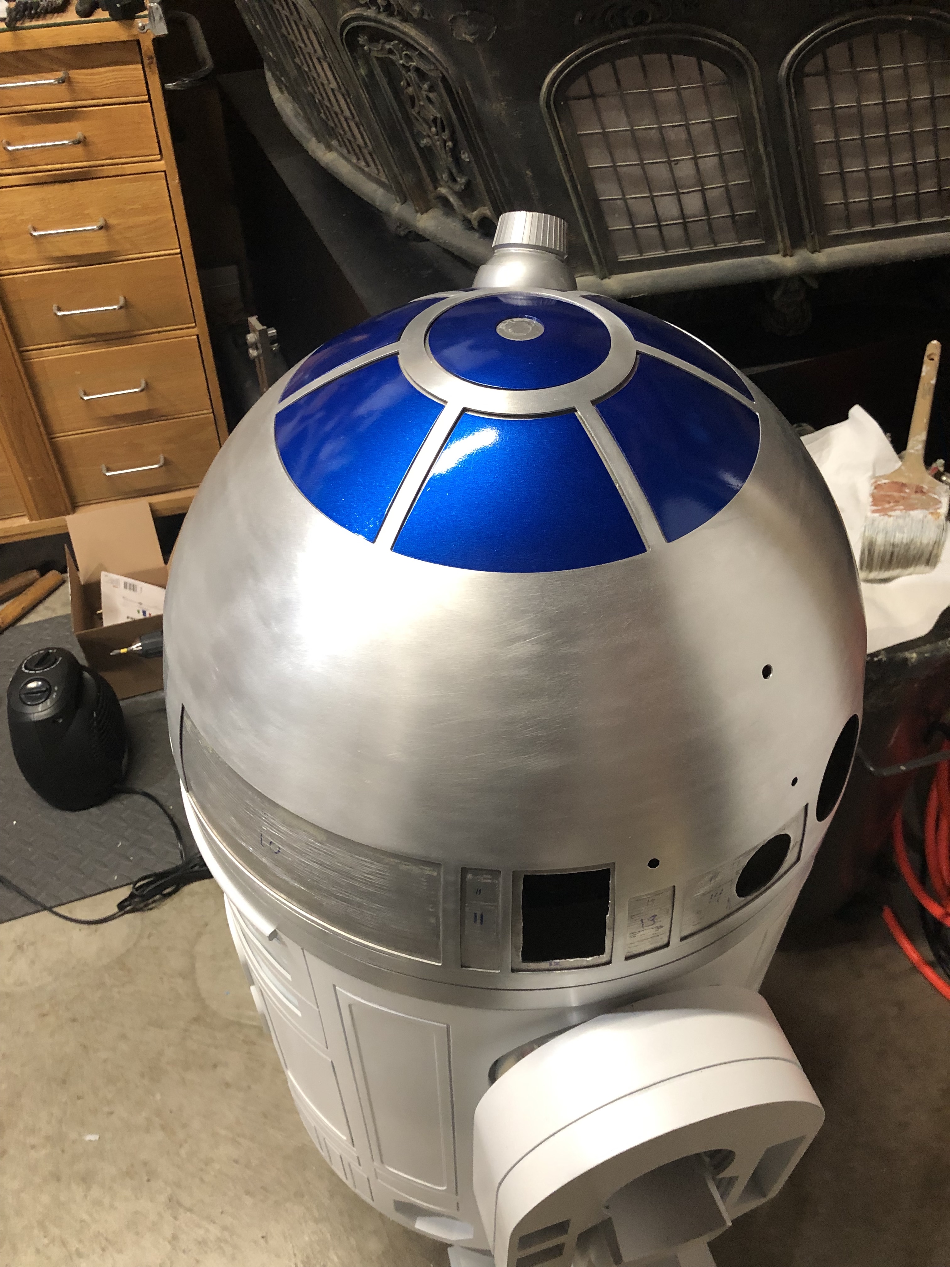

Sooooo..... paint.
A lot has been said about R2 paint colors.
....pesky accuracy... again....
As I mentioned before, all of the droids got repainted so that they all matched for the prequels.
(Further justification for purists that mine would be defined as a Prequel Droid);)
Over the previous years, movies, TV specials & commercial, and public appearances and exhibitions the R2s had been
touched up and repainted with a variety of differing colors.
This hodge-podge of mis-matched colors simply wouldn't do for the new films, so Don Bies and his team set out to find original parts with untouched paint still on them in order to have new paints made that would restore the droids to as close to original colors as possible.
Since Don was a part of our Romeo Delta group, we were able to order batches of the paint as well.

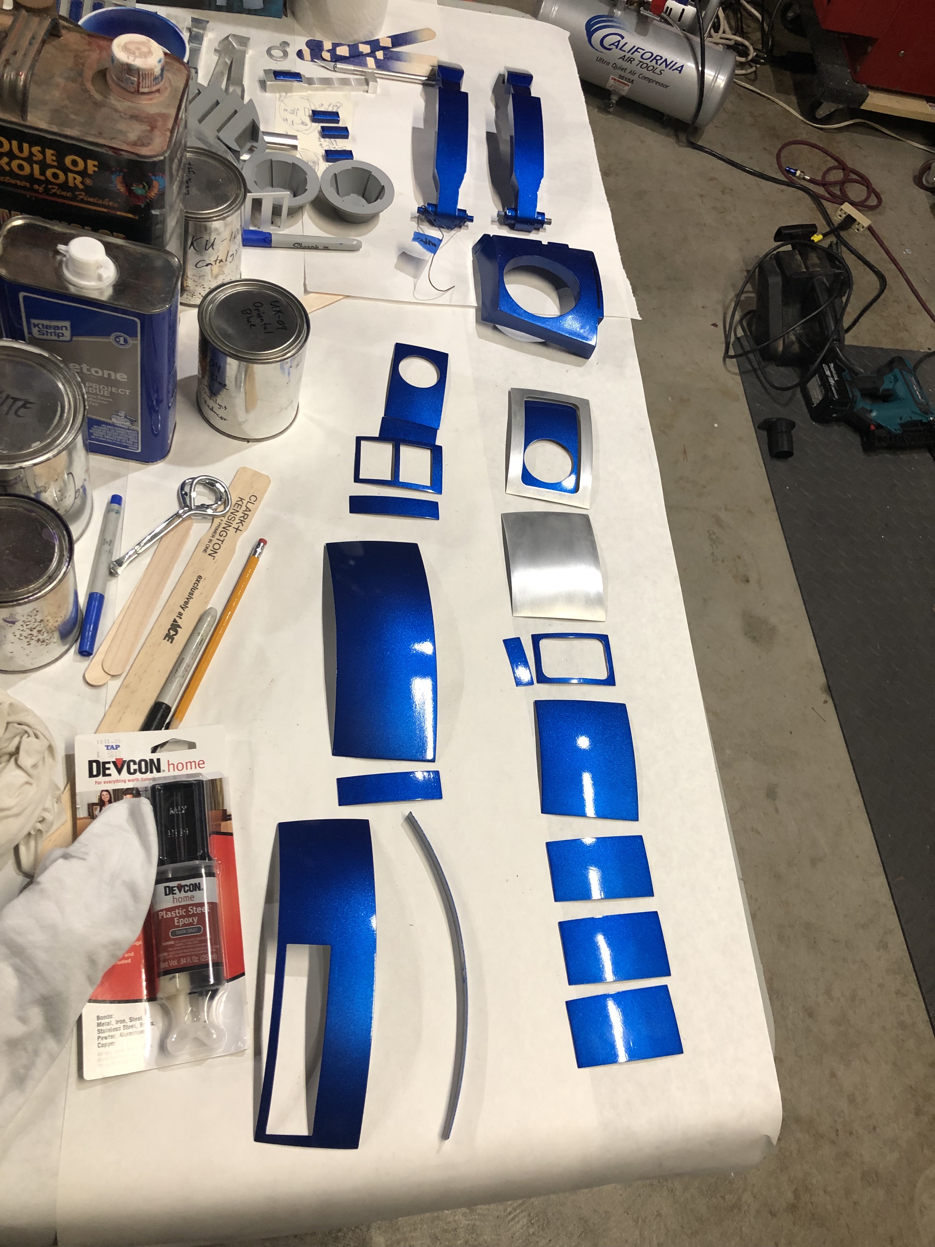

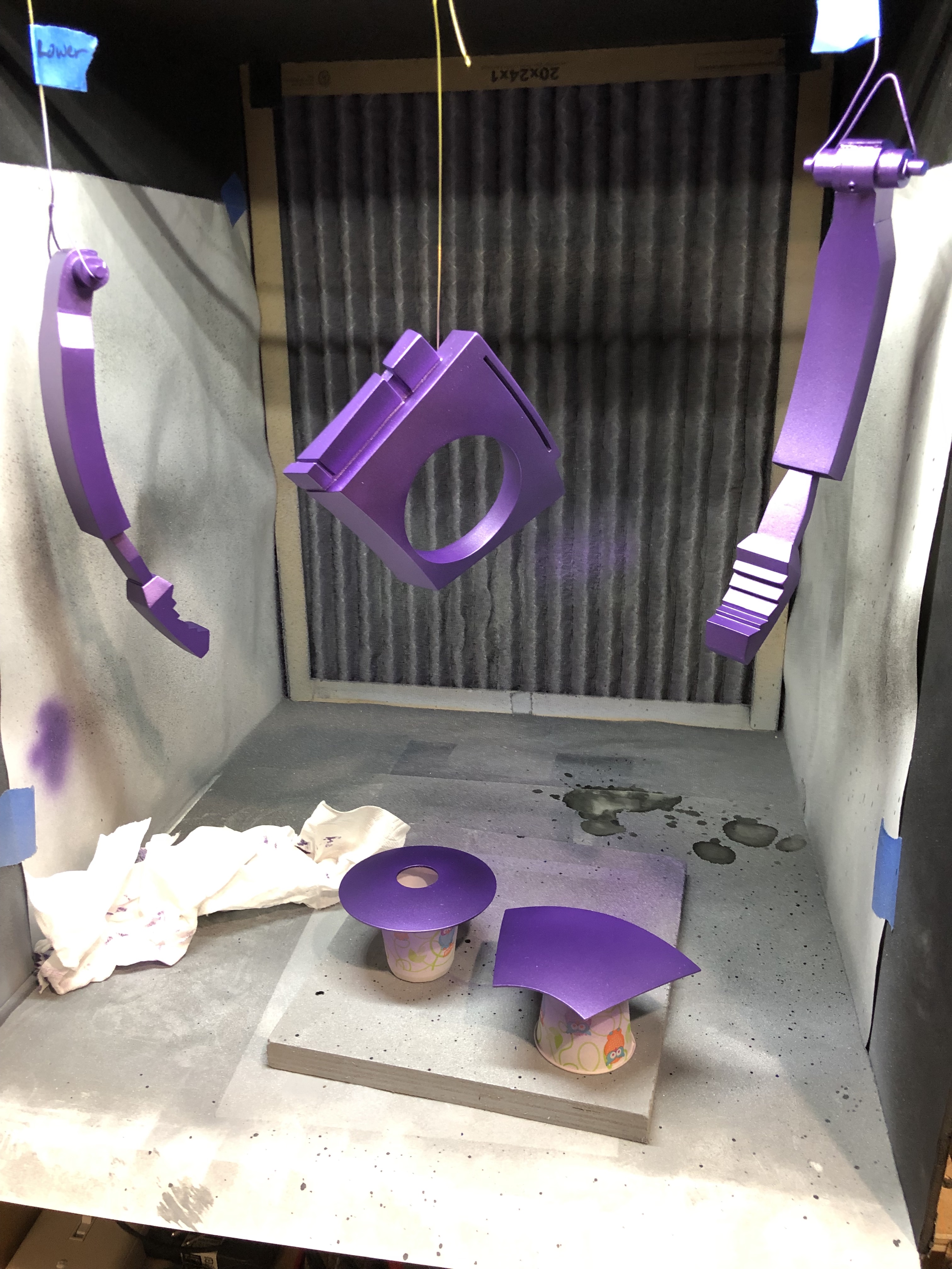

The white was a custom off-white with a sort of satin sheen. It was a straightforward automotive type paint.
The blue got complicated. To get a deep blue that shifts to purple or even blackish from the right angle took more steps to do.
The base paint was a purple metallic that was a mix of three House of Kolor auto paints. Then that was over coated with a catalyzed clear blue.
The clear blue was a bit of a pain to spray because you had to mix the color with the catalyst and a reducer (at the right ratio) every time you used it. Since it was catalyzed, you had to use it right then - you couldn't store it. It would turn to jelly and harden. So even if you just needed to paint one tiny part, you still needed to mix up the whole potion.
When I painted the purple color on, there was a part of my brain that was screaming "What the hell are you doing?"
But once I got the clear blue topcoat sprayed on, my heart went "Aaaaah!"
And...The Viscount light HP's were found by John Sherrell. Once Jeremy Firth over in England tracked down the original part and part number, John was able to secure a fairly large cache of them. He bought all they had and had them shipped here to Texas. He then sold them to builders for what he paid for them...$30 each. :)
That's...That's beautiful.
