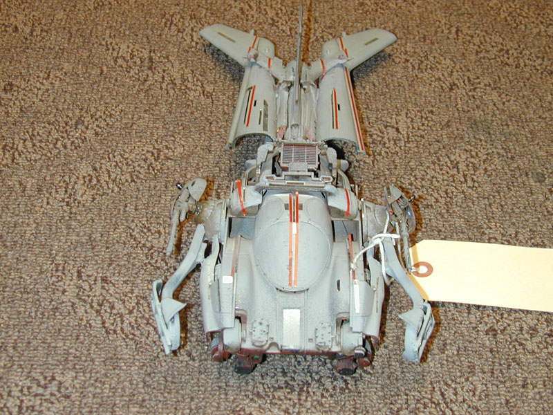

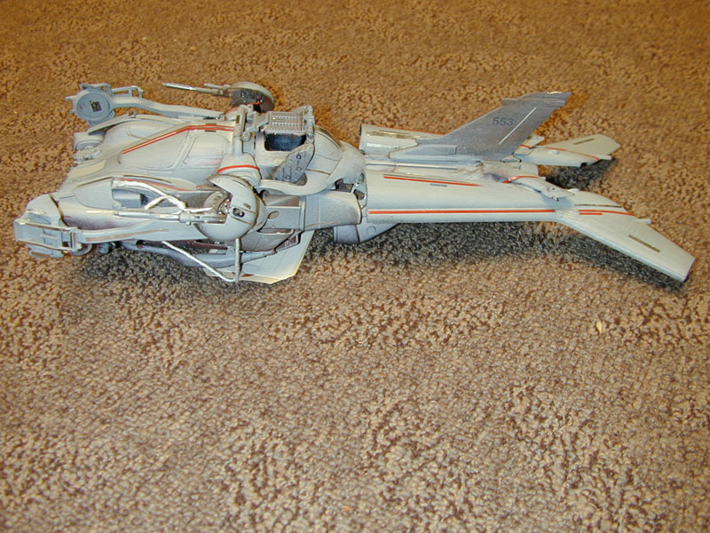

Aliens: Gateway Station Shuttle- research thread

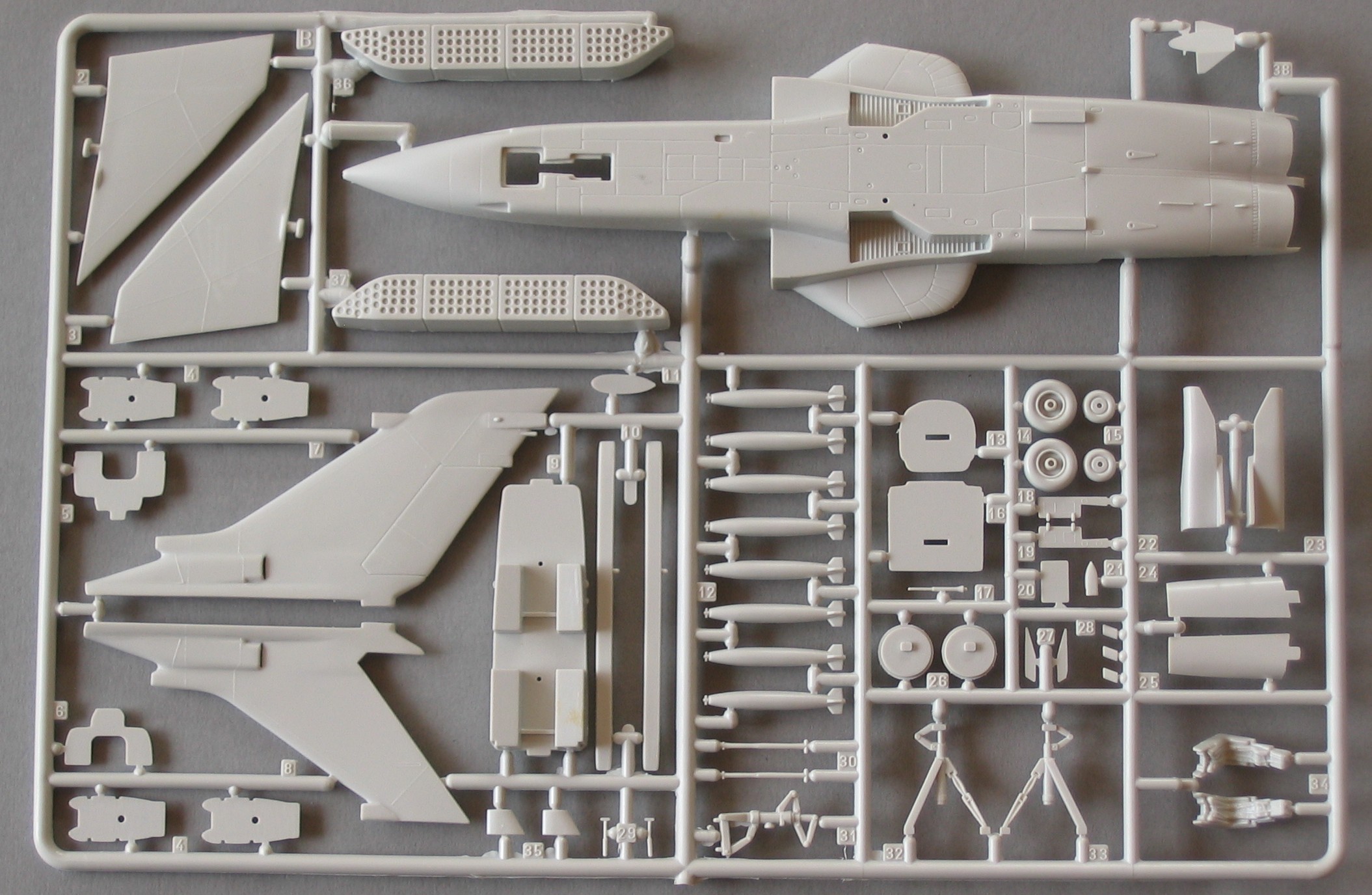

The Heller GR.4 is wrong too. Little winglets at base of tail and larger winglets/canards near top of tail (like the Monogram). Probably the same as the Airfix kit, with extra sprues for different weapons load.
JT
Tgreco, do you have a larger version of this photo?
JT
JT
which one?
the bottom one is just the small one printed out full page
the quality is pretty much crap
the main photo of the porsche body and huey tail I do have larger, but it's wrong.... first huey I found was 1/48 scale, not the appropriate 1/24

BTW do we have an ID on the Seahawk/Blackhawk kit?
And any news on the ESCI Tornado? If that's not right, I have another possibility in the post from OS. Let you know when it arrives!
Cheers, JT
I've used the Hasegawa Seahawk and I coudn't spot anything wrong with the parts. There is no copyright date on the parts, but the instructions say 1985.
As for the ESCI kit - I just got the box in and from first sight think we have a winner. I'll post some pictures as soon as possible.
