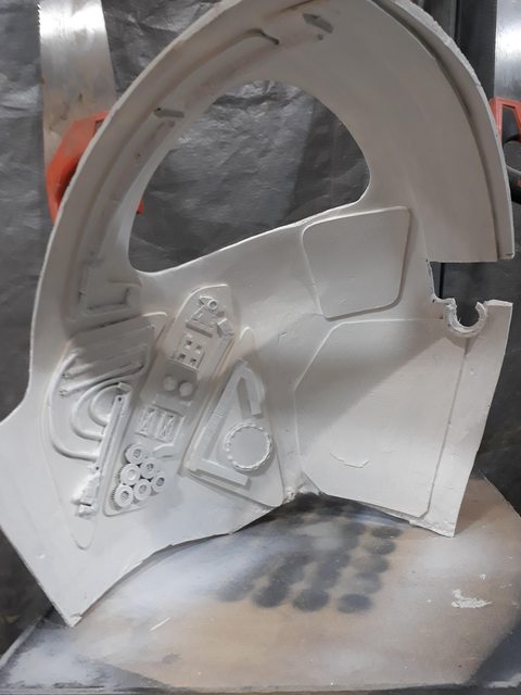

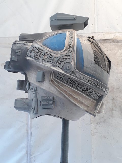

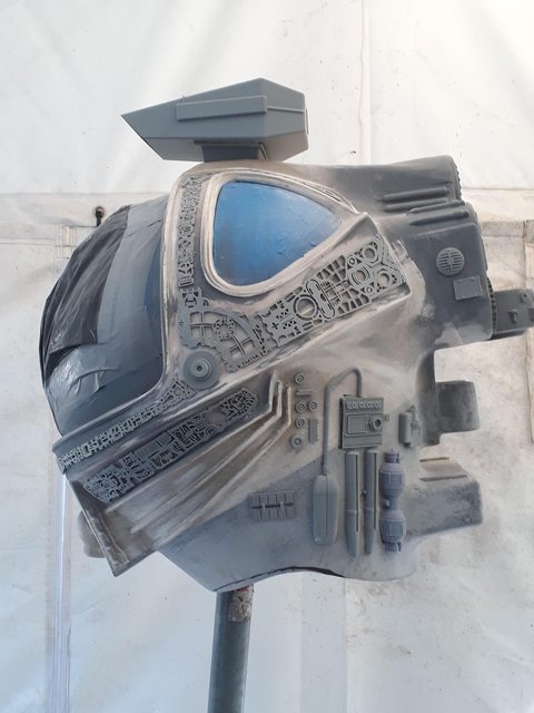

Cheers guys, so bit more progress...got the inner panels done
Thanks dude. The etchings; printed on a prusa at .10 quality setting 100% infill...they print at 2mm thick so they are pretty flexible anyway...I just used a hair dryer to soften them a tad
ahh okay that's perfect for what i want to do as well. thanks again for the info and for reigniting the fire for building this. Your work is incredible and sooo fast compared to the pace i was working at!

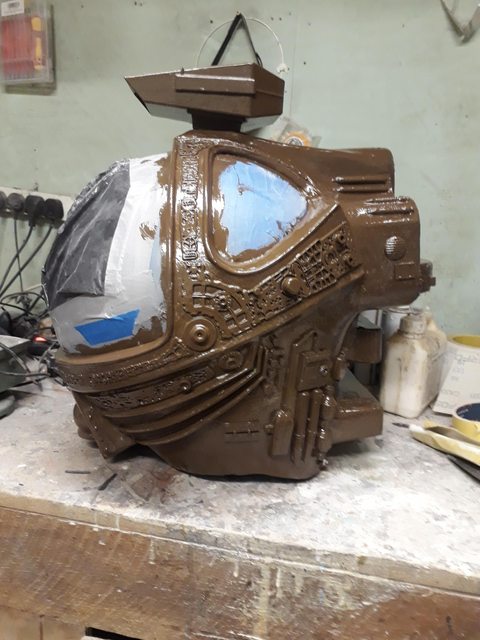

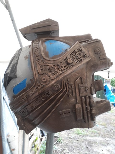

So I've started work on the bronze effect...polyester resin loaded with bronze cold cast powder. It needs a bit of buffing with wire wool to expose the metal and then spritzed with ammonia to get the verdigris to bloom. I'll keep at it until I'm happy with it;

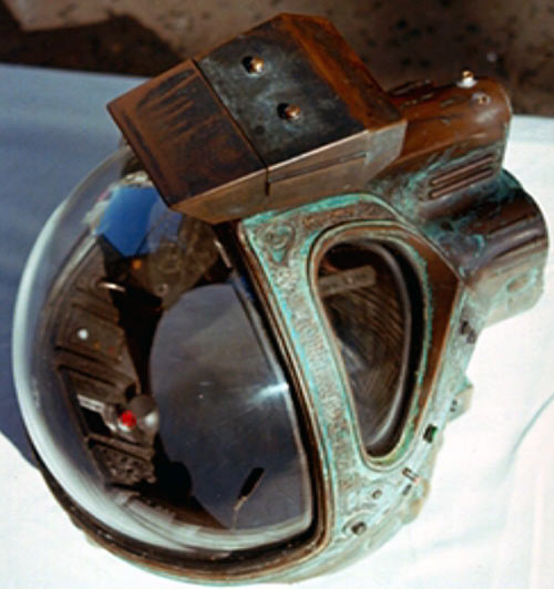

Are their heads slumped forward like that just because the helmets are heavy, or did they not provide enough head room in the back to hold their heads up straight?
Great pictures Division 6!
The light placement and type is something I've been trying to figure out.
