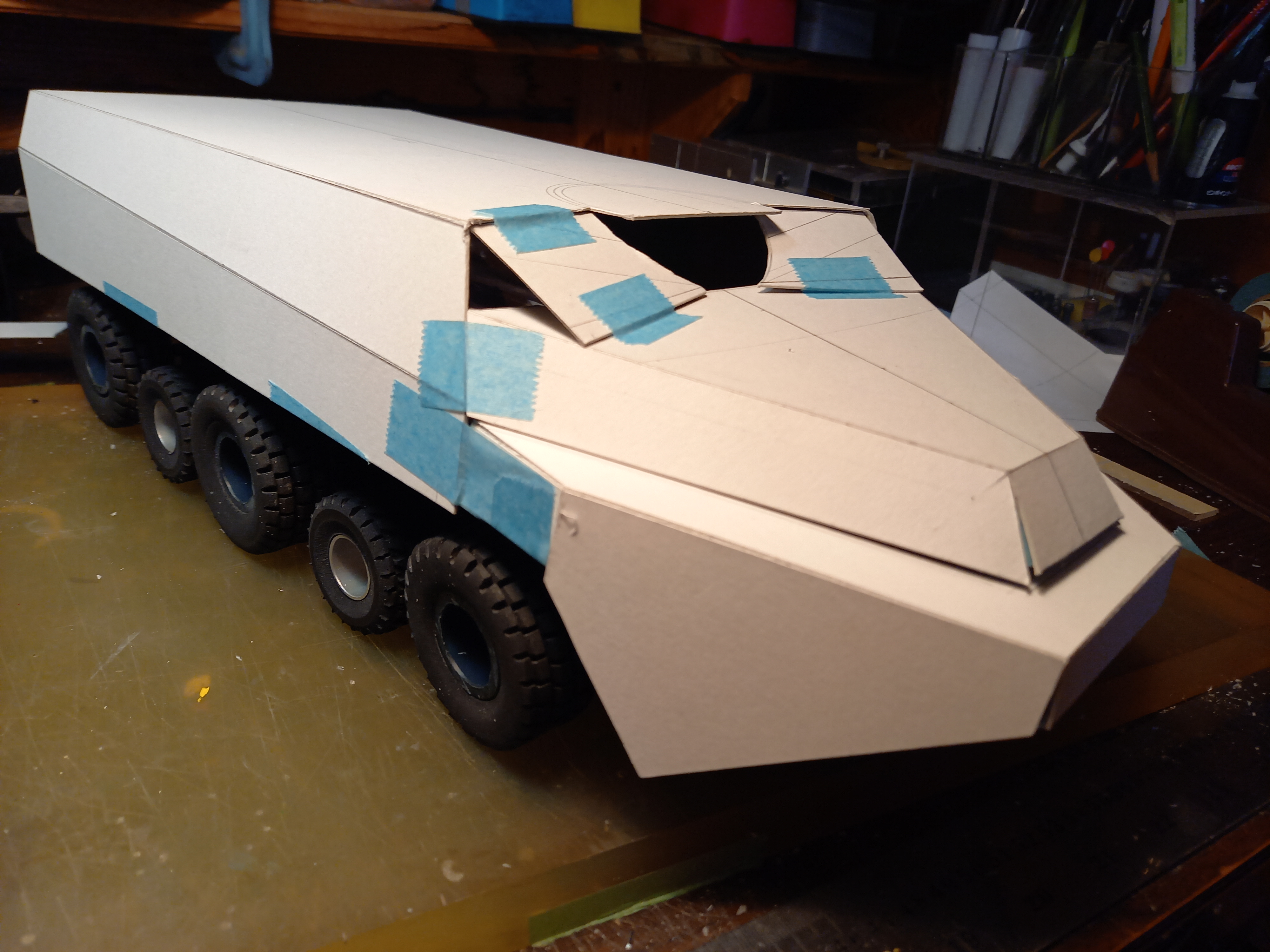

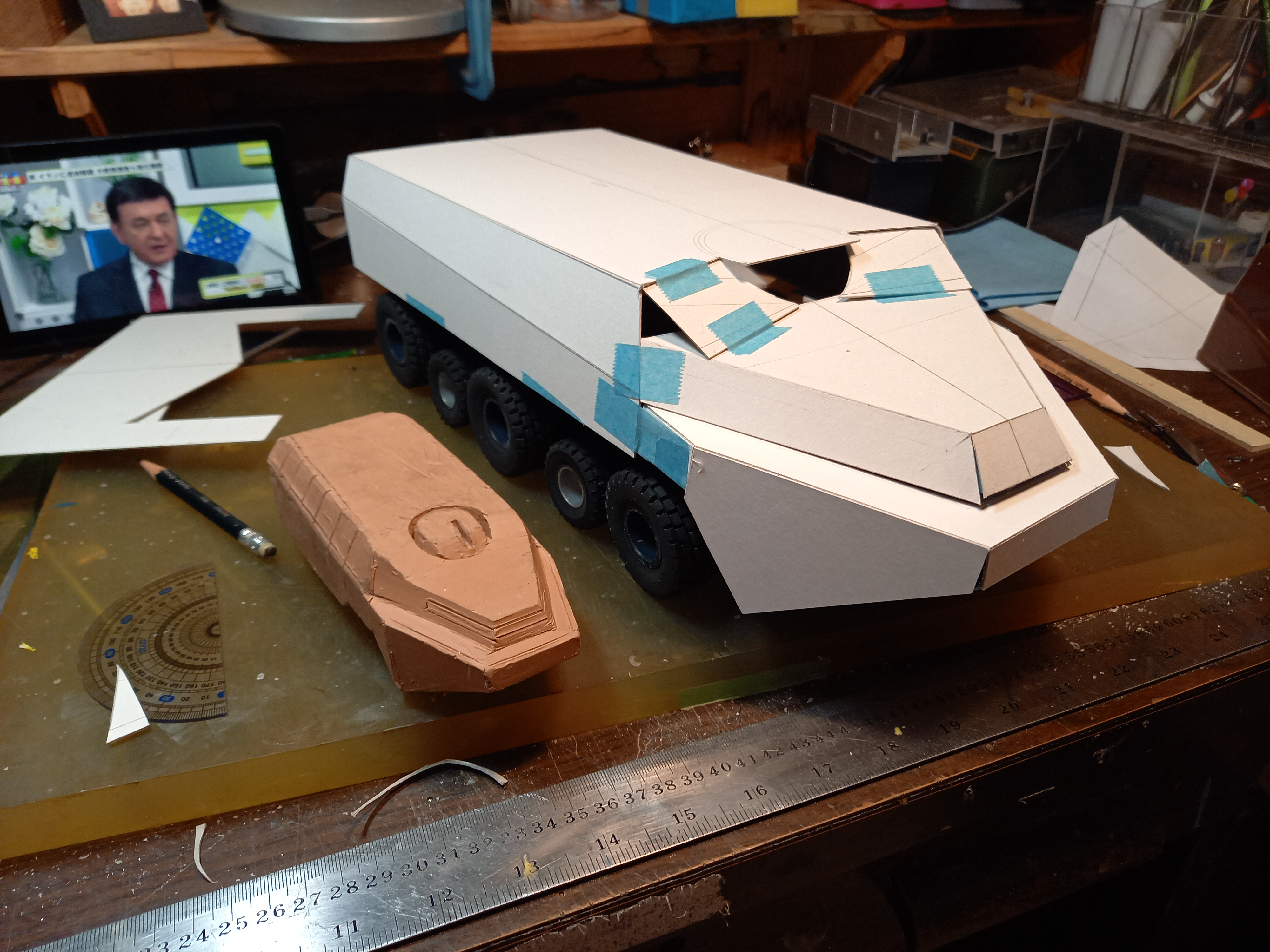

Started to build the upper body.
I've just put on the cardboard pattern to see how it looks.
A long way to go.
Thanks for looking!

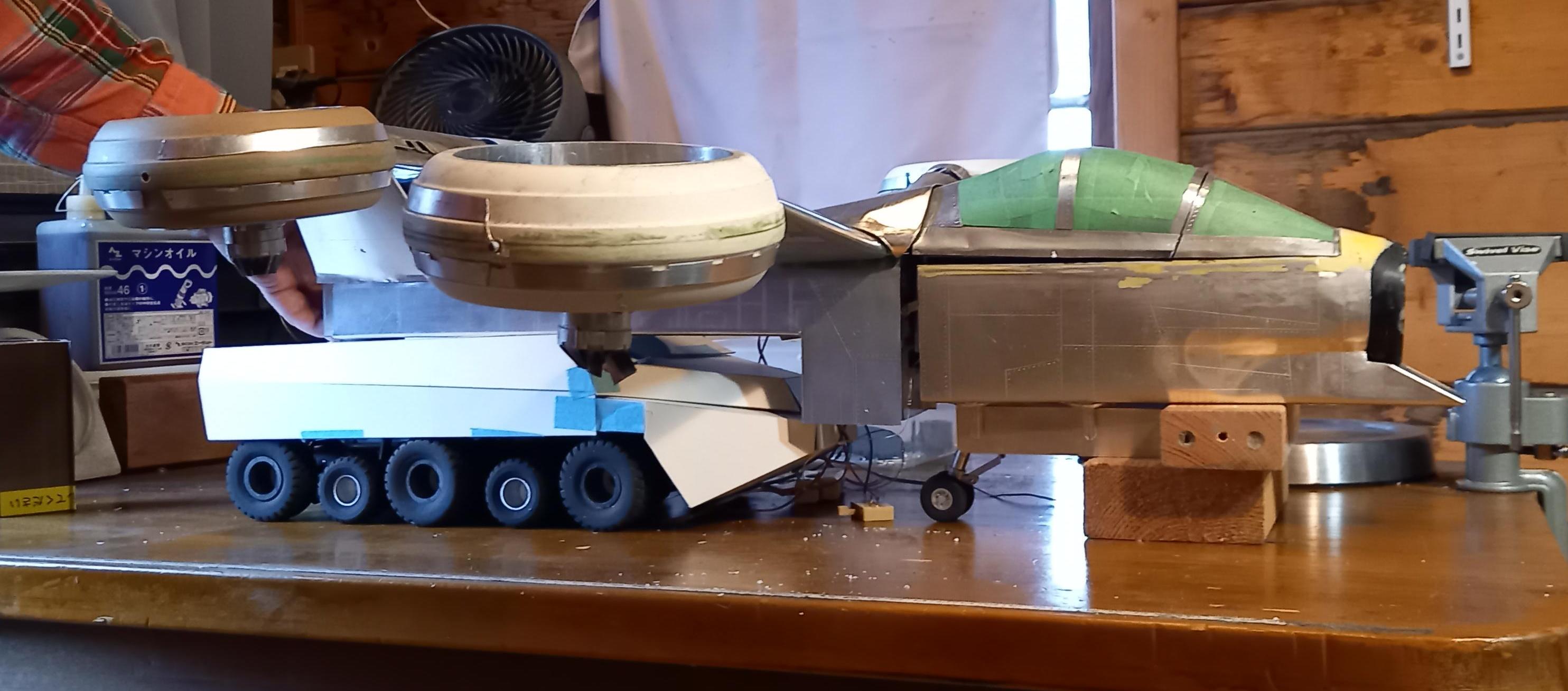

Out of curiosity, would the AAV fit facing backwards? It looks like the shape of the bottom of the drop ship's hull matches fairly closely to the rear of the AAV. (Though tactically, I would think it would make more sense to face forwards, like you have it.)

.Out of curiosity, would the AAV fit facing backwards? It looks like the shape of the bottom of the drop ship's hull matches fairly closely to the rear of the AAV. (Though tactically, I would think it would make more sense to face forwards, like you have it.)
Yes, Tom-san. That's another issue that I have to solve. The first idea didn't have the nose tilt mechanism. So, there was enough room to accept the nose of AAV. Now the room is occupied by a gearbox and actuator. There are two options that I supposed to take.
1. Put the bulge on both sides of the nose section to conceal the AAV's nose.
2. Just remove the nose tilt mechanisms and re-construct the new nose section.
I'm now thinking that the new design of the nose section will be the better option to take. That will be fun to build.

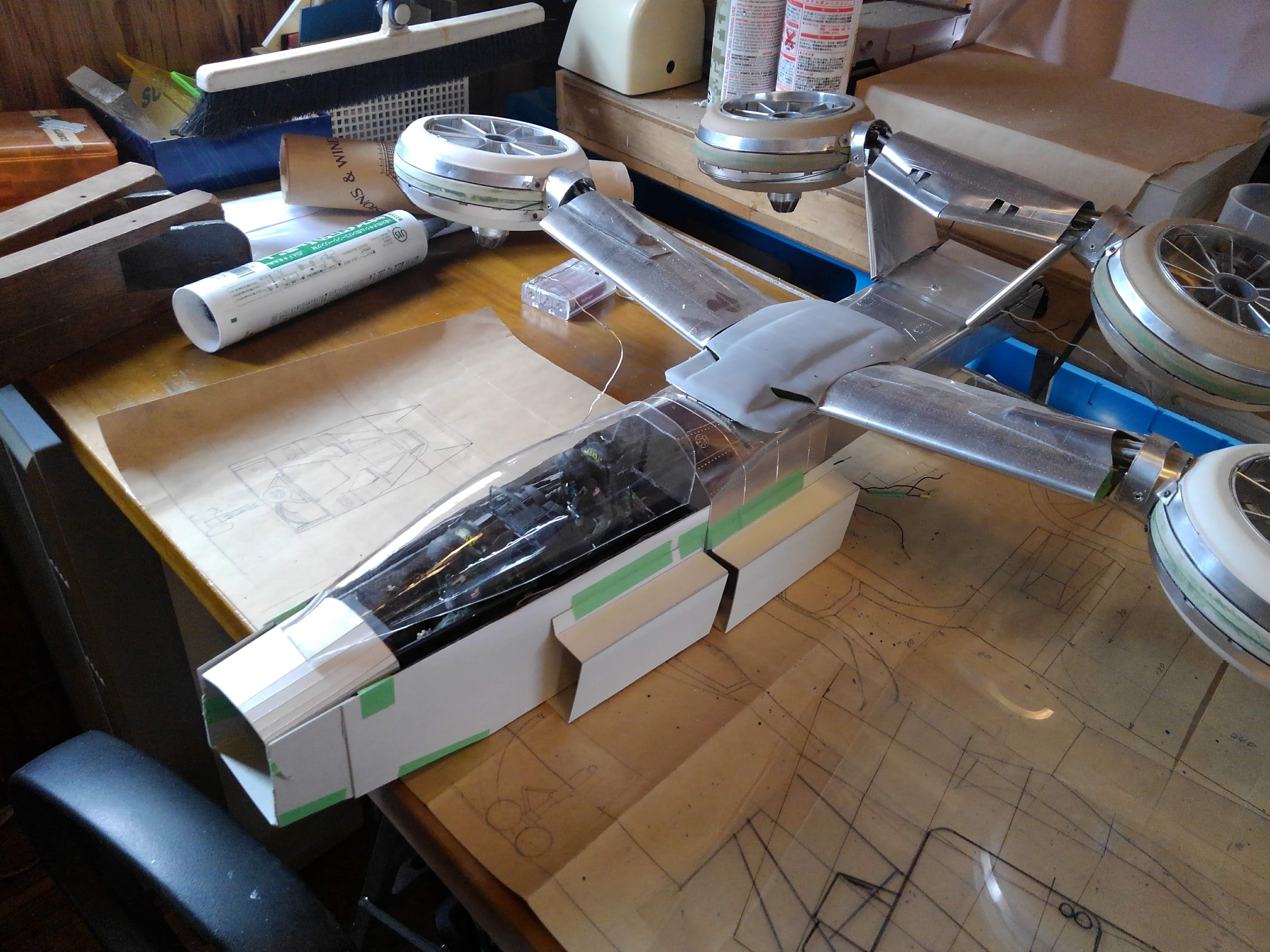

The early idea of adding a bulge.
I'm thinking that the new nose section will be the side by side seating cockpit.
Hey, this project is getting harder like the one of the MV-22 Osprey. :lol: :eek:

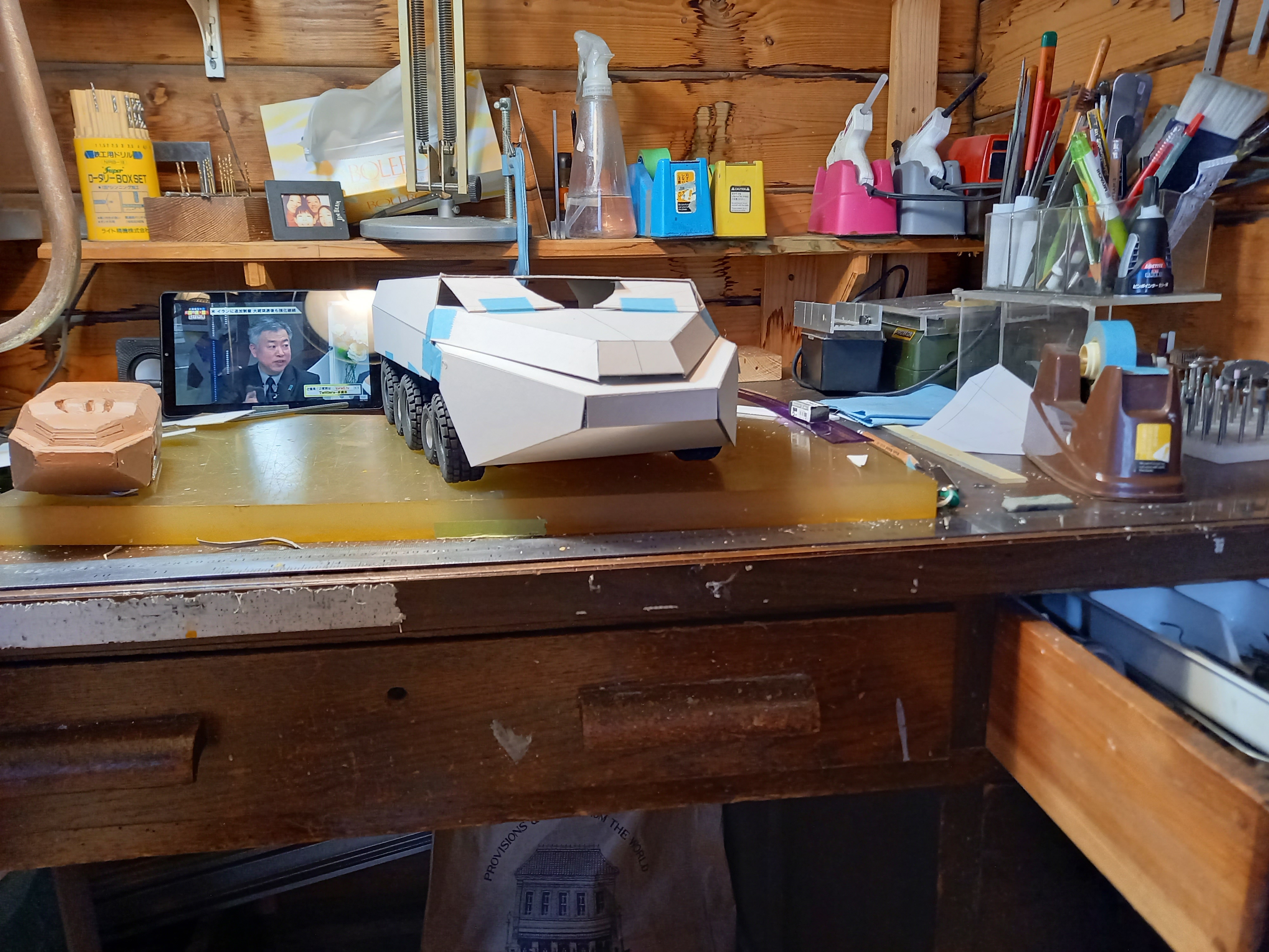

Actually I can see how it might make sense to have the AAV facing towards the back of the drop ship. The drop ship lands with the rear facing the enemy to deliver the AAV and then takes off away from the enemy lines. Provide rear facing turrets on the sides of the drop ship tail assembly to lay down cover fire for the decent to the ground and subsequent launch of the AAV.
I like the idea of a side by side cockpit arrangement. Seems to fit better with the width of the AAV.

I'm keep thinking about that and thought that maybe it's not necessary to fit the vehicle so tight with the dropship. I will try some.

If you rebuild the cockpit 1) Save the present one for some future build and 2) Consider making the cockpit a smaller scale to better match the size of the AAV. Maybe its a trick of the photos but the AAV and the cockpit don't seem to match in scale.
