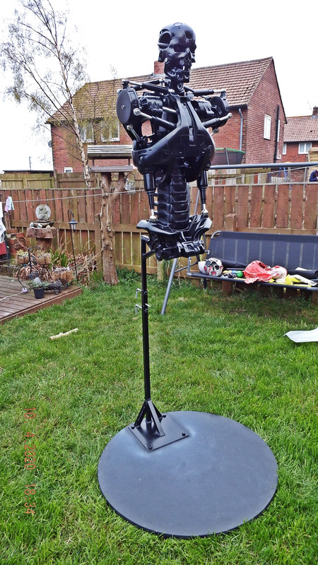

I have spent a lot of effort sanding and priming, and more sanding and more priming to get to this part.
I have the hydraulic cylinders to finish, but thus far, this model has gone together very nicely.
my big worry is fragility. If this were tipped over, all my work would be gone at the speed of gravity!
but here is the current status. This has been a life long dream, and I am
finally At a point that I can look at it and see my dream coming true.

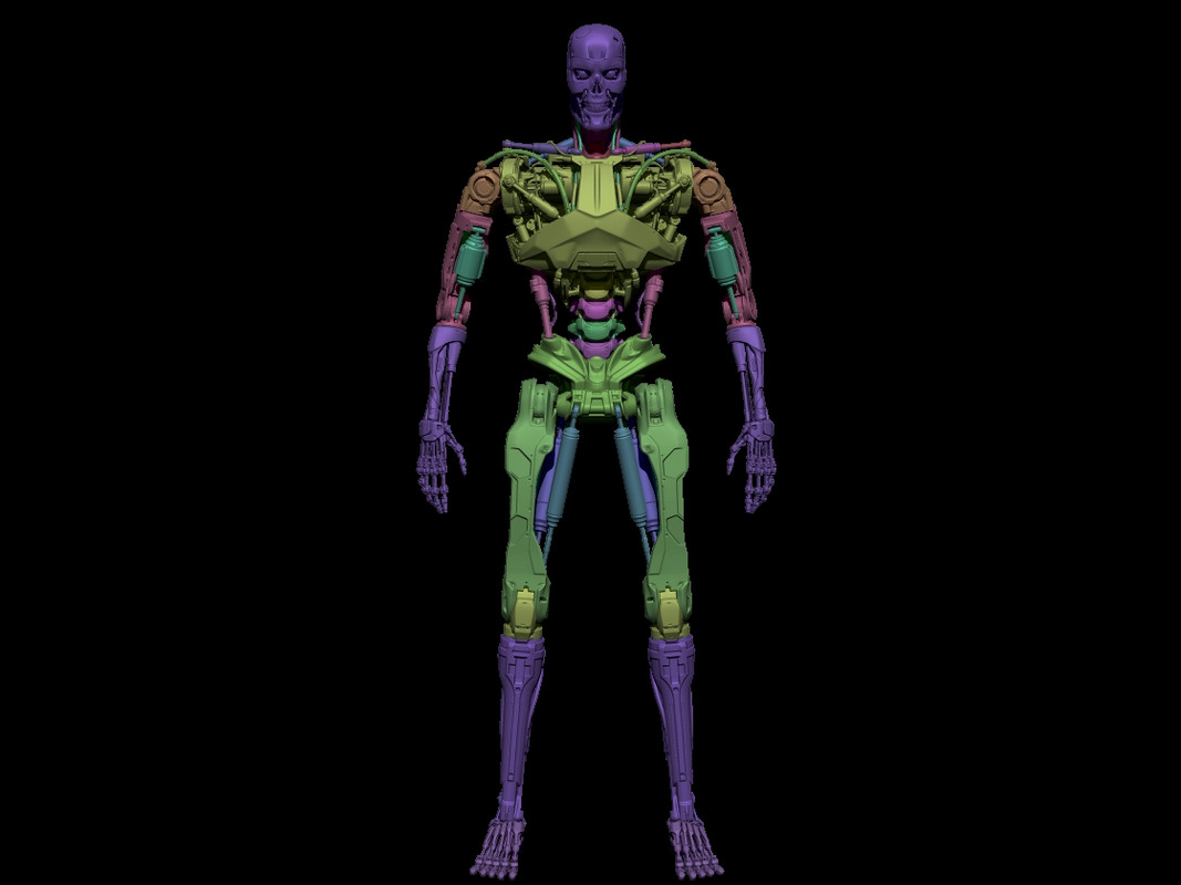

i have them same 3D stl files that you are using plus the T-800 Genisys Endoskeleton one's i was thinking of having a go at them but i have enough on my plate at the moment building my sold polyurethane resin T-800
here is some photos of wear i am up to with the build so far if you haven't seen it in a post that i made some weeks back. plus the 3D stl file main build photo. the Genisys Endoskeleton will be a really nice one to put together.

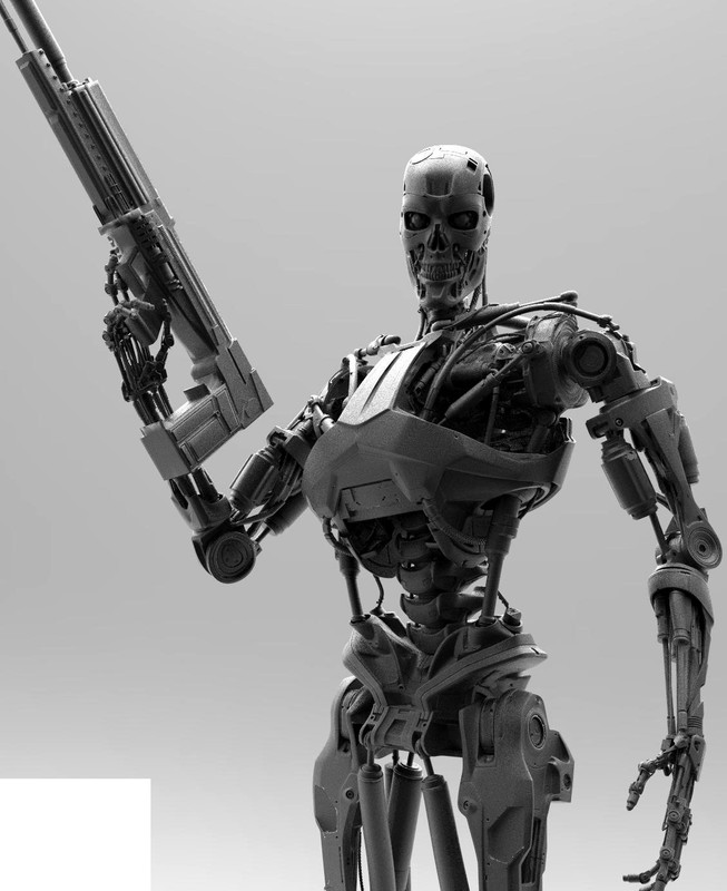

as long as we are on the subject, The original Stan Winston endo needs no improvement, and the Genesis Endo is just another cyborg in a cyborg movie. There! I said it.
I was just on YouTube, and the skeleton can be seen HERE

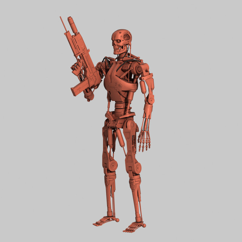

This not my printing, but someone has printed the same file. There are a few differences, but pretty much the same. It is now available on CGTrader.com and anyone who would like to print one should look here
I will say that all the files have printed very well and every fit together to make an endoskeleton that can carry its own weight.
but here is the current status. This has been a life long dream, and I am View attachment 1306646finally At a point that I can look at it and see my dream coming true.
