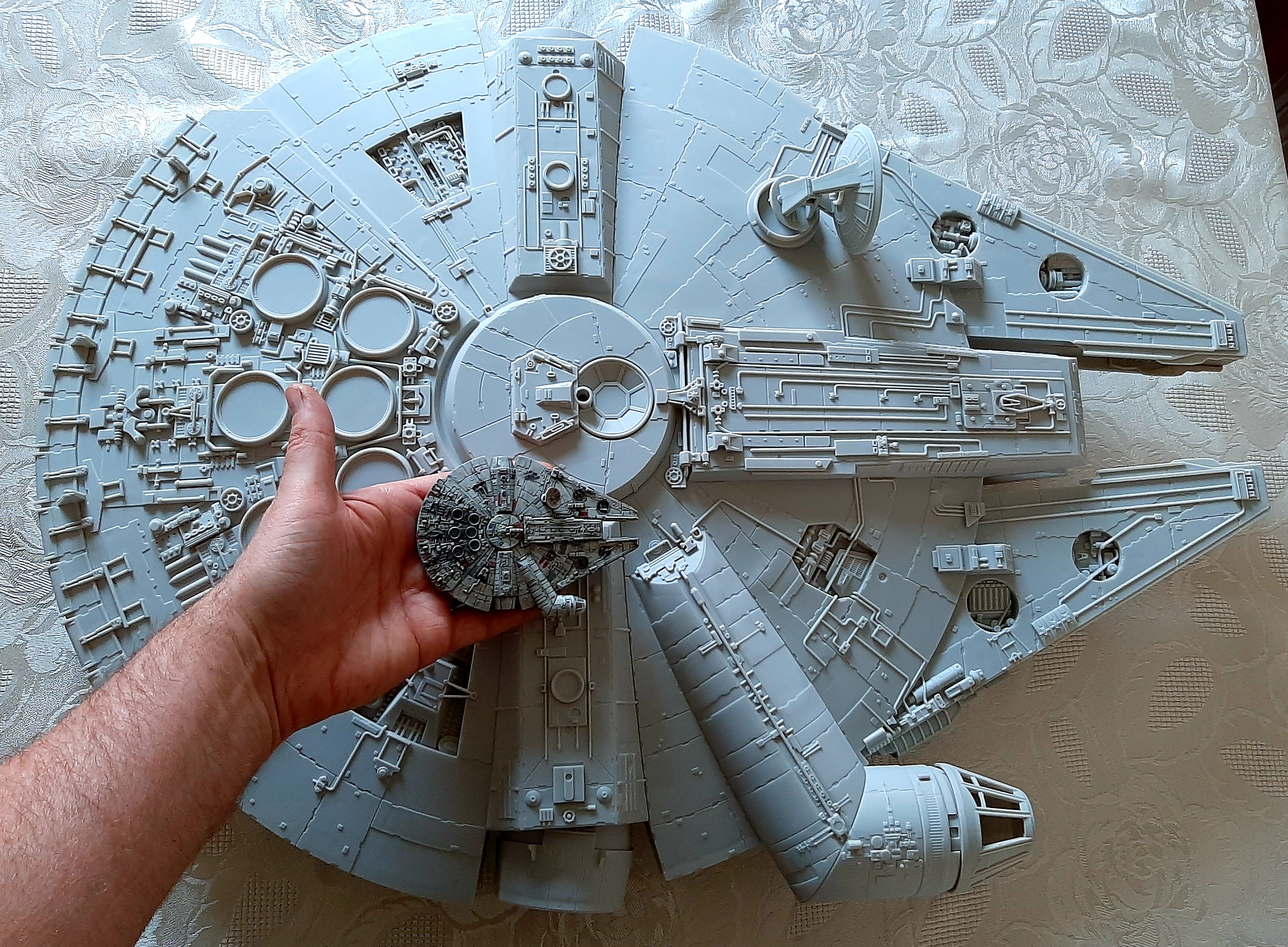

Just a quick size comparison with a small 1/241 Revell Falcon I gave a better paint job (or is that worse) to a while back. With all this talk about adhesion I'll have to do some tests on the interior to see what sticks and what doesn't. Before I tackle the hull.
Andy.

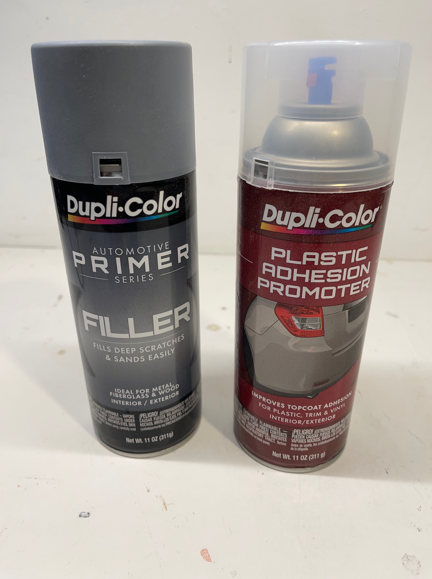

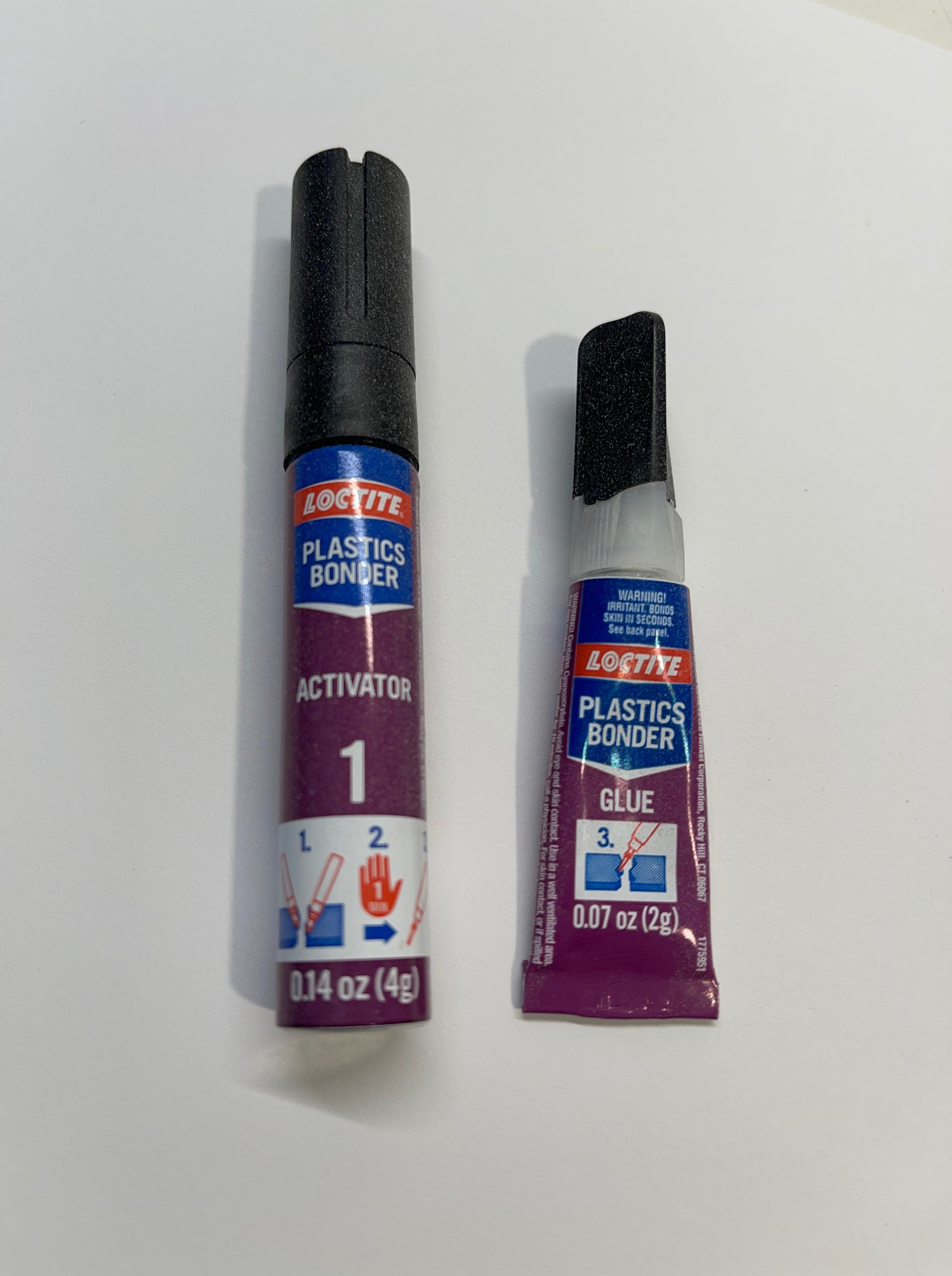

Not meant to discount or contradict what Starks said. but this is how ILM's Bill George finished his (again no guarantee it won't flake off 20 years down the line, but it seemed to work for him)
from Facebook Groups
"This is what was recommended online and it worked great for me. The adhesion promoter on the right is for painting flexible car bumpers. That goes first followed by the DupliColor primer. I applied the enamel base coat over that. Before painting the first coat I did a quick wipe with a cloth rag and acetone. As I had already glued a lot of styrene pieces to the polypropylene, I had to avoid those areas."
"he glue was really useful for glueing down surface plates and details."
"And I used countersunk screws to attach the shells to my plywood armature. To fill the holes, I melted discarded poly pieces with a soldiering iron. It was the only way I could think of for filling the holes. I never got the surface perfectly smooth but with all the paint/aging it's pretty forgiving."
