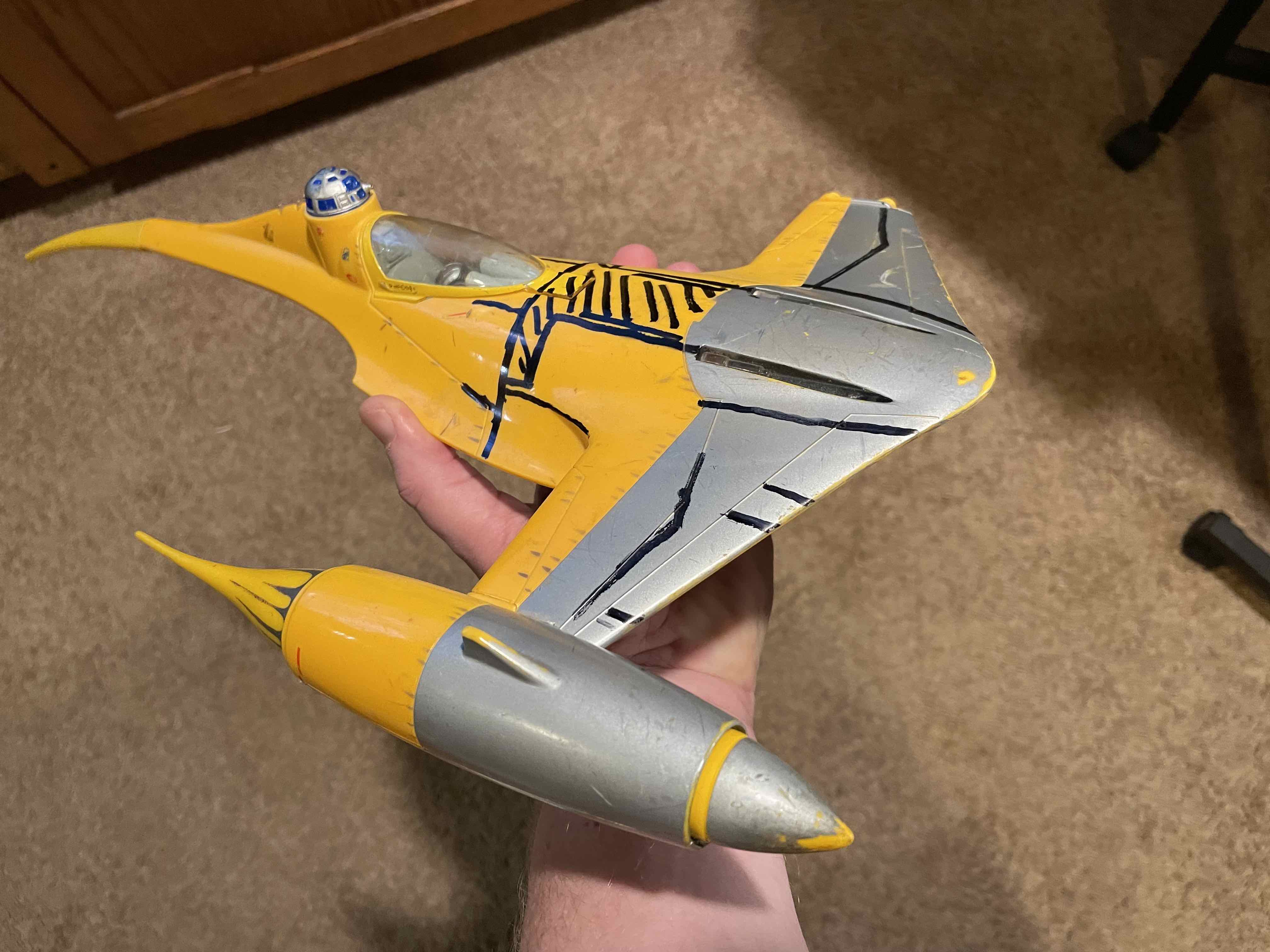

A few months back a friend was giving away his kids' Star Wars toys and I snapped up this original Hasbro N-1 fighter for free. It had a missing engine and some well-earned dings from children playing, but it was in otherwise good condition. The canopy bubble wasn't cracked, so that was a big plus for me.
My original idea was to convert it to a more accurate TPM replica: 3D print a new engine, replace the rubberized engine and tail spikes with accurate 3D parts, new cockpit and canopy frame, etc. After seeing last week's episode of Book of Boba Fett, however, it's a no-brainer to turn it into Mando's new ride instead. The proportions seem close enough and Mando's modifications make for a fun challenge.

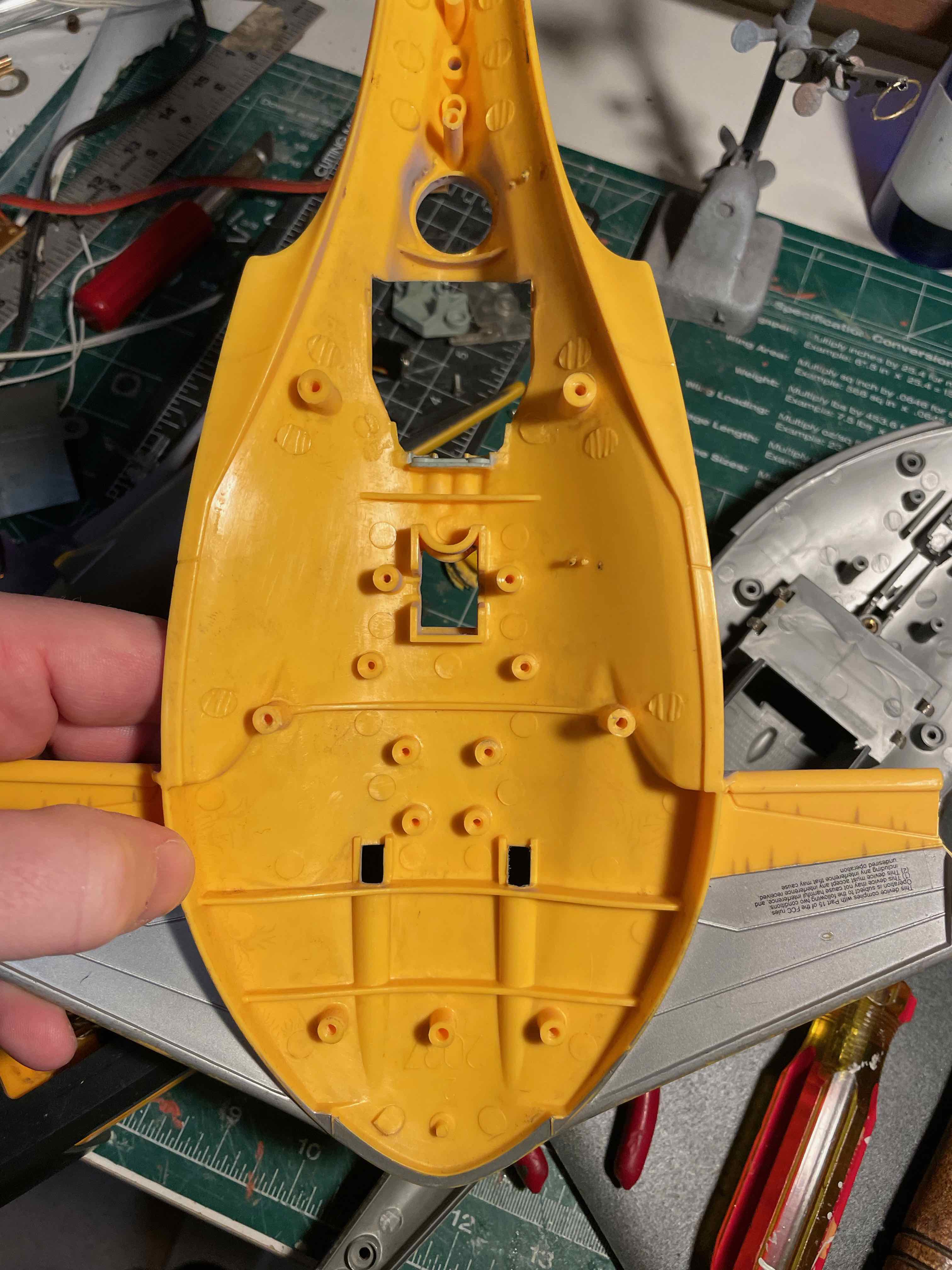

A few screws removed and these are the guts. Removed all the electronics, the rubber R2 unit, and snapped off the remaining engine.
Some disassembly required. I had to break part of the wing to get the engine off, but I'll be running some brass rectangle rod through the wing to run lights and support the new engines, so I can repair the wing later. The undersides of the wings are missing, so I'll be adding that with styrene.
After stripping the stick-on decals, I gave it some primer to get a better look at what needs to change. The raised lines will be first to go.
I did a quick proof of concept for the engine spikes in Tinkercad and printed it up. I discovered using screengrabs I inverted the raised areas on the new spikes, so I designed some new more accurate spikes that are printing this afternoon. The new spikes are fragile, so I'll experiment doing them in PLA as well. It would be nice to cast them in aluminum, but that's way outside my skill set for now.
View attachment 1540982View attachment 1540984

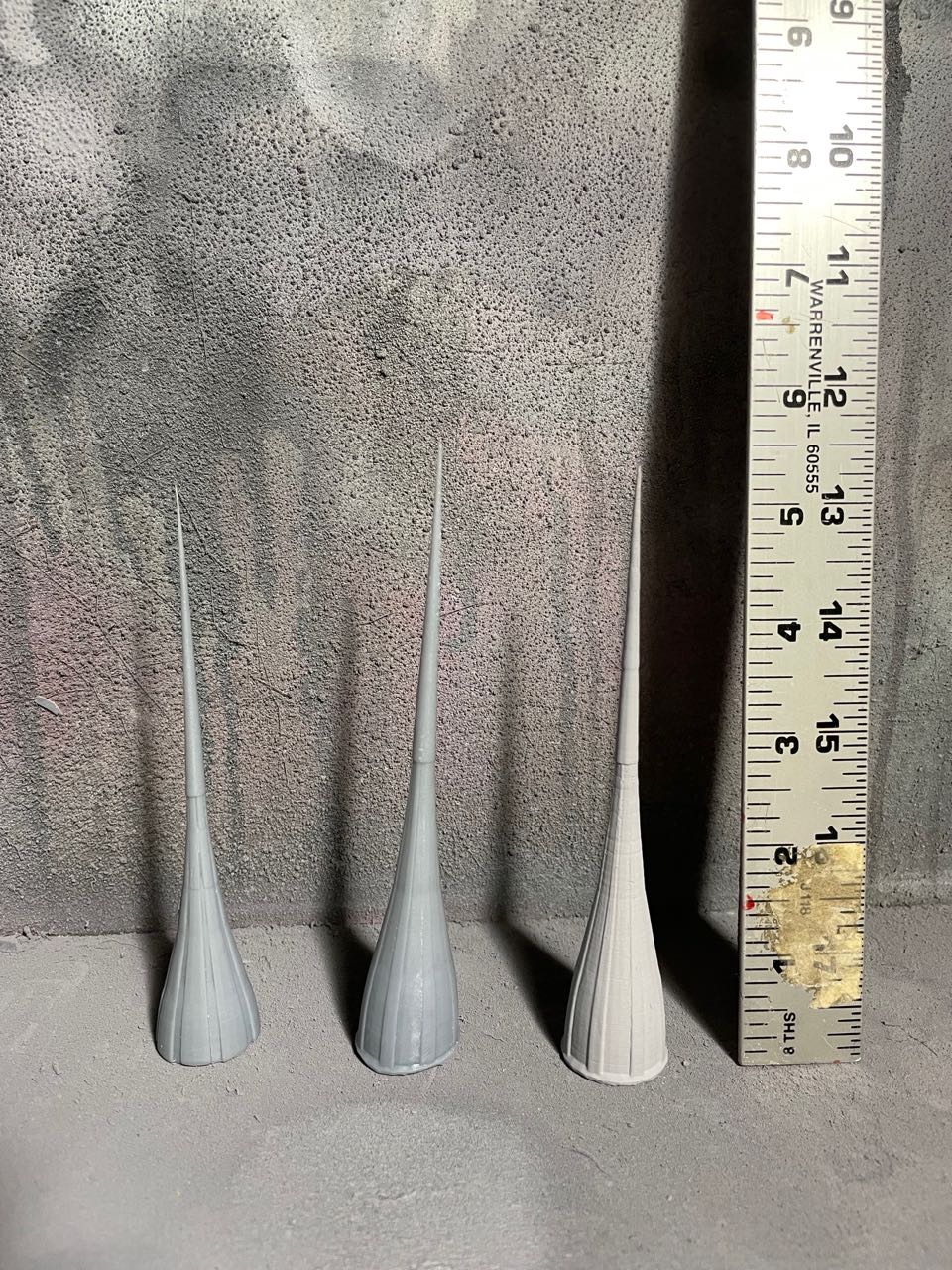

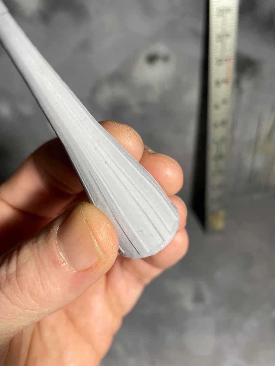

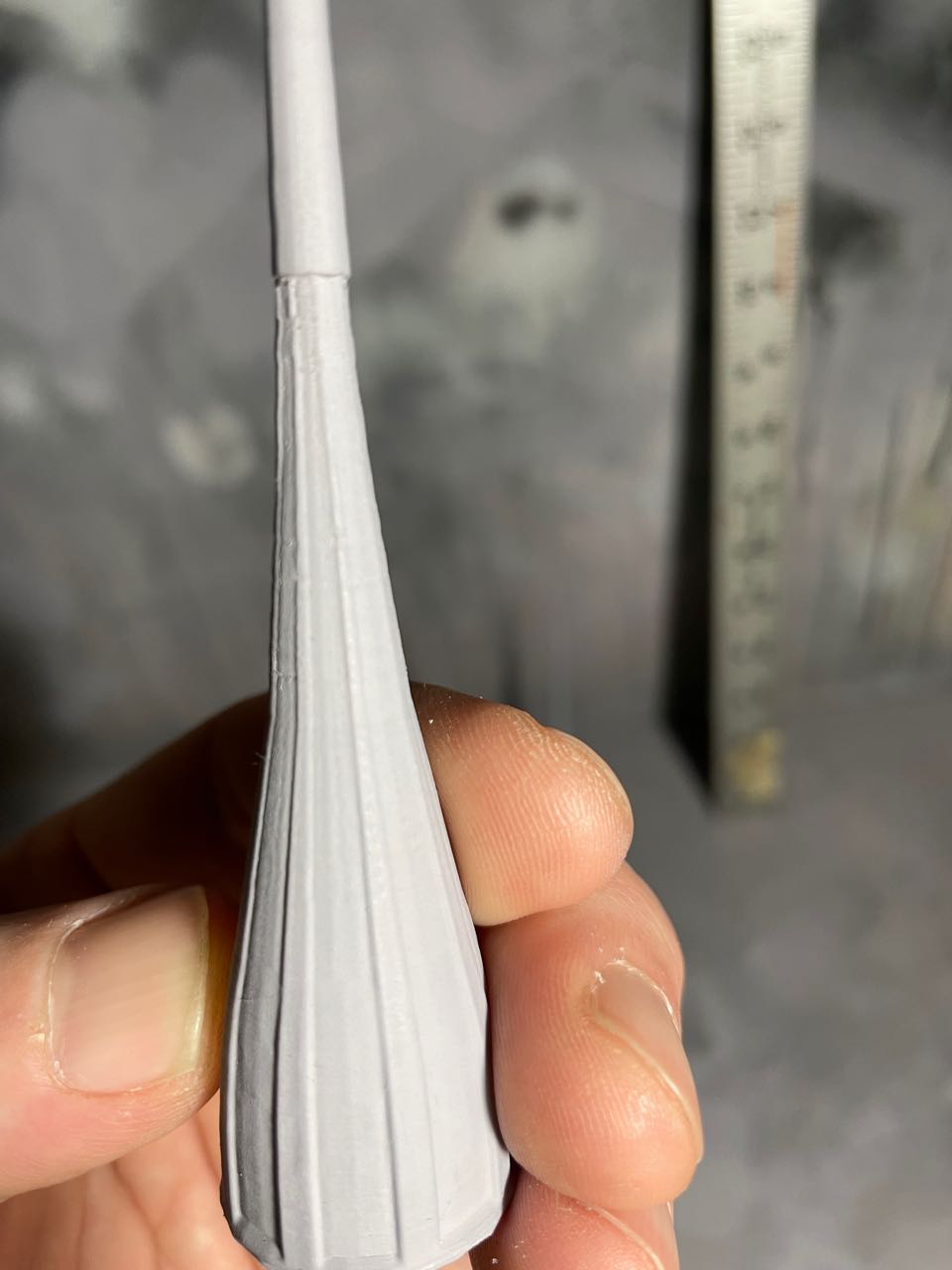

Printed a spike prototype on my Ender-5 Pro using PLA. Seems about as stiff as the resin spikes but not as brittle. It's also easier to see the layer lines, so sanding will be a bear. The long tip of the finial seems more likely to get distorted from random bumps and handling in resin than in PLA (these sentences all require an obligatory "that's what she said" ) :p
My three prototypes so far.
So I think the final version will be in PLA. I'll tweak the settings on the Ender to see if I can reduce the layer lines some more. Instead of mucking with inserting brass rods or trying to figure out carbon fiber (I need to keep this project moving) I'm going to mold a cylinder-shaped insert into the base of the spike to epoxy in a magnet. That way the spikes can be removed for transport or easily replaced if an accident happens and they get dinged. If the magnet has some give, they're less likely to snap (I hope).
