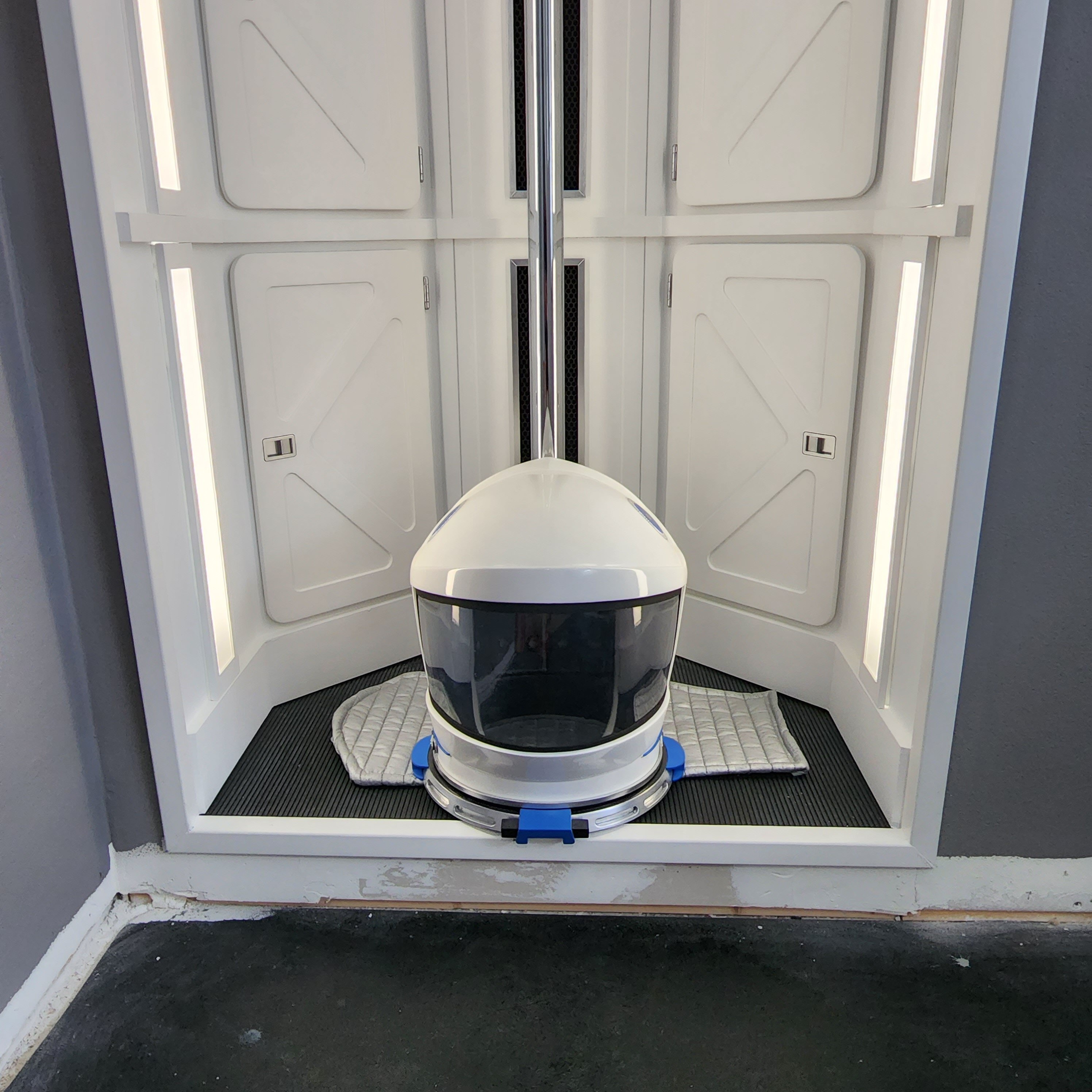

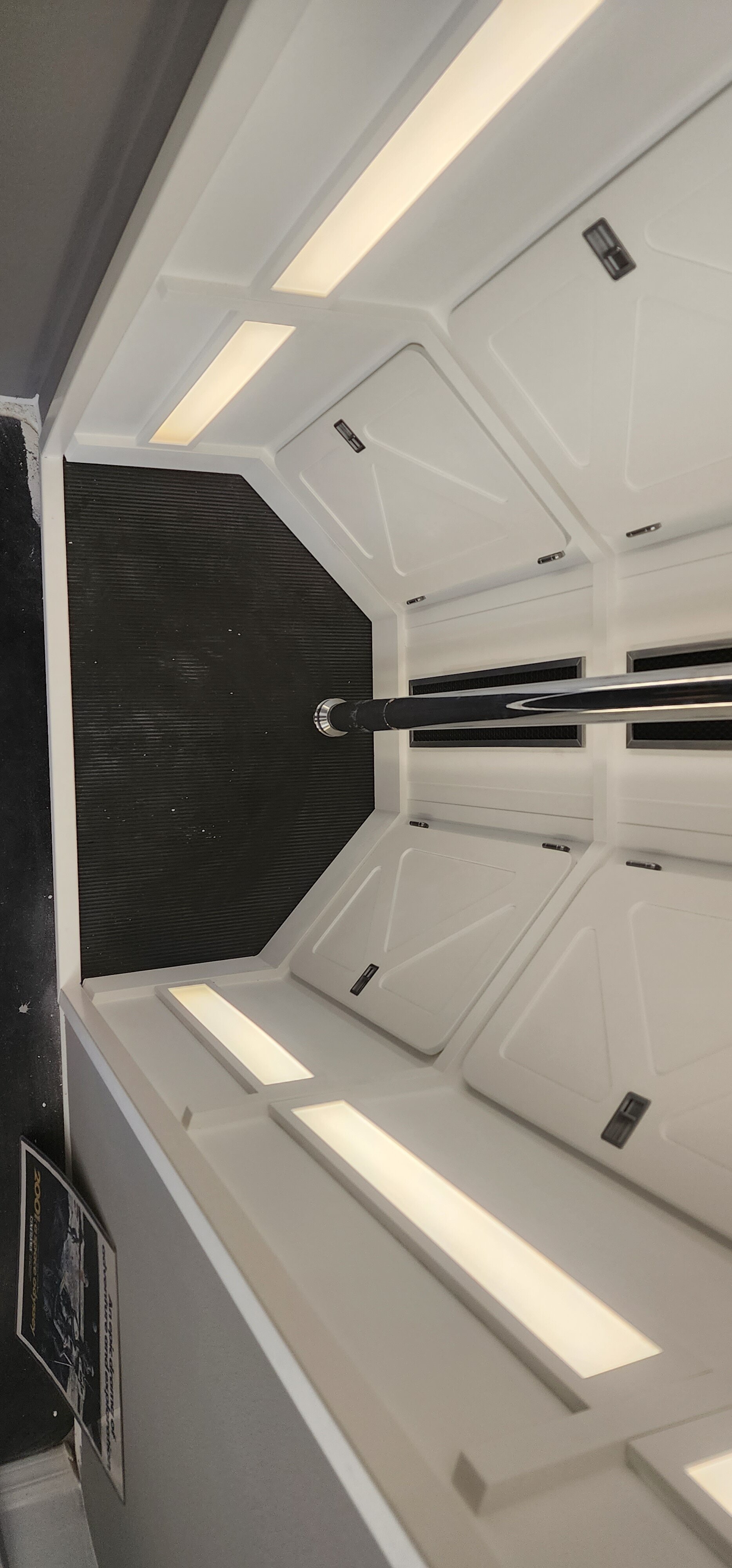

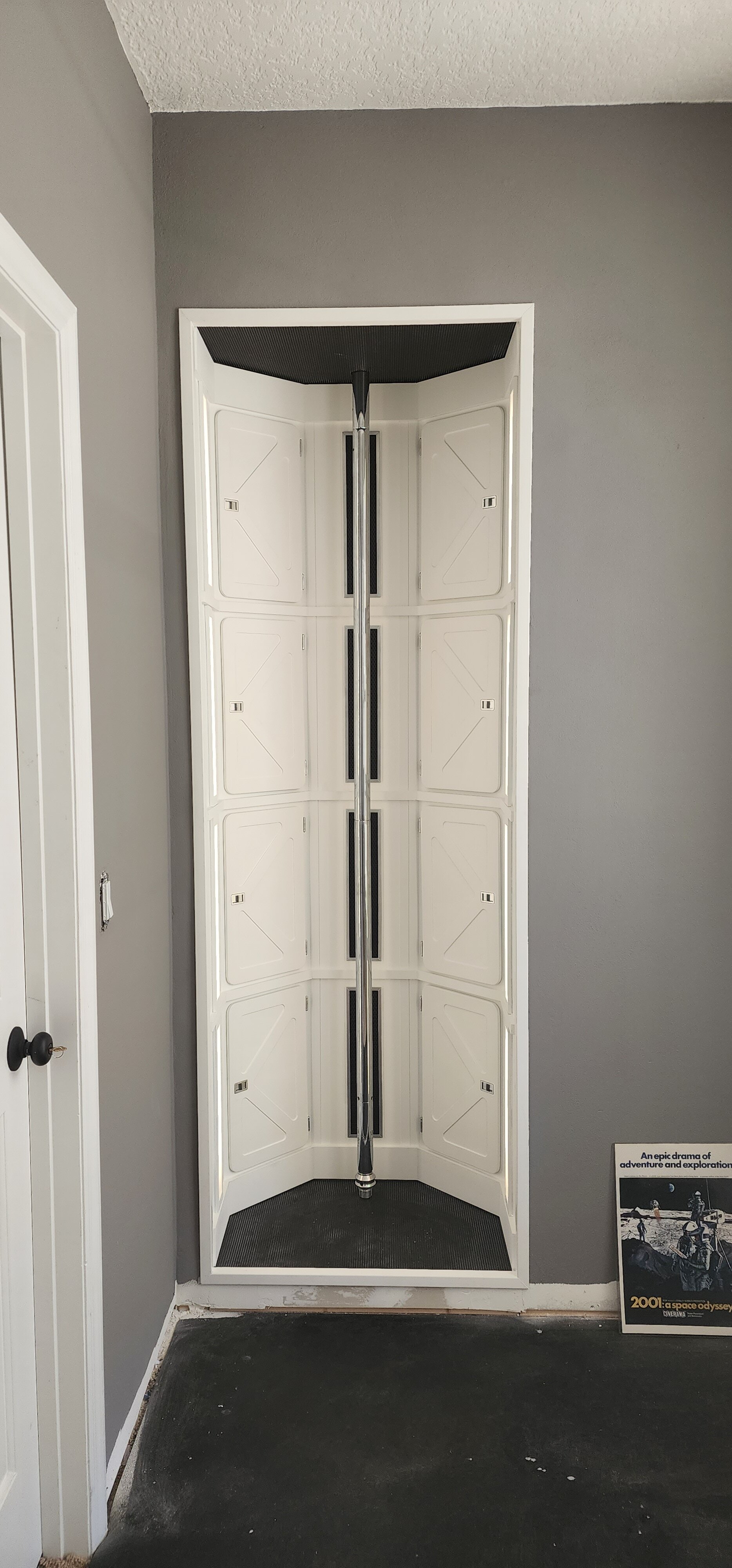

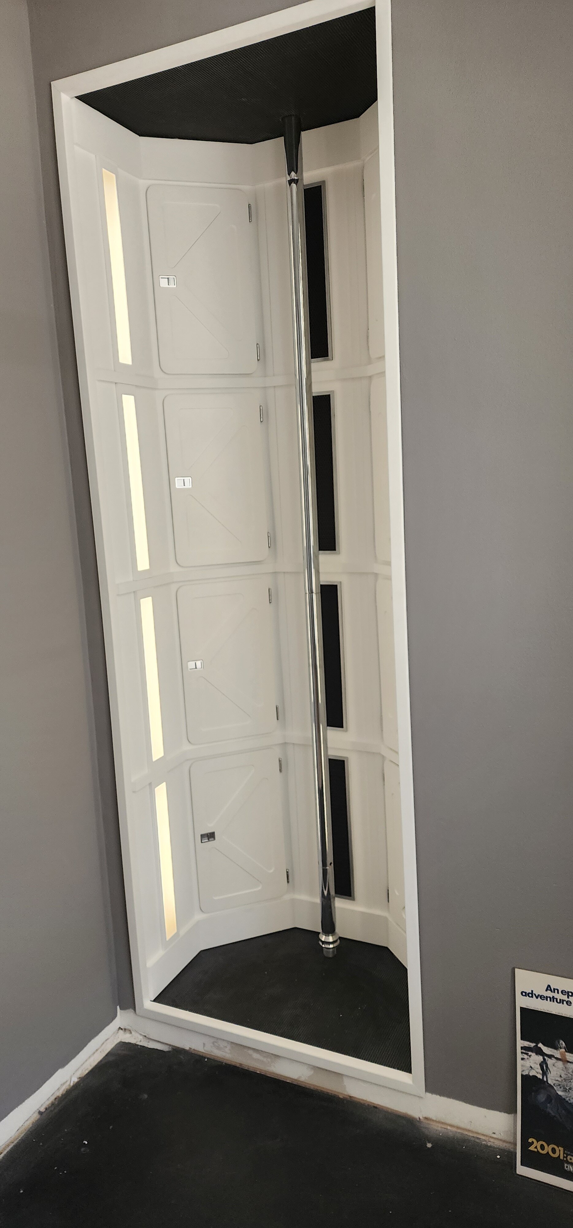

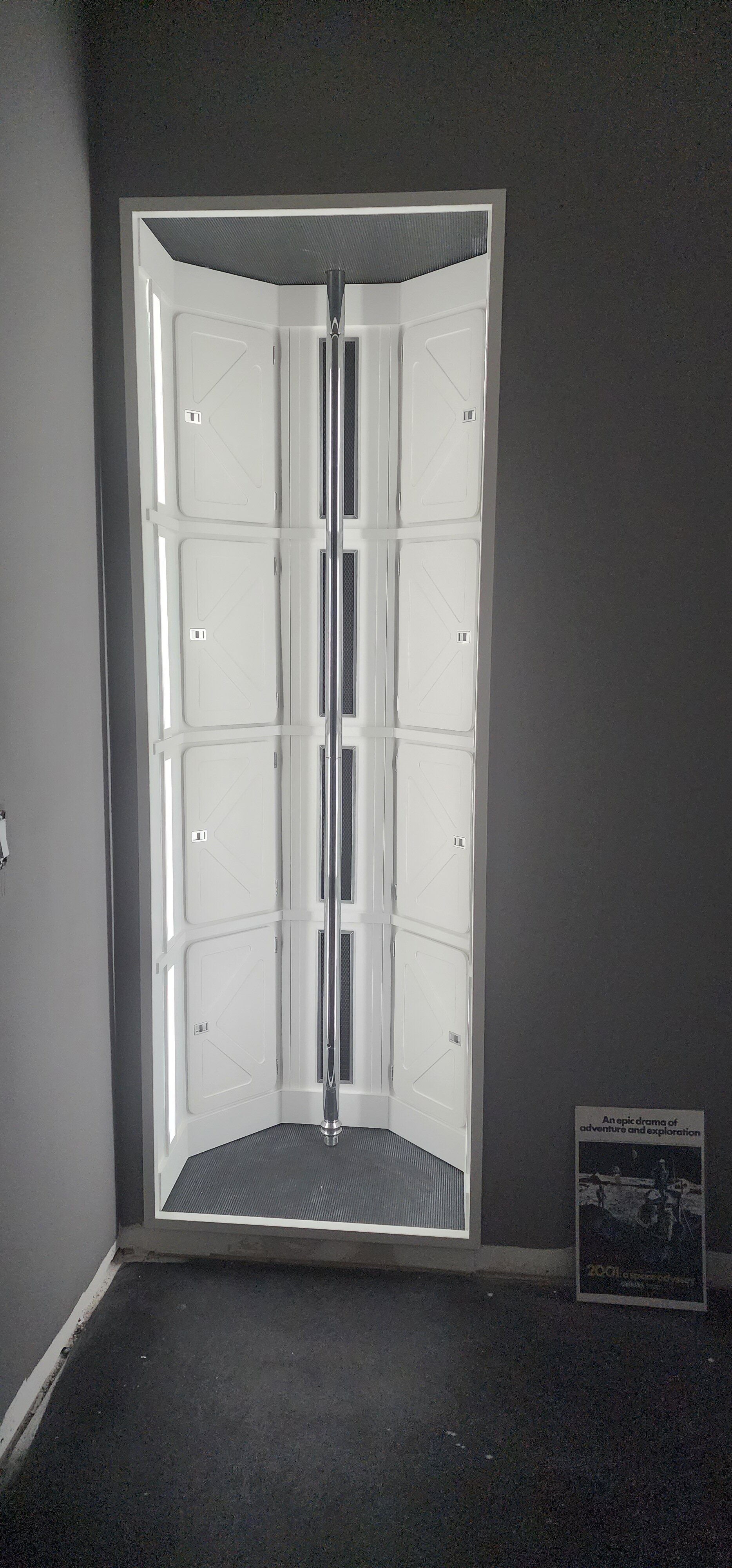

So...I can't believe it been a year, but finally getting back to it...but I had to shift gears (and didn't document the process sorry) I completed the case I will be displaying the suit in...it's a doorway I constructed and there is another door to the room behind it. Its part of a house remodel and needed to prioritize it...I am now focusing 100 on getting the suit completed.
That helmet and display area are great! Can't wait to see the entire suit.
Wow...you went all out with that displayo_O :cool: :cool: (y) (y) How did you do it? Vacu-formed doors?

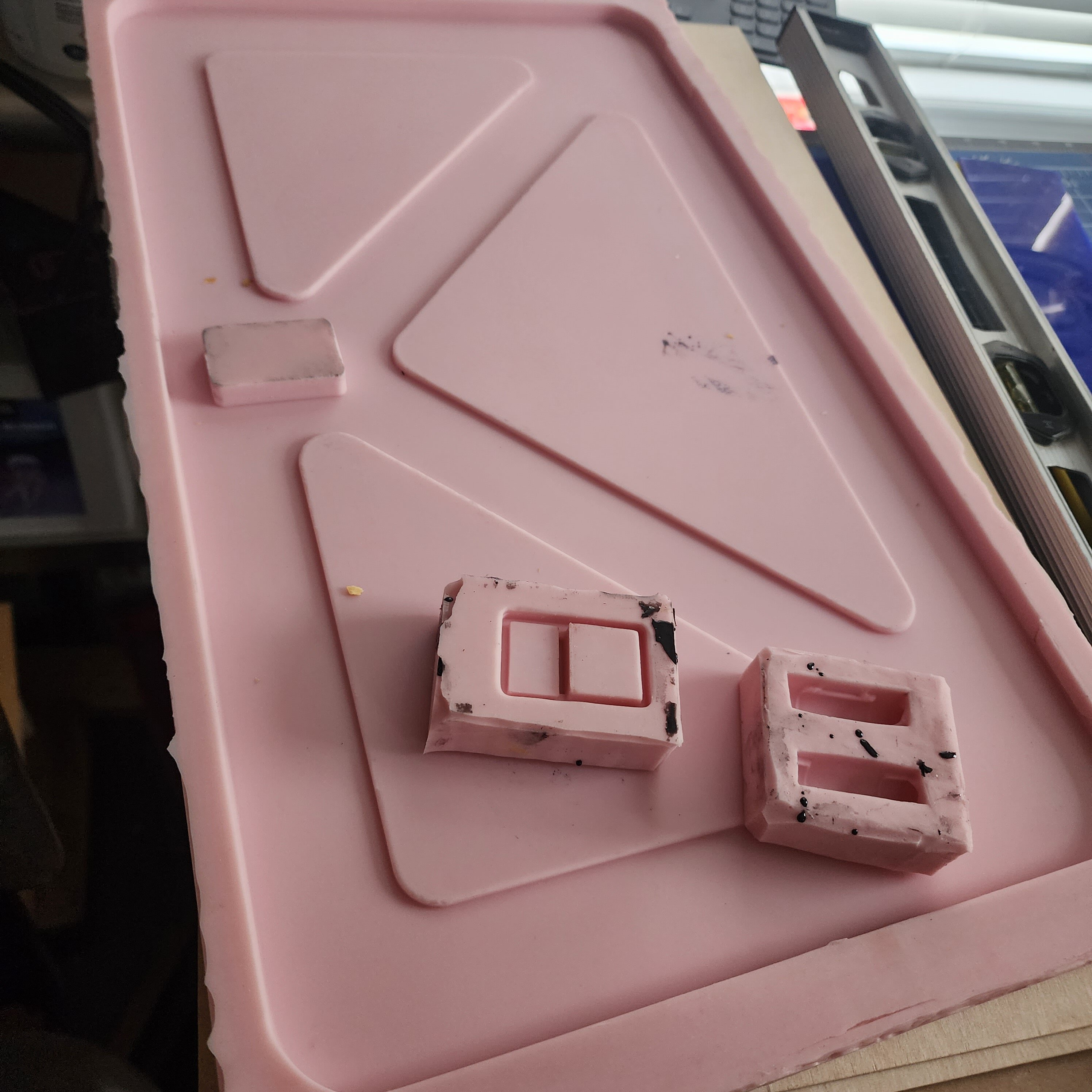

The main carcass is mdf, and I laser cut a door, then made a silicone mold and cast them in Smoothon Featherlite urethane resin. Hinges and latches all resin cast. Lights and vents are laser cut acrylic. Rubber mat for floor and ceiling..."dancer" pole from amazon to finish it off...I'll soon post images of the brackets for the pole that match the hardware the suits are on in the pod bay on the Discovery...

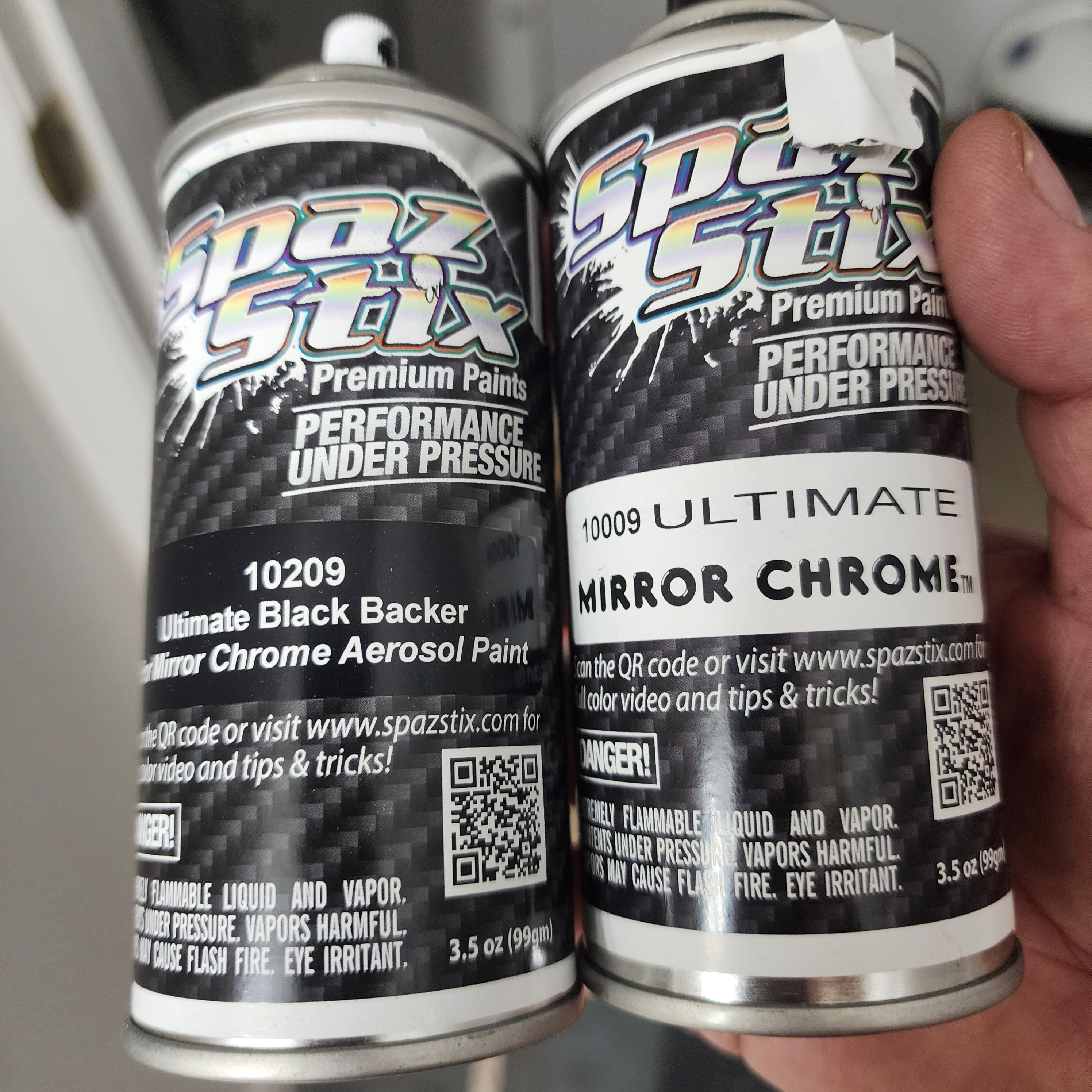

This looks amazing, well done display area. What'd you use to paint your resin parts to appear metallic?
I have been getting great results with this product...2 to 3 coats of black, buffing with a fine scotchbrite pad between coats and topping off with the chrome spray, then a light buff with a cotton cloth...the neck ring on the helmet is the same process, and is what all the parts of the rest of the suit will get...
Thanks, I'm always on the hunt for new and decent metallizing techniques/products. I'm not familiar with this brand, is I'll need to read up on it. I'm actively learning electroplating, but good and fast painting techniques are always valuable.
...it's doorway I constructed and there is another door to the room behind it...
I'm a little dense at times, so please forgive the dumb questions, but are you saying that the display opens "as a door" into the adjacent room, or that the doorway no longer functions and you have to use another entrance to go into it?

You aren't dense, my post didn't make much sense...I removed the door and jam and built the cabinet in place. I have another entrance to that room (which happens to be where my 3d printers and laser cutter are.) It would have been cool to have it open, but that would reduced my usable space in that room...
Thanks for the clarity, and yes, your post may not have been very clear, but I’m still pretty dense (most of the time ).
Sounds like a cool way to display your suit and I’m looking forward to watching it come together.

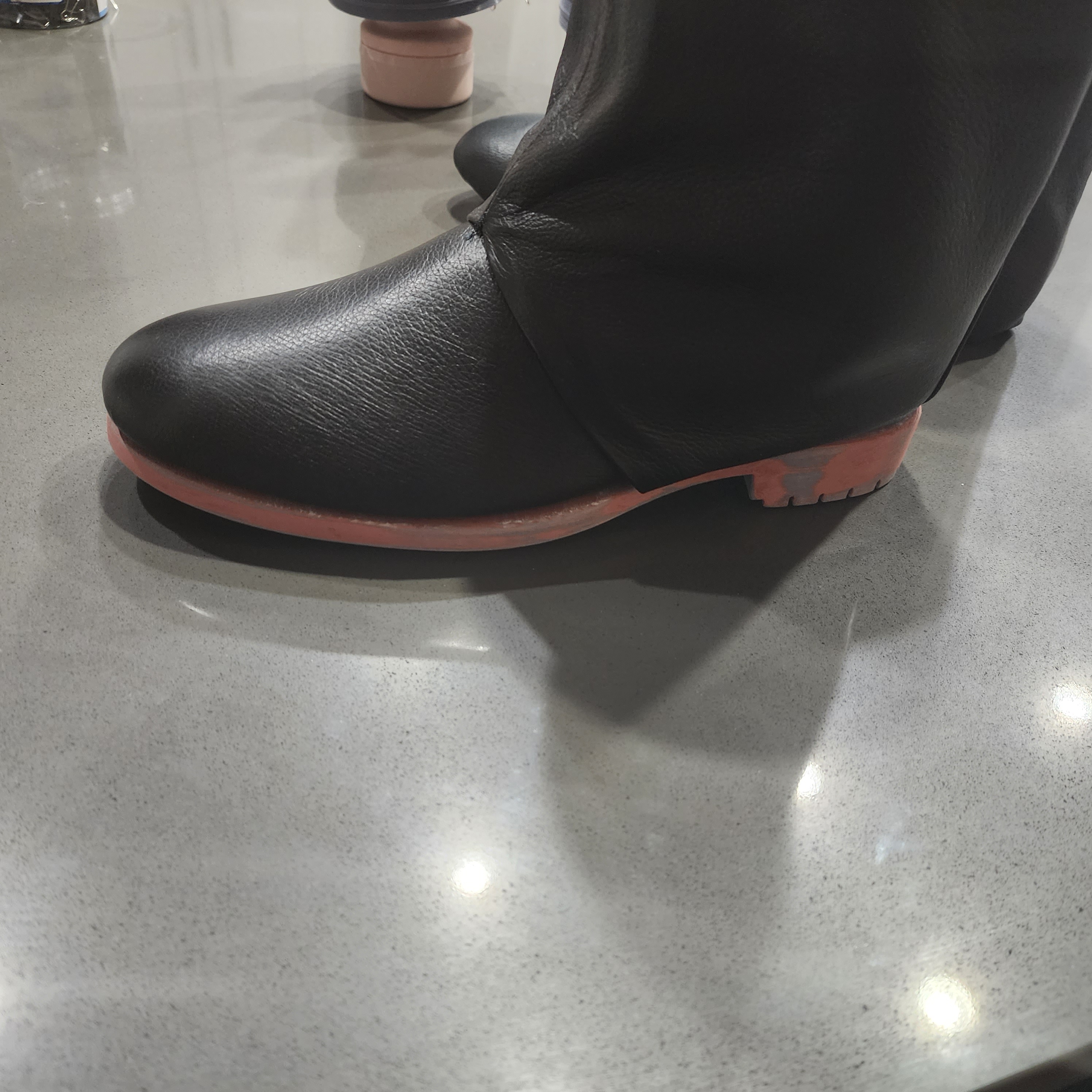

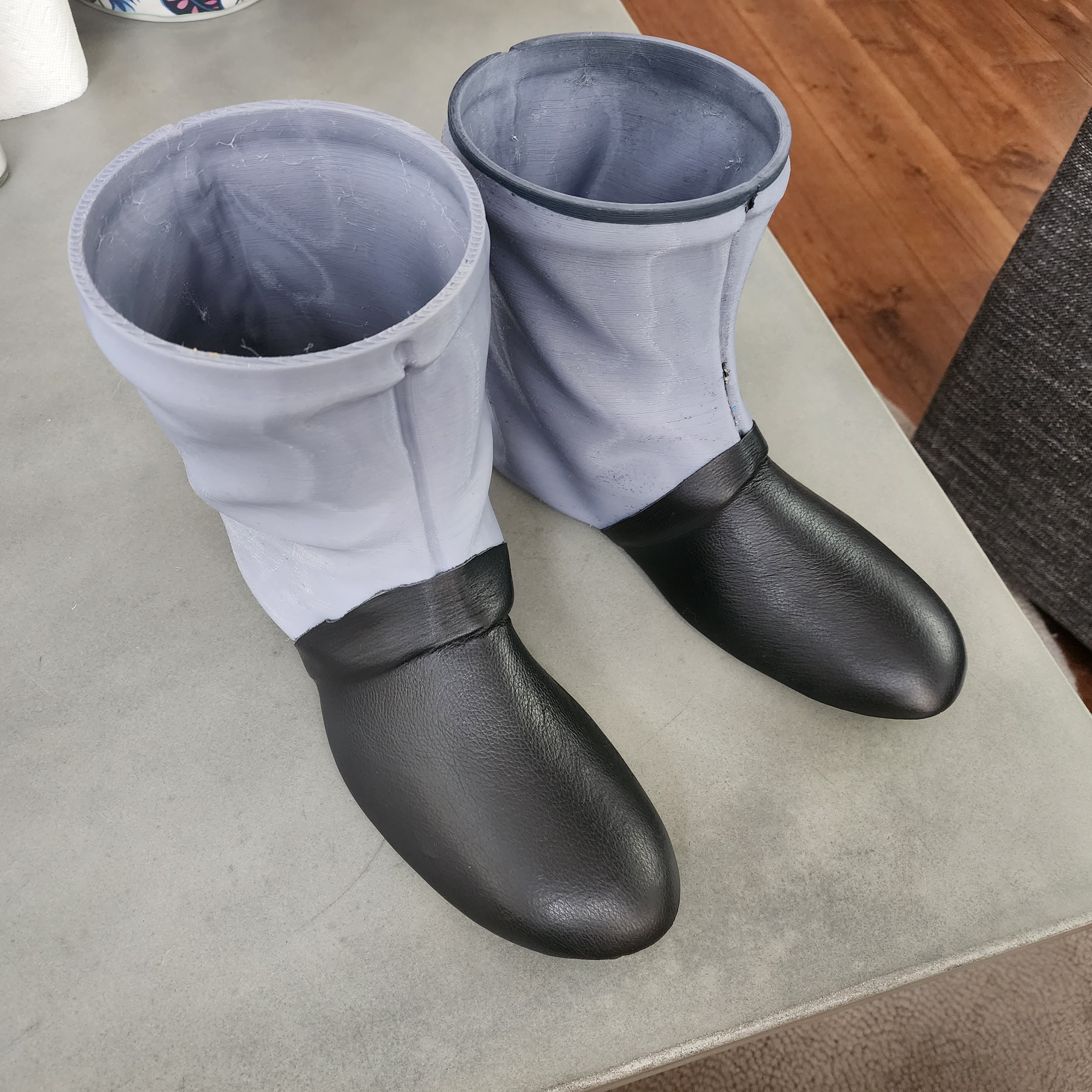

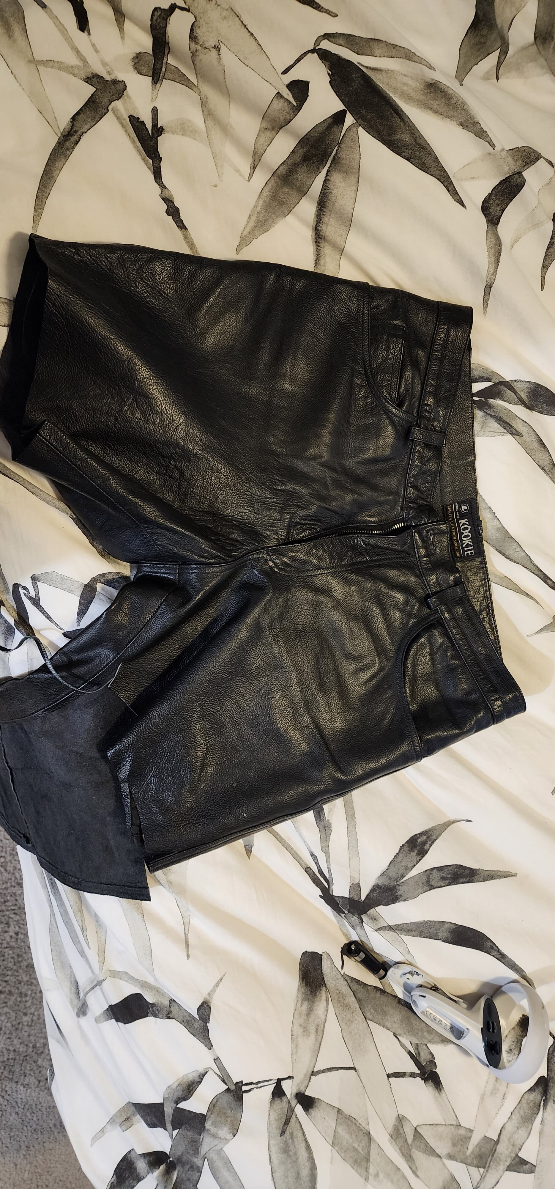

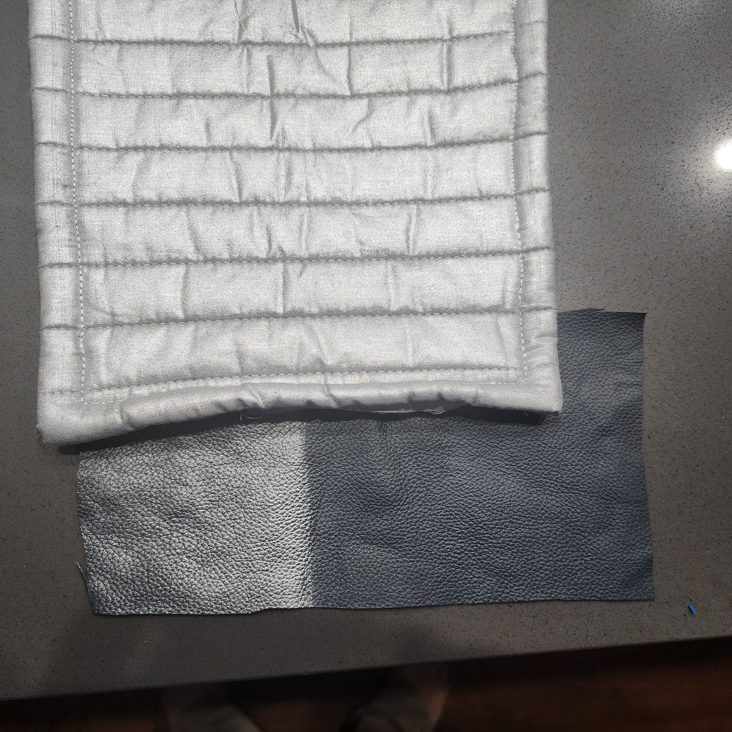

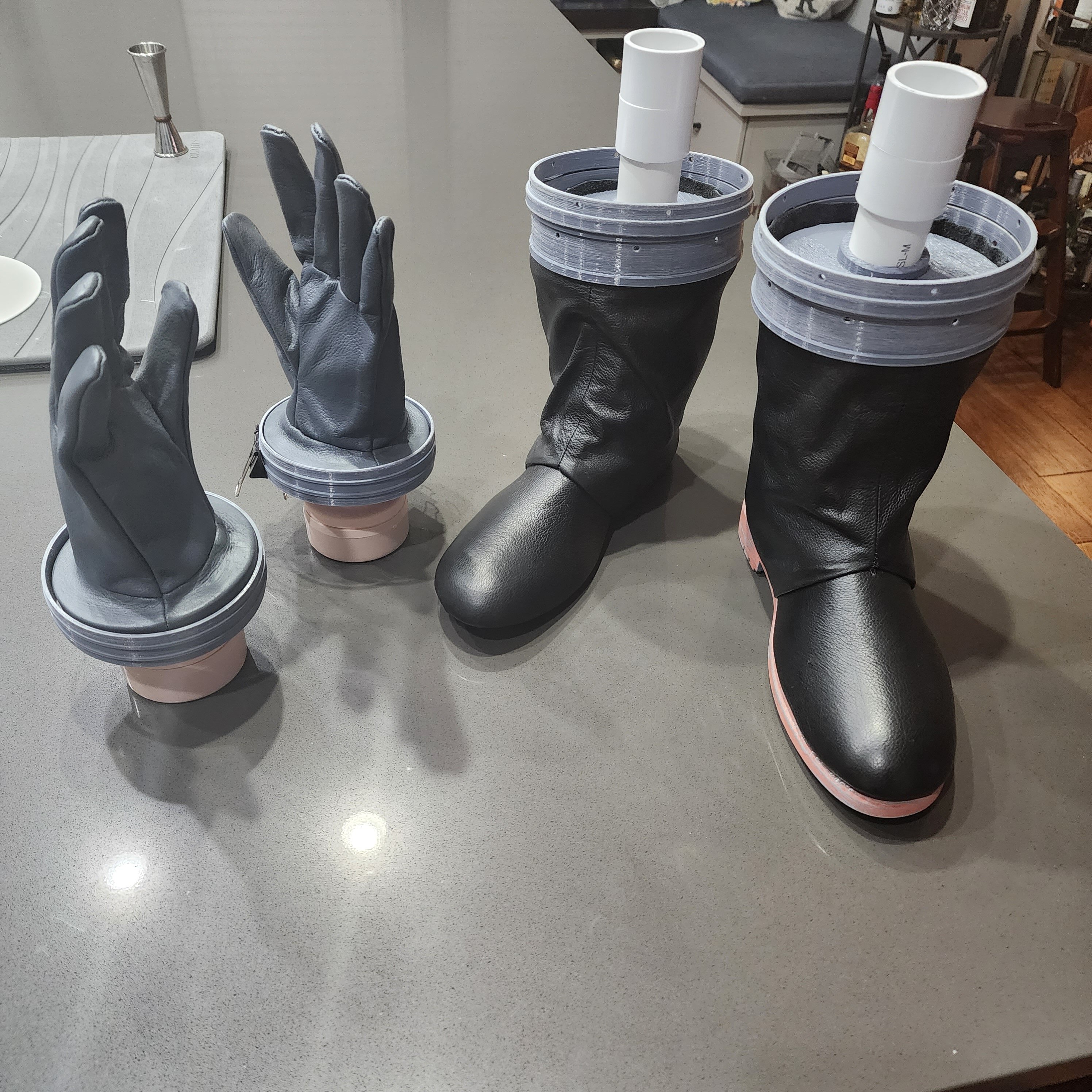

So, progress on the boots. They are rigid 3d prints. The suit can stand on its own, supported by pvc up the legs. I struggled with how to even approach this, but I knew the suit was not something I would ever wear and in essence be a life-sized action figure standing at the door to my home office so this made sense and gave me great control. . I said on here before I'm not going for screen accuracy but my interpretation changing a few things to make them feel more real, my suit is sewn in the same fabric for ironing boards, so it has a cool fire suit tactileness to it it feels more real than the silver from the film. I also wanted the gloves and boots be made of the same leather, not the tan suade commonly depicted. I cut the legs off an old pair leather pants and wrapped the leather around them. I'm going to paint the black leather to match the gray of the gloves, and dust maybe dust with silver...maybe leave gray, palms of gloves will be died black...

Those boots are looking good (hard to find a real pair:(); the ironing board fabric is a good idea for sure:cool::cool:(y)(y)
