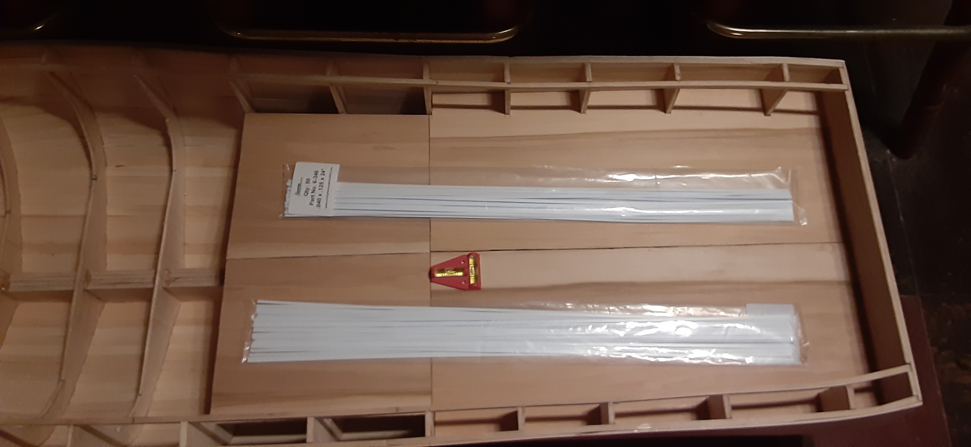

My head is spinning, trying to figure out where the rear hatches will be, where a part of the rear deck can be removed to access r/c equipment, where the mast mount under the deck will be. Head spinning. I'm waiting on 3/8" planks for the deck, you were absolutely right Nolan, 1/2" was too wide. The white plastic strips you see will be between the deck planks. They're going to help a lot to hide the r/c access hatch. I've cut the bow deck section, putting deck camber into this piece will be fun.

Locating and Cutting the deck hatches next, then I can glue everything down. I'm liking the plastic strips between the planks.
